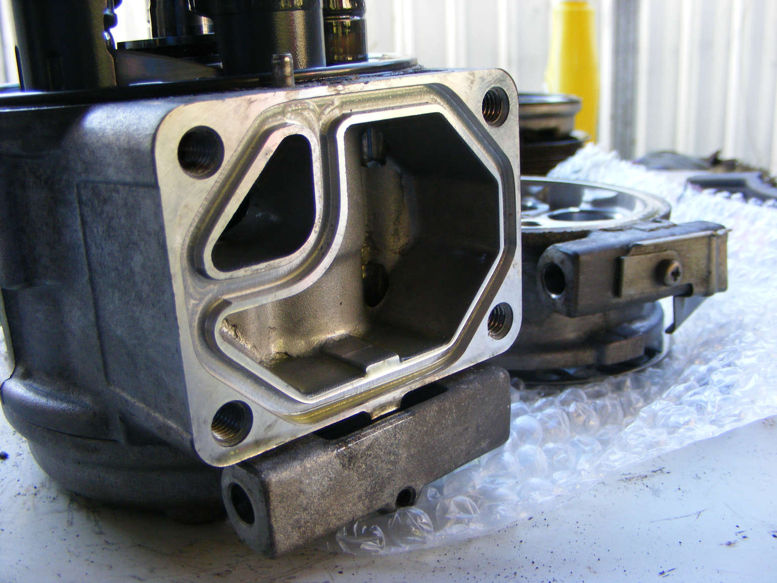

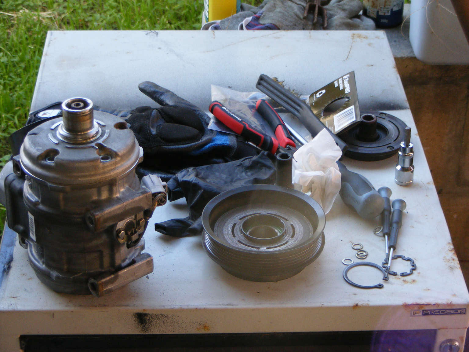

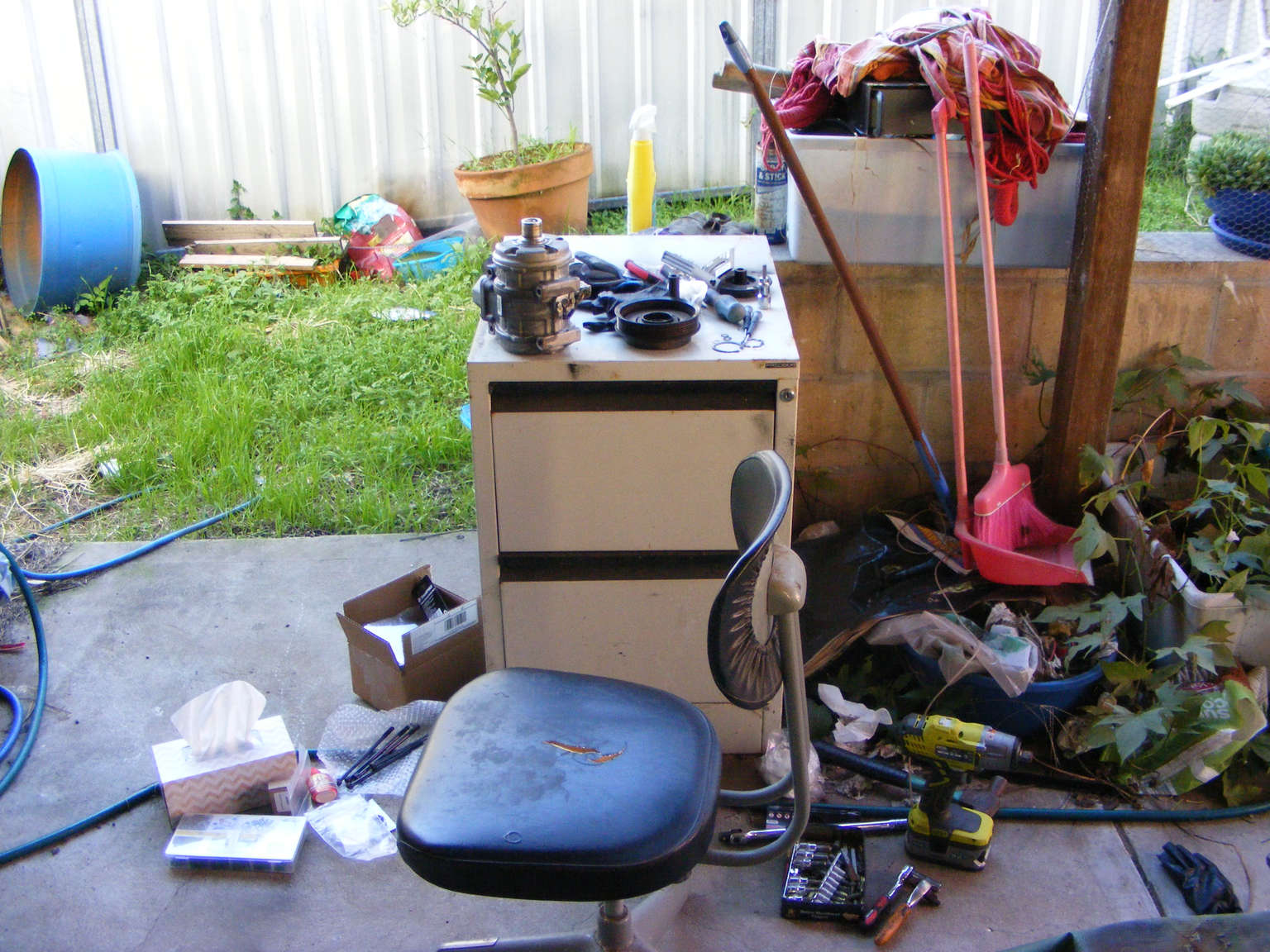

Well the A/C compressor is back in with new seals all round. I'll have to find or make some rubber plugs that I can stick in the inlet and outlet pipes on the A/C compressor, right now I just have a plastic bag covering it and thankfully its not raining and there is no water on the ground so I have some time to find something that will work. Maybe stuffing some tissues in there will be better.
EDIT: And that is exactly what I did. I stuffed some tissues in there and put the plastic bag over it with a rubber band, it will have to stay that way until I can get the hoses repaired which is a tad expensive.

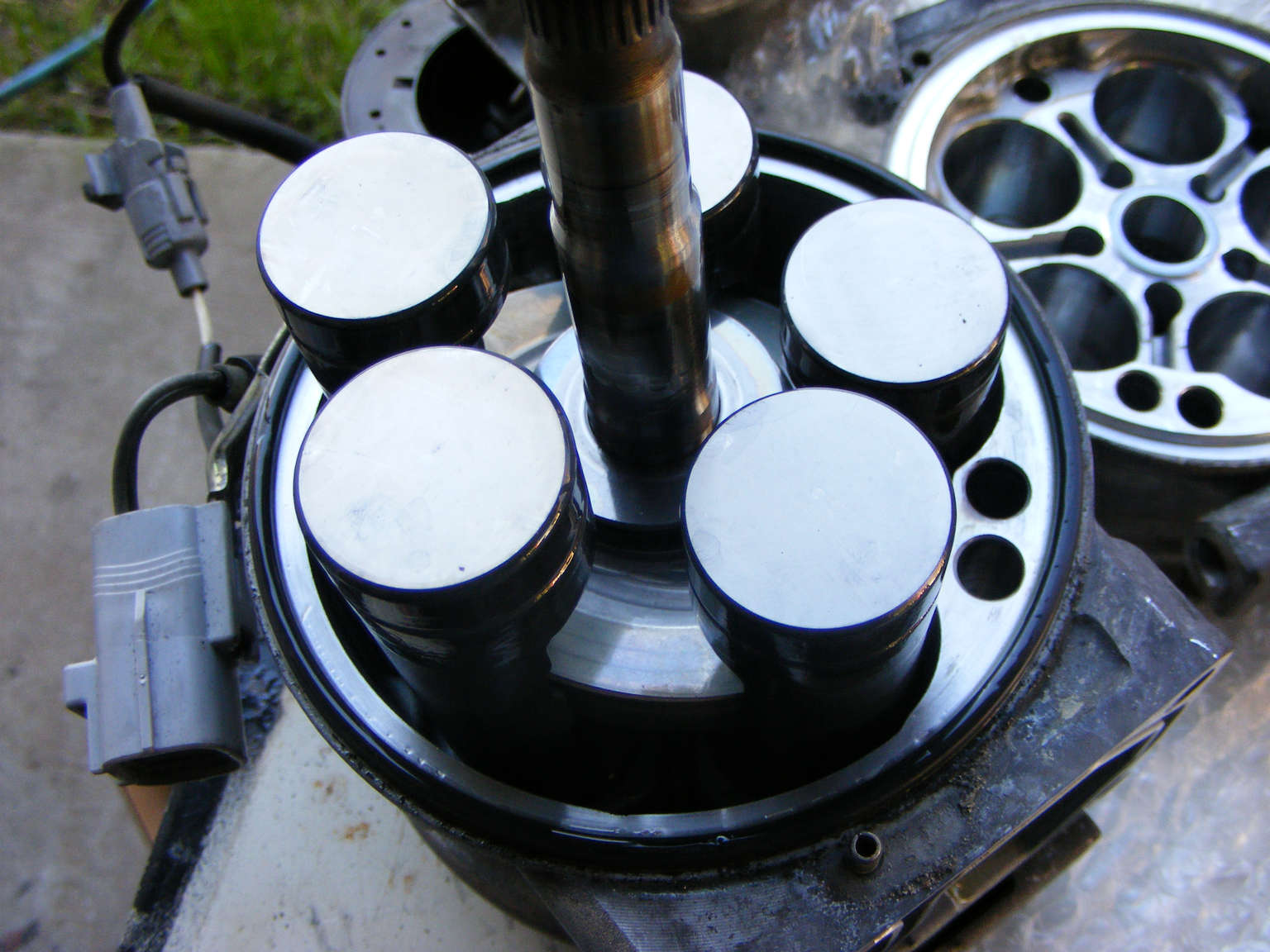

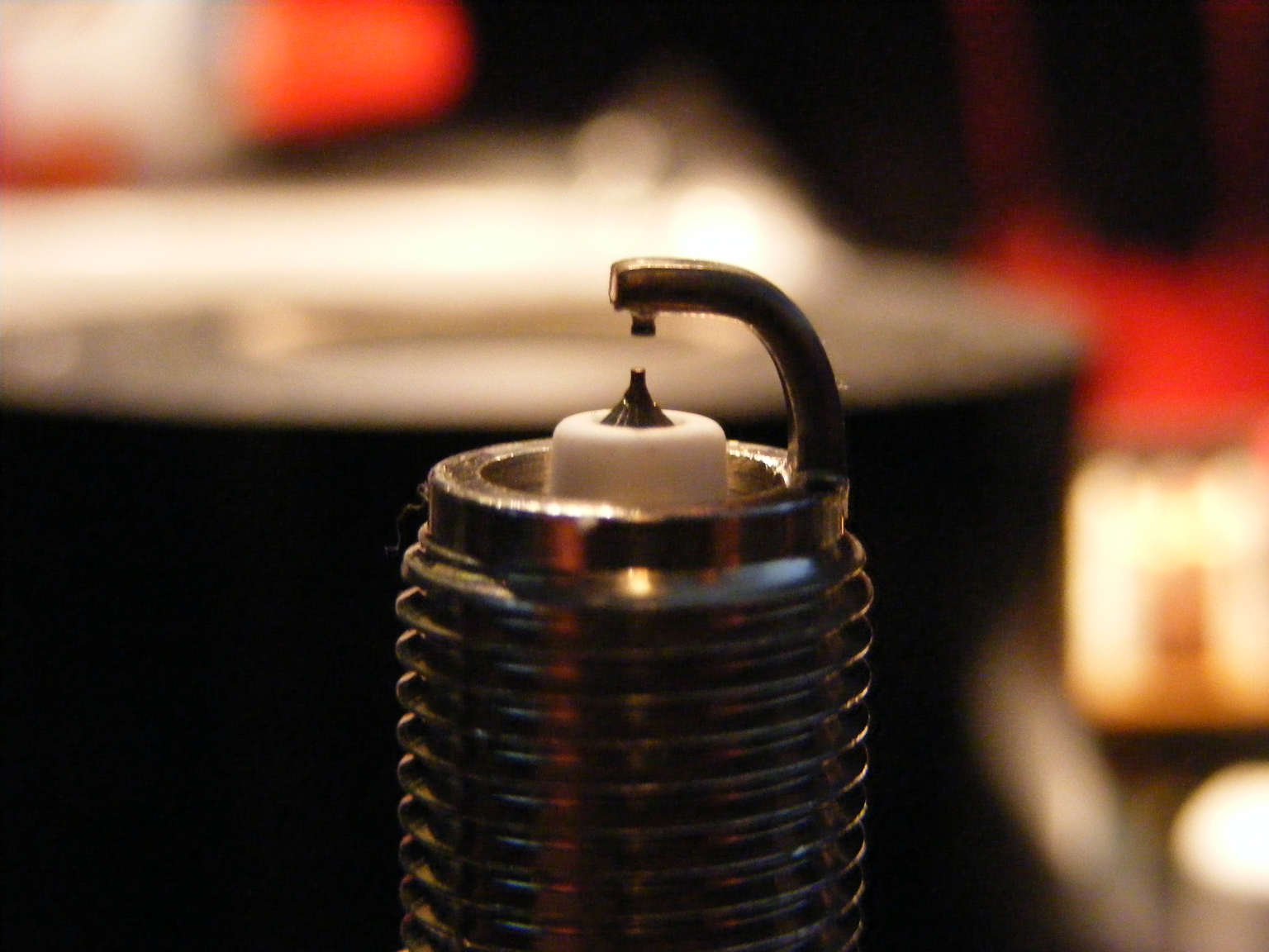

The setup required to do a compressor (Denso 10PA17C) seal replacement and also a bonus photo of the Denso Twin Tip spark plugs that I installed a while ago.

Interesting I've not seen inside a compressor before. Is it just the large O ring that you replaced or the "rings" on the pistons too?

You just replace the O rings, you leave the pistons alone. Actually on mine I ended up only replacing the input and output seal (in picture 8) and the shaft seal, I left the big O rings alone and I simply took them out and coated them in Nylog Red sealant in between my fingers inside of gloves and put them back in. The reason for doing this was because the old O-rings were larger than the replacements in the rebuild kit and I didn't have confidence that the new O rings would seal properly.
Before I reassembled everything I also made very sure that no dirt got into the compressor and I cleaned the outside lip with tissues and white spirits to remove any dirt away from the O ring seal areas.
I also made sure I didn't lose any pins. Basically follow the videos I link to below.
There are also some bearings on the center shaft which on mine came off a bit but I pushed them back onto the shaft with my fingers.
YouTube
YouTube
Its not a task for an amateur mechanic, you really need to know your finger skills (skills that you gather over the years of being a mechanic) and know where everything should go (namely the valve plates in the compressor need to be the right way around) to do this one properly. You also need to know the impact limits of bearings and what to do and what not to do when handling bearings.
The shaft seal is also very fragile.
YouTube
Basically a fingerprint on a shaft seal can make it start leaking. Not even kidding.

I've pulled down and rebuilt engines, but not sure I'd tackle that, anything with extremely fine tolerances I'll usually pass on 😉

Yeah. You've got it. I had to learn what to do and what not to do. Even using the wrong lubricant can stuff things up. Leaving oil in where the bolts go can also cause a crack on the back of the compressor housing due to hydrolocking, I put q tips in my compressors threads to soak up all of the excess lubricant, basically If you skip a step it can be disastrous for the compressor and the A/C system as a whole, that is mainly why I would recommend people shy away from it.
I don't recommend even thinking about doing it unless you happen to have the hoses and compressor and condenser out like I do and have plenty of spare time to sit there for 3-5 hours in one sitting twice over a period of 2 days to make sure the A/C compressor rebuild is all done properly. That is how long it took me and I'm not including the week of time that I had to wait between those 2 days for waiting for a new shaft seal to arrive because I put the old one in backwards and subsequently had to destroy it trying to remove it back out of the front housing of the compressor with a screwdriver and hammer.

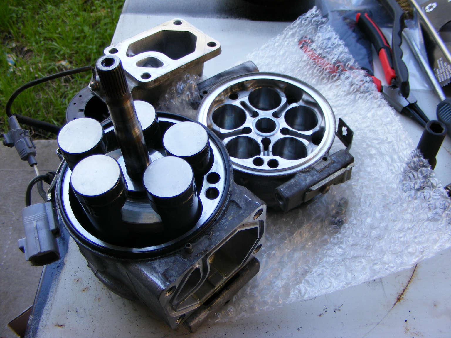

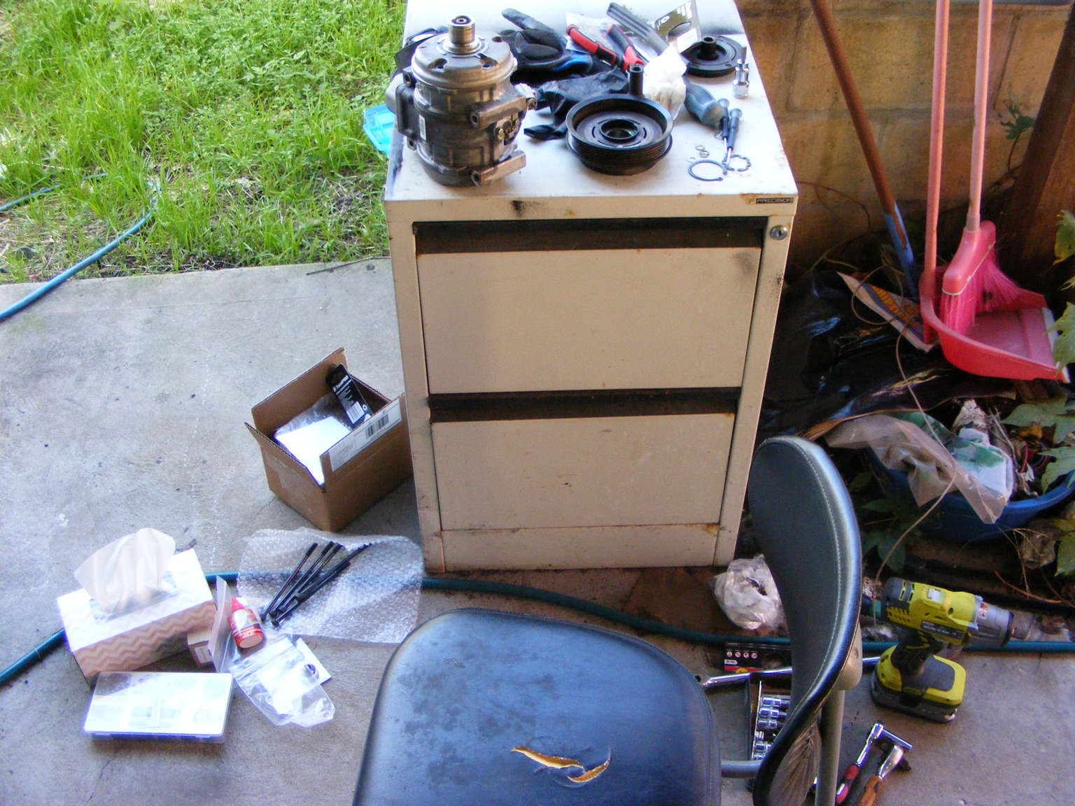

Only reason why I replaced the shaft seal and did the rebuild on the A/C compressor was because my system is gone completely to gas and the condenser and the hoses both need replacing and all of the O-rings everywhere on the car (wherever hoses meet one another) need replacing already because the system has never been serviced before, its all original and the hoses are leaking and that could cost me heaps at an A/C shop.
So if you are doing a full restore on the car AND the A/C system has already outgassed then you should even consider doing an A/C compressor rebuild yourself AND even then think twice about it because a small piece of dirt or sand in that compressor can cause quite a few problems (score a bore for example, get stuck in the shaft seal). It isn't that difficult to take the A/C compressor down to a shop and get them to do the rebuild for you. Or you can get a new rebuilt one on ebay.
And even after all of that I still have to take it to an A/C shop to get them to flush it out and put new lubricant in it because I don't know the amount of lubricant to add to the system, well I do, but I'm not experienced in filling an A/C system with lubricant so I'll leave that job to an expert. The fear is that I will end up adding too much or too little to the system if I did it myself.
