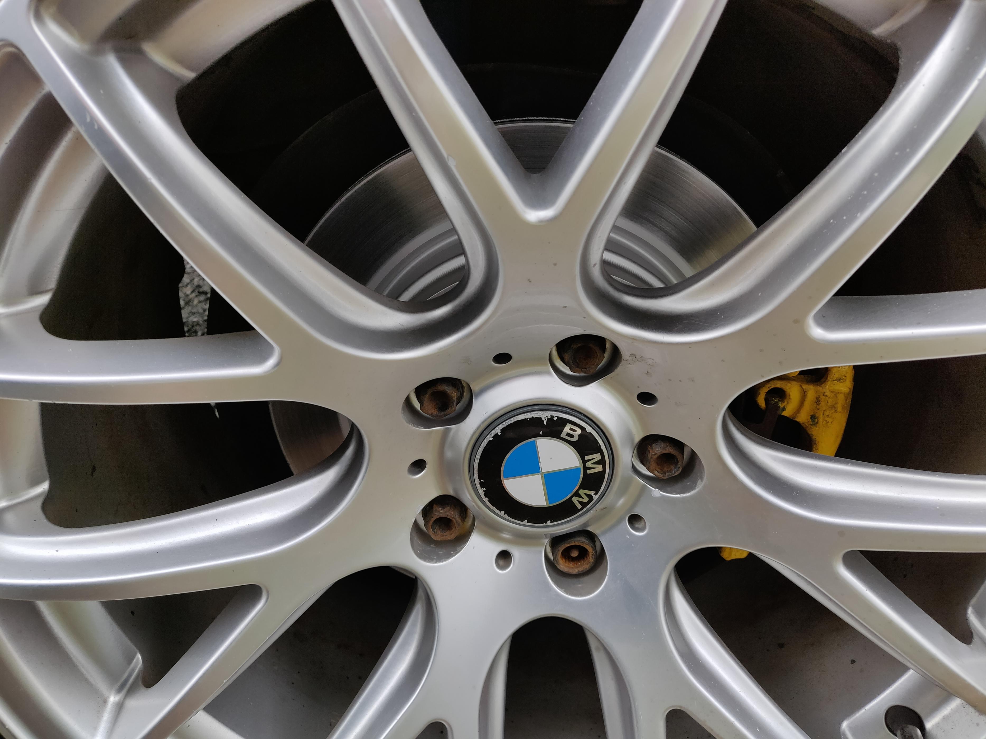

Refurbrished my rear calipers with sandblasting, paint and new seals and pistons two months ago. Yesterday I finally found time to replace the pads and rotors. After 1km driving the coated rotors looked like this. Not bad for a single piston caliper. 🙂
