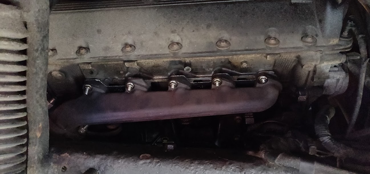

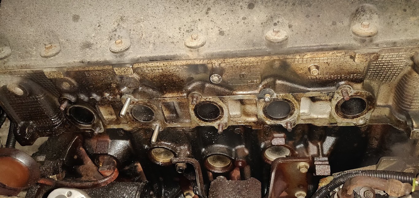

Just finished one of the worst jobs I've done on a car.
I was asked to help replacing a couple of broken exhaust manifold studs on a Ford V10 engine. 5 of the studs were snapped before I started. I had to snap the remaining 5 to remove the manifold.
Here's how it looked like after drilling out two bolts.
I used this kit to help center the bit and drill a pilot hole through the studs.
Great kit, but the supplied drill bits was worthless. I had to use HSS cobolt bits to get the job done.
I drilled all holes in steps 3.2mm - 5mm - 6mm - 7mm then re threaded the head with a m8x1.25 tap.
Here's the final result.
If someone outside my family asked me to do this job. I would refuse doing it for less then $2000. It was a real pain.

Thanks. 🙂wow. that is just crazy. good job.
How's your back after that?
Not too bad, a bit stiff but that was cured with some beers in the evening.
The engine was installed in an RV, so I did the whole job sitting on my knees inside the wheel well.
It felt amazing to stand up and stretch after sitting 8 hours in the wheel well.
I'm still young (turning 30 this year) so I'm still flexible enough for this kind of gymnastics. 😛
