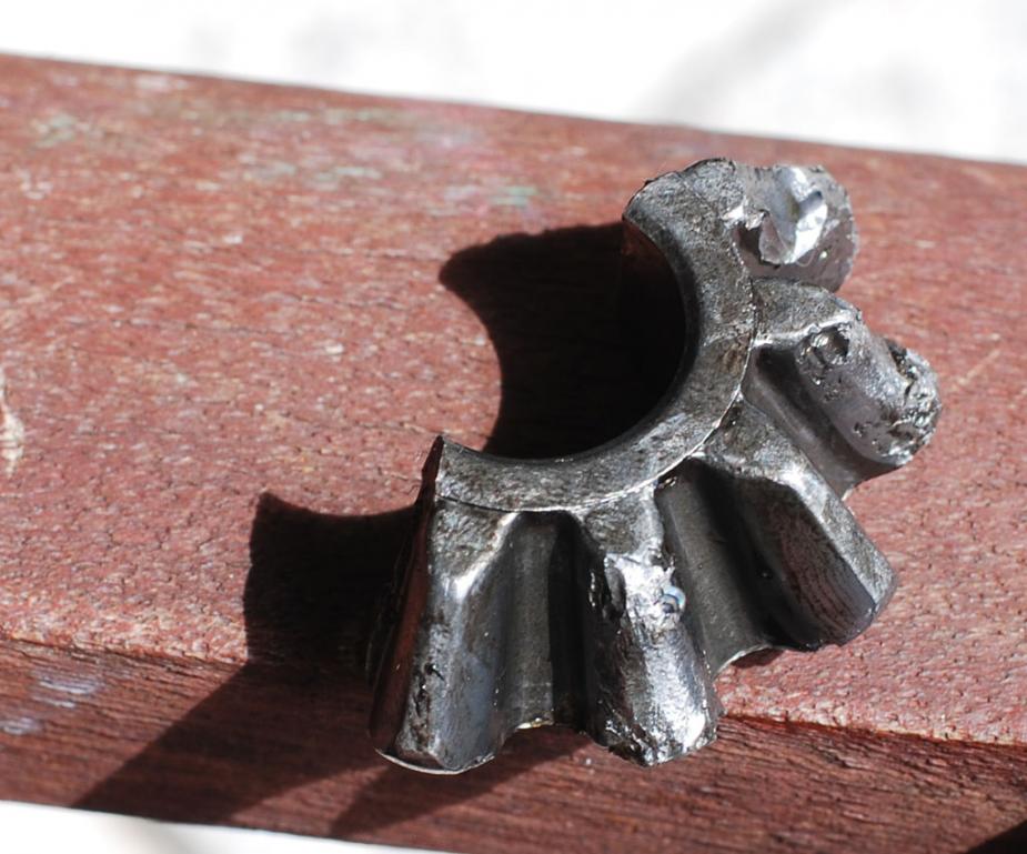

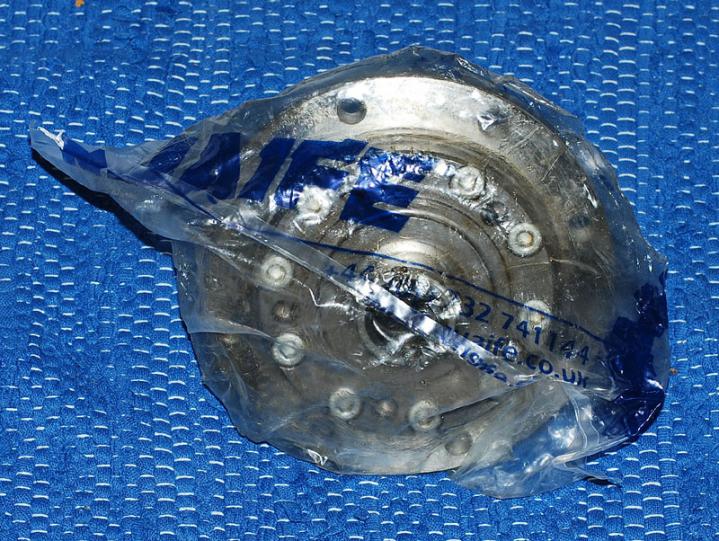

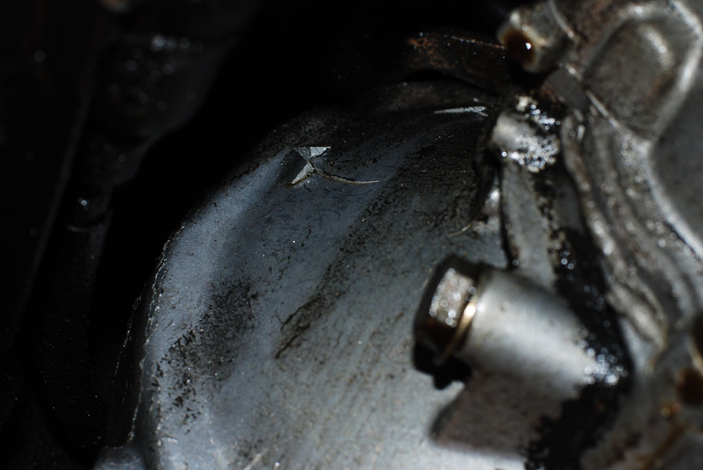

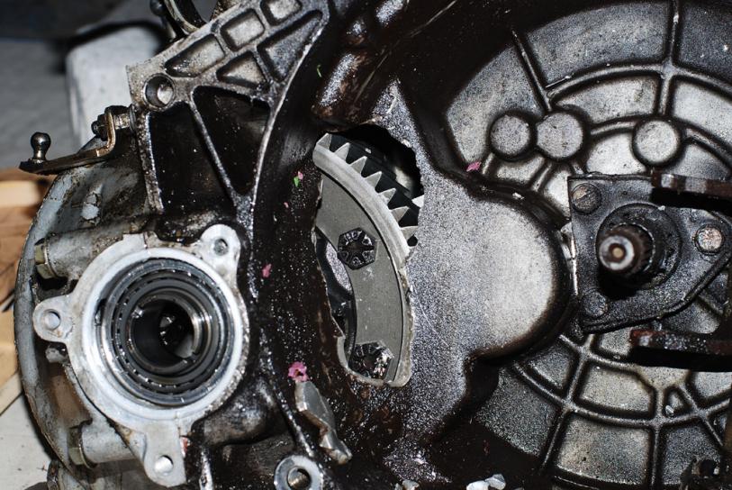

Quaif LSD's are not locking diffs, nor are they a clutch/plate style diff. Completely different animal which progressively transfers torque to the wheel with the most grip. Quaife ATB Limited Slip Differential - Quaife
They come with a lifetime warranty (for the original purchaser) as well. I put one in my 306 S16 when the original diff exploded.
Tony.
