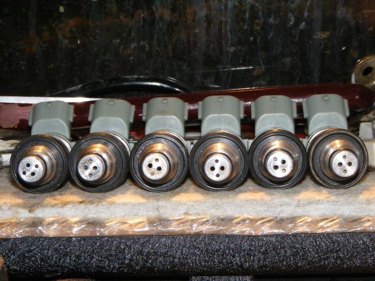

Anyway rant over. I received the aftermarket ho-mai-yum-cha fuel injectors and they are marked on the side as 23209-62030 which was the exact same part number that Toyota suggested to me when I gave them my VIN number, despite my car having 23250-62030, they are probably, 100% likely the exact same part.
However, the "refurbished" fuel injectors that I received have most of the metal pintle caps misaligned, which was disappointing and it means that I cannot use them, one of the fuel injectors also had one of the O rings missing.
So I'm going to keep them in the spare parts bin and keep ahold of them and never use them until such time as I'm desperate enough to want to be using these things in my car and I'm going to get the original pulled fuel injectors properly cleaned in an ultrasonic cleaner that I'm going to buy off ebay for $30 and I'll put my own new o-rings onto them.
I'll mock up some kind of system where I can fire the fuel injectors when they are in the ultrasonic cleaner bath, 2 at once or depending on how many I can fit in a small 455mL ultrasonic cleaner.
Call me snobbish if you want but I believe my pintle caps should be aligned properly and fire the fuel into the cylinder and past the valves instead of on the side of the intake wall. If they can't align a pintle cap with the body of the injector then what else have they mucked up.
On one injector they also appear to have drilled the holes a bit bigger? not sure what is going on there.

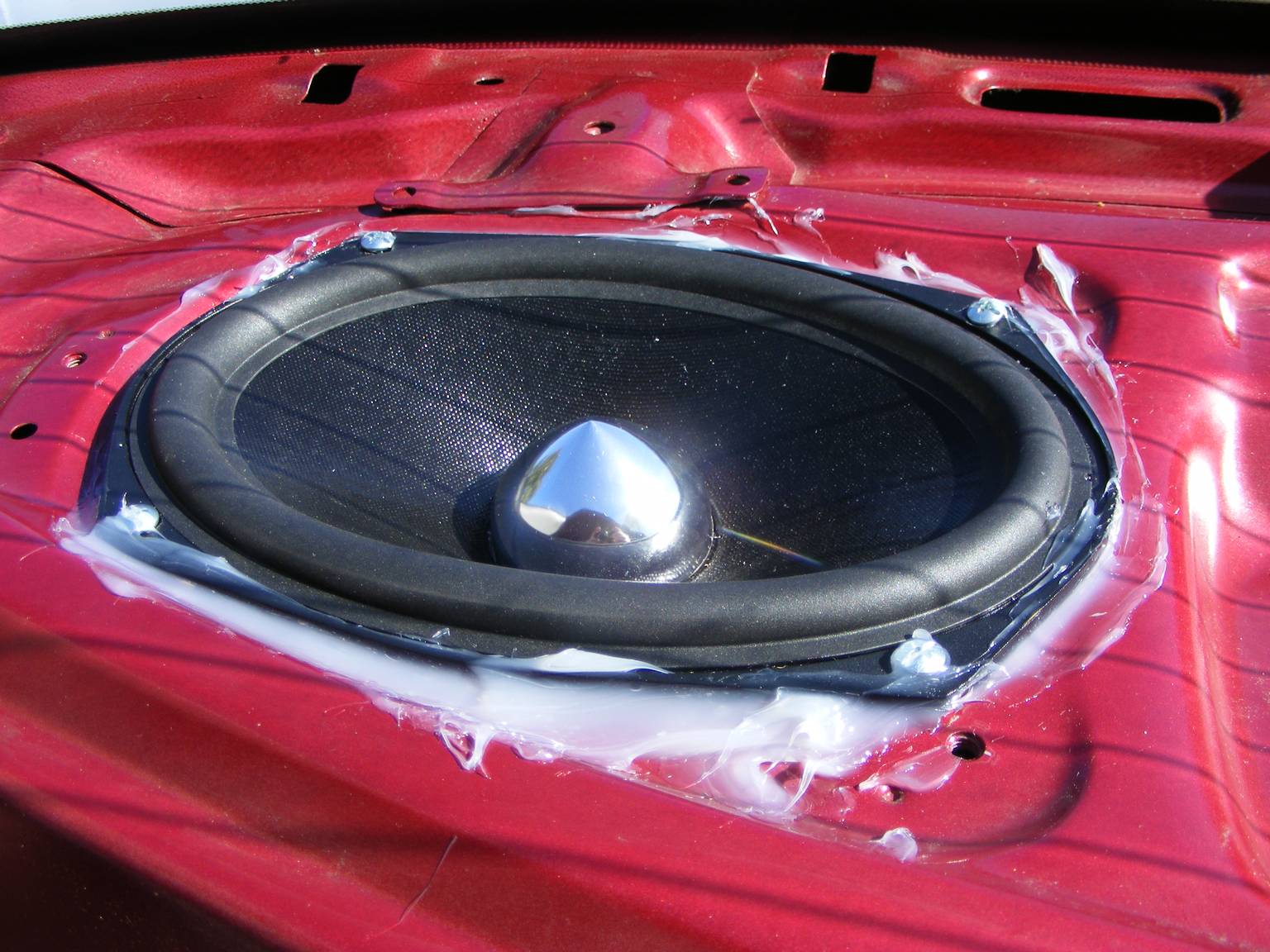

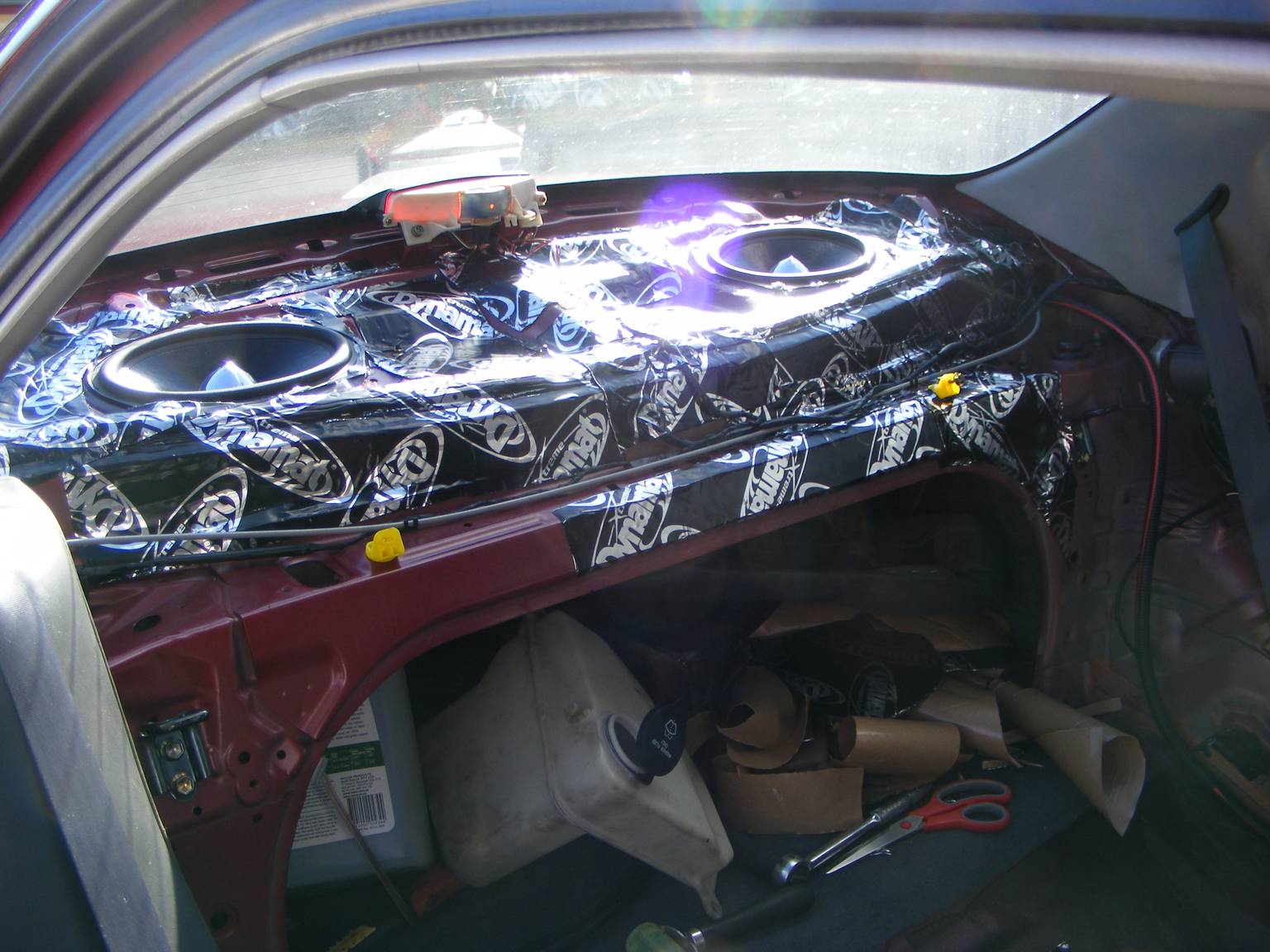

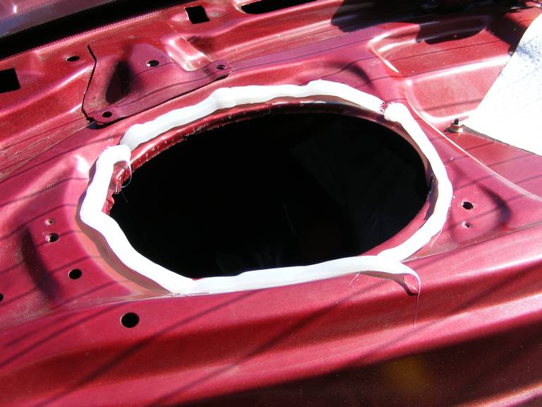

Put one of the Rockville RVL69W's into the rear parcel shelf.
It was very easy, once I figured out what I was going to do all I had to do was get a pair of large blunt nose pliers and bend the sheet metal of the rear parcel shelf out of the way of the basket of the speakers, I was thinking that I had to cut the metal up but that isn't the case at all. All you have to do is bend it out of the way.
I then used silicone to seal the speaker basket up against the metal frame. I then used some 10Gx19mm sheet metal screws to securely mount the speaker to the chassis of the car. They ain't going anywhere.

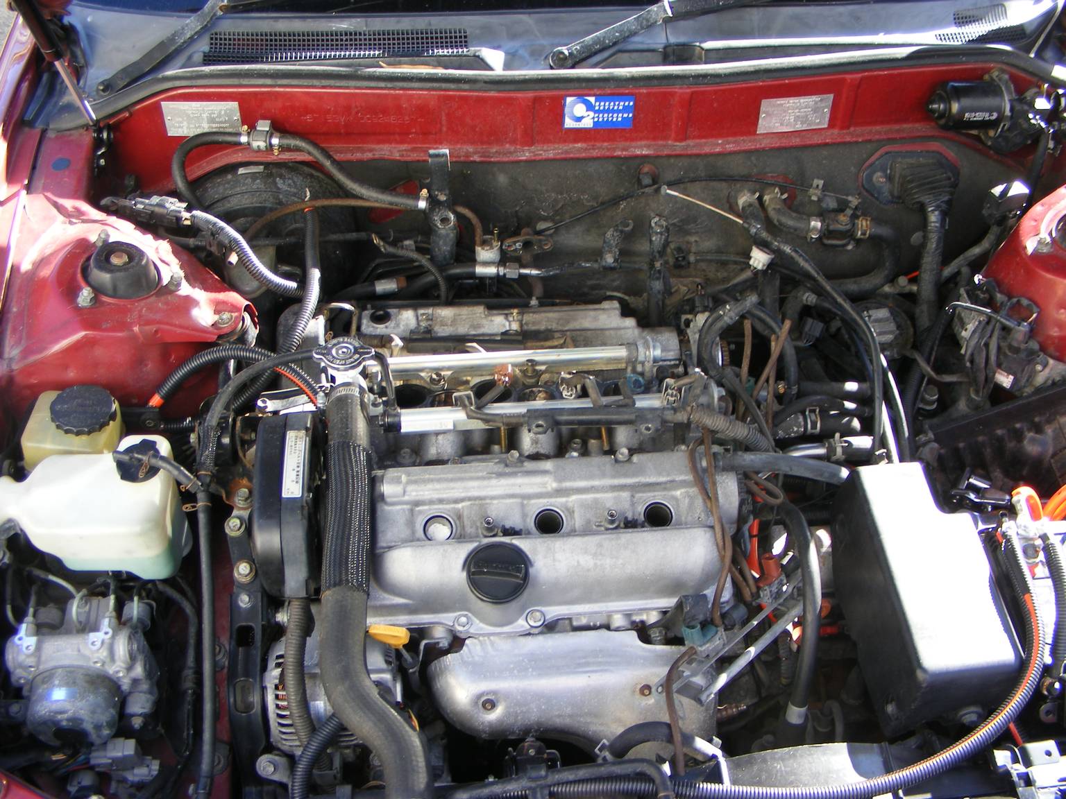

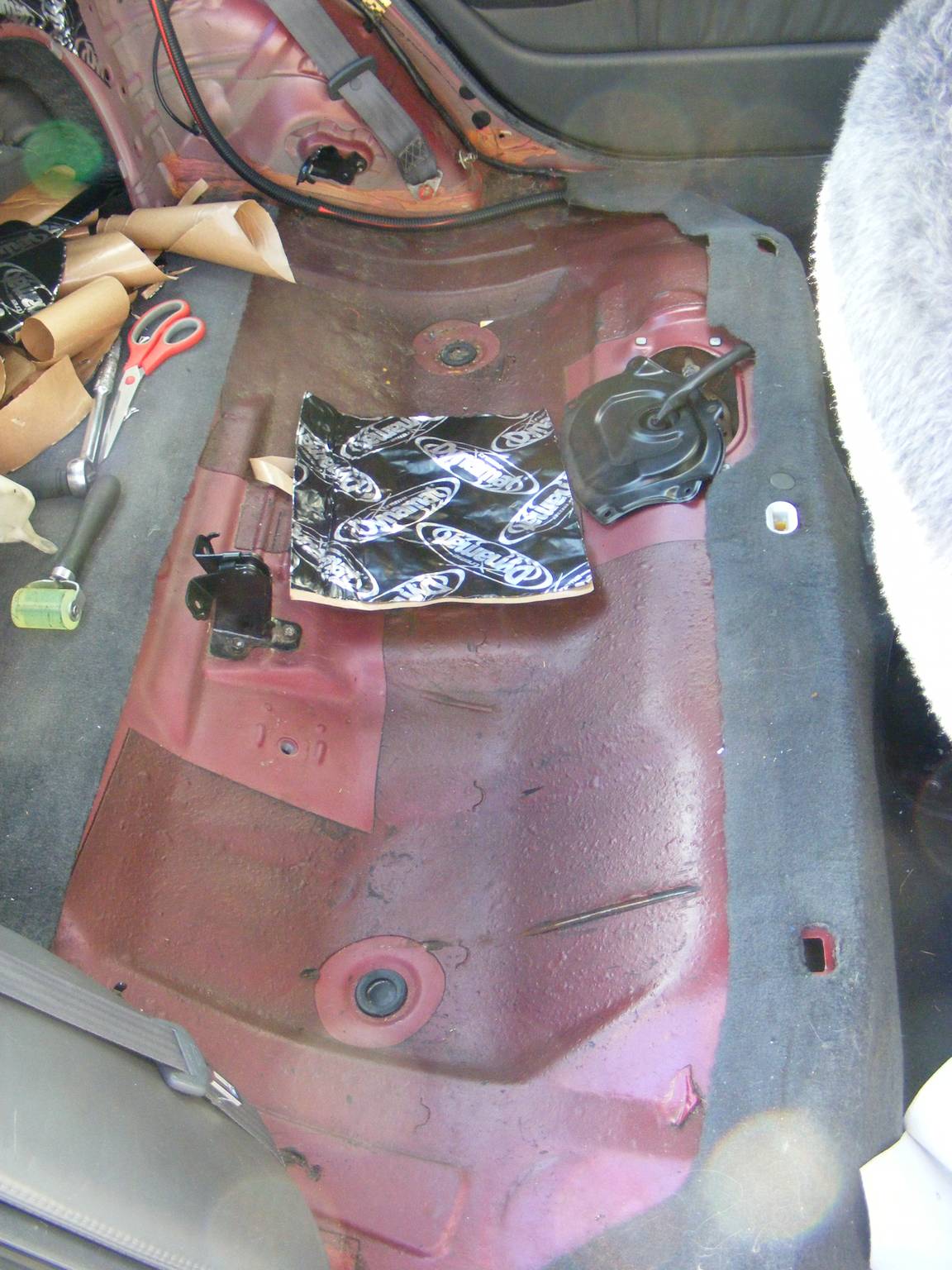

I've bought a few things to get my car buttoned back up and on the road:
1x Floureon ultrasonic cleaner 400mL for cleaning my fuel injectors
1x fuel injector service kit for my injectors: FUEL INJECTOR SERVICE KIT FITS TOYOTA CAMRY VCV10 3VZFE 3.0L 6 91-96 INJECTORS | eBay
1x EAGLE IGNITION LEADS - for Toyota Vienta 3.0L V6 (3VZ-FE engine) VCV10R | eBay

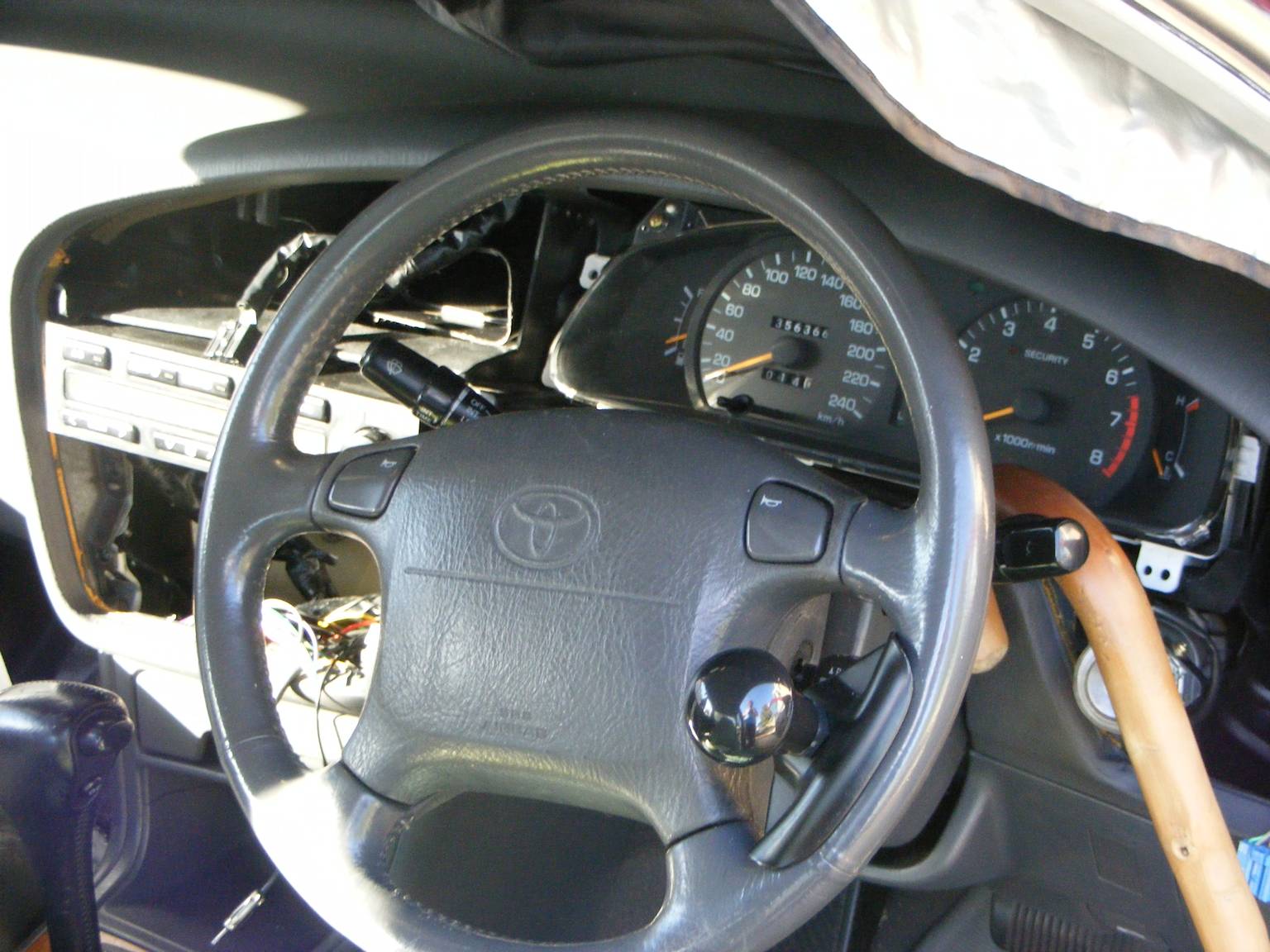

I've been cleaning the engine bay with engine and bilge degreaser which has unfortunately left some corrosion but its not difficult at all to remove it with a wire brush which I'll be getting onto tomorrow.
I've also been working on the dash and replacing the bulbs (again) with newer different designed (Cob style this time) T5 and T10 LED globes. I'm still waiting on the T5's to arrive.

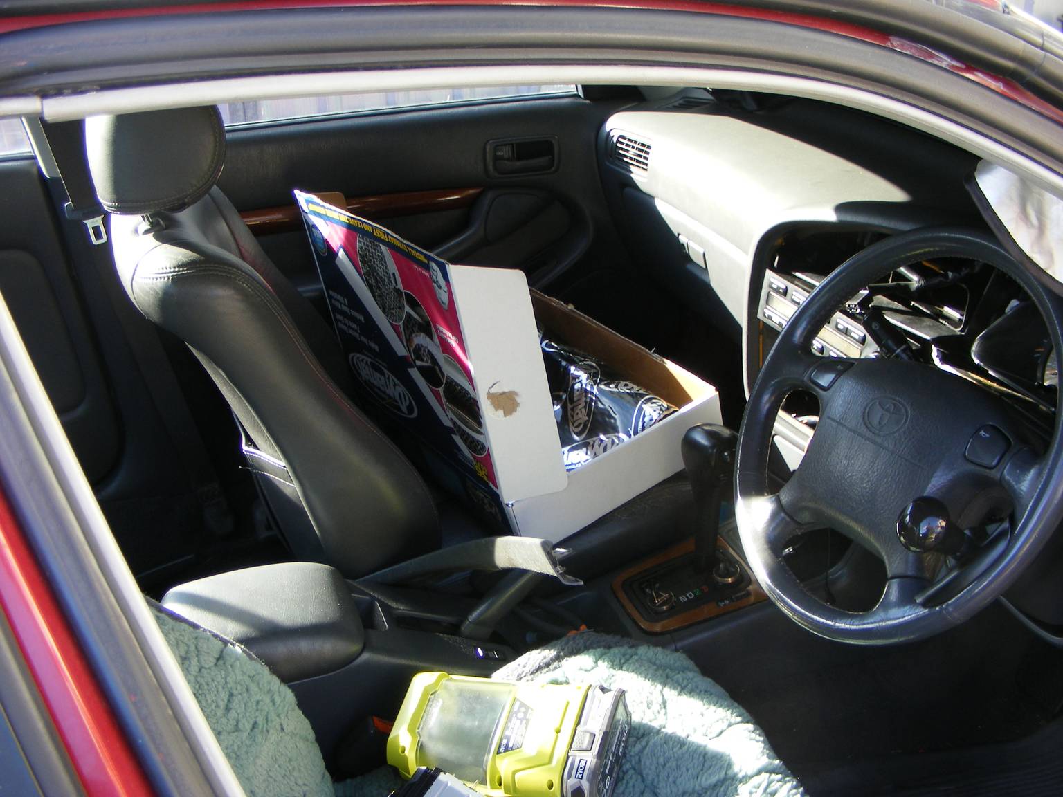

I've also been covering the rear parcel shelf with strips of Dynamat xtreme, for what its worth I want to be able to reduce the sound coming out of the boot and encroaching into the cabin as much as possible so that I can enjoy my music more. Also the strut towers are both on the left and right sides which means they could potentially add a lot of road noise into the cabin if I don't cover them.
I have already covered the C pillars near the rear doors with dynamat aswell just in case road noise decides to echo up through that chamber and into the cabin.
Pictures say a thousand words so I've attached a couple, while I wait for the ultrasonic cleaner and fuel injector service kit to arrive I've got the car in a thousand parts strewn all over the place.
Next payday I'll go over to Toyota and buy a genuine distributor cap and rotor to go onto the distributor.
