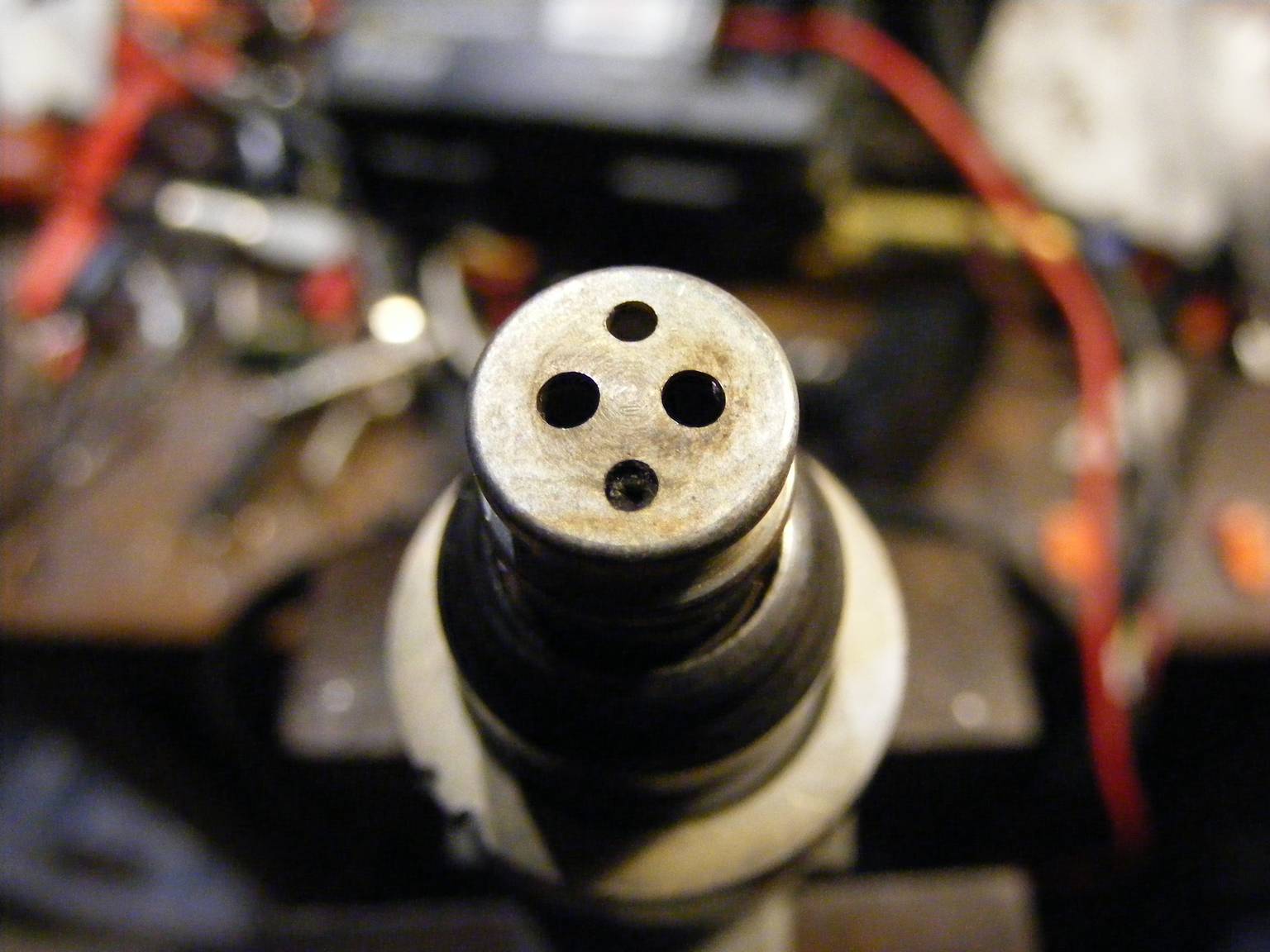

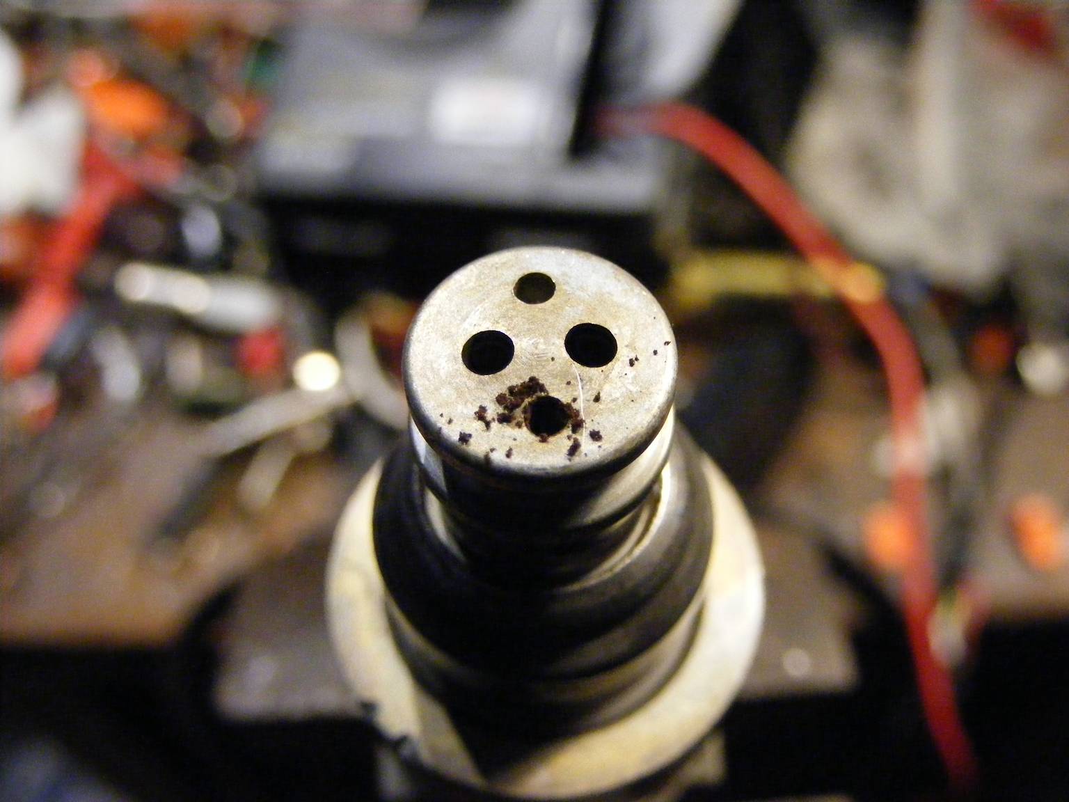

Well I've finished my review of the 400mL Floureon ultrasonic cleaner.
It is completely worthless for cleaning car parts. The cavitation action of the "ultrasonic" cleaner is so weak that I cannot even get the dirt buildup out of the pintle caps of my fuel injectors even with the fuel injectors resting the pintle caps directly onto the base of the ultrasonic cleaner tank where the transducer is located.
I suspect that DIY cleaning of fuel injectors is actually a fools errand and I will be sending my fuel injectors off for professional cleaning.
I don't recommend that anybody else do it themselves because:
1) You need a powerful 2L or 3L ultrasonic cleaner that will stick around after you're done with it. $69.99
2) You don't have access to the professional cleaning solutions which are used in cleaning fuel injectors, which is half of the battle when it comes to cleaning fuel injectors. $$
3) You need to do before and after flow rate tests on fuel injectors to confirm that you have indeed cleaned the inside of the fuel injector, this is not possible at home without yet another piece of equipment that you must build yourself. All of this equipment does take up a LOT of room. $$$
4) You need to buy an EM276 fuel injector pulse generator. $42.88
Total cost is well over $120.
Also. I just got a few quotes for fuel injector cleaning for six fuel injectors:
Bursons: $350
My local mechanic: $120
I will be going the route of my regular mechanic to get these cleaned and probably using this ultrasonic cleaner for some other minor tasks.
As an example, I've attached some pictures showing before and after pictures and after a simple prick cleaning with a needle. All pictures are the same fuel injector.
First pic is before ultrasonic cleaning.
Second pic is after ultrasonic cleaning for 15 minutes.
Third pic is after a prick cleaning and after the ultrasonic cleaning.
Needless to say this ultrasonic cleaner didn't even remove the mound of dirt located in a hole of the pintle cap, only a prick cleaning did the job.

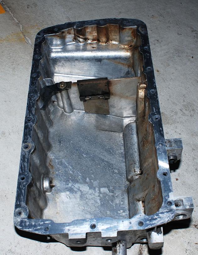

I never understood the reasoning behind using aluminium oil sumps. One crack or hit with a rock and its done for and leaking all over the ground. Unlike pressed steel aluminium will fracture afaik.
Can someone explain it to me?
I don't really know, but heat transfer may be part of the reason? I don't imagine weight would be a factor as aluminum sumps tend to be a lot thicker than pressed steel ones!
Tony.
Tony.
And one properly sized bolt covered in JB weld screwed in that hole along with a serious coating of the whole area in JB weld fixed that leak. Volvo wanted $300 for a new pan and it would require some serious disassembly to change it. The car ran for several years, after that repair, and was still fine when I sold it.
Cast aluminum does not flex like stamped steel. It is usually an integral part of the block "system" and all modeled up on a computer when the engine is designed.

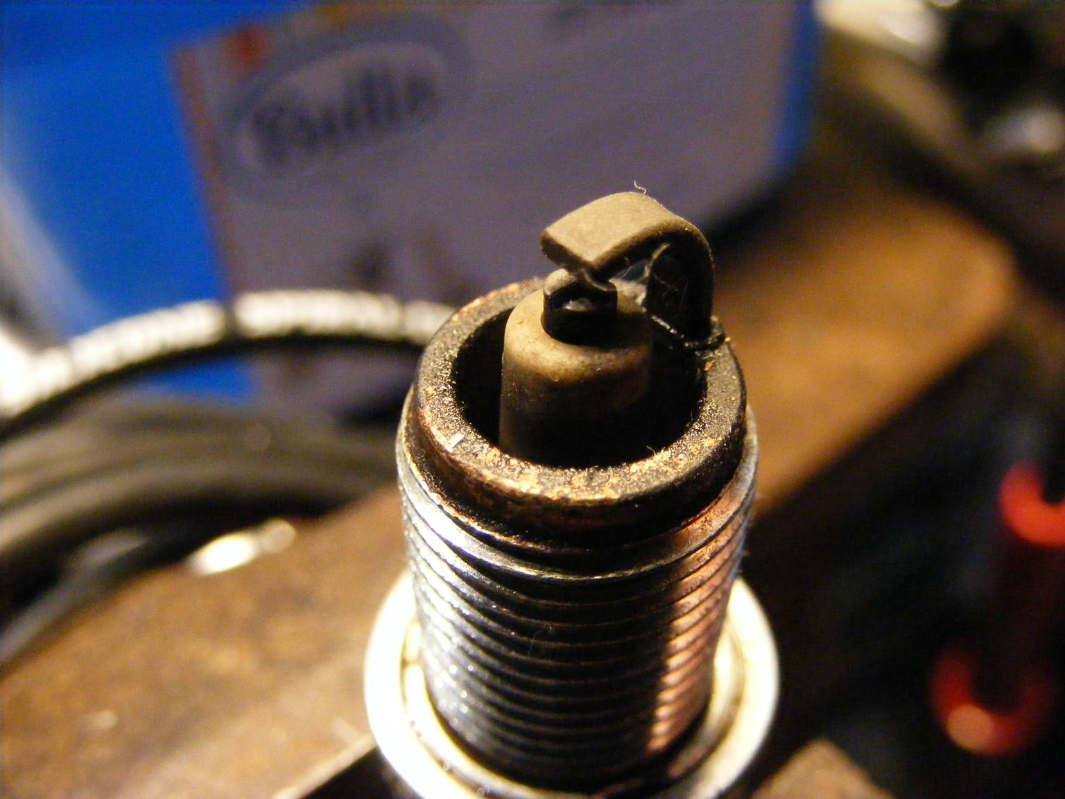

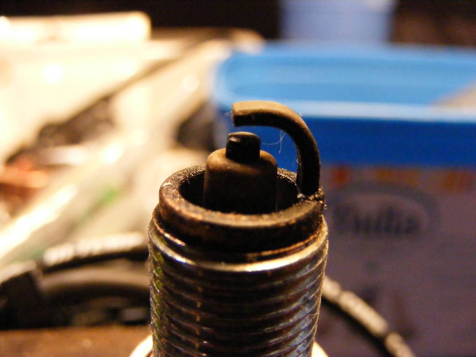

I've measured the ignition leads on my toyota v6 and the longest ignition lead at approx 1m was 12k ohms! I've measured another ignition lead too, the one coming from the coil to the distributor center pins, the old one measured at 6.32k ohm and the new one measured at 408 ohms or 0.40k ohm. A significant difference. I suspect that the old ignition leads have increased in resistance over time, they are as old as the car is, dated 1997.
I've also removed the number 6 spark plug (from the front furthest right cylinder nearest to the battery.) and inspected it, there is a bit of carbon buildup on the spark plug despite them being almost brand new. After watching this video: YouTube I think its being caused by either a set of worn ignition leads or worn ignition coil or both.
I've already bought new ignition leads and I've inspected them for build quality, Eagle Australia appears to have done a good job in regards to build quality. There is sufficient coverage of the spark plugs when inserted into the boots to prevent any sort of arcing and the insertion of the spark plug into the spark plug tube is sufficiently tight that excellent pulling of the top of the boot is made against the top of the tappet cover to prevent water ingress into the spark plug tubes.
The male plugs when inserted in the distributor cap do provide a sufficient amount of length to make contact however I would have preffered that they were the exact OEM length, they are slightly shorter at 1mm or 2mm shorter, But its not significant and I doubt it will make much if any difference to the performance of the leads.
I've found that they should provide a good replacement/substitute for the OEM leads which I am replacing.
Tony.
I would agree.
Pics from 60's-80's Alfa Romeo 2-liter 4-cyl. 7 quarts of oil in a large, flat, finned pan were definitely employed to keep oil temp down.
As far as cast aluminum durability goes, mine has survived 43 years.

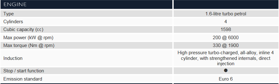

Good grief check out the outputs of these Alfa engines:
Australian specs for Alfa Romeo Giulia lineup announced | PerformanceDrive
Alfa Romeo Giulia (952) - Wikipedia
2.0-litre turbocharged four-cylinder engine (147kW/330Nm)
206kW/400Nm 2.0-litre turbocharged four-cylinder offered in the Giulia Veloce. With a 0-100km/h sprint of 5.8 seconds, it manages a fairly economical 6.1L/100km combined cycle.
The Quadrifoglio’s 2.9-litre twin-turbocharged V6 produces 375kW/600Nm, taking it from 0-100km/h in just 3.9 seconds, and on to a top speed of 307km/h.

I'm more concerned about its power and torque curves wintermute. If the majority of the power comes out of the engine at only the high end and the engine remains at <100hp below 4000 rpm then what is the point. And what is the point of stating that it has 300> nm of torque when all of that torque is at the top end...
