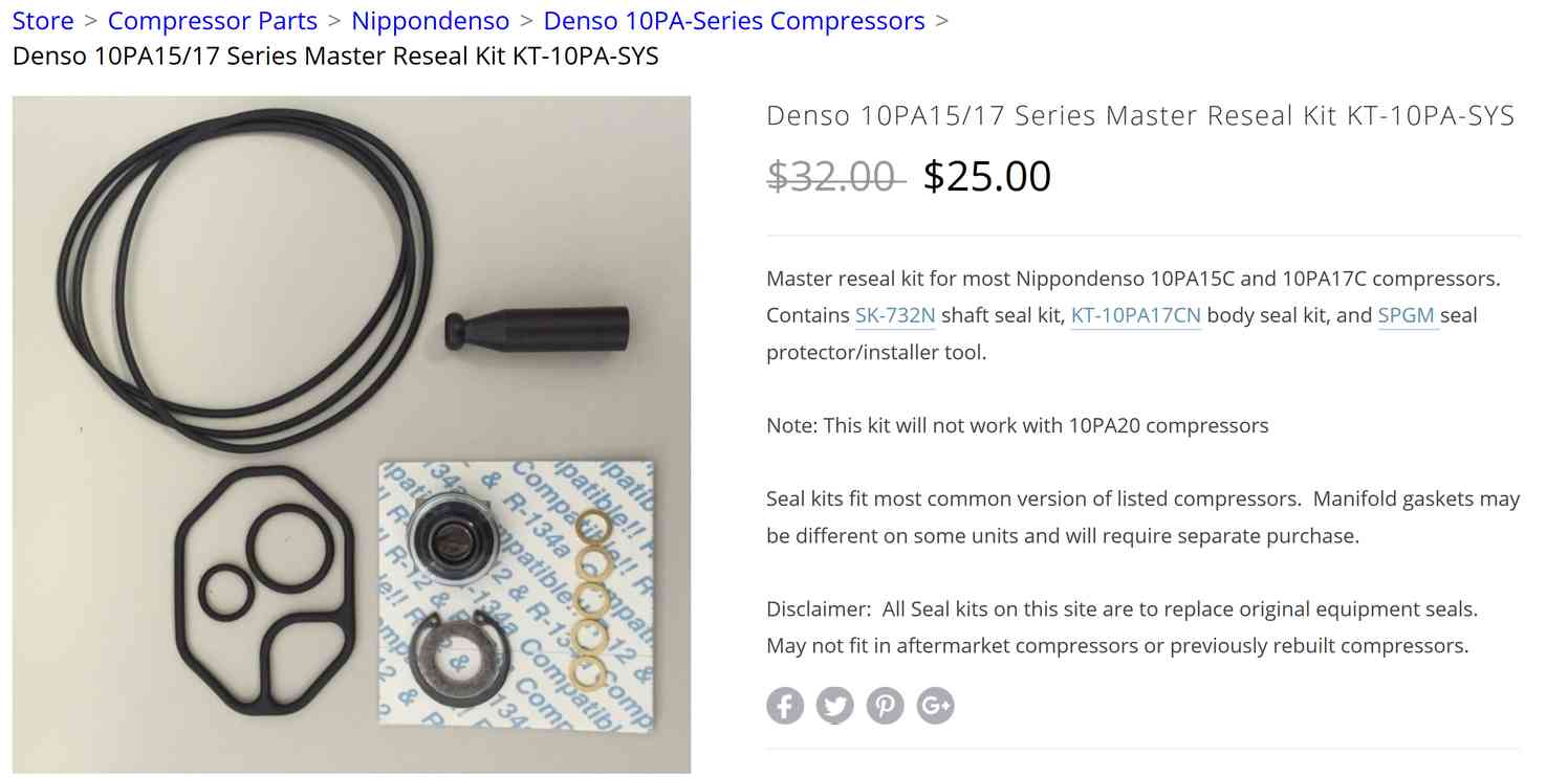

I found out some information about my VCV10/VDV10 1993-1997 Toyota Camry air compressor.
Apparently it uses a Denso 10PA "Series" 17C A/C compressor which a "master reseal kit" are available for it from this website: Denso 10PA15/17 Series Master Reseal Kit KT-10PA-SYS

Rebuilding the A/C compressor is really easy by the looks of it, just need to take some TLC with the O-Rings and coat them in mineral oil before reassembly and to drain the compressor of fluids and the thread holes of fluids so that it doesn't punch a hole through the back of the soft aluminum body when the bolts are torqued down.

I've sent the six fuel injectors in for cleaning today with my regular mechanic. Its going to cost me $120 AUD and I can pick them up tomorrow.
This payday is super tight so I'm really just waiting for next fortnight to start to put things back together. I've only ordered the Denso 10PA17C reseal kit from the USA via Century Auto Air: Featured Products It cost me $25 USD for postage! arrg, for just some rubber seals. arrgg. and $25 USD for the seal kit. arggg. Oh well. $69 AUD all up. Can't complain when you can't get it anywhere else.
I'm going to need to source some 525 viscosity mineral oil (apparently this viscosity is the best for car aircon O-rings, DO NOT use the compressor oil!) Why 525 viscosity mineral oil on O-rings? - Automotive Air Conditioning Information Forum
So this payday I've only really got the fuel injectors cleaned, $120 AUD. And ordered the Master reseal kit $69 AUD. I've done literally nothing else the budget is that tight. But I've gotta do these steps first so that I can put the A/C Compressor back in where it belongs and put the fuel injectors back in where that belongs so that I don't have to pull it apart again and take it out later on.
I also ordered an assortment of nitrile rubber O-rings from HK for $6 AUD: 225 PC R22 R134a CAR AIR CONDITIONING HNBR O RING SEAL ASSORTMENT SET X8Q7 Q2O2 192090060498 | eBay
Now I've gotta find someone online or in store who will sell me some 525 viscosity mineral oil so I can coat the O-Rings and do all of the O-rings on the A/C system and get it all ready for reassembly later on. then my shopping is done for this fortnight.
Next payday/fortnight I will be buying the A/C Receiver drier and a new condenser. I'll probably be putting my A/C clutch and bearing back on the compressor as they appear to be fine and more than servicable.
