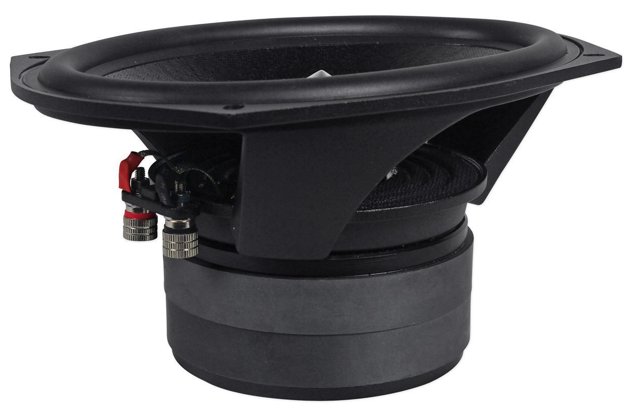

(2) Rockville RVL69W 6x9" 600w Cast Aluminum Car Subwoofers Sub Woofers | eBay
These are the speakers which I'm going to be putting into the car instead of a dedicated subwoofer. Rockville RVL69W speakers.
150 watts RMS each, should make me happy. I will power them with a Pioneer GM-A5702 (150w RMS x2) mounted in the boot (somewhere, not sure where just yet). As a pair of stereo channels, so technically I will have stereo bass and midbass support from the rear.
That way my existing Pioneer GM-A3702 amplifier can power the two front speakers in the door at 60 watts RMS per channel, and if I can get myself a crossover for midrange I can add the SL713 drivers into the mix along with some tweeters on the dash for high frequency support.

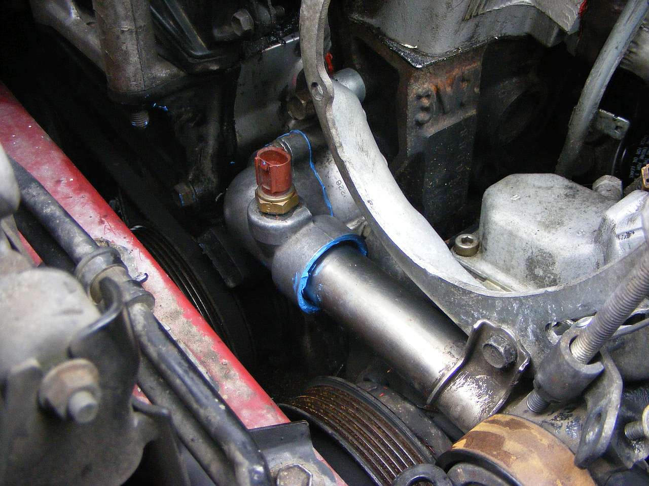

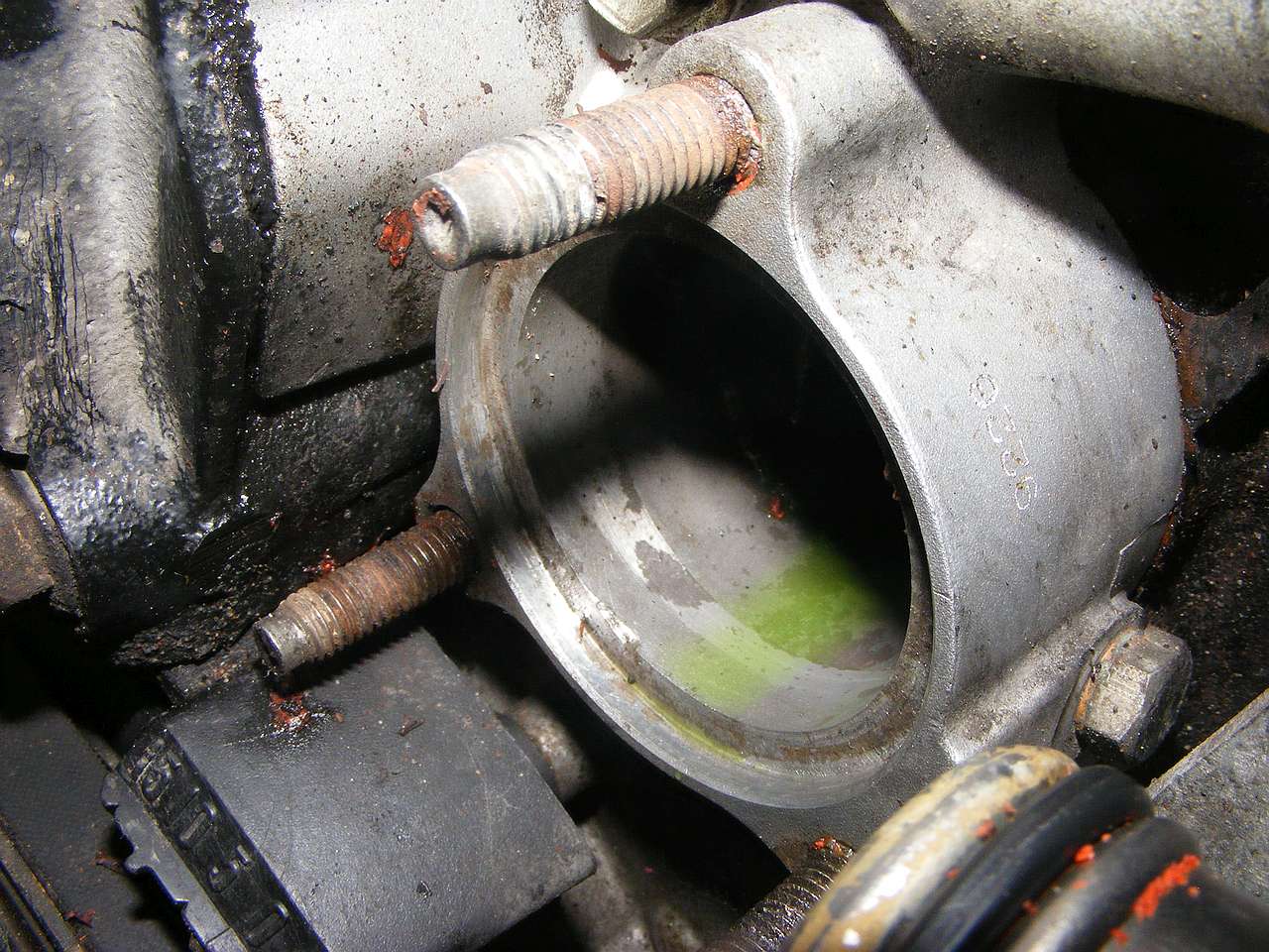

I pulled apart the car today and removed the old thermostat housing and thermostat. which was butchered by the previous owner, he had cut off the spring mechanism and left only the ring in place, I know this because there are cut marks of some cutters on the edges.
My thinking here is that the previous owner was on the incorrect assumption that the head gaskets were done however when I got the car it was only leaking from the tappet cover gaskets as far as I could see.
As soon as I've completed the installation of the new thermostat and cleaned everything up with some new permatex permaseal and start the car it will pressurise the water cooling system and I will be able to check for any smoke from the rear tailpipe.
I'm not expecting any, this car has never given me the typical signs of a headgasket failure, which was the primary reason why I bought it, I made a thorough and well informed inspection when buying it.
I'm hoping that the previous owner was going on the assumption that no thermostat = good which is the old way of thinking which seems to be prevalent around here, But he wouldn't have understood or known what a computerised engine is supposed to do or does whenever the temperature isn't adequate which is keep the injectors open for longer.
Anyway at least I've found why its not warming up as quickly as it should.

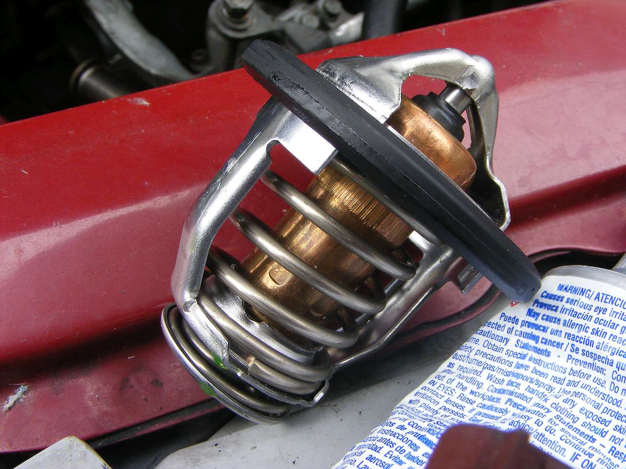

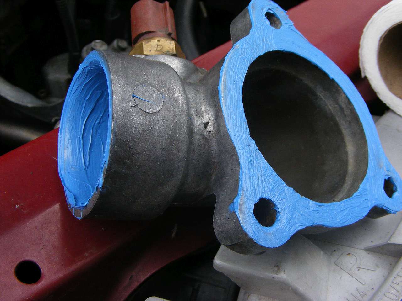

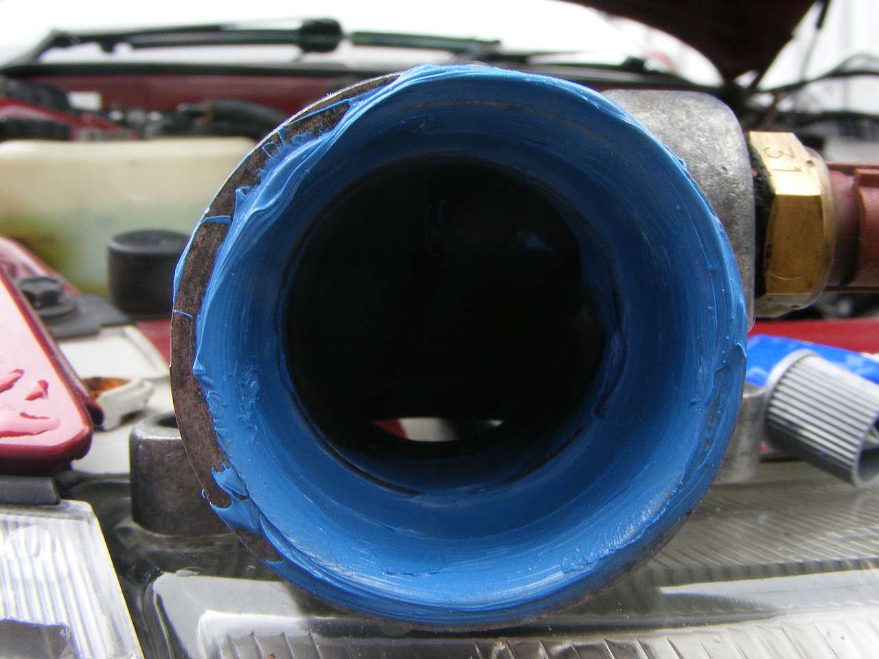

Finished the reinstallation of the thermostat today. Added a liberal but not excessive amount of Permatex Ultra Blue sealant to the mouth of the thermostat housing and the thermostat housing contact area on the water pump. Should hold up for another 20 years at least.
I will wait until tomorrow before I refill the cooling system with new coolant as I want the Permatex to dry. I rotated the thermostat so that the air bubble bleeder hole is at the very top.
An interesting footnote is that the thermostat opens at 82c.

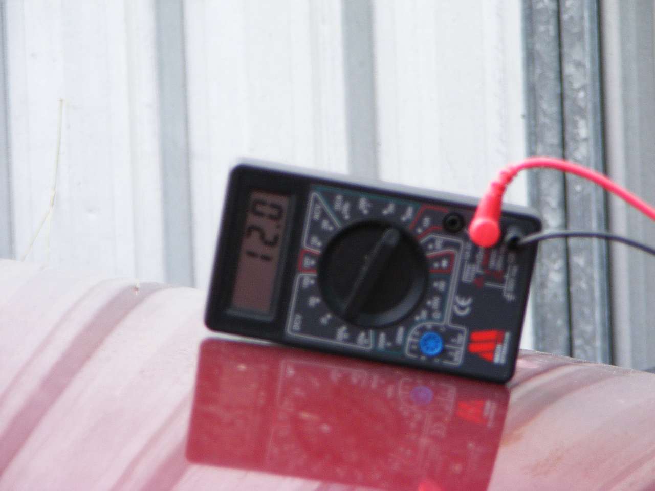

I just did a measurement of the alternator with only the alternator connected to the battery and nothing else except for the starter motor solenoid positive lead. My reading was 0.4mA which is almost half a milliamp. Exceedingly low.
It might be likely then that the alternator regulator is faulty in some way if there is indeed any fault at all. It could be that I have simply not had the car running for long enough to fully charge the battery.
However I had run the car for approx 30 minutes the other day and the alternator voltage dropped to approx 13.8v, then left it for 1 day before I disconnected the battery negative lead.
Either the battery wasn't fully charged, or the battery no longer has any capacity left so it therefore no longer has the ability to hold a charge, OR I haven't been charging it for long enough.
Or there is a parasitic load inside of the car somewhere, possibly the newly installed LED lights are not compatible and have a high amount of diode leakage.

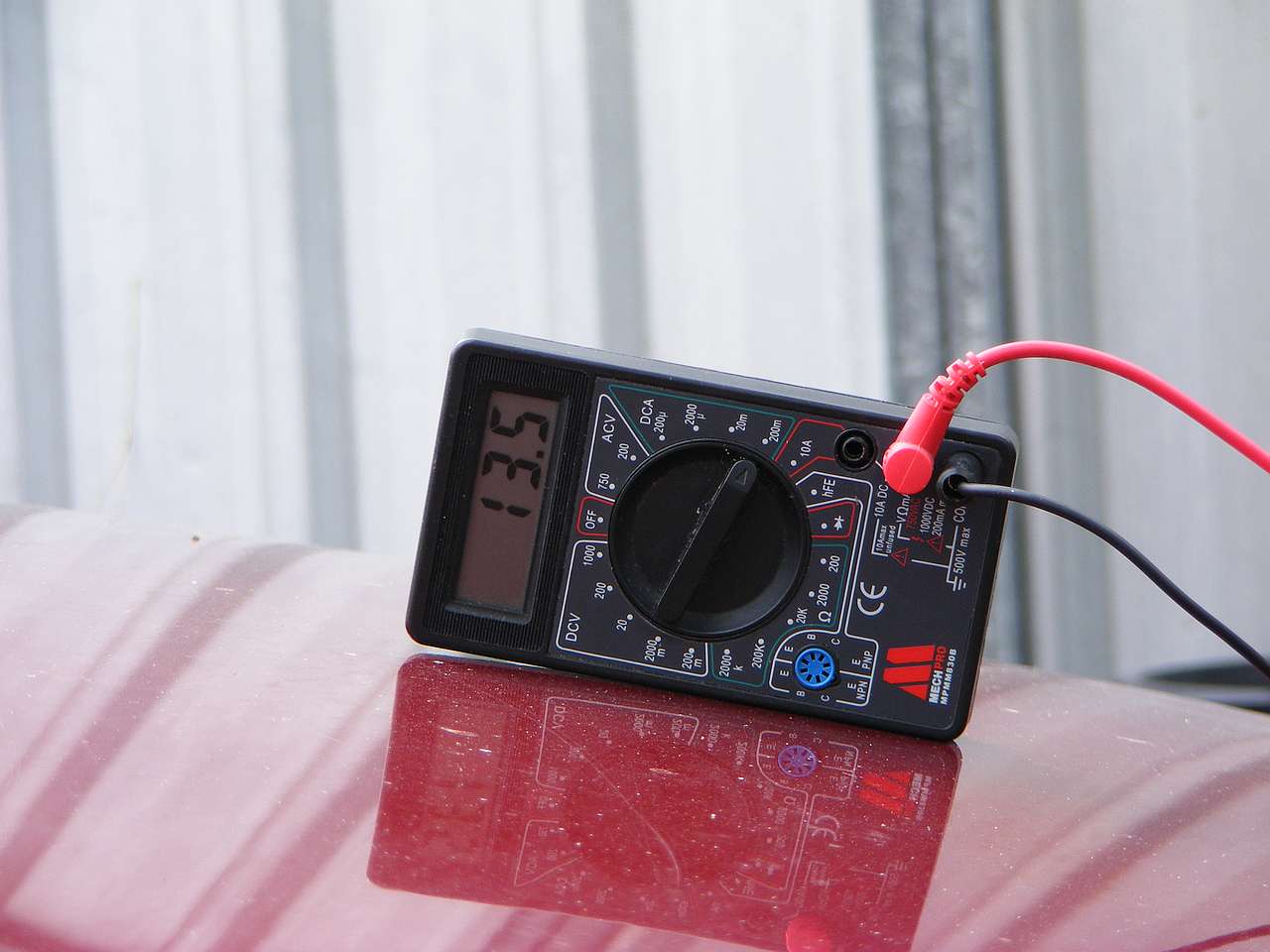

I discovered the "problem". There is no problem.
If there is then the problem is with me. The car's inbuilt factory alarm system was causing the error and it was keeping the computer awake for as long as I had the bonnet open. As soon as I decided to wait 2 minutes I made the descision to run the multimeter leads out of the car underneath the bonnet and close the bonnet and that is when I made the discovery that the computer actually isn't faulty but is operating normally.
As soon as I closed the bonnet the multimeter reading dropped to 13.5mA within approx 30 seconds.
I had the dash and clock unplugged at that point and I did some further tests which resulted in the clock drawing an additional 2.5mA which brought the total current draw up to 15.5mA.
I then disconnected the car radio and the car radio was drawing 1.5mA. With both the factory VFD clock and the sony car radio disconnected I managed to get the current draw down to 12.0mA.
All in all I've discovered some new things about my car and how it operates and also discovered that its electrical system is still in good shape.

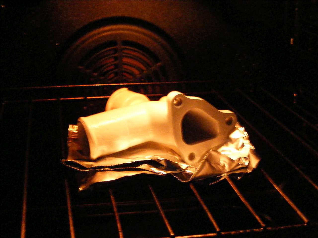

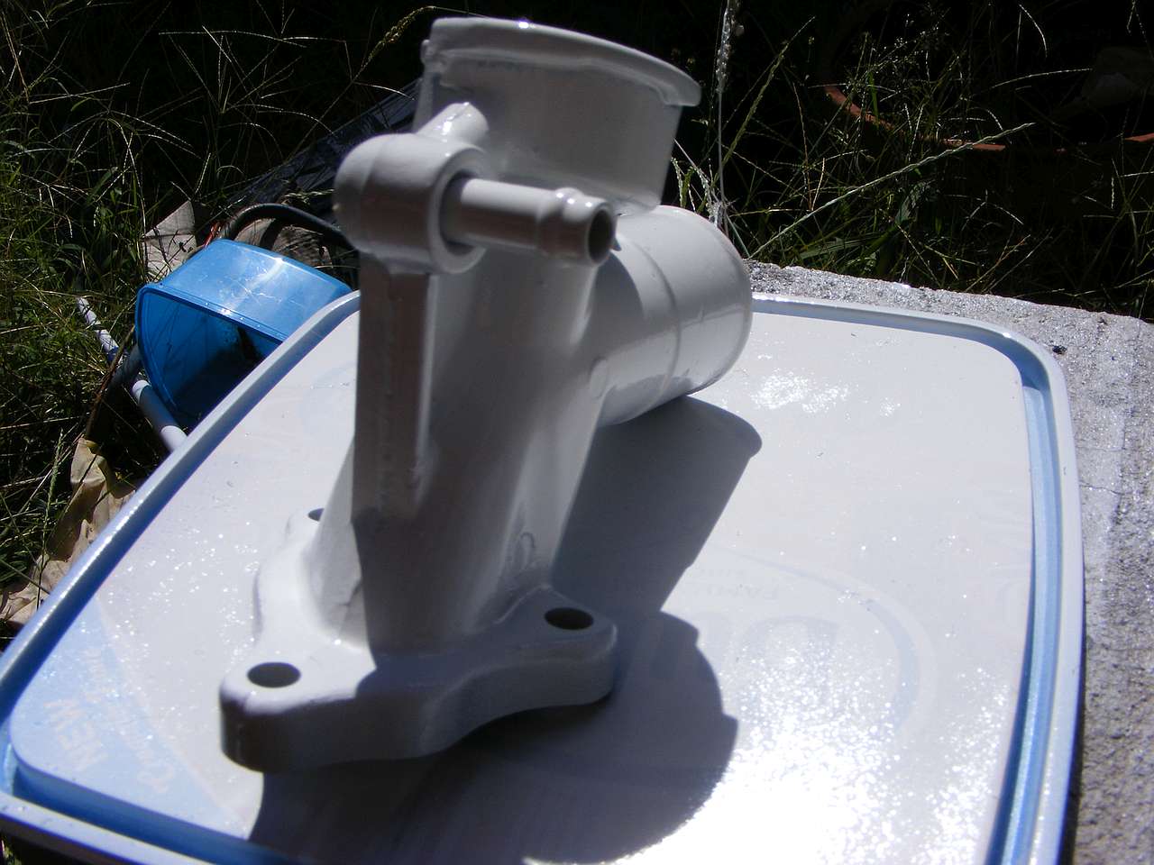

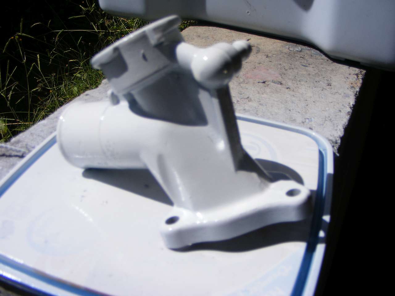

Pics below are of me spraying and baking some rust inhibiting paint on the aluminum water body which bolts ontop of the engine. I "baked" it in the kitchen oven with all of the windows open for 2 hours last night at 80-100 deg C. It seems to have done a good job of setting the paint.
This morning when I refilled the engine I noticed that the neck which plugs into the thermostat housing is leaking some water, however its going to be a pain to get to it so I'm going to leave it for today and revisit it maybe on monday or tuesday and really seal it up properly this time.

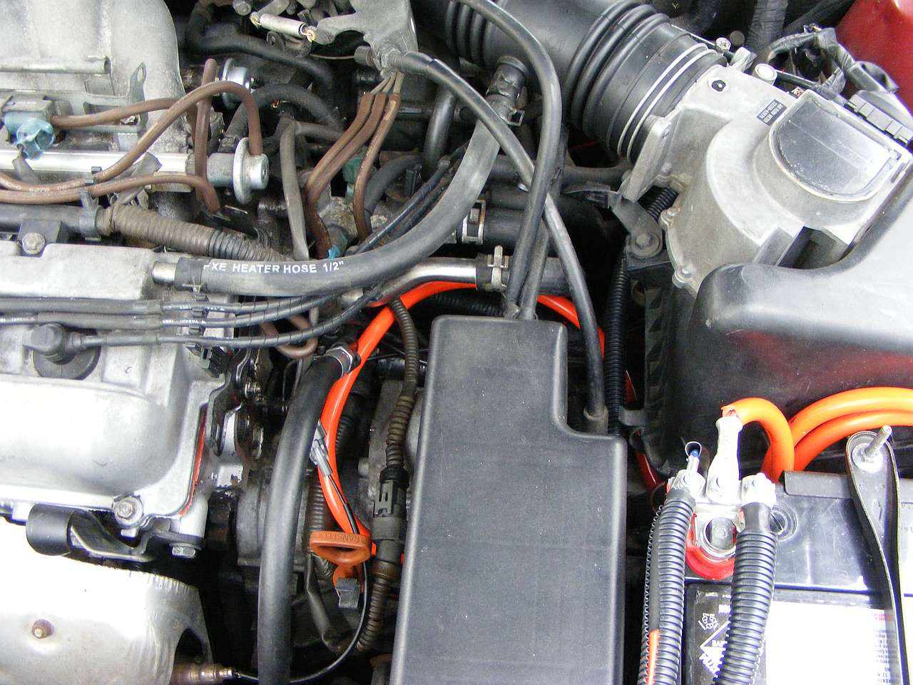

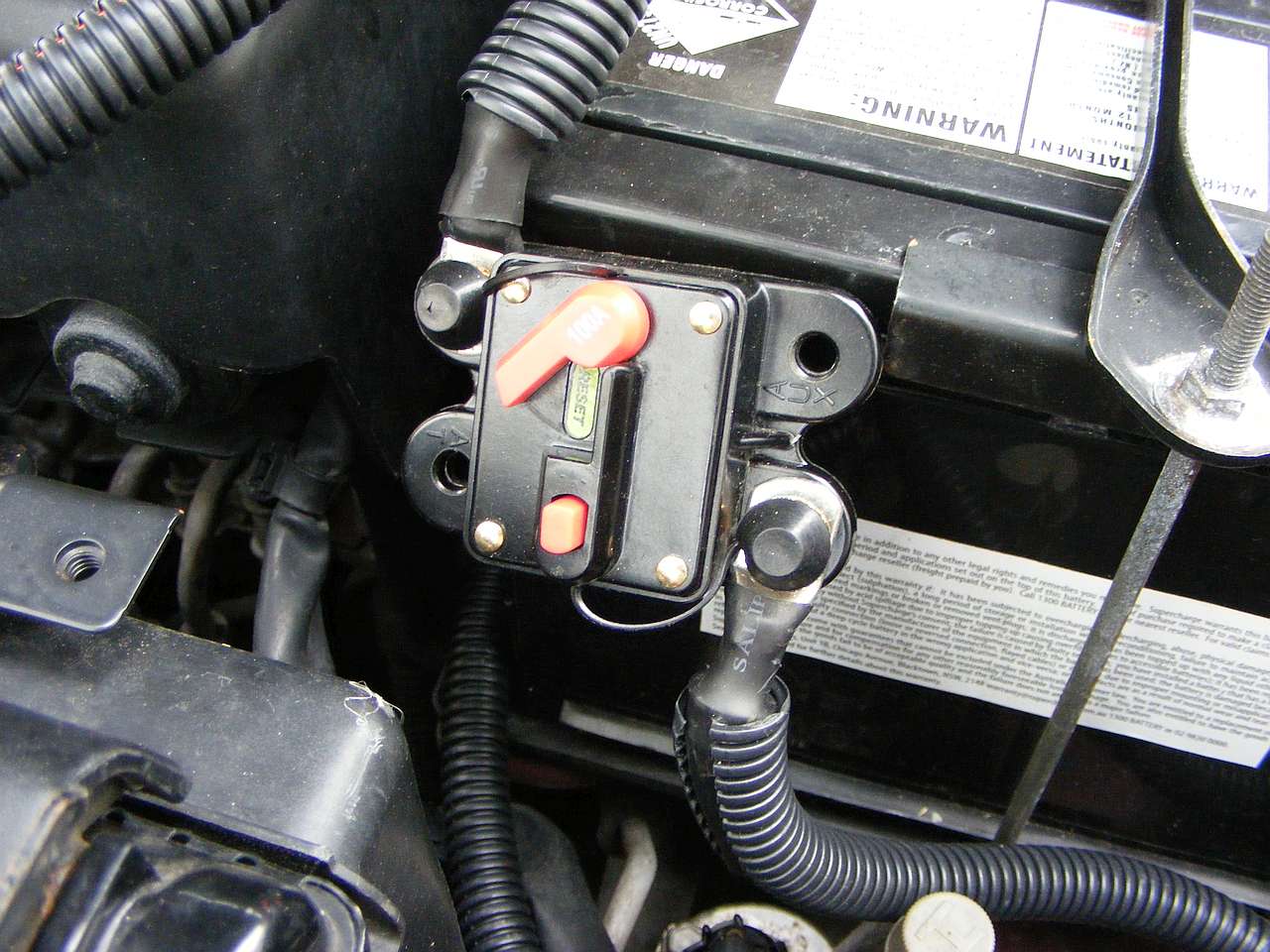

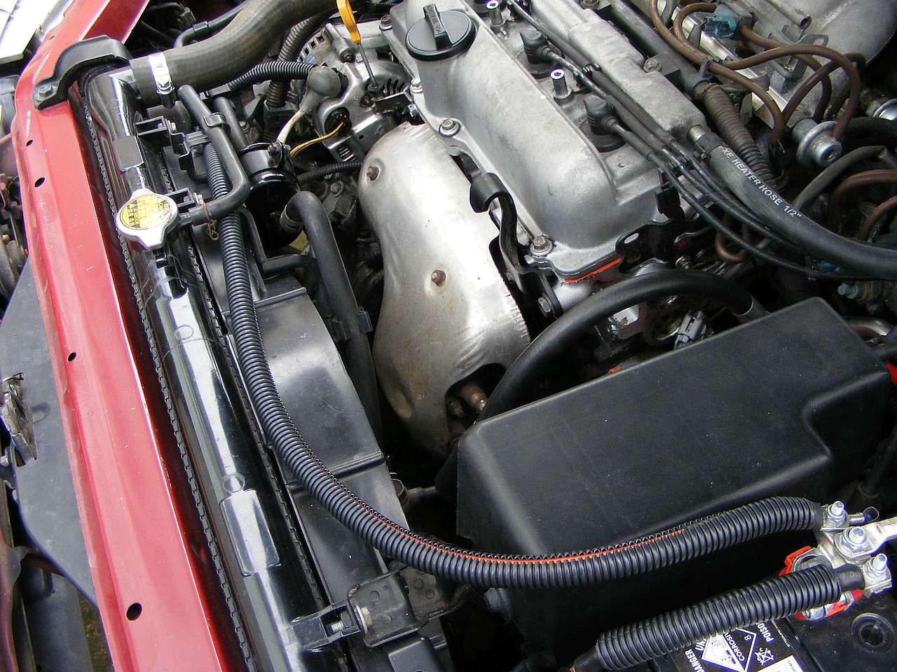

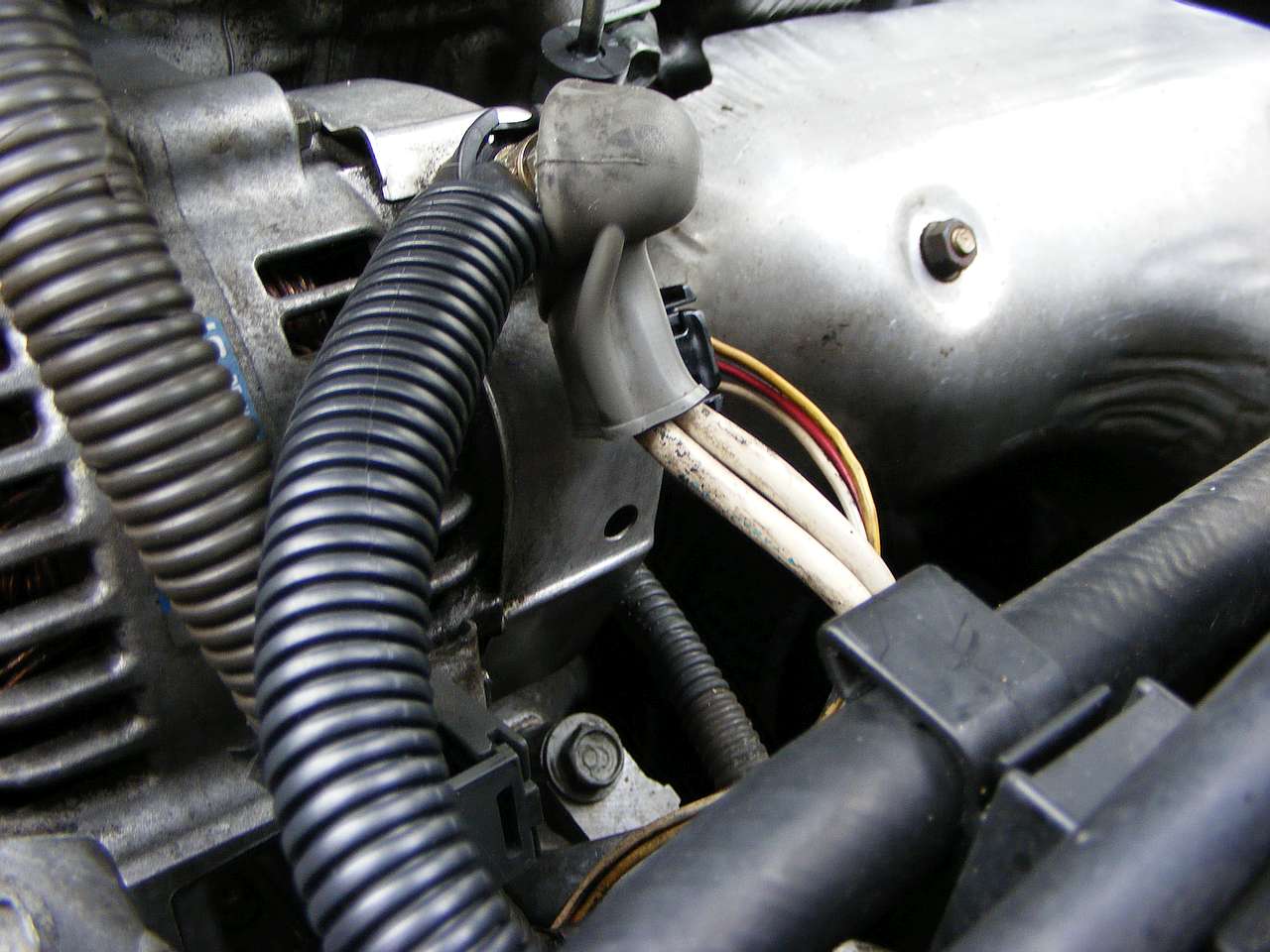

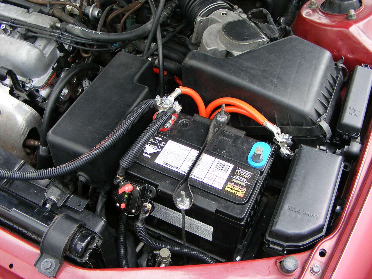

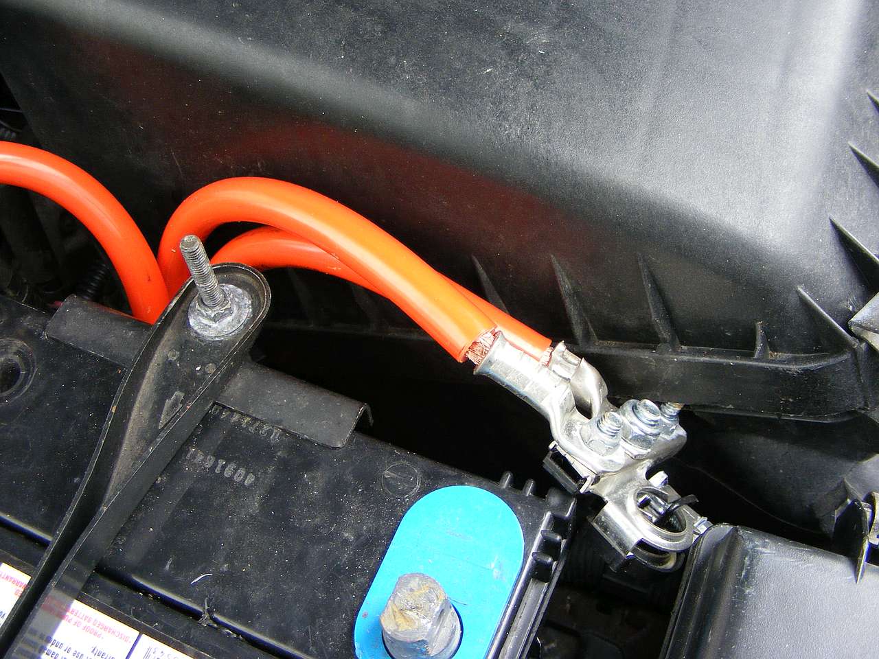

Here are some pics of the "big 3" wiring job that I've done. I realise that the alternator could do with fusing and I'm going to entertain the idea of placing it on a circuit breaker. The circuit breaker shown feeds the pioneer amplifier(s) and SB50 connectors inside of the car. All of the wiring is 35mmSQ, I have yet to finish heatshrinking the ends of some of the wires and adding conduit to the negative earth leads going to the transmission and body. I just mocked it up really as a proof of concept and the conduit hadn't arrived yet when I did this wiring job. But I will disassemble it and redo it soon.
I might end up riveting the circuit breaker(s) to the housing for the cruise control motor which is just beside the battery. They would have to be shallow as I don't want the rivets or bolts to interfere with the throttle linkages and mechanisms inside.
You might notice that I've left the existing factory wiring for the alternator in place and simply bolted the additional 35mmSQ cable over the top of it, this is so that the current going from the alternator to the accessories has the best possible connection to the original factory harness. This might end up being a fire hazard for the time being until I add a circuit breaker to the new 35mmsq alternator cable.
The new alternator positive lead runs along the top of the radiator, I got this idea from my old falcon which had a similar arrangement.
The car starts within a quarter of a second with a fully charged battery (topped it off yesterday) and immediatley jumps to 2,000 rpm for approx 10 seconds before beginning to settle down, it sounds very nice to hear the engine run as smoothly as it does but it still sometimes misses, not entirely sure what that is but it could be simply the ecu training or it could also be an ignition cable problem.

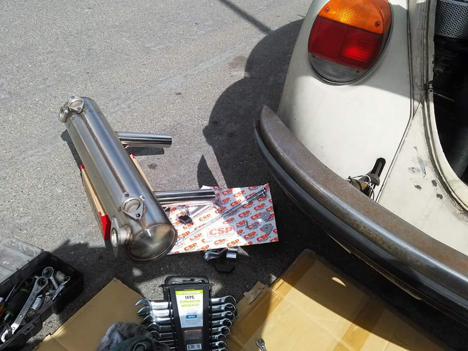

Went down to Disneyland for a couple days, and grabbed a nice stainless exhaust for my bug while in the area, I've gone through three in two years, and no matter what rust eats them alive ( and this is in California, San Francisco bay area!!!) So I said screw it, and splurged on a nice unit made by Vintage Speed. Much quieter and deeper sounding than the cheapo header and muffler pack, and it just plain looks good. Everything fit perfectly, and is adjustable to work on different setups. Quieter on the highway too. Nice to have my tailpipes where they belong, too. Also installed my new carb linkage too, also perfect fit, and easy setup.
Those short exhausts are hard on mufflers too, most have glass packing which burns out. That whole scenario reminds me of the stacks of “Hot VWs” magazines that I had around growing up.
