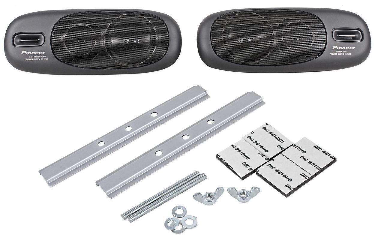

I'm thinking of putting a pair of mdf speaker boxes on the front dash facing directly towards the driver and passenger. Along with a tweeter mounted on the side of each box.
But the question is finding the right size box and what will work without obstructing the road too much. It would have to be 100% diy fabbed at home with mdf from the hardware store.
Tomorrow I'll consider going down and buying some mdf and in the meantime come up with some designs using a 4 inch or smaller driver.
Something similar in design to this, with the speaker laying down, would work better with the windscreen: PIONEER TS 44 Surface Mount Dash Pod Car Van Motorhome car Audio Sound Speaker | eBay
PIONEER TS-X200 4" 3-WAY SURFACE MOUNT CAR SPEAKERS SET 12562165141 | eBayhttps://www.ebay.com.au/itm/Pioneer...014830&hash=item2aa0d173df:g:up4AAOSwgsxajM2O

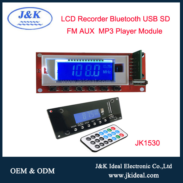

I have been looking at these types of players, it's so dirt cheap (~14$€£) one couldn't care less if it broke, a cheap class-D amp would mate well to get little bit noise out of it.
MP3 Decodierung Bord 4,0 Bluetooth Wireless Audio Modul USB SD Radio APE FLAC WMA AUX Externe Signalquelle Storungen Bord in MP3 Decodierung Bord 4,0 Bluetooth Wireless Audio Modul USB SD Radio APE FLAC WMA AUX Externe Signalquelle Storungen Bord aus Integrierte Schaltungen auf AliExpress.com | Alibaba Group
edit: the inspiration came from this thread tuner modules that dont suck
I went down that path myself and made an alps volume control and mounted it onto a flat single din plate intended for a nissan. I then got a bluetooth receiver/sender module for $30 off ebay with optical output and realised that I also needed an AV switch for switching between the stock AM/FM Cassette receiver that was single din, then I needed to buy 3x external 2 channel Class-AB amplifiers in order to realise the full potential of the system, along with crossovers and new speakers ontop of that.
