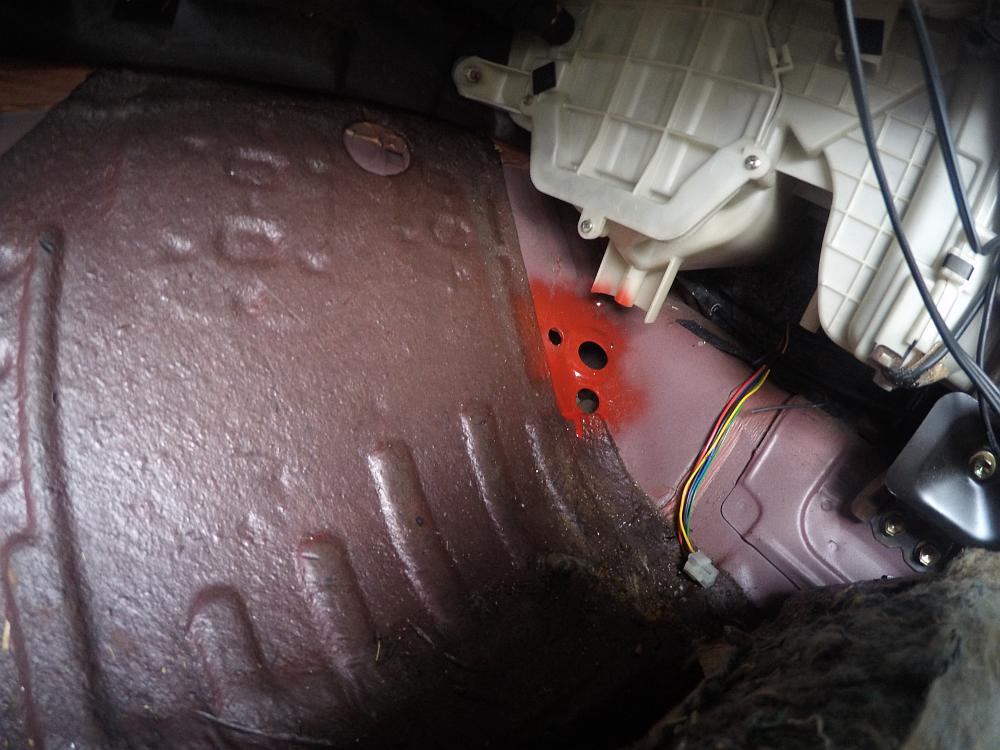

My project will involve a dual 10" subwoofer in a box that was made specifically for this car as it will clear the two strut towers and the rear parcel shelf with a centimeter to spare on each side.
I'm not 100% sure on the second part and that is re-making a second dual 8" subwoofer in the same size of cabinet. The cost might be too great as the drivers are expensive but we will have to see what my finances are like for the rest of 2018.

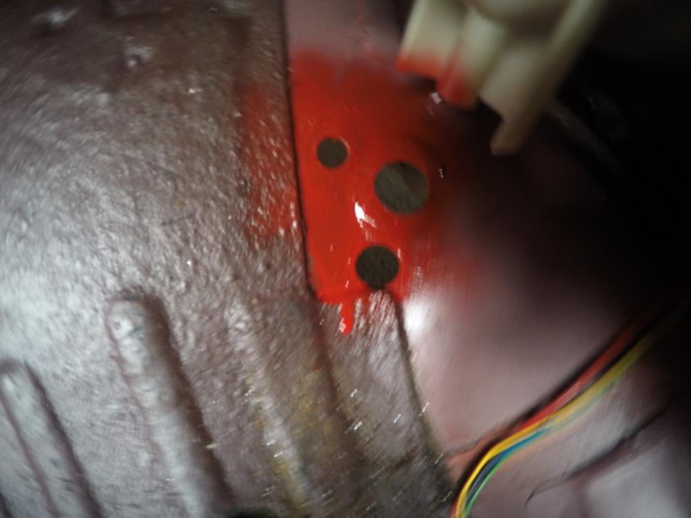

I received the 8 meters of 35mm2 cable yesterday. Today I figured out an interesting method of drilling some extra holes without having to get underneath the car to look at the area where I'm drilling into. I simply went down and stuck my middle finger through the existing aircon AC drain hole and then pulled my middle finger out and measured where the holes should be roughly. and also at the same time checked the area around where I'm going to make the holes to make sure that they were free of obstacles.
I then put a small 2mm pilot hole into the metal using a step drill then reconfirmed where its going to come out on the other side with my finger again. I made sure that where I was putting the holes there wasn't going to be any obstacles on the other side, but it did come close on the 10 o'clock position hole that I made.
In the attached pictures you can see the original existing ac drain hole which is about 22-24mm wide, but you can also see the first hole that I made at about the 6-7 o'clock position, this hole is 20mm wide, I've ordered some cable grommets for this size hole.
Also in the attached pictures you can see a second hole at about the 10 O'Clock position in reference to the original AC drain hole. this hole is 14mm wide, the reason why this one is so small is because just above it and to the left there are what I suspect to be either fuel lines/brake lines or a bracket to hold the steering rack in place.
I've also ordered some 13mm inner diameter plastic conduit on ebay, that will take a while to arrive.
I've also sprayed the new holes with some high temp paint that I had lying around.
I did the best I could considering but as far as I'm concerned it turned out good, really good. Now I can route two 35mm SQ cables for the front amp and the rear subwoofer amp as well as a 6mm SQ cable for ham radio use and coax.
