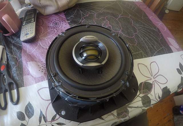

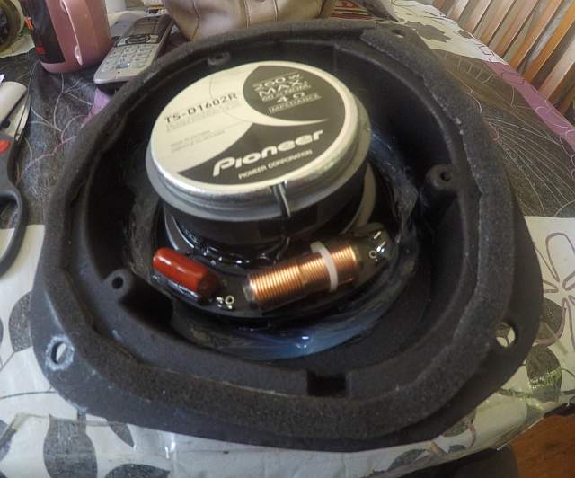

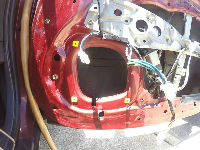

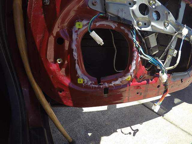

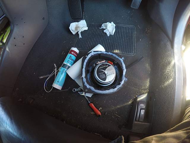

I "finished" the drivers side door driver installation today. I used some white spirits to clean off the paint of any residue and glue then I used the silicone monster to seal up any perceivable leaks around the crappy plastic speaker basket (in some areas its only 1mm thick so some padding was required) but I have no choice and cannot use an MDF bracket because the speaker is installed at an angle and the plastic door cover works with the factory angle of the speaker and the plastic speaker basket.
Once I laid down about half a tube of silicone and test fitted the plastic basket up against the door frame I pulled the basket back off and went back over the area with some additional silicone to make sure it was well and truly sealed up against the door frame. I did try and fit up some weather stripping to the area but there were leaks galore.
I routed some of the prepackaged wires for the speaker driver behind the basket through the mounting hole so I can access them later and solder in an extension lead to go to the factory speaker wiring harness, its not ideal, I would have preferred all new speaker cabling going directly from the amp to the speakers however routing wires through a 97 toyota camry wiring loom is impossible without drilling some holes in the door frame to route a new wire just for the speaker wires. The factory speaker wires are high gauge anyway.
There is no room left at all in the toyota factory wiring harness rubber grommet or wiring assembly to route new wire, I've tried and tried and even if you do get it through it it comes out inside of the kick panel inside the body of the car at a mysterious location that I cannot access. Truly a pain in the ****, but the factory wiring loom is high gauge so I'm not worried.
I have yet to install the closed cell foam insulation on the door frame, as I haven't yet finished the wiring harness going to the speaker from the factory speaker wire harness, so I cannot button it up just yet, another day perhaps.
