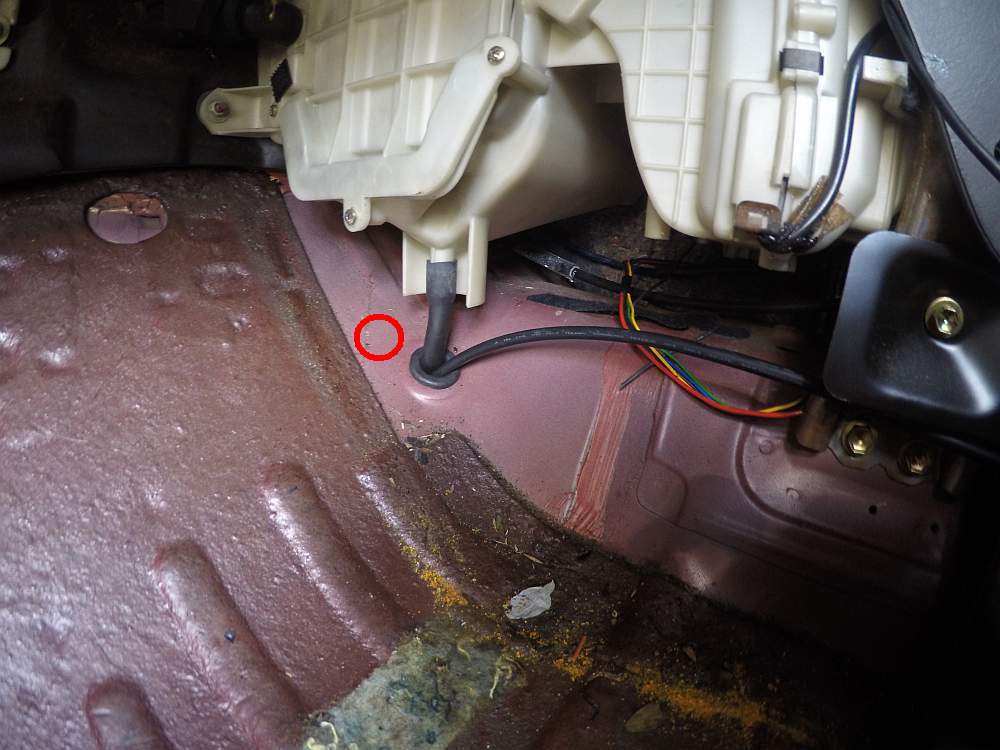

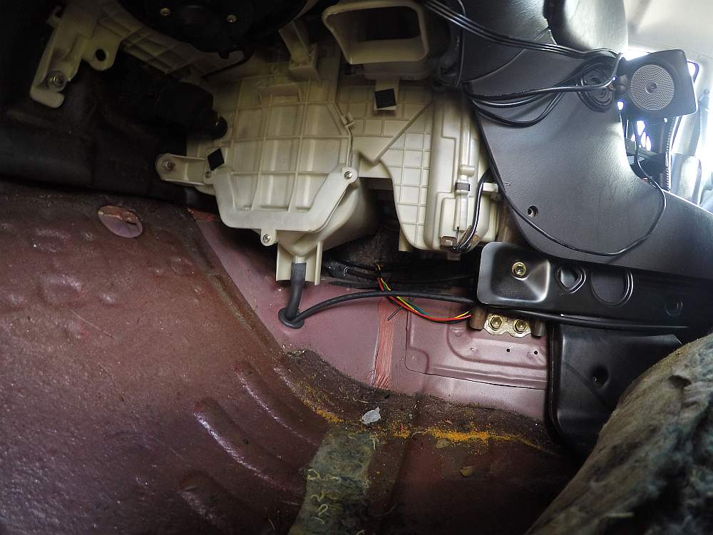

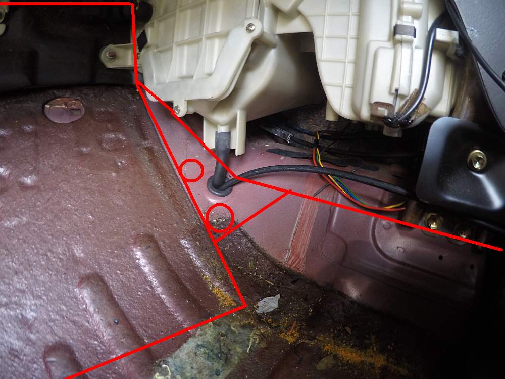

I've gone down and had a look again at the area where I'm considering cutting a hole for the 70mmSQ cable. But it looks more and more likely that I will probably be relegated to the fact that I cannot run it through the cabin of the car.
I've attached 3 pictures and the 2nd one shows a likely candidate where I would be drilling a hole, just above where the air condenser drain hose currently is.
This area is supposedly free of fuel and brake lines but of course I will need to be 100% sure before I or anyone else does any drilling. Everywhere else on that floor panel is covered in fuel and brake lines which go to the back of the car or the power steering rack gets in the way, not even kidding, its a tight close quarters area in there. And the wheel well is where the exhaust is. So we are literally about 2-3 inches away from the exhaust manifold and catalytic converter, both which run very hot.

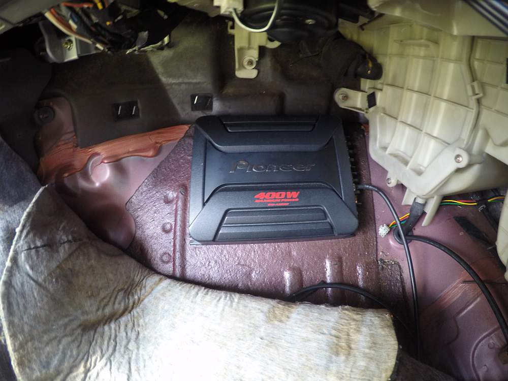

In other news the 3rd picture shows a likely spot for placing the 2 channel pioneer amplifier for driving the 2 front speakers. I'm thinking of placing it here and not underneath the seat just so I can keep cables short as possible.
This means that the 2 channel amp will then have its own connection to the battery in the engine bay independent of the subwoofer cable run, which is great for me.
The amount of footwell space taken up by the amp is minimal and shouldn't give anyone issues.
Anyway this is all hypothetical stuff, everything is still in the design stage for now.

Here I've drawn some lines to detail where its off limits. basically everywhere but the red circles and the immediate area around them are off limits.
Even if I were to run the 70mmSQ cable underneath the car it wouldn't contact the road, there are chassis beams running the entire length of the car going back to the boot which the cable can run up against and be protected by road rash, in addition to this the suspension and steering components are lower than these points. So the likelihood of the cable being damaged is low.
I also intend on raising the car 23mm above the stock ride height.
So things as they are now if I can power the subwoofer independently of the front amplifier AND I add a fusible link in the engine bay AND I don't relocate the battery to the boot AND I put the cable in some reliable conduit it should be safe.
If I run the 70mmSQ cable on the outside of the cabin I can then run a 16mmSQ cable to the 2 channel amplifier underneath the passengers seat from a second hole drilled in the firewall. I highly doubt that I will be able to run both 70mmSQ cable and a 16mmSQ cable and the aircon drain hose all in that area, I will most likely run out of room.
So the plan for monday is to go down and check their conduit out, see if its worth its salt, ask them if they can run it somewhere in the firewall (up behind the dash I'm thinking) then if it is order the parts online and get them to put the 70mmSQ cable in and run it either through the firewall or outside of the car to the boot where it will be used only to power the subwoofer amplifier (yet to be ordered).
Tomorrow I'll take the glovebox back out and see if there is any room up along the vertical part of the firewall where I can run the 70mmSQ cable and not run into things like fuel and brake lines.
Then come back and drill a second small hole for running 16mmSQ cable to the 2 channel amplifier located underneath the passengers seat.
