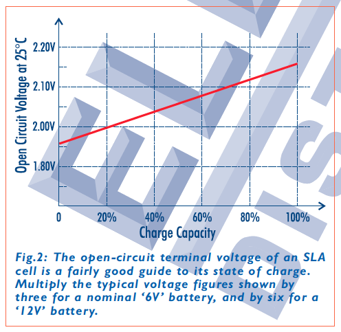

I checked the voltage drop from chassis to battery and block to battery both unloaded and loaded and it was minisucle (around 0.01 to 0.02 V) So I think that the earths are good (tested same alternator body to battery.
Also the voltage at the battery is 14.2V unloaded at first start up but drops by about 0.4V once the alternator has warmed up.
With almost everything on (low beam, high beam, fog lights, defrosters cabin fan on full, hazzard lights) voltage at the battery (idling) was around 13.1V, when revving up the engine that went up to 13.7V.
The battery seems to be holding charge well. Cranking over much quicker than before even after a week of short trips after fixing the faulty cable.
So I'm thinking whilst it is possible the diode pack/regulator may not be 100% well, it is actually doing ok.
I think the burning bakelite smell may actually have been the insulation on the starter solenoid where the cable attaches. It was that end where I believe the "high" resistance was, and with 70 - 80A passing through it, it would certainly heat up!

Sounds about right to me - nice job.
Seeing 14.2v after start-up is a very good sign; it's not 'unloaded' but actually the point at which the alt is pouring current back into the SLA to replenish the lost start charge (e.g. clamp meter test on my E39 5-series I see 50-60A here... for 30s or so - at idle!) - so holding such a high output V is spot-on. That alone looks good to me.
As for your other comments - SLA batteries are at full charge at c. 12.8v utterly unloaded/disconnected; so never seeing below 13.1v with a full system load is solid enough - it's not loading the battery; and that 13.8ish is ideal long term 'float' charge voltage.
Remember for SLAs there's a slight negative temp dependence for ideal charging volt vs temp, (? c.10mV/degC iirc)- so where you are, giving up handful of tenths of a volt is likely right. System voltage dropping a couple of tenths isn't to be worried about - it's likely to the be the reg in the alt doing such deliberately (the temp compensation is v old tech long incorporated - even dynamo regs from the 1950s have it)
ETA: a useful chart - at ~20degC. note when connected in the car, even when not running, it's still likely supplying 20-30mA to maintain body electronics, clock, alarm, ecu watchdogs etc: it's not disconnected - expect a .1v or so lower than predicted here.

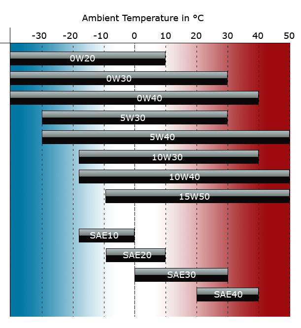

Oleje silnikowe zestawienie / Engine oils Summary - Google Sheets
My opinion is only of interest for people in warm climates:
After reading this extensive list of testing oils for friction from the youtube channel "Piotr Tester": YouTube
I've concluded that the best brand and viscosity with the lowest friction out of a few final choices is the Mobil 1 Super 2000 X1. My choices were limited by availability here in Australia. None of the local oil manufacturers such as Nulon are listed. However Penrite is, and if I had no choice and couldn't find Mobil 1 I would choose Penrite 5w40, as you can see in the chart above a 5w40 oil will do all climates including cold and hot all the way up to 50 deg c ambient temperatures.
3rd choice: The Castrol Magnatec 10w40 score is: 0.05 cold and 0.1 hot (100 deg c)
1st choice: The Mobil 1 Super 2000 X1 10w40 score is: 0.07 cold and 0.01 hot (100 deg c)
2nd choice: Penrite HPR 5 5w40 score is: 0.07 cold and 0.06 hot (100 deg c)
The Mobil 1 Super 2000 loses out just by a hair in cold starting operation but wins hands down in hot operating temp.
And Mobil 1 Super 2000 X1 isn't available anywhere, only Mobil 1 Super 2000 X2 is. Also Mobil 1 oil isn't available or sold at supercheapauto which can be a problem for some, to find it you have to go to autobarn or shop around or buy it on eBay.
This is assuming that X1 is the same quality as X2. Ie that the testing isn't out of date. X1 is apparently obsolete.
