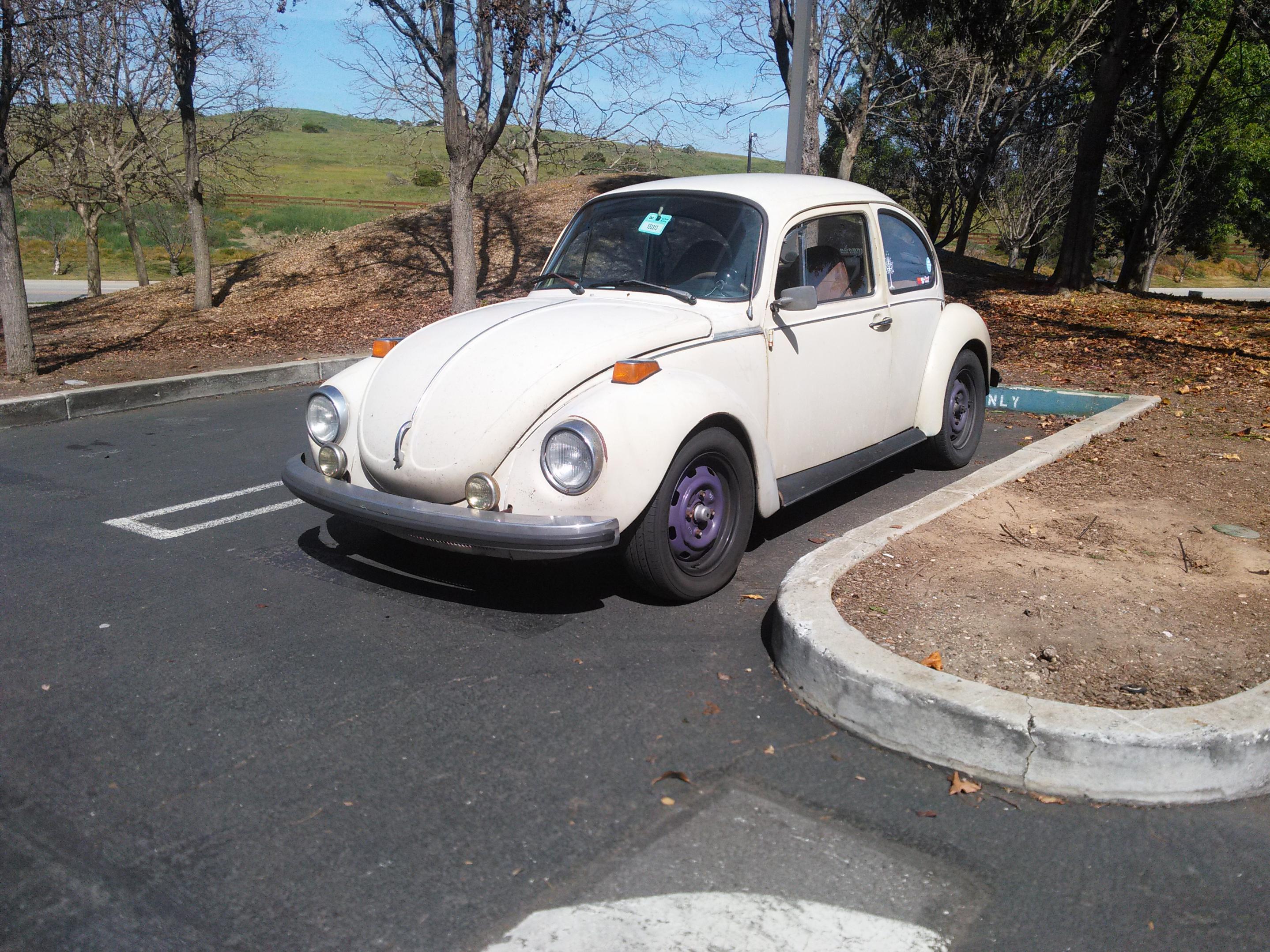

Got a bunch of neat stuff in for my daily driver 73 Super Beetle yesterday, it's used as a commuter car so gets a lot of use, sometimes 120-150 miles daily, six days a week.
attachment.php
Seat padding on the driver's side front seat is shot, got in New TMI padding. Very nice looking, should be pretty comfy.
New CSP stainless steel, made in Germany linkage for my dual carburetors. The 40+ year old linkage on my Kadrons is worn out and sloppy. A tad expensive, but worth every penny from what I hear.
New door handles, the driver's side was stripped where it slips over the stub from the mechanism inside the door.
New trim for the heater vent on the floor. The existing one has a broken flap, thanks to a careless guy at the tire shop.
Need to pull the driver's side valve cover and see why the gasket isn't doing it's job.
On my next real day off I have a new uprated front sway, a rear sway bar, and stiffer rear shocks to install. Already swapped to lowering struts and stiffer cartridges up front (as well as disc brakes) last summer. Once it's all done it should handle like a slot car on the curves 😎

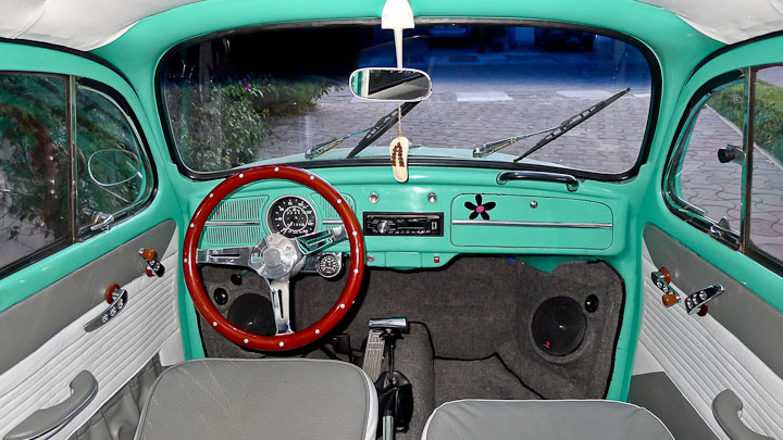

Pic for reference of front speaker location, my dash is different (not my car) but you get the idea-
And the rear, pretty typical location for most cars, really (again, not mine)-
As it is now, I'm thinking of going for a pair each front rear of something different, but in a similar size... smaller up front and directly under the dash is what I'm thinking so far, in a small wide rectangular shape enclosure should work and not be too intrusive, especially if covered with carpet material. The rear I'm thinking of doing something similar to what I already have, just out of better material. The current stuff is very thin (3/16" ?) Luaun or plywood, simply covered with vinyl. 1/2" plywood with carpet material should be a good start.

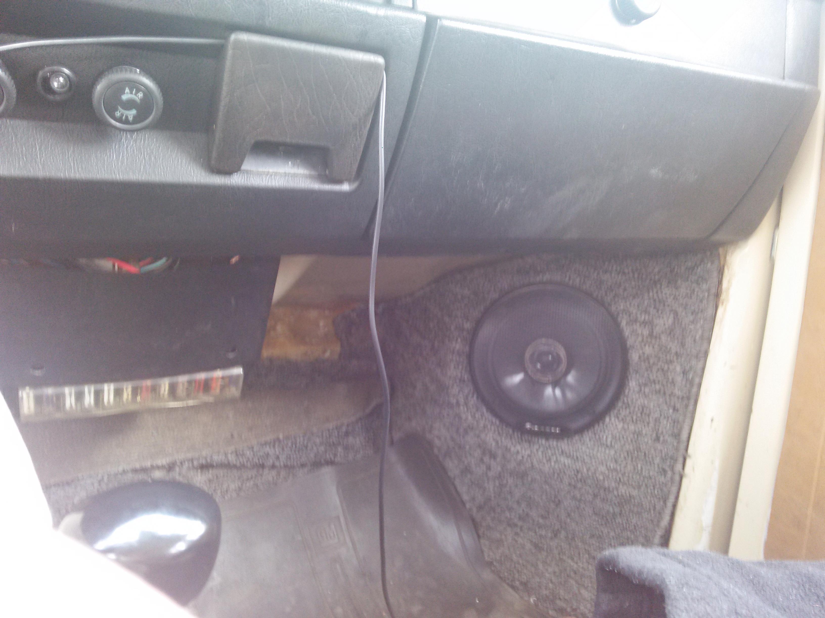

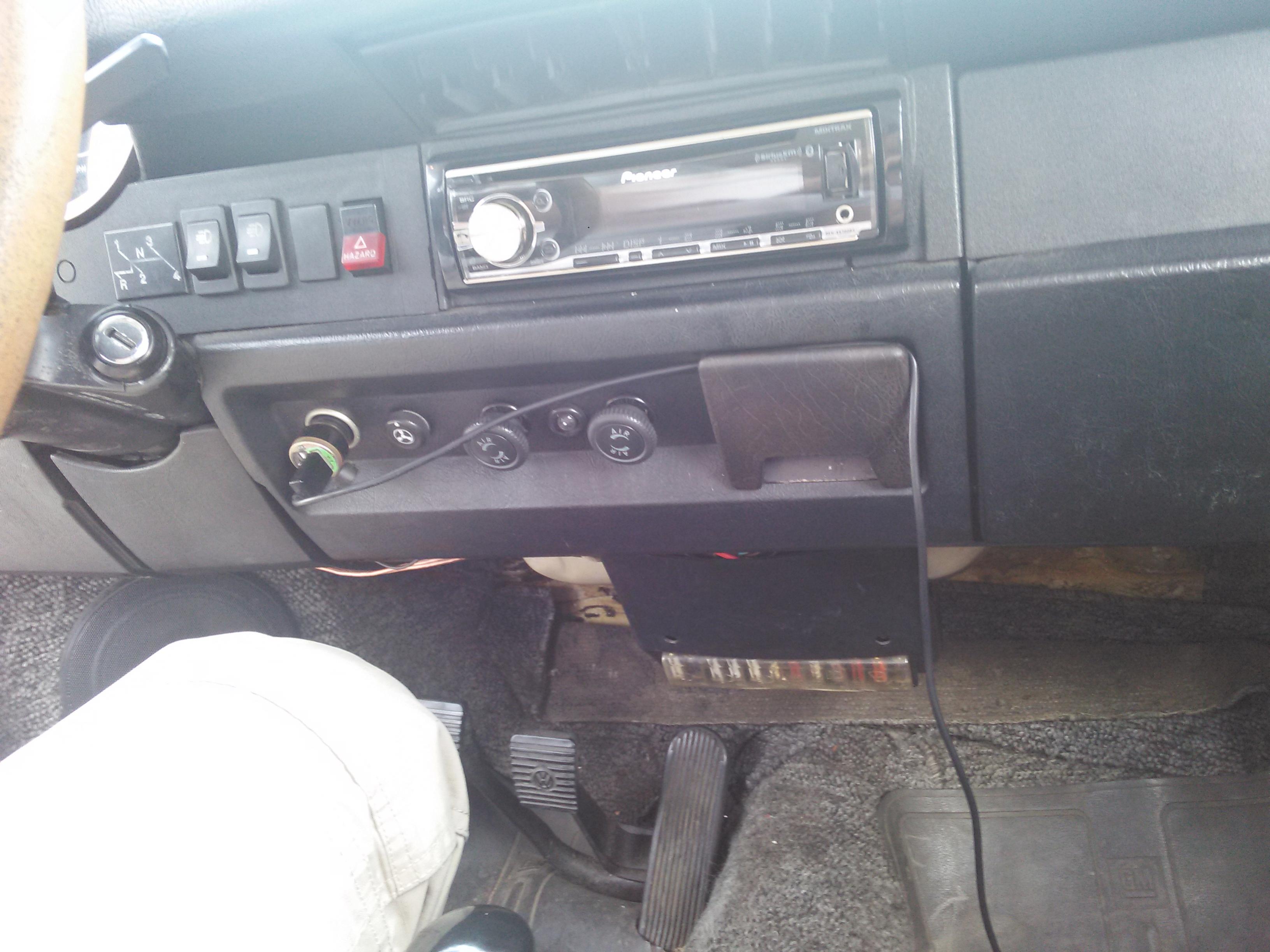

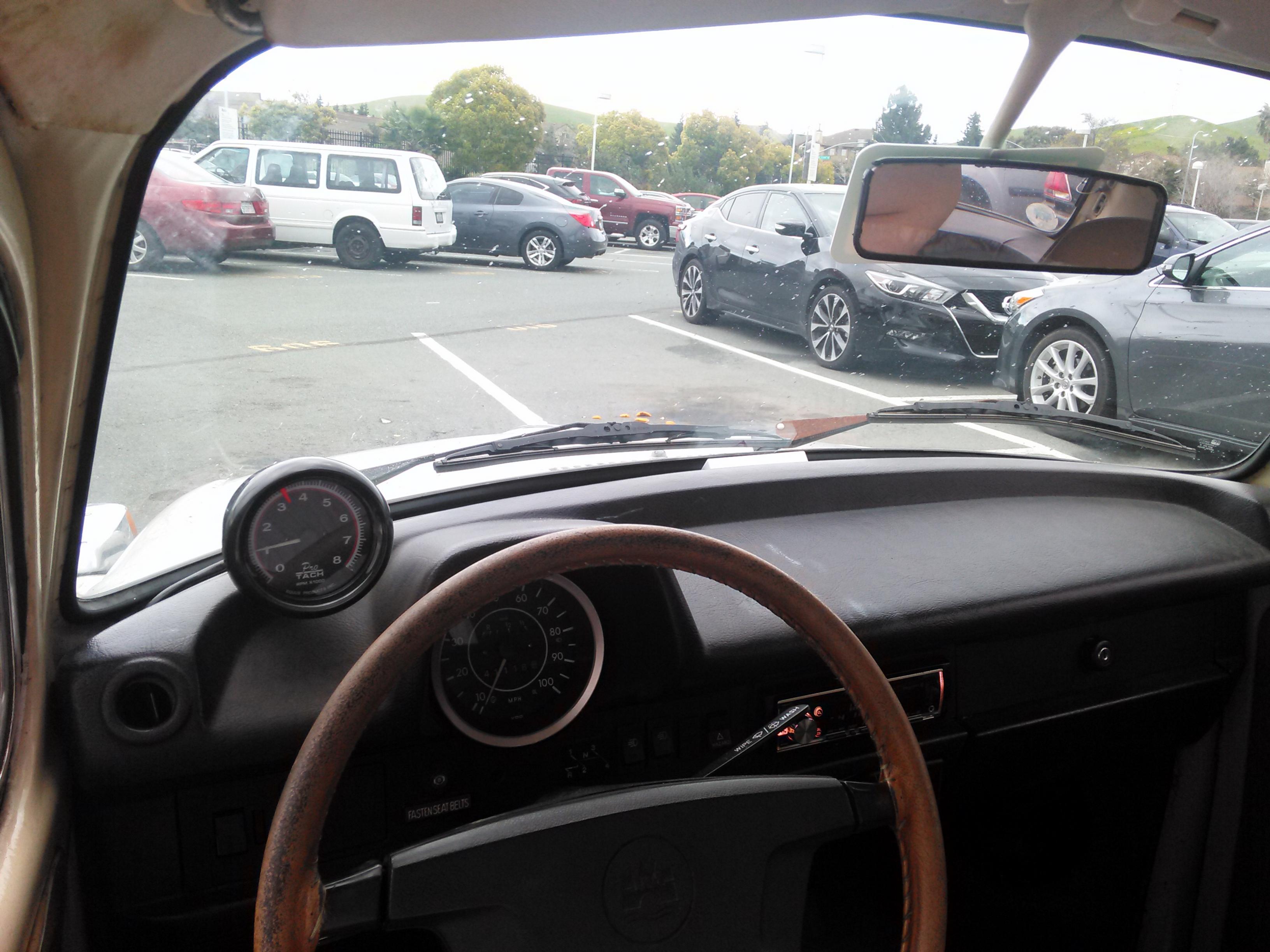

It just so happens that I have two Vifa TC9FD-18-08 sitting on my kitchen table right now, and two more that I can pull from a pair of speakers I'm not currently using. Two per side might do just nicely, especially with a pair of tweeters up on the dash in the corners...
Attached are pics of the under dash area, looks like two 3" vifas per side should be an easy enough thing to do. Ideally I would remove the kickpanel mounts entirely and just carpet over that location, I really don't like them down there. I think the vifas pointing upwards to follow the curve of the dash should work pretty well, especially with tweeters up higher in the corners of the dash like suggested.
The rear speakers are easy, plenty of room, and the way the car curves at the rear window makes it all work pretty well, even with cheap speakers. I still want to swap them to something nicer.
