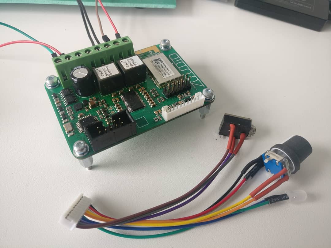

For those of you who haven´t seen it.
Sure electronics now makes a bluetooth amp with DSP and a simple high/low-pass filter
The only problem is that the DSP programmer cost more than the board. Mayby we should pool together to get one.
Sure Electronics' webstore 2 x 50 Watt Class D Audio Amplifer Board with Audio DSP - JAB3-50
The programmer is also for sale. The programmer can be used with bluetooth and an app or with usb and sigmastudio. It is really easy to use and only 20 USD.

Do you have any good reference for getting started with the Sure DSP board and where to buy it? As I understand you would skip the passive crossover filters to get a better result and control of the audio.
Does the Boominator sound any good in a non-DSP setup? If not; then it might be worth considering the DSP part from day one even though that was not my original plan.

The Boominator war intended to run just with passive x-over, so yes i guess so.
Sure DSP:
Sure Electronics' webstore ADAU1701 Audio Digital Signal Processor Kernel Board
Programmer:
Sure Electronics' webstore WONDOM In-circuit Programmer with BLE Bluetooth for APP control
Good point to start with is to play with SigmaStudio and read the DSP wiki:
Sure DSP Wiki
(Needs google translate for english)

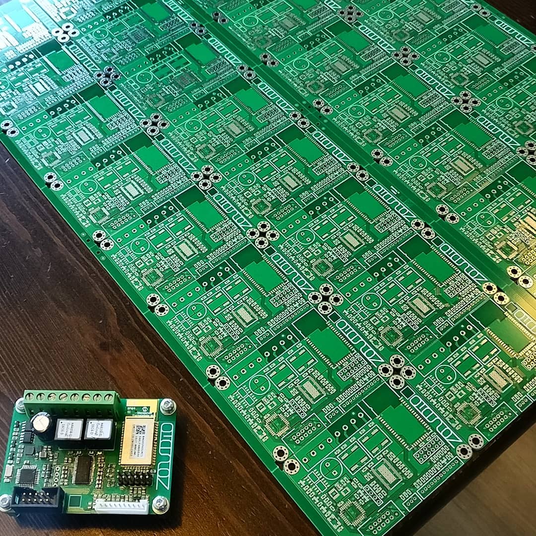

Maybe a good time to announce a project that I've been working on for a while.
Can't promise too much because it's still in development, but main specs for now are:
-2x45W class-D amplifier
-Bluetooth V4.2 module
-DSP with 5 biquad filters per channel and options such as psycho acoustic bass enhancement and dynamic range limiting
-Extremely low power consumption
-Onboard microcontroller for tasks as status LEDs and under voltage protection
-Stackable up to 4 channels, so suitable for a active full boominator
-Very small (65x35mm)
-Price <100€
-Manufactured in the Netherlands
Developed with high-performance portable speakers such as the Boominator in mind.
Are there any updates on this 😀?
For sure!
I have had a lot of trouble getting the bluetooth module to work properly. The latest software release has all kinds of bug fixes and new features but it is not stable at all. So I rolled everything back to old software and now it works fine. Also having some problems with switching between aux and streaming, but that seems to be a minor issue.
I am in contact with a handful of beta testers which will receive their PCB in the near future. If they are happy and no other issues show up, I will do a series production. No clear timeframe yet.
