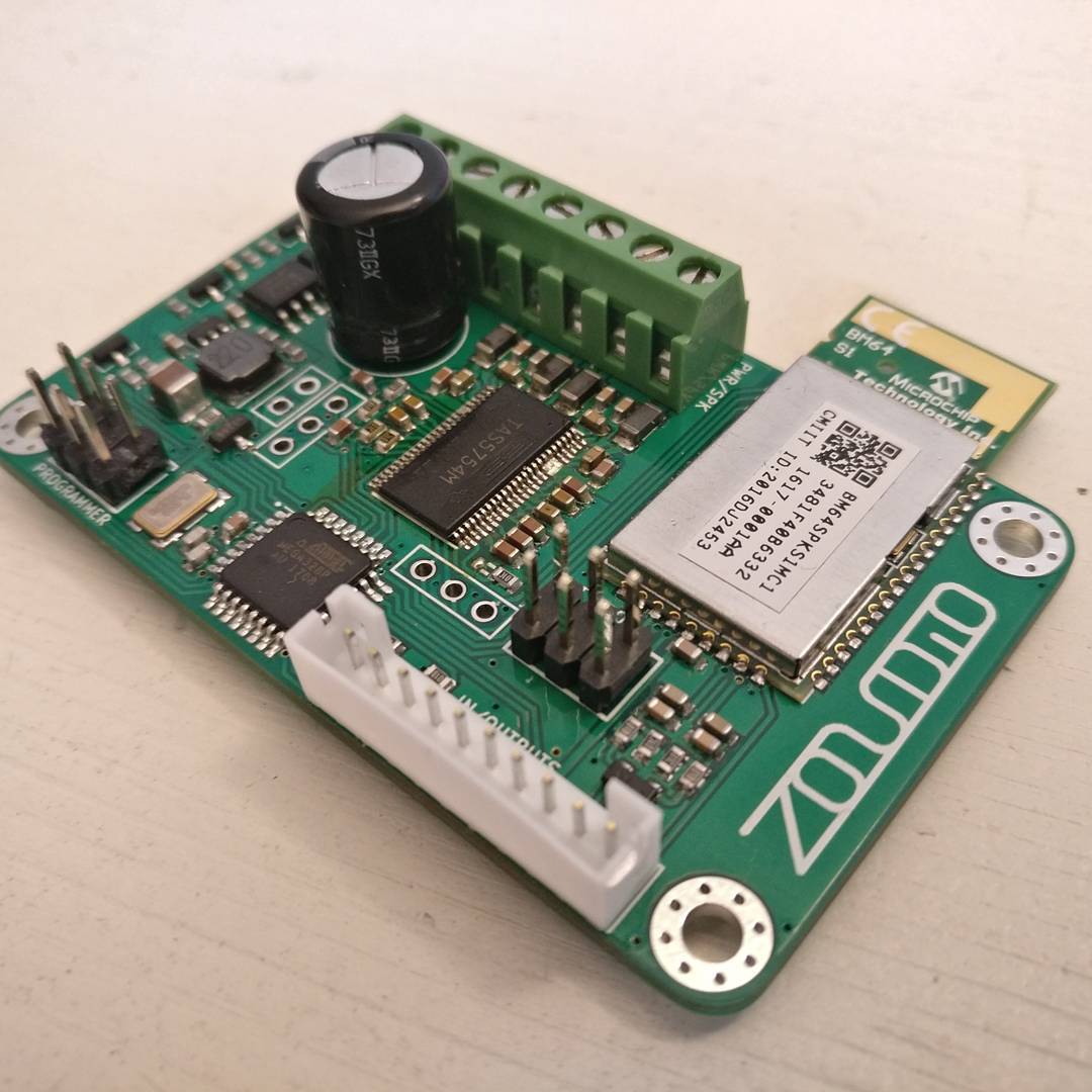

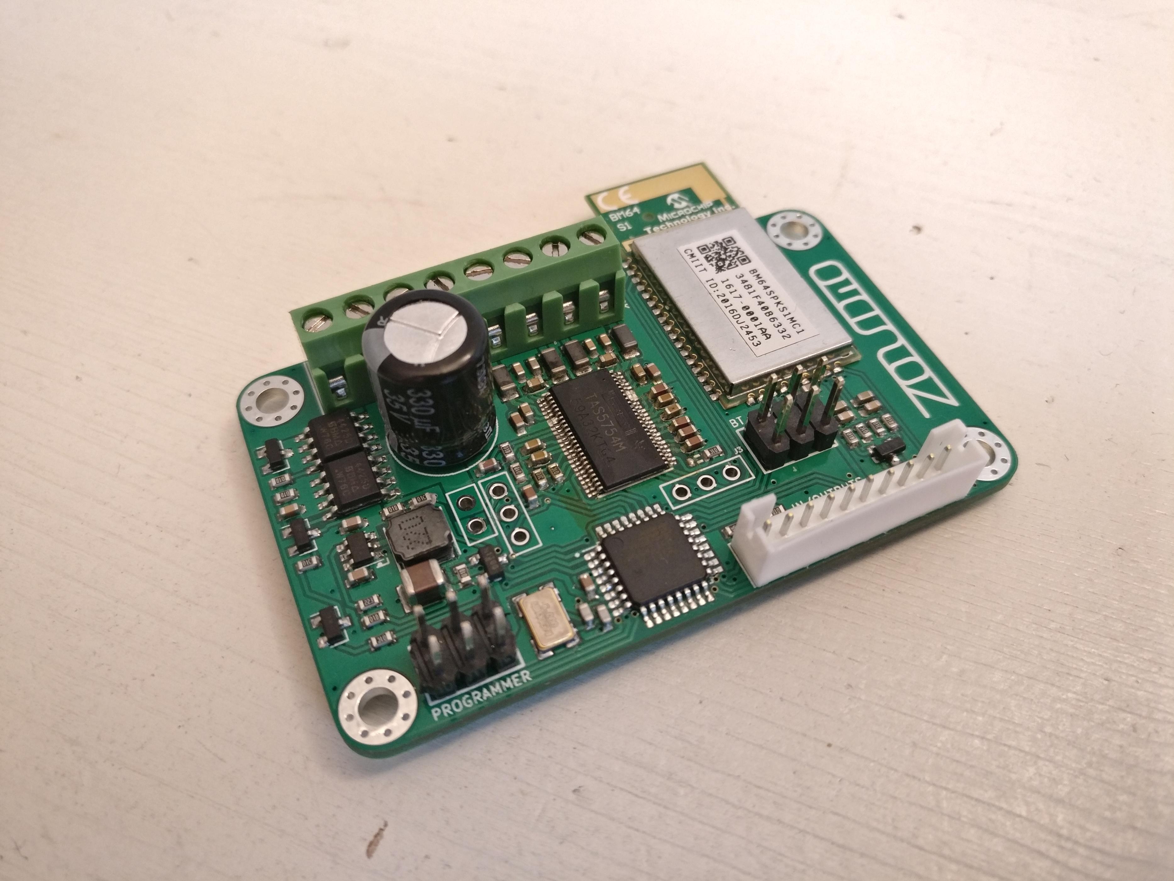

Maybe a good time to announce a project that I've been working on for a while.
Can't promise too much because it's still in development, but main specs for now are:
-2x45W class-D amplifier
-Bluetooth V4.2 module
-DSP with 5 biquad filters per channel and options such as psycho acoustic bass enhancement and dynamic range limiting
-Extremely low power consumption
-Onboard microcontroller for tasks as status LEDs and under voltage protection
-Stackable up to 4 channels, so suitable for a active full boominator
-Very small (65x35mm)
-Price <100€
-Manufactured in the Netherlands
Developed with high-performance portable speakers such as the Boominator in mind.

Hi lutkeveld
That looks very cool. Congratulations on the work so far.

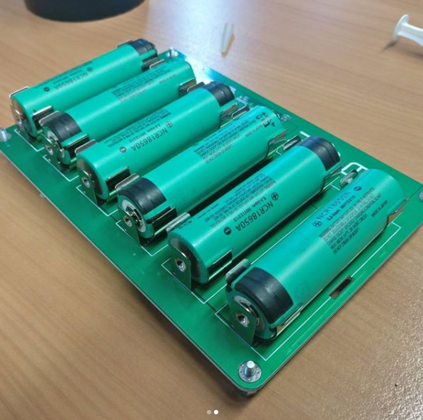

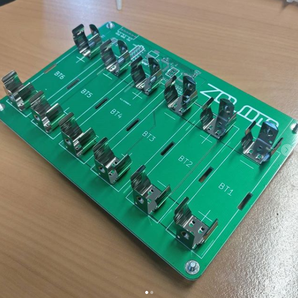

Some of the add-ons that make the SURE JAB2.50 so user friendly would be welcome additions:
Li-ion battery pack and charging. Perhaps you could just use SURE's board (AA-JA11113)
Interface Board
Wiring/LED pack
