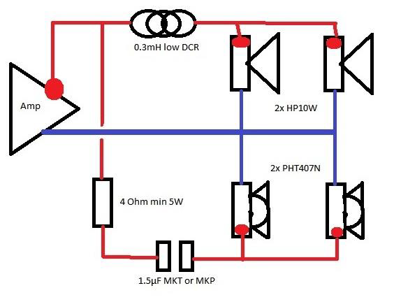

I'm building a half boominator with the HP-10W and Monacor MPT-001 Piezo.
I use the 2 x 100 Watt Class D Audio Amplifier Board - T-AMP and my power source will be two or three power banks in serie. So I have 10V or 15V.
I found this filter schematic.
Anyone who can help me change the filter design so it works with separated channels, i.e. not paralleled as the one Saturnus posted and with the Monacor MPT-001 Piezo?
Thanks in advance!

I don't think you need filters for Monacor MPT 001?
