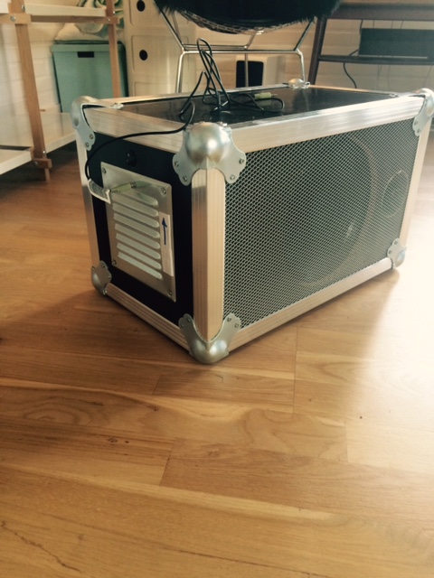

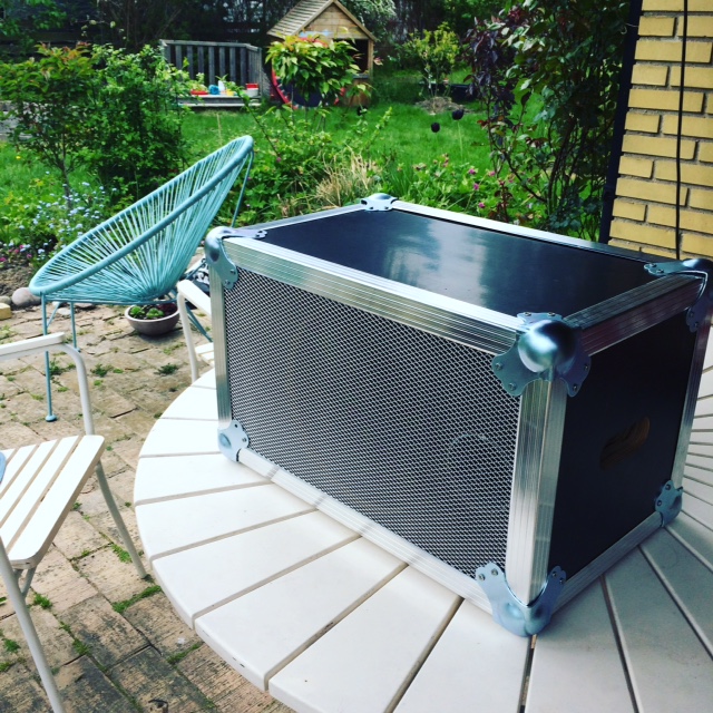

Finally finished my half' first build
Sune 1981:That is a really nice design of finish. Did you build the cabinet, or did you cut up an existing? Either way, great job.
Hi, thanks.
No i made the cabinet myself - 12mm plywood and a steel grid from the local builders market.
Everything glued together with silicone sealants and epoxy
