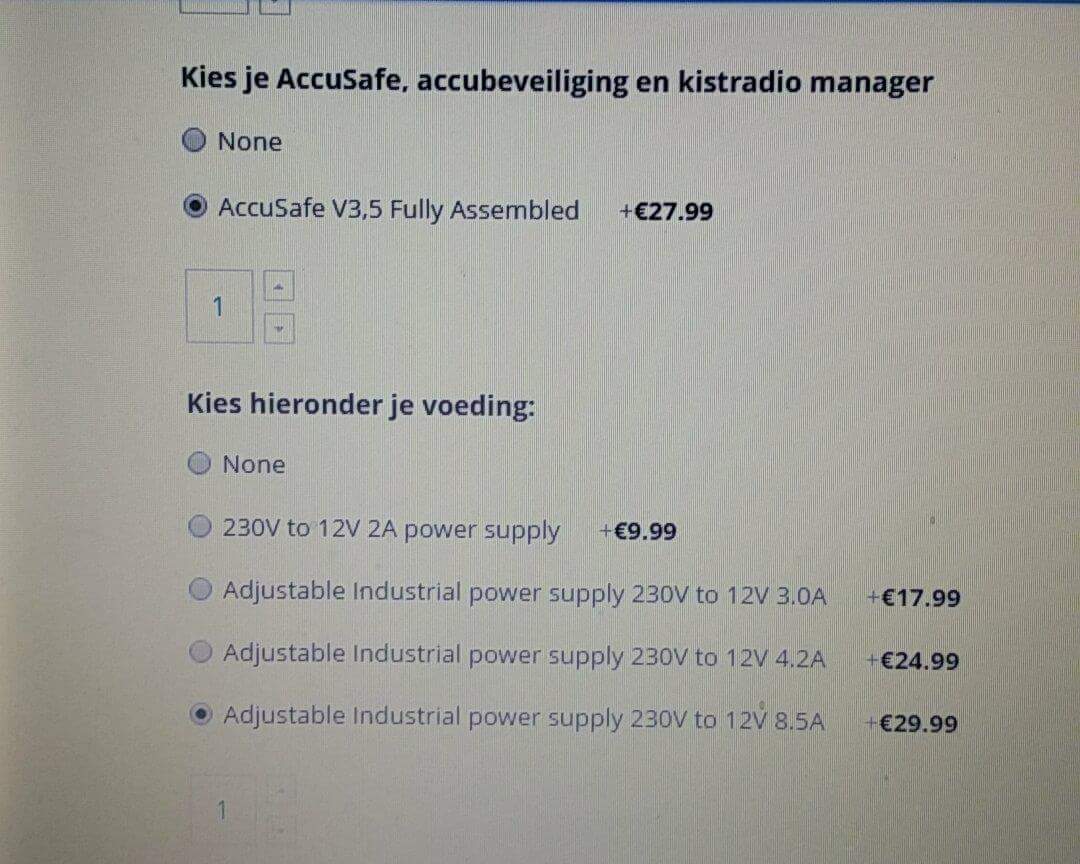

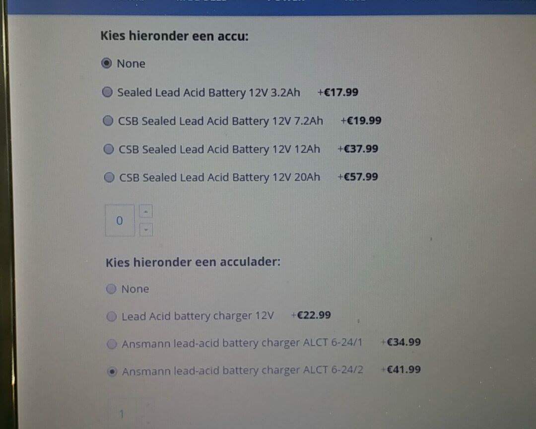

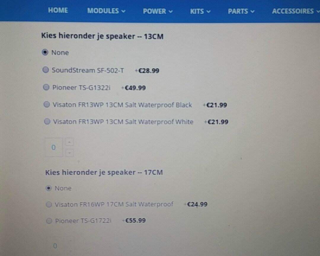

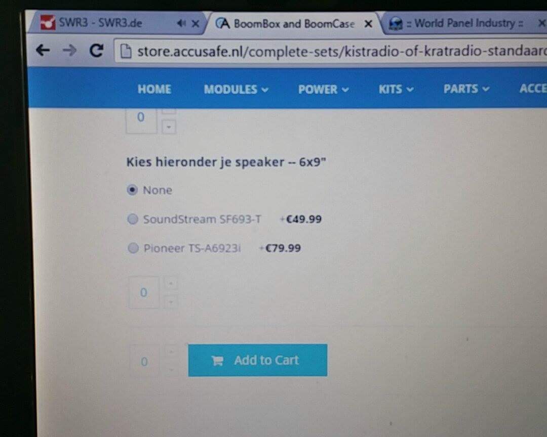

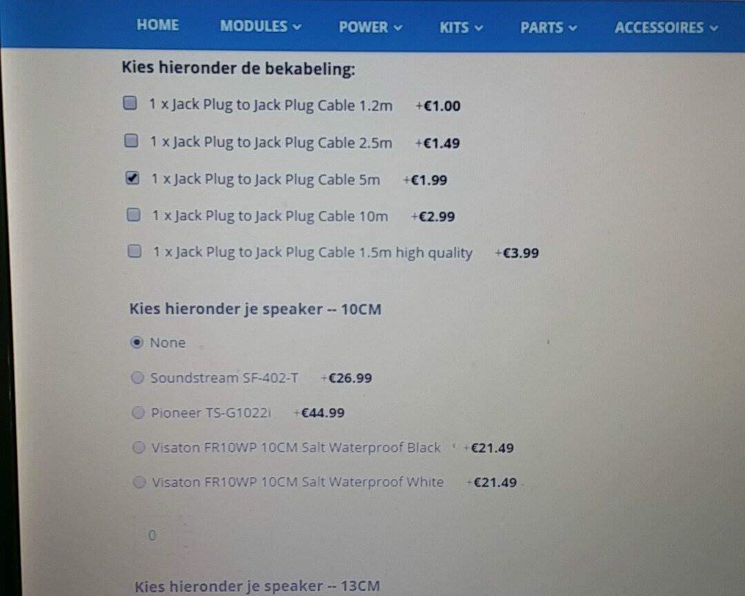

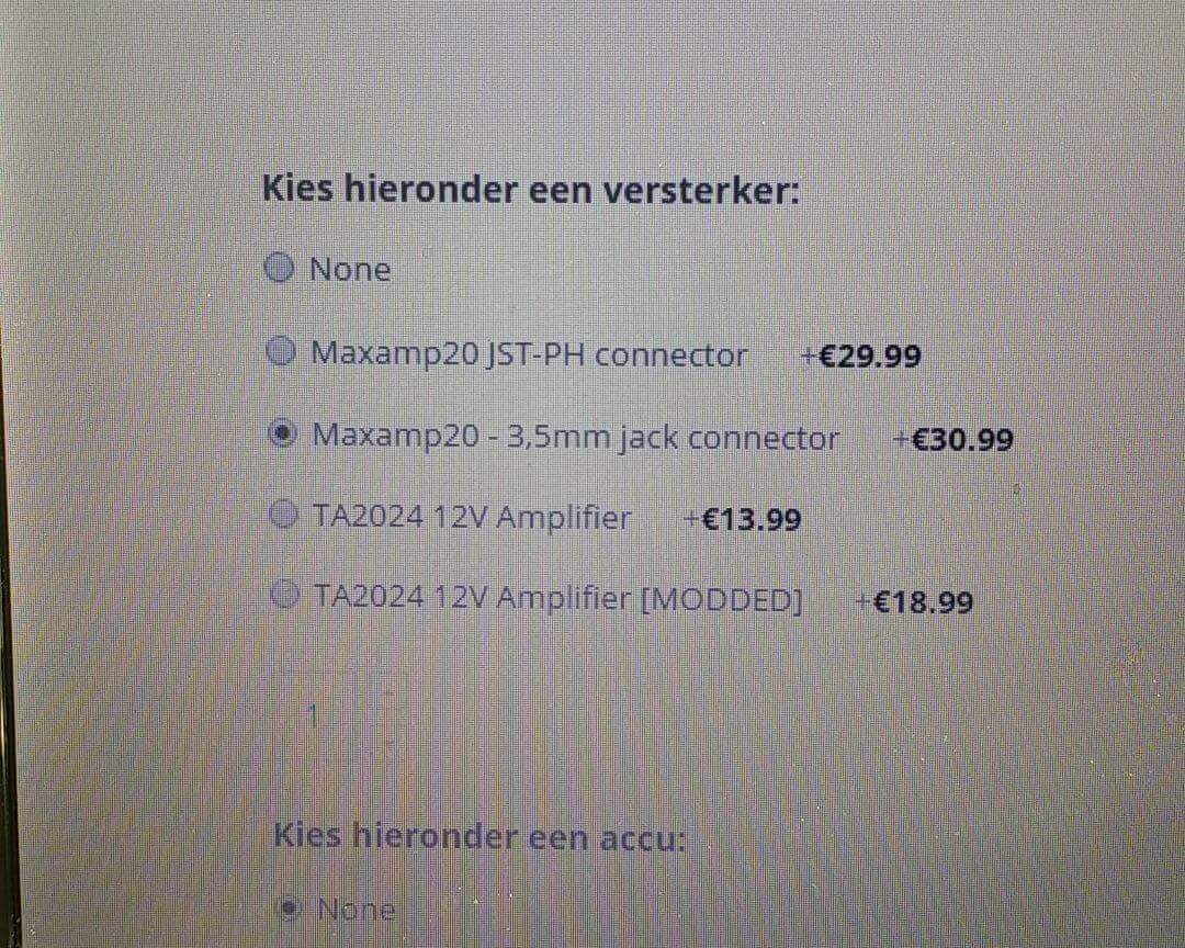

Hey Guys!
We cutted 12mm Plywood to the measurements given in the sketchup 2015 model (newest model). Is it right, that the middle part for the electronics is only 6.6 cm wide? Our battery (biggest model on accusafe.nl) does not fit in this space at all. Is it better to buy a smaller battery or is it possible to cut a few cm off of the wood parts inside (the two parts with all the holes in it)?
And how do you solve the problem of accessibility to the electronics? On a festival, or while transporting the boominator to some, there could be easily some vibrations which can cause some ripped-of cables or something like this. Therefore we would like to build an easy access to the center. Our idea is to drill a hinge at the one end of the top plate and a handle on the other side. So we would be able to unfold the top plate to check the electrics. We want to use sealing tape and a strong fastener to secure a strong fit to the rest of the glued boominator.
Furthermore we did not found any pictures of the boominator cabling or the placement of the electronics IN the boominator. We checked saturnus, lutkeveld and this build log Boominator - Album on Imgur. Please send me some pictures or links or links or whatever that show me how to settle the battery, the amp and so on.
The next important questions is can you send me a link of the part i have to order to be able to switch between battery, solar panel and 230 V source? We already have got a cold appliances connection (known by PCs etc.). And please tell me how to connect it between the parts that we have got.
My next question is the choice of the right glue. Like Lutkeveld we want to glue the whole box as well as the speakers and piezos. Which glue (please name the product name, so i can order it) should we use for boominator itself. Which glue should be filled into the grooves or dimples of the piezo? and is this glue the same that is used to glue the speakers and the piezos to the frame`? In Our stores we know the manufacturers of glue like ponal, loctite and stuff. Please name no only-available-in-the-us-stuff :-D !!!

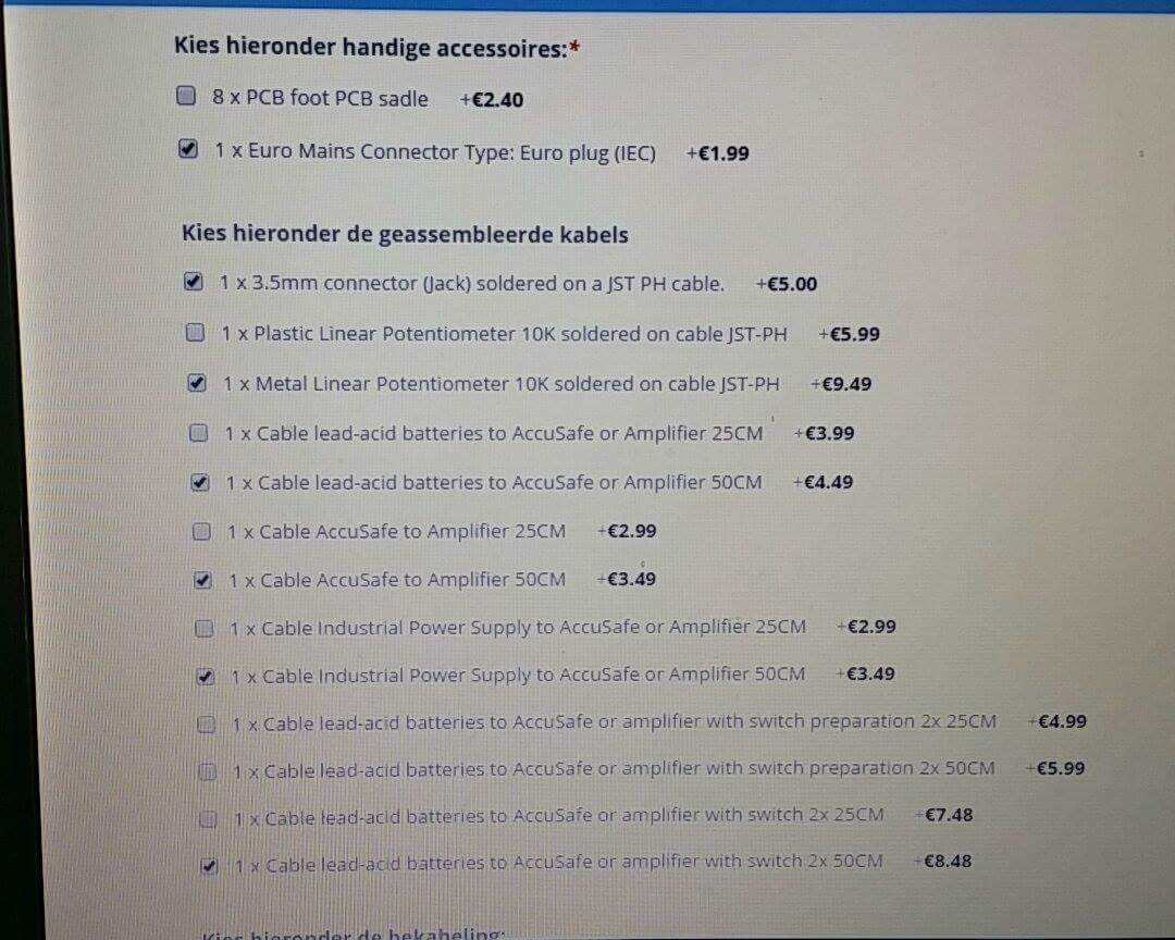

Here are some pictures for you to know which parts were bought until now.
here are the pictures 😱
Wrong battery. The case is made for "standard" 12V 7.2Ah. (Or even 9Ah when using some deep cycle types)
There are also LiFePO4 batteries available in this size.
If things like this worries you, you should overthink your system electronics design. There's so much PA stuff around which doesn't suffer from this problems - have an eye on the internals to do you build in the right way.
