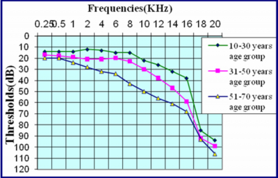

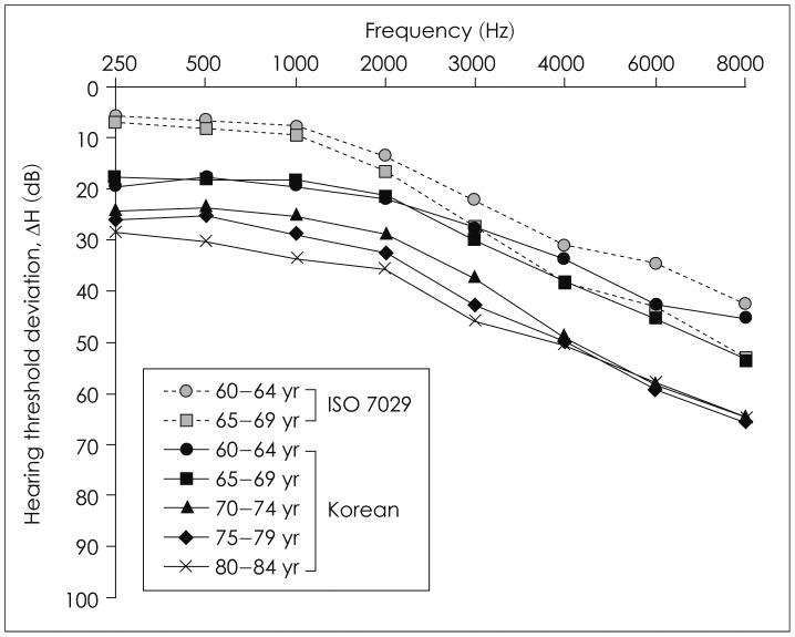

When I was doing my own live recordings to get Masters for equipment listening evaluations.... i was a lot younger than i am now. That is when i first heard the differences between CD made off a good analog 30 ips 1/2 track master.
But today? I would think many of us over 50 here cannot hear much above 8-10KHz now.
Just aging ears.
I would therefore place zero cred in results from anyone with less than perfect hearing.

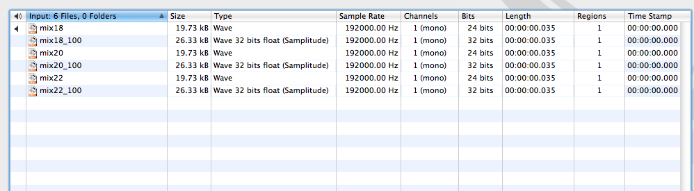

These are Hans' latest 192k test files downshifted four times to 48k. Test signals are now in 4.5k - 5.5k range. See if any of you can hear anything unusual besides missing upper sideband, lack of which now obviosly contributes to sound "signature".
The audio data itself is untouched and there is no downsampling. All I did was some file format conversion (wav to sd2 and back to wav on a Mac) for the purpose of changing file header.
P.S. Hans, your unprocessed 192k files are in 24 bit fixed format, but filtered are in 32 bit float. Just FYI, in case someone has problems in playing them back.

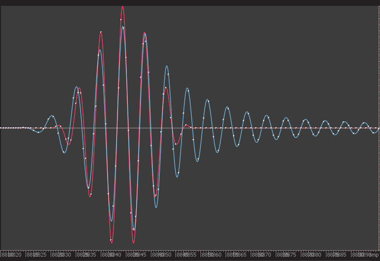

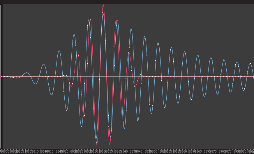

Jn,I've no idea how to interpret the different filters w/r to the time symmetry, others here are far more advanced in that aspect.
1. Don't you think that the test results should not be ignored?
2. I won't let you off the hook that easily 😉
Back in the old thread you said (simplified) that 20k IN thru LP filter leads to 18k OUT and all that you needed is to look at zero crossings.
I deliberately introduced one variable in the test - a different type of LP filter and there you go - you have your zero crossings. And what is the OUT frequency in these two cases??
Even without using a ruler to determine T, I can see that the zero crossings and therefore the so called "f OUT" is different for both of the filters I used.
IMO, if the "f OUT" is dependent on LP filter type, something is wrong here.
Any thoughts?
P.S. I didn't post any FFTs of my experiments, because they showed what they were supposed to show.
P.P.S. For those who didn't read my previous posts - fs was at 88.2k.
