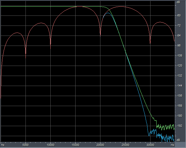

Here we go (well, actually sin(20)*sin(5), but we won't be nitpicking here). As expected, it looks exactly the same conceptually. Pulse center widened to reflect the now more dominant lower frequency, and pulse tails approaching natural ripple frequency of the filter.Yes, direct multiplication, not raised.
That perfectly duplicates a sum of sines. A sin(20)cos(4) is identical to sin(16) + sin(24) with no carrier to confuse the issue. If you block the sin(24).....
thank you in advance for your effort..
Jn
In the spectrum we can see the bulk frequency content is in the 15k and 25k regions, as suggested by trig identities. The filter affects the 25k "hill" only.
EDIT: the high points are *not* at 15k and 25k exactly, more like ~16k and ~24k (not related to the 20x4 thing), the reason being the underlying bell-shaped EQ on the leafes of the spectrum.
This shows that the high points in the spectrum of a blip (not a peridic AM of two infinite sines -- with whatever phase angle, which affect only details of time display) are not a good measure of "where the frequencies are", nor is zero-crossing distances. Both loose their meaning to indicate "frequency" when used with non-infinite sines (single, sums or products) or when EQ is applied (no matter if explicitely or intrinsic to the process).

Nice work, last sentence, well...Here we go (well, actually sin(20)*sin(5), but we won't be nitpicking here). As expected, it looks exactly the same conceptually. Pulse center widened to reflect the now more dominant lower frequency, and pulse tails approaching natural ripple frequency of the filter.
I note you ran the full sine instead of one lobe, great. Now run 20 or 30 cycles and look at the output, your blue waveform. Run it for minutes, days if you want. How long does a sine signal have to run to "qualify" as having a frequency?
I'm not being snarky, just curious where a constant frequency wave of any shape graduates to having frequency, as one lobe "clearly" does not qualify.
Also note, your output no longer has the amplitude modulation of the input. That is the crux of this sideband discussion. The more upper sideband removed, the flatter the envelope and the closer to the lower frequency the output gets.
Ps.. I also assume that with 20 or 30 cycles, your spectra will tighten up due to sample size.
Jn

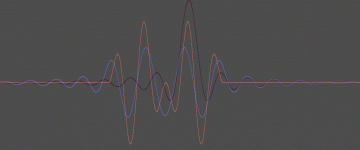

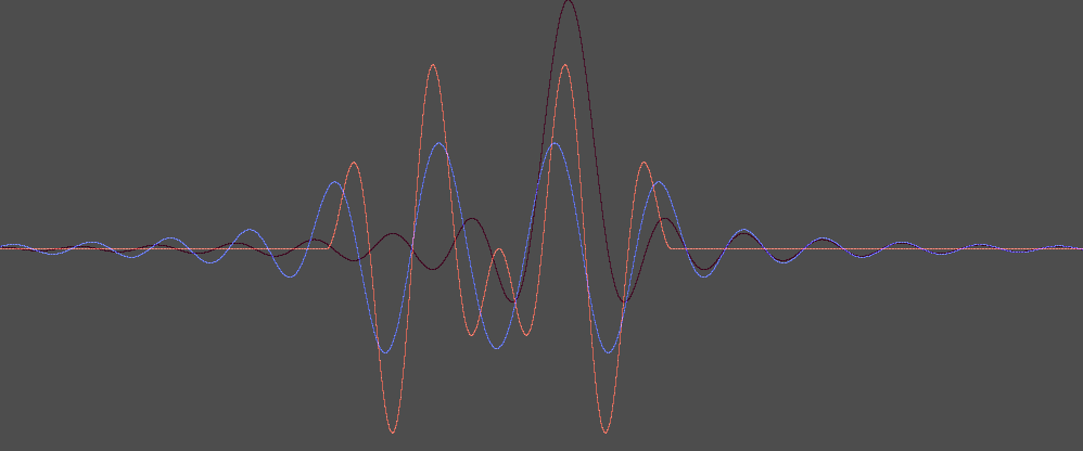

Let's be careful with simplification a bit lest it be misunderstood by others. I said 20k modulated, as a steady state sine will never be frequency shifted by a filter.Jn,
1. Don't you think that the test results should not be ignored?
2. I won't let you off the hook that easily 😉
Back in the old thread you said (simplified) that 20k IN thru LP filter leads to 18k OUT and all that you needed is to look at zero crossings.
As I earlier mentioned, the sum of two sines is a lobed structure with the average of the frequencies as the lobe content. That average frequency is the result of one frequency phase walking the other. If you change the amplitude ratio of the sines, the internal lobe frequency will head towards the dominant frequency and the envelope smooths out more. So the final result will depend on how much of the USB is actually removed. And the average within lobe frequency flips phase every lobe, so does not show up on an FFT. However, as the ratio of the sine amplitude changes, the inner lobe frequency will start to show up on the FFT.I deliberately introduced one variable in the test - a different type of LP filter and there you go - you have your zero crossings. And what is the OUT frequency in these two cases??
Even without using a ruler to determine T, I can see that the zero crossings and therefore the so called "f OUT" is different for both of the filters I used.
IMO, if the "f OUT" is dependent on LP filter type, something is wrong here.
Any thoughts?
Using raised sine modulation (which never occurs in natural music IMHO), the carrier will influence the time domain picture. Removal of the USB in that case leaves carrier and LSB, and the output will look like modulation around the average of LSB and carrier and at half the modulation rate.
As KSTR is heading towards, supressed carrier modulation (the trig identity is two sines added), when the USB is removed. All that is left is the lower USB.
Jn

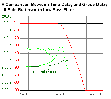

No. There are several issues which affect the sound.
Anyway, I have a question... which of the filters being used here has flat GD to 22Khz?
[The advantage of IIR filters over FIR filters is that IIR filters usually require fewer coefficients to execute similar filtering operations, that IIR filters work faster, and require less memory space. ... FIR filters are better suited for applications that require a linear phase response.]
THx-RNMarsh

Phase shifts? What else?There are several issues which affect the sound.
The books by analog oscilloscope guys @ Tek and HP include very deep analysis of group delay and zeta. (The difference between Butterworth and Bessell is merely zeta; Butterworth has 0.707 while Bessell has 0.866). Look for "Wideband Amplifiers" in the title.
