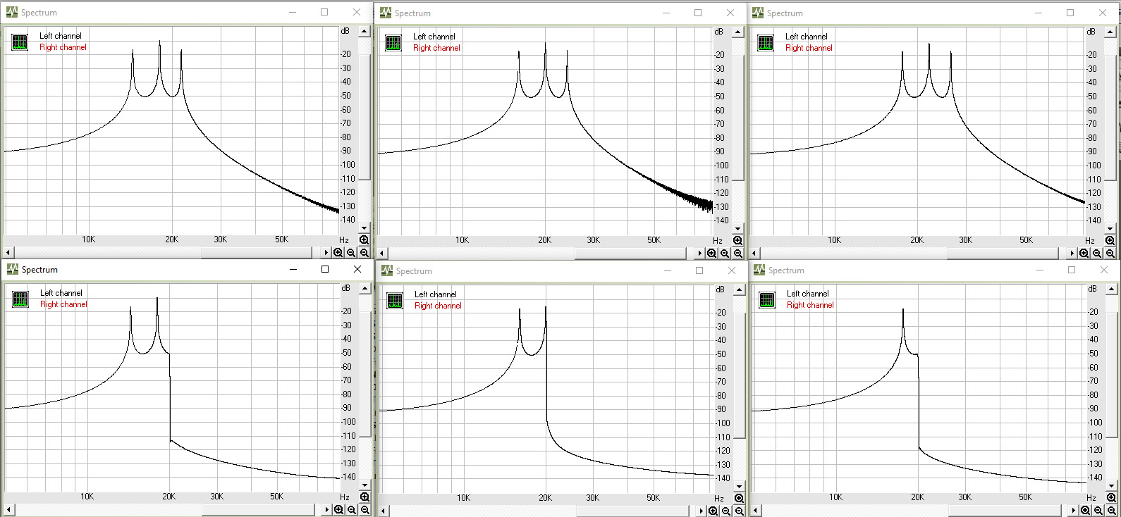

Here You are.
I made 3 new versions, resp 18/3.6, 20/4 and 22/4.4.
All files are also in 20Khz Brick Wall filtered version.
They are now 192Khz, 32bit float, instead of the previous 16 bit versions.
And all .wav files are 35msec long, with 10msec lead in and 10msec lead out, because of the Gibbs ringing added to the time domain signal.

I’ve got no sound coming through on these? They download and play but no sound.
The lowest frequency of the 3 files is 18Khz with sidebands at 14.4 and 21.6 Khz.
That proves at least that you can’t hear 18Khz, neither can I 😀😀
Hans
Haha, you're a funny guy, nothing to do with the fact they only last a fraction of a second?The lowest frequency of the 3 files is 18Khz with sidebands at 14.4 and 21.6 Khz.
Hans
Yah I top out around 15k.....the last time pavel posted a 20k I cooked my tweeter voice coils trying to hear it.
I really don’t think it’s about being able to hear that high, that seems to be the disconnect.
It’s what brick walls might do to the rest of the audible signal?
Yes, in the time domain, not the frequency domain, but......that's where the type of filter comes in
