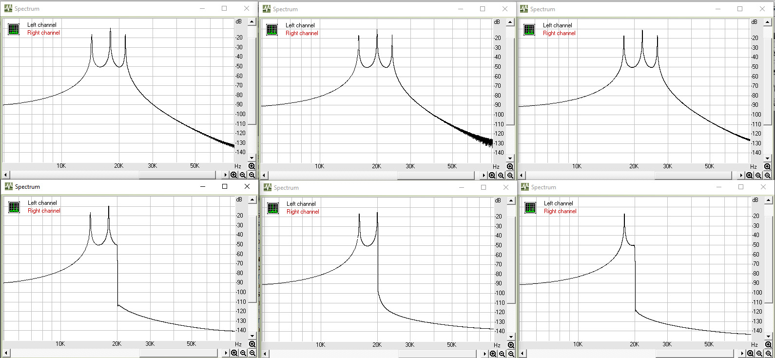

And yes, in the case where the brickwall filter removes the upper sideband, the waveforms will certainly change. But not the frequency. As far as I can see, removing an inaudible upper sideband would probably make no difference to audibility.
We have been talking about Fs near CD sampling frequency. While humans seem to have a nominal frequency upper limit of about 20k, but Kuchnur’s (sp?) research shows that the temporal response goes higher in frequency than that Fs.

20k modulated with and without the upper sideband...
But as continuous tones - so they can be examined more easily...
Just a thought...
Here You are.
I made 3 new versions, resp 18/3.6, 20/4 and 22/4.4.
All files are also in 20Khz Brick Wall filtered version.
They are now 192Khz, 32bit float, instead of the previous 16 bit versions.
And all .wav files are 35msec long, with 10msec lead in and 10msec lead out, because of the Gibbs ringing added to the time domain signal.
