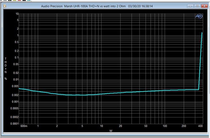

Damir,
I changed the power supply to +/-35vdc at 5A total idle, 24 OP devices and fixed a HF osc with RC at each FET; Improved SOA.
Here is max power THD+N at 2 Ohms.
-Richard

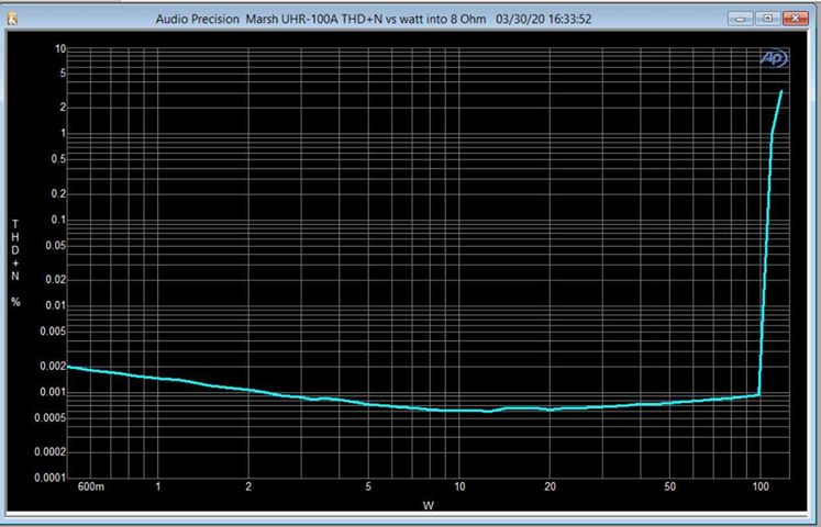

A little more than 100W into 8 Ohms.
-Richard
0.5Watt into 8 Ohm is 2 Volt rms out.
Assume that the specified 20ppm at 0.5 Watt is just white noise.
20 ppm of 2Volt is 40uV at the output or circa 1,3 uV RTI.
Not knowing the BW that was used, but when taking a usual 80Khz, this translates into ca 5nV/rtHz.
Sorry, but I find this a bit hard to believe.

Richard you can't get 100W at 8 Ohm with +-35V DC, some of this is wrong.

Bridged amp with +-35V power supply can deliver 200W/8 ohm but nobody said it's bridged.
Disabled Account
Joined 2012
Not bridged.
he said.... "Use standard (Vdc) x (Vdc)/2Rload'
Might be THD and not THD+N. he will use another instrument to double check the numbers. label at top of screen may be wrong.
PS voltage is actually +/- 42vdc
THx-RNMarsh
