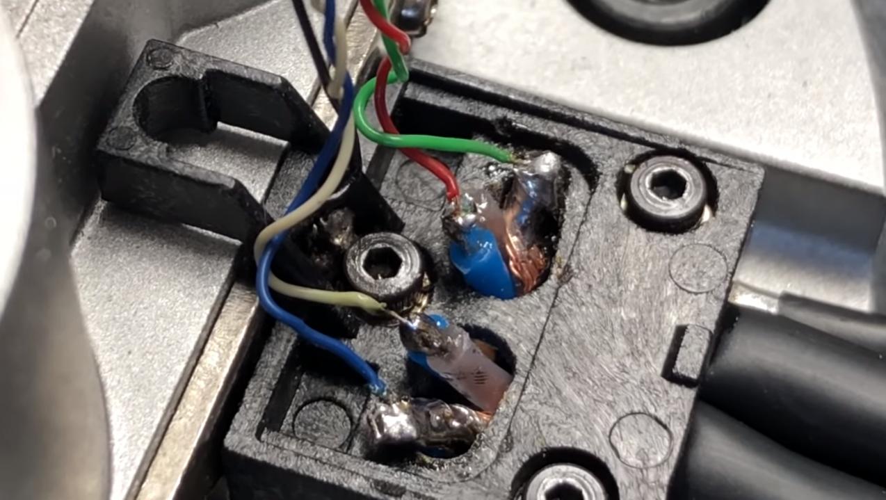

Thanks Paul
Well, heuristic skills is one of the masks of stubbornness (I wouldn’t be able to sleep at night if I had an untraceable hum problem with my TT) :D
So now that I know you are a bicyclist, I am asking you to spare 5 more minutes to ‘run the last mile’ for verifying the root of the hum.
Unplug the TT from mains.
(With preamplifier switched off ) unplug the TT interconnect from the preamplifier .
Remove the headshell from the tonearm.
Using an Ohmmeter :
A. Measure between Earth single wire Y spade and both RCAs outer barrel, one at a time. If there is no continuity, you confirm that the arm’s internal wiring and interconnect are configured as floating.
B. Check for continuity between all four connections at the arm’s front receptacle where the headshell plugs and the RCAs plugs.
C. Check for continuity between arm’s metal body and Earth wire Y spade.
Reinstall the headshell (with the cartridge in place) on the tonearm
Using the Ohmmeter set at low Ohms range:
D. Measure between Earth wire Y spade and both RCAs outer barrel, one at a time. If there is no continuity, you confirm that the cartridge’s electrical connection is floating.
E. Measure resistance between inner pin and outer barrel on each RCA plug. There should be the same value on L and R channels.
F. Check for continuity between headshell metal body and Earth wire Y spade.
At the rear side of tone arm’s base, remove the cover and visually check for proper connection between the arm’s internal wiring [5 wires, red(+) green(-) for R, white(+) blue (-) for L, black for arm’s body] and the interconnect, plus single Earth wire. Reinstall the cover if all found OK.
Then I would unscrew the lower base of the TT and unplug /replug all the wire connectors found there.
Next I would check where I should best connect the Earth wire Y spade at the preamplifier.

Hi George, Hans,
Just back from 2 1/2 hours pedaling. Thank you very much for your inputs.
The wiring was exactly done as shown in the picture George posted. The four thin wires (black/white and red/green) run through the tone arm to a connector to which the cartridge shell can be screwed on. All wires connect separately to the cartridge shell and none is grounded. The shield is connected to ground at the pre-amplifier side. For grounding the turntable and tone arm, a separate wire runs from the turntable to the pre-amplifier.
The cartridge is a Denon DL-103r MC element.
Since I already mounted balanced cabling, it is hard to go back to the original situation, but I measured the old wiring OK on several occasions. The reason for repeated measurements in the past being that I never could get rid of unwanted signal pick up since I bought the bloody turntable almost 40 years ago.
Tomorrow I will do some measurements where I ground black and green at the pre-amplifier side and see if the interference comes back. As all my ventures in audio, it is basically because I am not happy with something I hear. So, like in Bonsai's case, when a single ended connection works fine, I would definitively not touch it.
To be continued.
