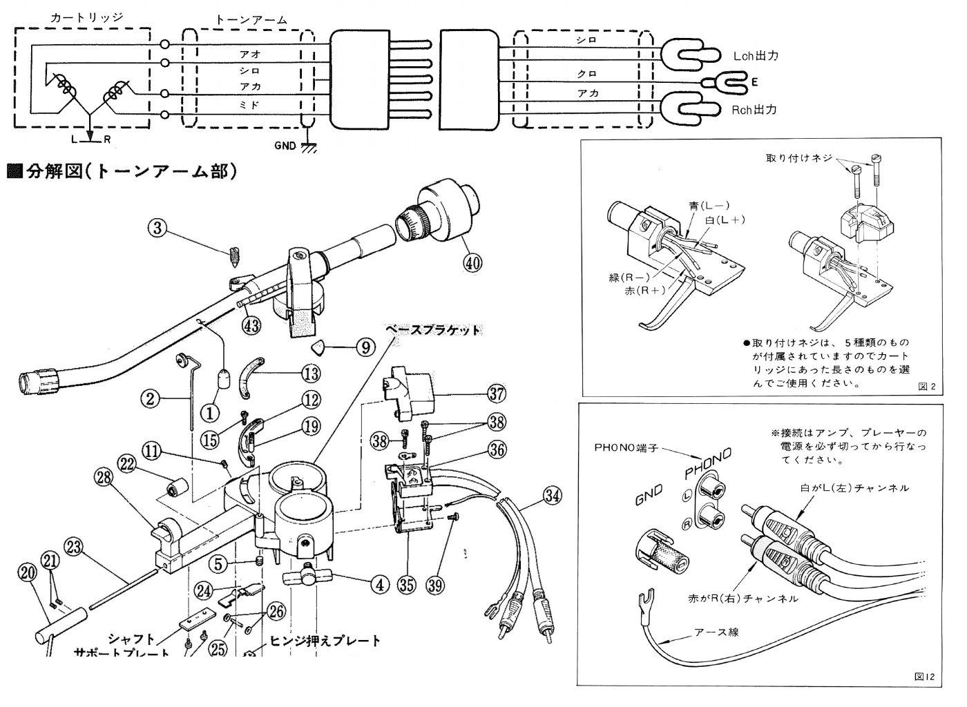

In my case, I have a turntable that I never have been able to get reasonably noise free. Especially hum. Yamaha GT-750. Because I want to play my albums again, I decided to try a balanced setup. And this totally solved the problem, to the point that I have never heard less noise coming from a turntable.
Now, I might be able to replicate your measurements in my specific setup by grounding one of the balanced inputs. Will be continued.
Hi vacu
As far as I can tell, the signal wiring of your GT-750 has all four cartridge wires floating and that is good.
Now check if your cartridge has one of the output pins connected with a prong to it’s body shield. There might be located your problem with the formation of a ground loop.
Depending of if you ground the arm ground pin to your preamplifier, the hum becomes louder or more quite but it never goes away.
So, before doing the single ended/balance comparison, please check if one of the minus pins of your cartridge is connected to body shield and report back.
George
Hi George, your heuristic skills never cease to amaze me. Your possible explanation for the formation of a ground loop definitively makes sense. I am happy to report though that this is not were the problem came from. So the coast is clear to do some measurements.
