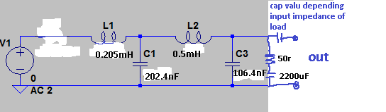

Attention guys I don't hear any kind of pop click using abraxalito 4th passive filter when I change formats between DSD & PCM or viceversa, only a pop when power on I guess because I don't use a bleeder resistor after the output capacitor. Attached schematic.

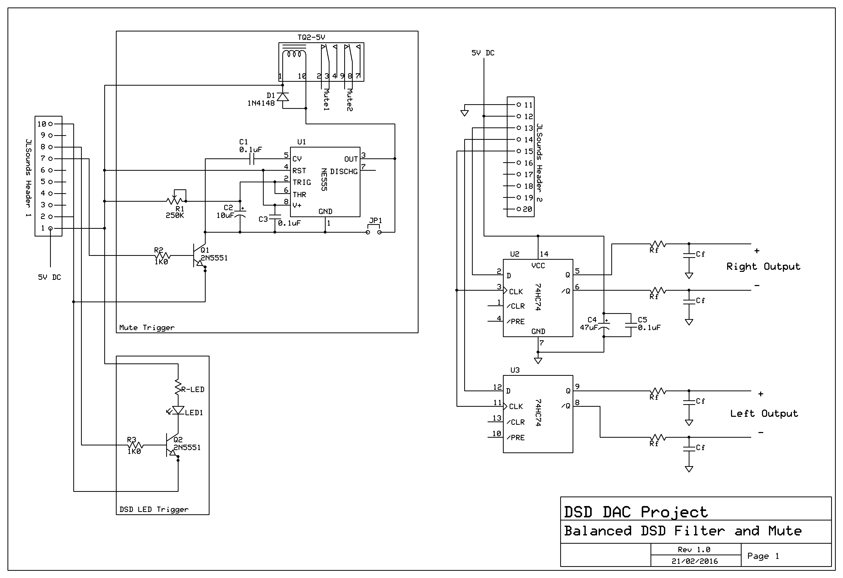

Yes SE, sounds far better than balanced using chips (attached schematic bor balanced isn't mine I guess is published in this thread).
No I didn't wind my own inductors I bought Janzen Wax coils, I bought 0,22mH and take off several turns till measures 0,205mH and the same with 0,56mH taking of several turns to reach 0,5mH
I'm sorry isn't C2 it's C3.

Maybe the huge out-of-band quantization noise intermodulates with itself in the amplifier, causing an increase of the in-band noise floor. What happens when you have two or three RC branches between the transformer and the amplifier, or even better, an LC filter with inductors with a decent air gap?

I don't know. On one hand the power spectral density of the out-of-band quantization noise should get lower with increasing DSD rate, on the other hand, the higher the DSD rate, the more often the signal switches, and the more often the amplifier can be driven into slewing.
noise is roughly the same as the first RC, I wonder if input impedance of next stage may be too low, thats the only thing I can think which would explain so much more noise with the 10 ohm trafo primary.

My experience is the same as you. The higher DSD rate degrades SNR in the analog domain though it can have excellent numbers in the digital domain. It's probably imbalance between rise and fall time of the pulse. The output of DSD toggles frequently even in no sound(the input is zero). Higher DSD rate increases the toggle counts, which results in poor SNR. If you are in the digital domain, no imbalance exists.
Standard FF like 74HC74 doesn't have the same rise and fall time. If you use a high-speed RF DAC(more than 100MHz), you can have better SNR than 74HC74 in my experience because it has almost the same rise and fall time. DSD64 and DSD512 can have the same SNR.
Another way to improve SNR is a multi-bit solution instead of 1 bit(DSD). Degradation by the imbalance depends on bit resolution because DSD always swings from +1 to -1 even in no sound. If you use 2bit DSM, the swing is from +0.5 to -0.5. So, the noise power caused by the imbalance decreases a half. With 4bit DSM, you can improve the noise floor by15dB in my experience, though more than 5bit doesn't dramatically improve SNR because of another analog problem. The disadvantage of a multi-bit is degradation of THD. It's not easy to have coexistence with SNR and THD.
It should be possible to improve things quite a bit with fast flip-flops, logic gates to make it a return-to-zero DAC and a well-filtered supply that supplies only the flip-flops and logic gates. Right now you have all digital noise of the XMOS interface on the reference (supply) of the DAC and the problem with unequal rise and fall times that xx3stksm mentioned.
As an example of a very basic return-to-zero DAC, see how the flip-flops and the NOR gates are connected in this circuit:
Simple second-order sigma-delta for checking raw DSD interfaces
After a rising clock edge, the NOR gate output always switches to 0. Depending on the data, it either does or doesn't go to 1 after the falling edge. This eliminates the effect of unequal rise and fall times at the expense of a worsened sensitivity to clock jitter.
