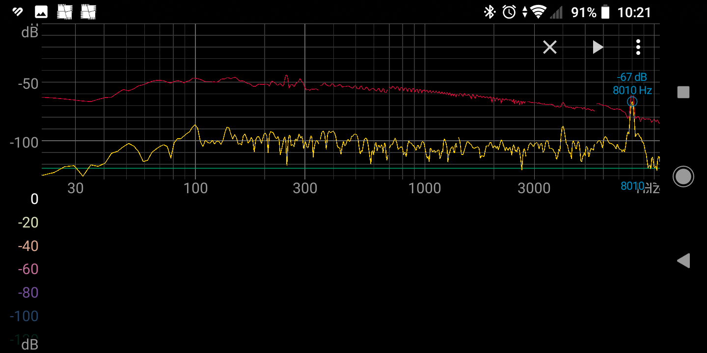

Look the FR of my system when I connect the powered Amanero with the LPF without music or signal, attached pic, when I use phono preamp Valve Itch without music no peak!
