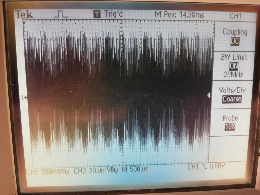

Anyways, I wanted to try it so I got an Amanero combo384 and made a L-C-L-C lowpasfilter for the DSD stream.
I use Jriver as sound software and I downloaded some test files from here:
FREE samples DSF audio files
I tried the 1Khz -11dB file, but only got noise out. See pic 1.
Lriver sees it as a 382,5Khz 64 bit and amanero dosent recognize it as DSD either.

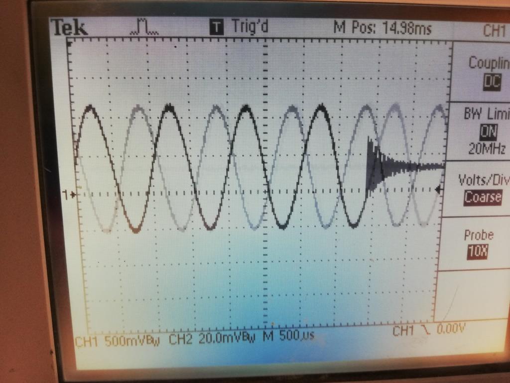

So I let Jriver convert all incoming formats to DSDx4 and now amanero puts up the DSD flag and out of the lowpasfilter comes a 1khz sinus Pic. 2.BUT
Something is wrong. You can clearly see the trigger is being f''''' up by this .

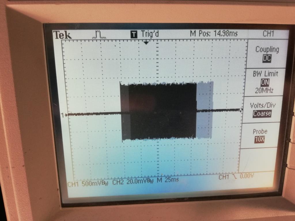

If I adjust the time base on the scope, I could see that the sinus is interrupted by silence half of the time.
What is going on here?
Can anybody help me?

I think a lot of people, including me, have moved onto this approach to DSD playback;
Signalyst DSC1
If you check out the last few pages of the signalyst thread you should find some info on the best Amanero firmware for DSD.
Thanks, I have now actually read that thread too now and I noticed the mention of the software update. I also noticed it at this page:
PureDSD
Aparently this is a must for the amanero USB board?
