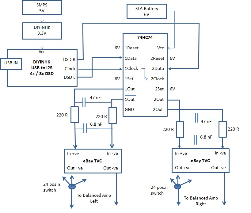

Anyway, finally got around to making some changes as discussed above. I bought the DIYINHK USB board. I also built a LPF as I threatened to do. Here is my summary.
1. My PC hasn't got enough guts to upsample 8x. So I am continuing with 4x till I upgrade my CPU. As far as I can tell, not much difference between JLSounds and DIYINHK at 4x.
2. I tried a passive 1st order LPF between the flip flop and TVC. Still some noise evident at fade in and fade out of songs. So I have now gone to 2nd order filter. F3 = 40k, and there is enough attenuation - I can't hear any DSD noise above the roar of the CPU fan.
3. I am happy with what I am hearing. Until I can upgrade PC, my no-DAC DAC will look like this. Not quite as simple as I wanted it to be, but as simple as I can make it.
4. While this is as good as I have heard digital - I still prefer records.
Note - my phono RIAA amp has adjustable gain, which I use a volume control. So I no longer have any pre-amp in my system, just a source selector (DP/DT switch). I think I have reached a point now where I can't simplify any more. So now I can relax for a while and enjoy some music.

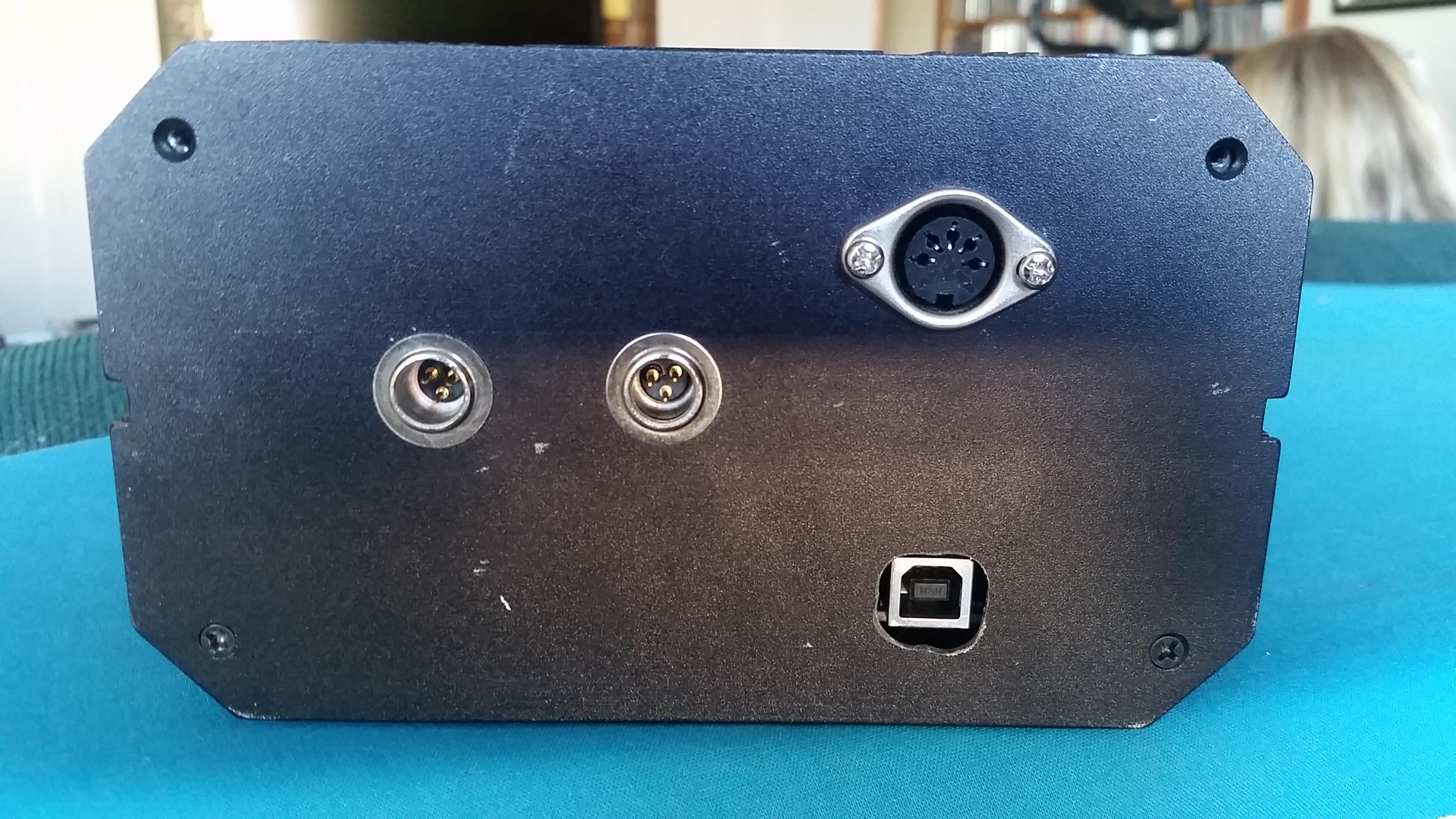

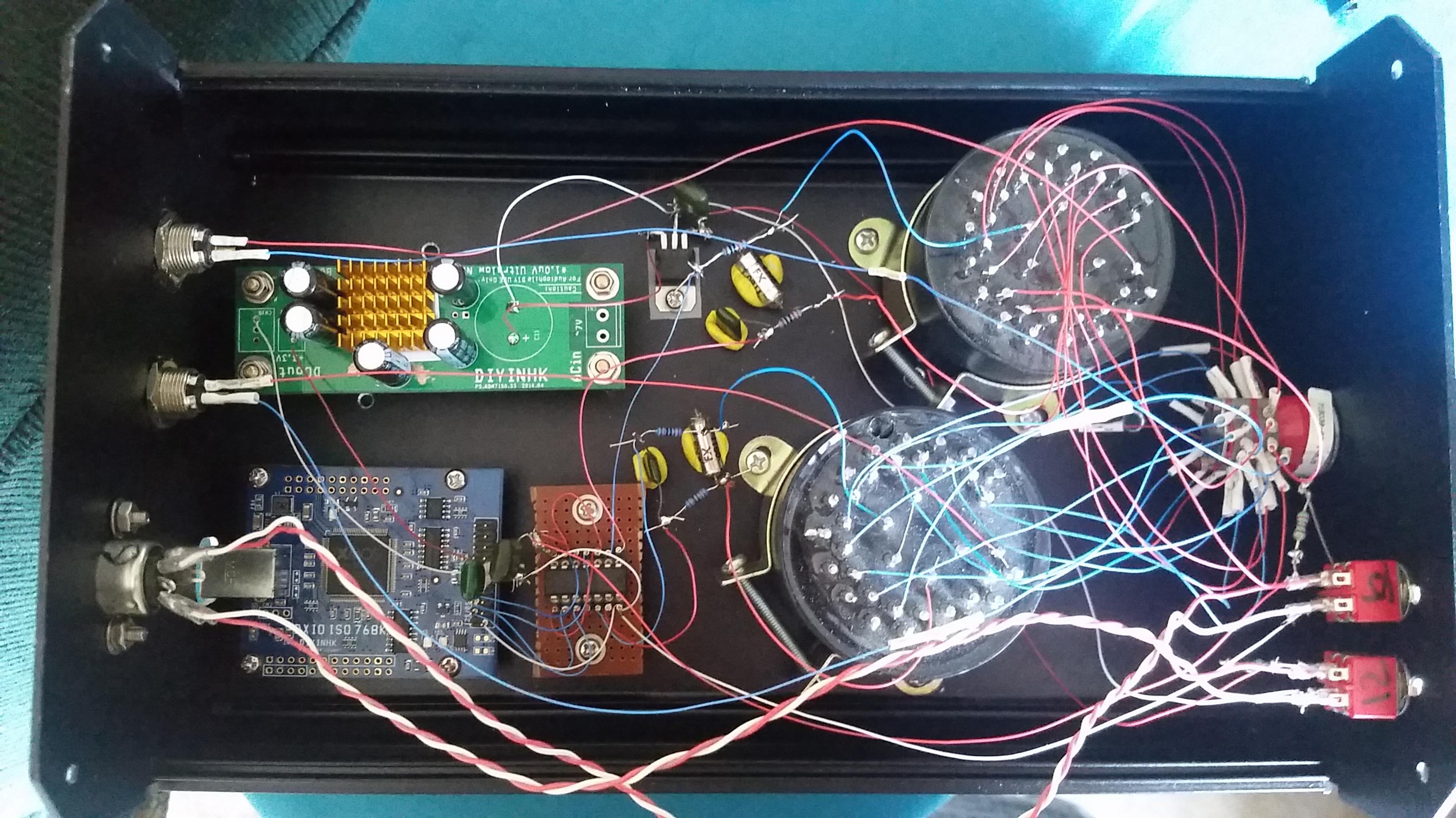

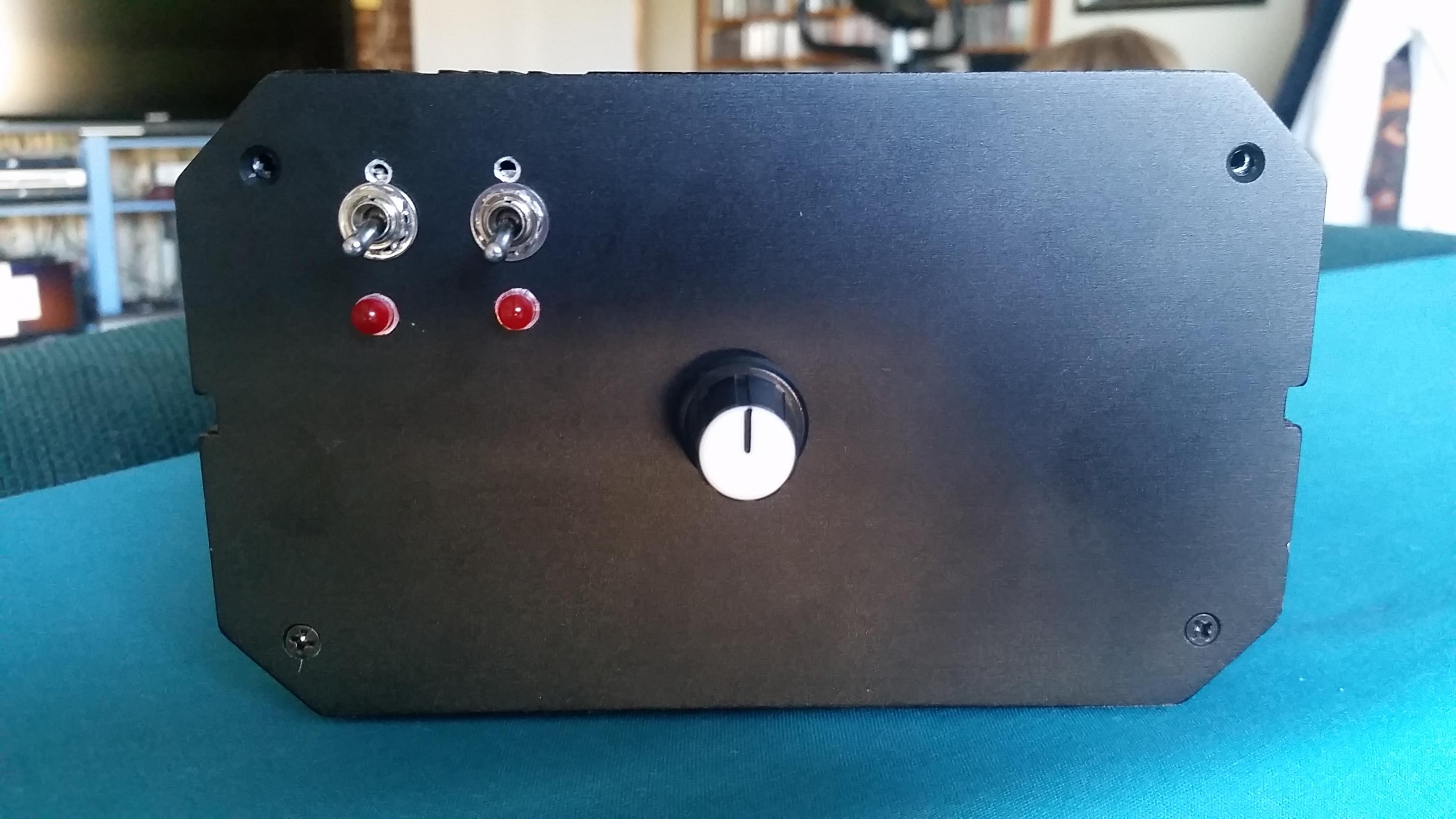

A picture is worth a thousand words. Or 3 thousand words in this case.
DAC Front - one power switch is for USB board, and one power switch for the flipflop. And one knob for the 2-deck volume switch.
DAC Rear. Power socket, USB input, and 2 mini-XLR sockets for the output.
DAC inside - the TVCs take up most of the space!

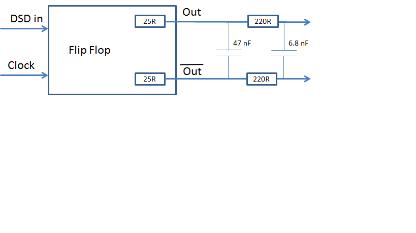

2nd order low pass filter attached schematic
R1 & R2 220R
C1 47nF
C2 6.8nF
R1 & R2 220R
C1 47nF
C2 6.8nF
Yes, this is a 2nd order LPF but not the one I am using. Note that the flip flop has a finite output impedance, I estimate it to be 50ohms based on my experiments with 1st and 2nd order filters and perceived roll off. This impedance is very much part of the filter, though it is not shown explicitly on my circuit diagram. And don't forget - my filter is balanced and differential.

Regarding the PS for USB board - there is a small error on my schematic. The external power supply is 12V SMPS (which also charges the SLA battery). Inside the no-DAC, the 12 V line feeds a (noisy) 7805, which cascades into a low-noise 3.3V regulator, both are visible in my picture in earlier post. Do you think that the 2 linear regs in series will undo the evils of the SMPS? I also thought about inputting 6V battery power directly to the 3.3V reg, but I think that this will undo the goodness of the battery - a chain is only as good as its weakest link - is there any advantage to providing battery power to the USB board if it is subsequently regulated?
1.0uV Ultralow noise DAC power supply regulator 3.3V 5.0V 800mA - DIYINHK
I see that your USB cable is custom. Are there any commercial equivalents? And if the USB board already has isolation, is there any advantage to additional isolation? I mean, most of the processing is already done in the computer using dirty computer SMPS, a little bit more on the USB is not going to hurt - as long as it is then isolated and re-clocked before it goes to the flip flop. IMHO, anyway.
