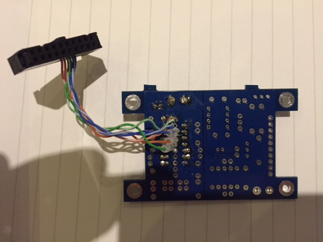

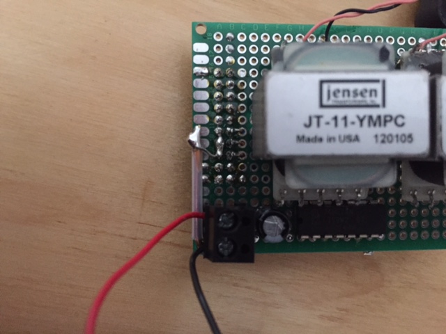

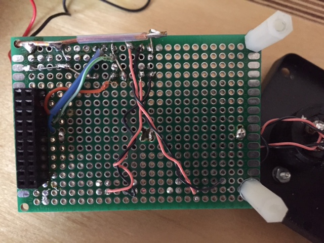

Here are the pictures. The first one is for the PCB in this thread, the other two for the point-to-point implementation.
Just in case is relevant, the flip flop power supply is 3.3v from a Lifepo4 battery.

Your picture of the FlipFlop PCB shows most of it unpopulated?
On the veroboard are you using just the transformers with no LP filter?
Are you using any isolation between Amanero and flipflop PCB or veroboard?

I have not populated the muting section of your pcb. I also thought the transformers would provide enough filtration.
That's what I have. You do not mention connecting the amanero ground (or whatever usb2dsd converter) ground to the flip flop pcb ground. 😕
