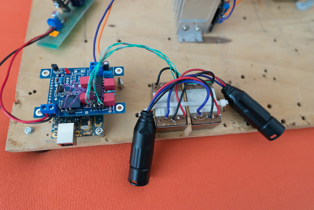

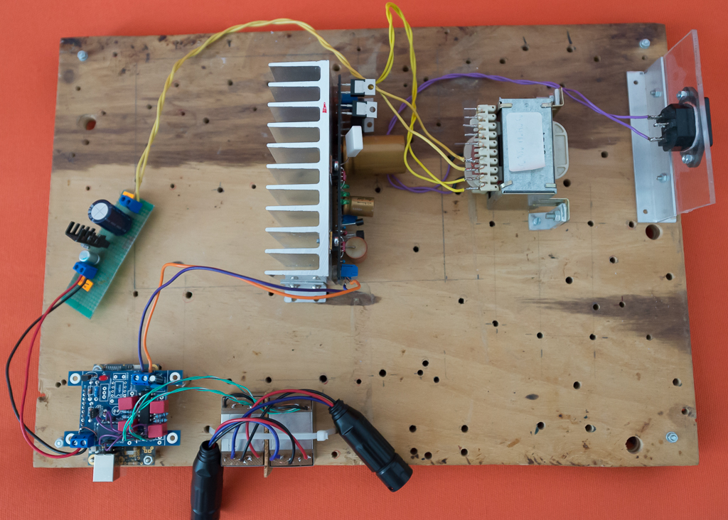

Can you post some pictures of your implementation?
Just a quick recap of my experience so far.
Flip flop board, both with and without isolating transformers (LL1676). 7805 for usb part of JLSounds board, Salas BiB for the isolated side and flip flops.
Muting relay takes perfect care of pops and generally there is low perceived noise and complete lack of switching artifacts.
A quick look with a scope at the output shows horrendous noise superimposed on a 1kHz sine. Changing the output filter values allows for a perfect, noise free 1kHz sine, but only at the expense of cutting into the audible range. A higher order filter looks like a must to me.
For listening tests i have only used 64 and 128 dsd files in dop and briefly tried the real time conversion of jriver from pcm.
Some tracks are listenable, but generally there is no comparison to a "real" dac. Especially poor are the bass and imaging. Voices are quite good.
Apart from the added voltage gain the transformers did not contribute anything worthwhile to the sound, so most of my listening was done without them.
My setup is not optimised for dsd and even less so for RT conversion. This may be a reason for the poor results. Still, a very entertaining project. Many thanks to Nautiboy for making it possible.

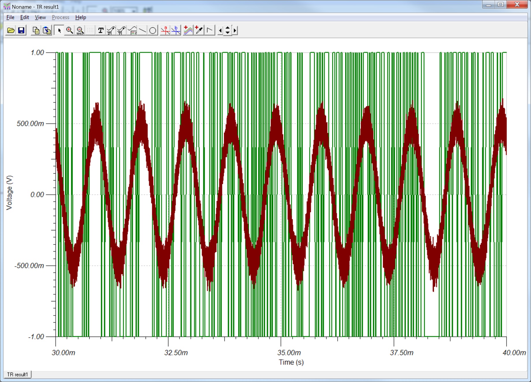

Here attached is a simulation of DSD64 with 3.3k/1nF RC filter. Are you getting something like that? (Note that the green trace (DoP) doesn't show all its true detail.)

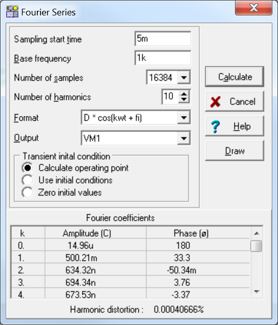

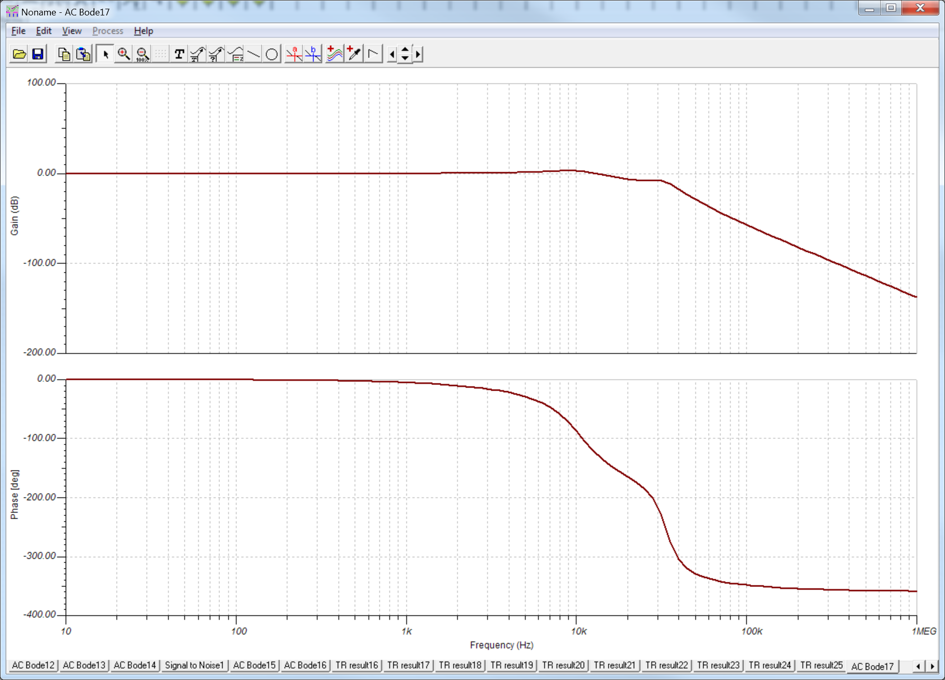

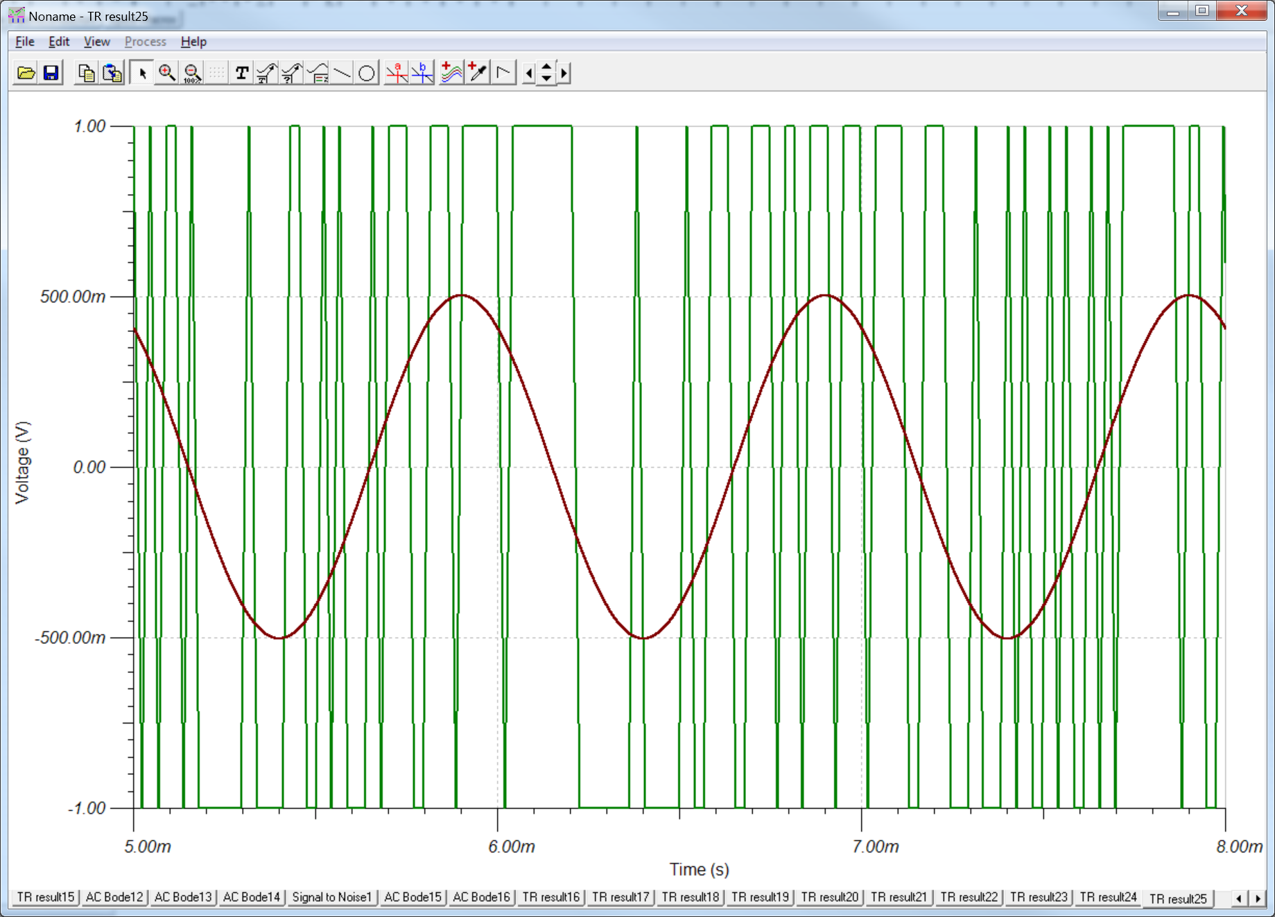

A few sims
A quick and dirty RLCRLC filter using DSD64 Everything is good except the phase. Hopefully others will fix that or be able to scoot the filter to higher frequencies when using DSD256...
Or, since we are running PC audio here, EQ it with DRC.
You can export from TINA and import into HOLMImpulse, but I'm not sure you would want to. Inductors have different values at different frequencies, so that is probably not ideal.
