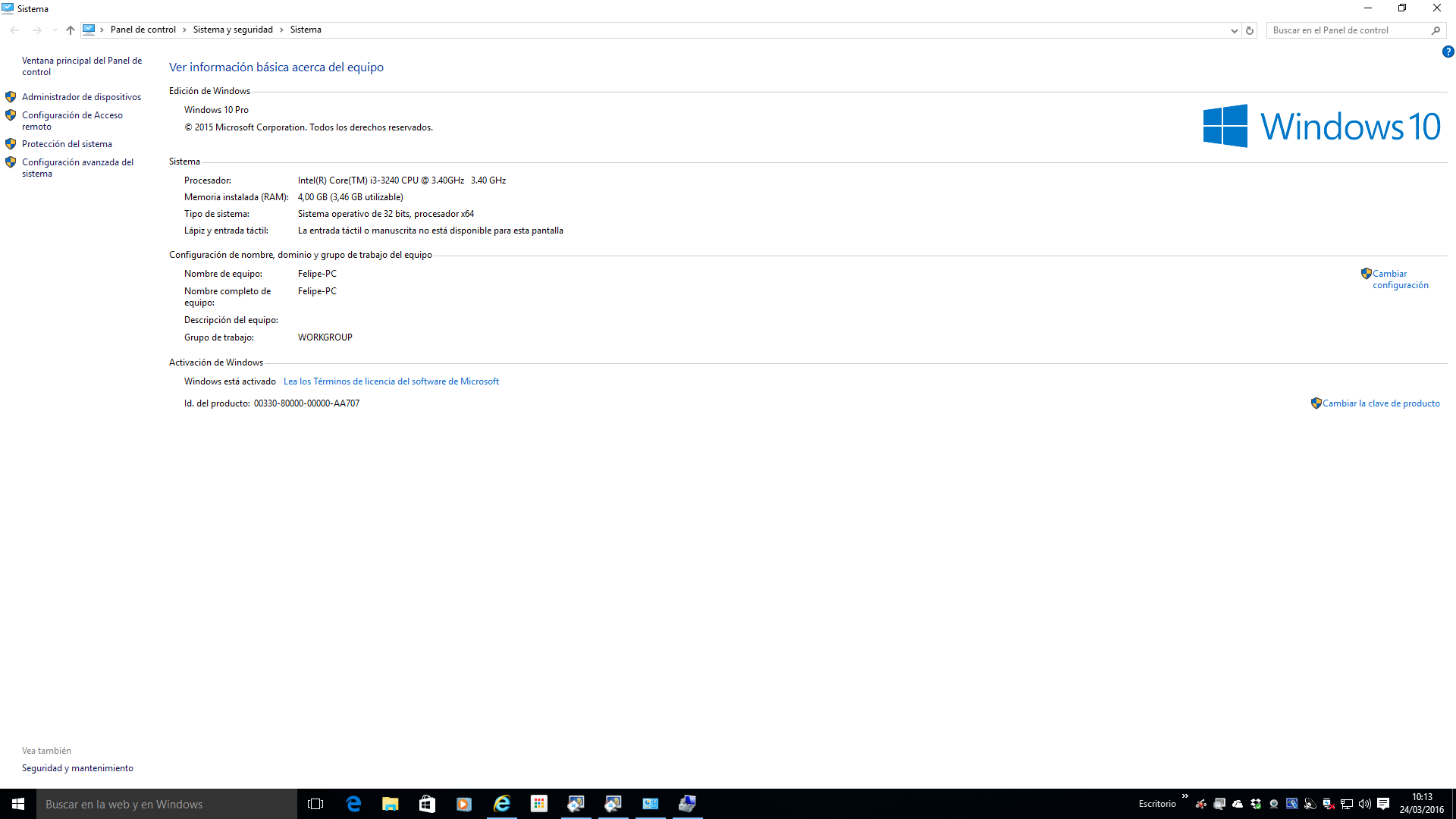

Daphile don't have 32bits kernel rt😡
Is You'r PC 32 bit or 64 bit? I doubt it is 32 bit PC.Daphile don't have 32bits kernel rt😡
... quote from Ray:
... quote from Felipe:
.. So Felipe - if I interpret your not too happy smiley correctly - then you would also use the real-time kernel version if you had a 64 bit operating system?
