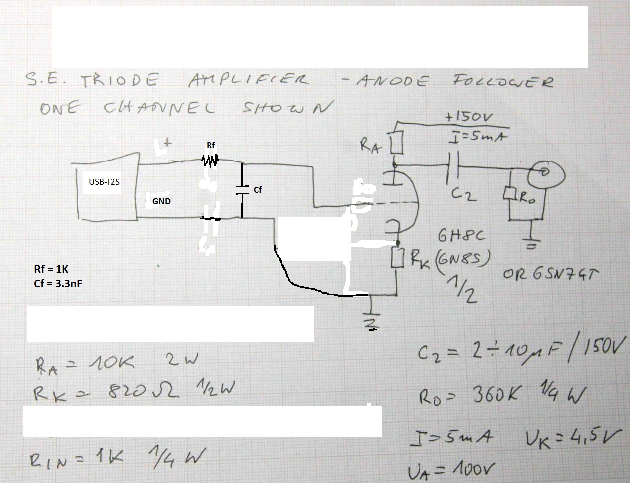

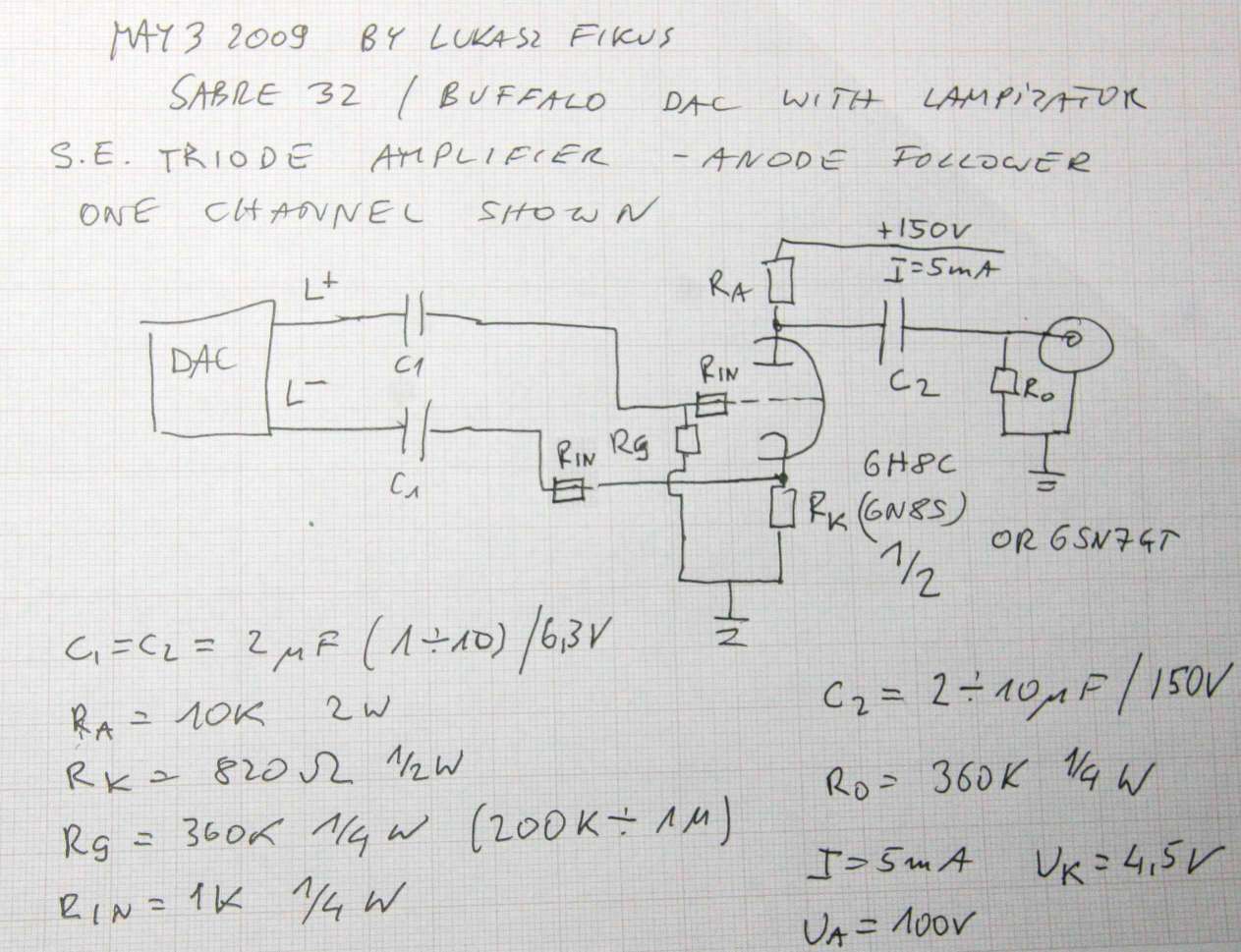

Can work this tube output to increase the gain?
I'm now using these FlipFlop devices, which work well in my project, but it's up to you; I'm not recommending them above any other FlipFlops because they sound better or anything like that.
https://uk.farnell.com/webapp/wcs/s...mjcfiGg6qiOldeqj3joIQ/Zzng=&ddkey=http:Logoff
Ray
Thanks again, I'm just trying to follow you as better as I can, to have a somehow comparable situation. BTW, you think the SE output is so low? I'm putting a Salas Dcb1 in front of it.
I'm ordering parts next week. The LP parts are off board, I remember, right?
