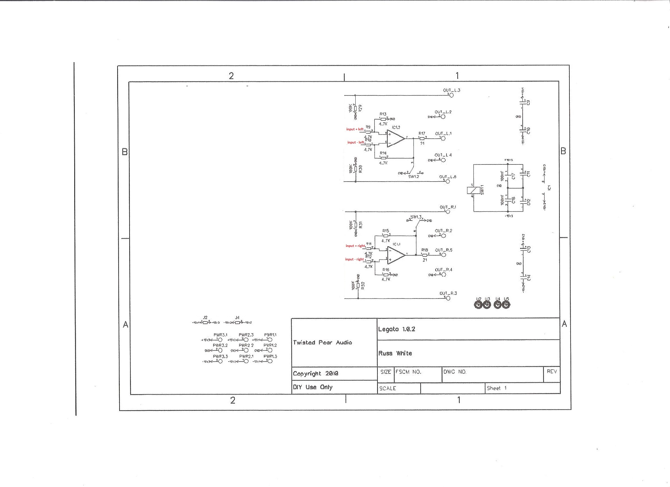

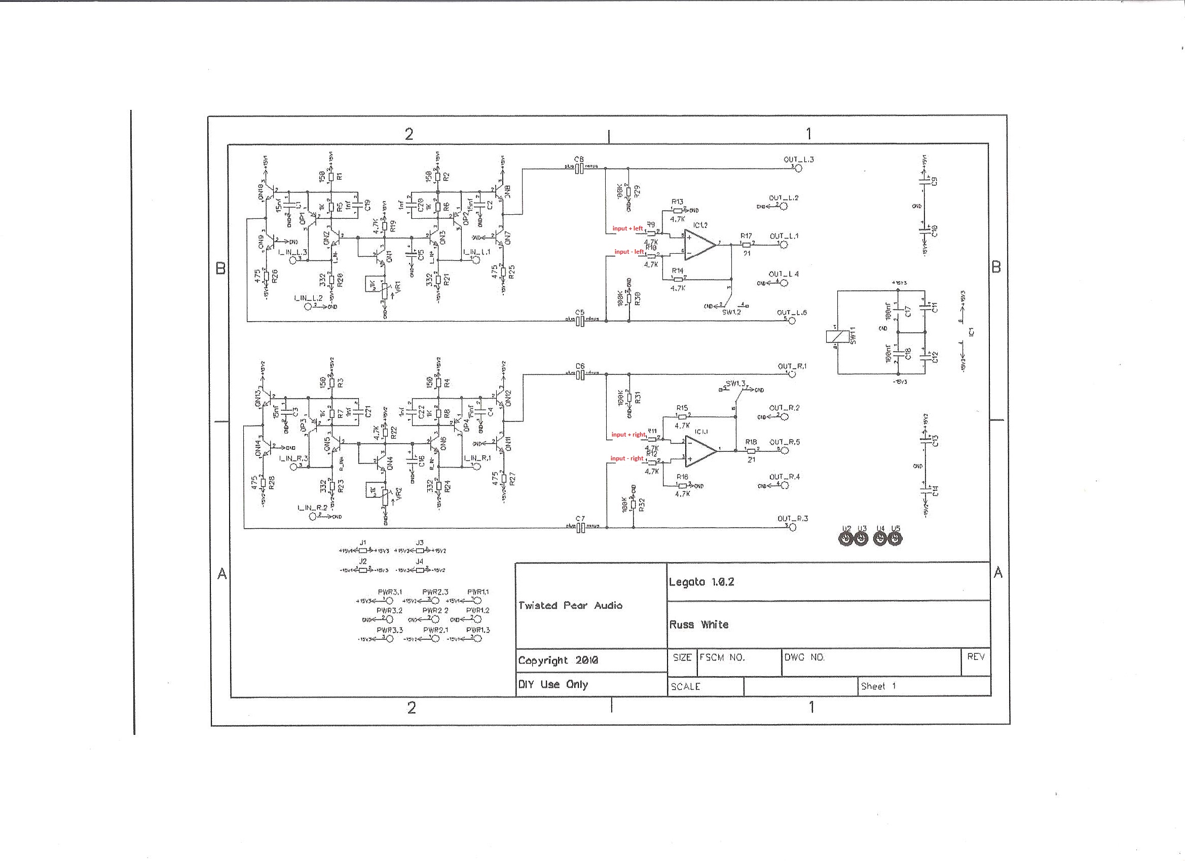

Waiting to arrive the FlipFlop boards I was looking for unbalancer circuits & remembered that I own an old Legato 1.0.3 so why not use only the unbalancer circuit? Also remember to extract the four jumpers J1, J2, J3 & J4 to only power the unbalancer section.
