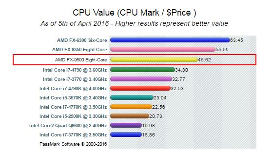

If it were me I would leave the i5 and look for a used workstation with a Xeon processor; Xeon are more optimised for number crunching processing than the i5/i7 ranges (because they don't have the on-chip video etc.).
I would aim for a processor that benchmarks at around 8000+. Here's a site with processor benchmarks;
https://www.cpubenchmark.net/high_end_cpus.html
I have a Xeon E3 1240 3.3GHz processor which benchmarks at 7974 and comfortably upsamples CD rips to DSD256.
Check out the used commercial kit resellers in Spain
Ray
Performance divided by price:
Your forgetting this;
I posted you some info about the PC I use a couple of weeks back; I'm using a reconditioned HP Z210 workstation that only cost me about £200...
There seemed to be far more suitable reconditioned/used Intel-based PCs available than AMD ones, other than that I can't get too excited about who made the CPU.

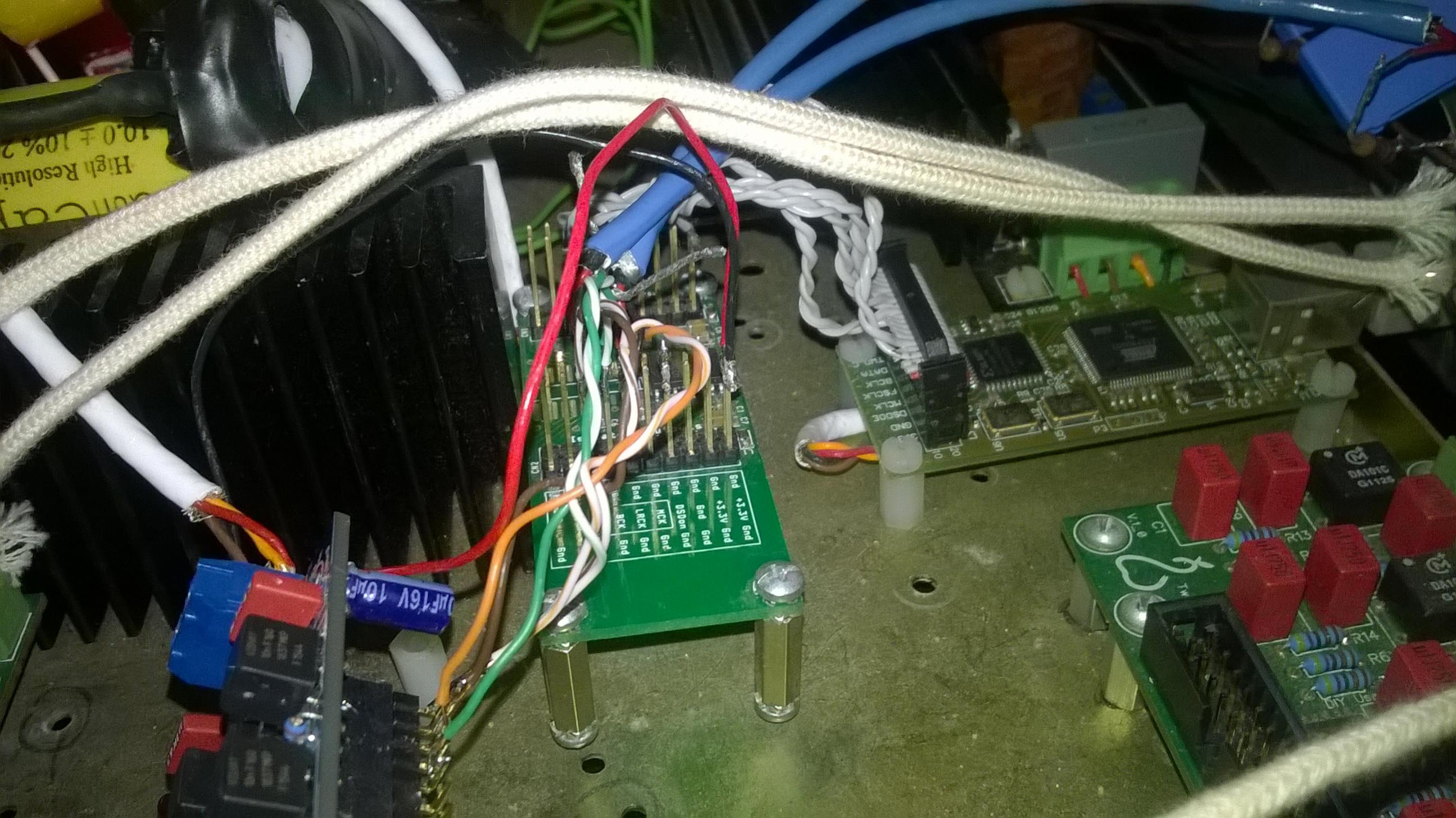

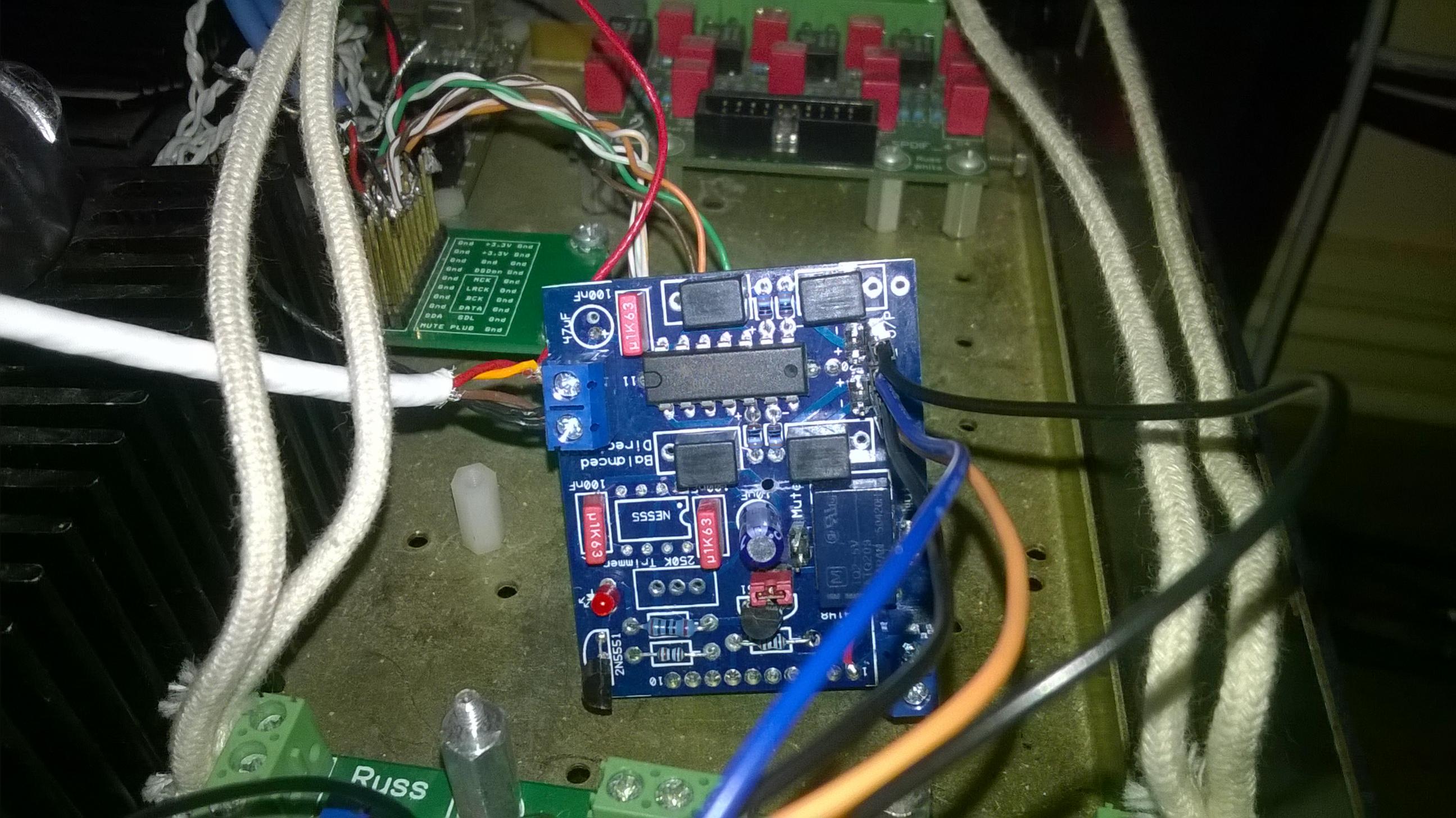

@Ray
Finally I got music in both channel using the Flip Flop but mixed with high white noise in both channels, at the beginning of the thread some people mentioned the psu powering the Flip Flop can modulate the signal and I suspect also is the same that I have because when used SE sounds without any kind of noise. I'm using to power the Flip Flop a Salas Reflektor shunt regulator specially designed for powering digital so I ask Salas if it's possible to add something at the regulator to filter the white noise.
Felipe
@Ray
Felipe
I'm not convinced it's the power supply - the Salas Reflektor is a very stable low noise power supply.
Can you post a picture of your implementation.
I don't have very long this evening as I'm on my way out but on a quick cursory glance;
The connections from the isolator to the FF board are very long and unscreened. The FF PCB layout deliberately keeps the digital paths very short when it's plugged onto the JLSounds board and I suggest you need to do something similar.
You need to twist output wires s from the FF board and possibly screen them. They'll act like aerials as they are.
Ray
