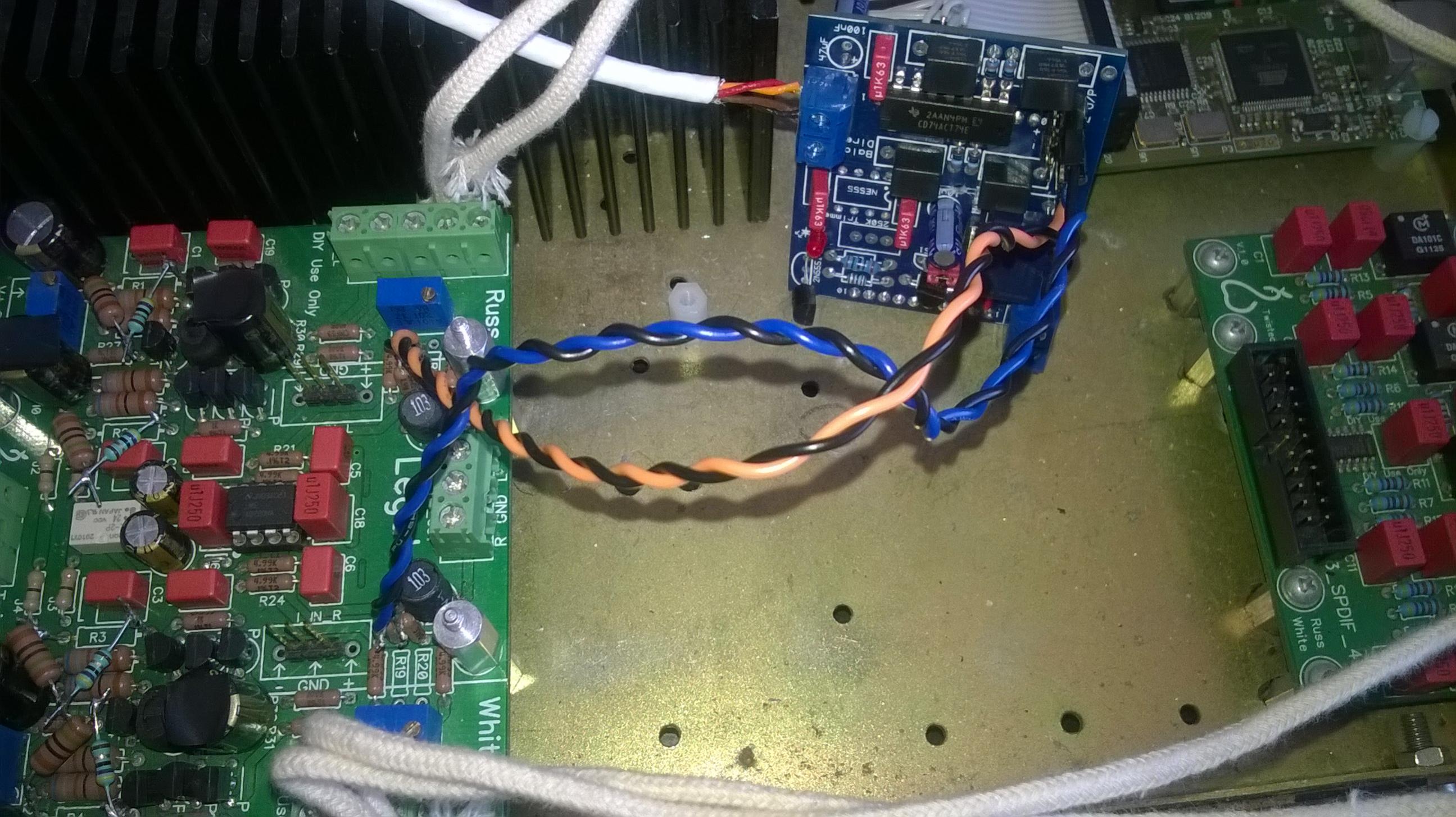

I make no claim to electronics expertise so this may be like the blind leading the blind but, looking at the pictures again...
Brown, green and orange wires take the digital signals for DSD-L, DSD-R and Clock from the isolator to the FF board (pins 13, 14 & 15)?
You have three white ground wires from the isolator to FF (pin11)?
You have 5VDC supply to the screw terminal connector on the FF board? you power the isolator board via the black and red wires from the screw connector to the isolator? The isolator says 3.3V supply?
You seem to have a lot of ground connections. Disconnect the white wires from pin11. The Reflektor, Isolator and FF boards will all reference via the ground connection of the screw terminal connector.
If you use the SE board, with everything else the same (except the Ballsie), it all works, just with the lower output level?
Have you tried the FF board connected direct to the Amanero, without the Isolator? Could you make up a really short ribbon connector to connect the Amanero to pins 11, 13, 14, 15?

No to excuse me about the poor wiring, the same wiring worked OK with Sidecar.
PIN 13 Brown DSD-R
PIN 14 Orange DSD-L
PIN 15 Green CLOCK
Yes all three white wires are GND of DSD-R, DSD-L & CLOCK
Isolator tolerates 5V, worked OK 1 year or more.
If you use the SE board, with everything else the same (except the Ballsie), it all works, just with the lower output level? Yes
Without the isolator add big buzz noise so worse.

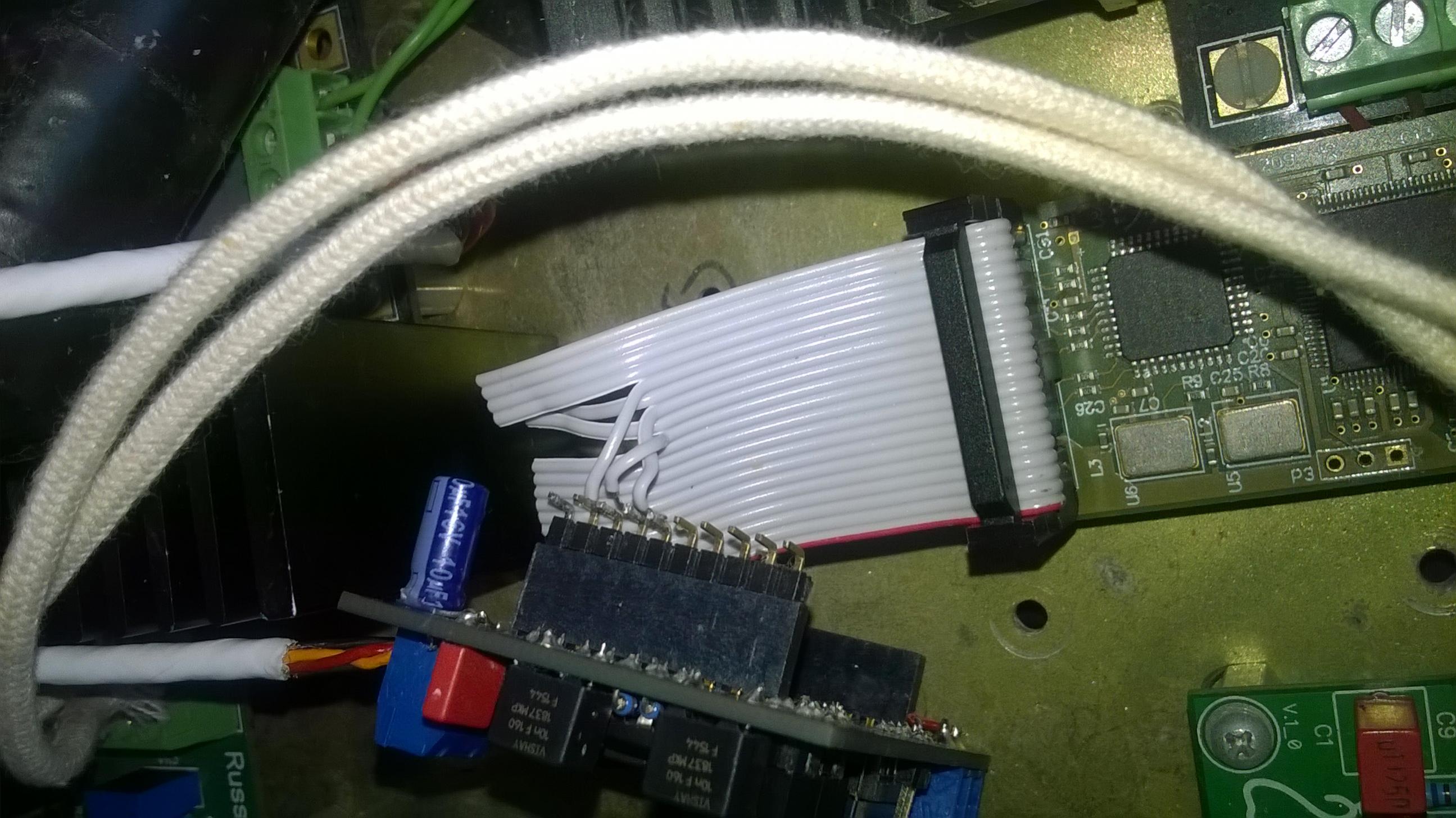

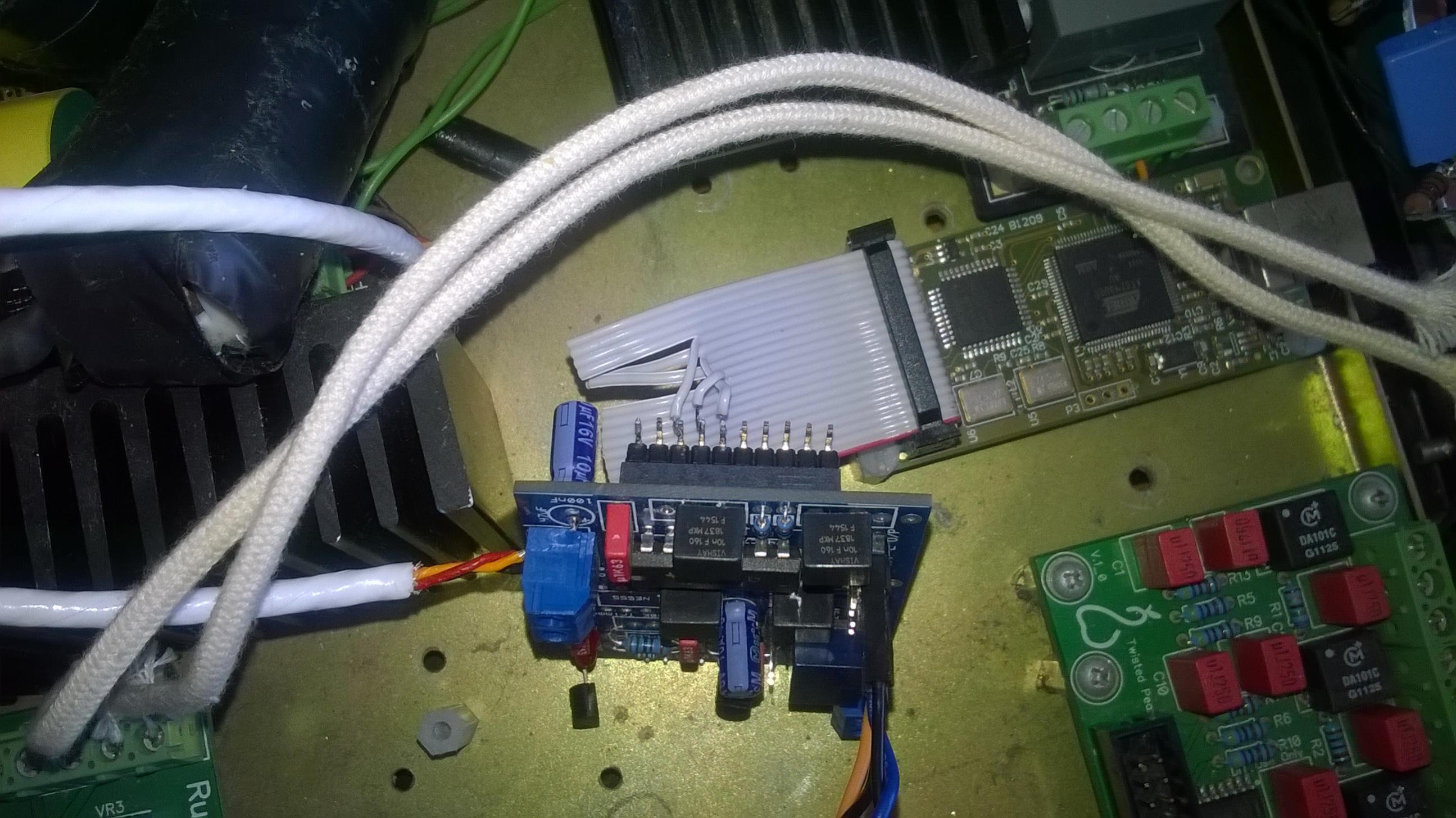

I've just been listening to my modified FlipFlop based project and the results are amazingly good and with no audible noise.
I'm using a JLSounds USB board with the flipflop board piggy-backed onto the headers. The FlipFlop board has LP filters at 40KHz (Rf = 390R, Cf = 10nF). The balanced output goes to a balanced shunt attenuator then to a Broskie BCF Bal to SE buffer. DSD material is upsampled to DSD256 using HQPlayer.
I modified the project by adding in the attenuator; originally I planned to use the HQPlayer digital volume control but that produced a lot of white noise, which disappeared when the HQP volume control was disabled.
Here are a couple of pictures;
I received the extra batch of PCBs this morning so I actually made one of them up and installed it; I just need to enable and set up the mute function now, hence the empty IC sockets.
As said above, I have no white noise. I'm controlling the stop/start bumps with the volume control until I install the mute circuit components.

As you can see I modified my wiring to 3 cm I2S between the Amanero & the FF and used twisted wires between the FF & the Balsie, also the Balsie connections are confirmed by Brian TP that are OK.

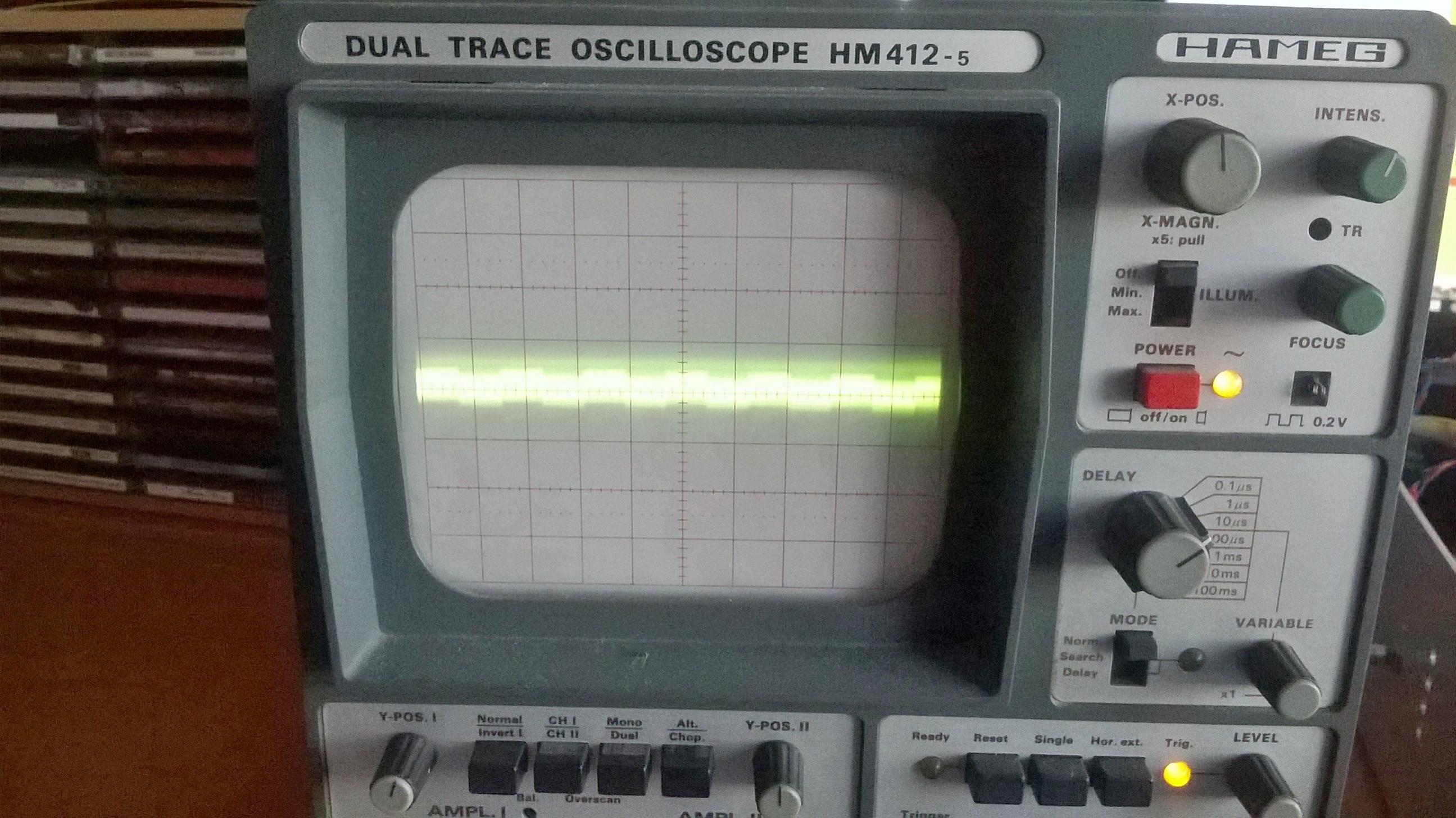

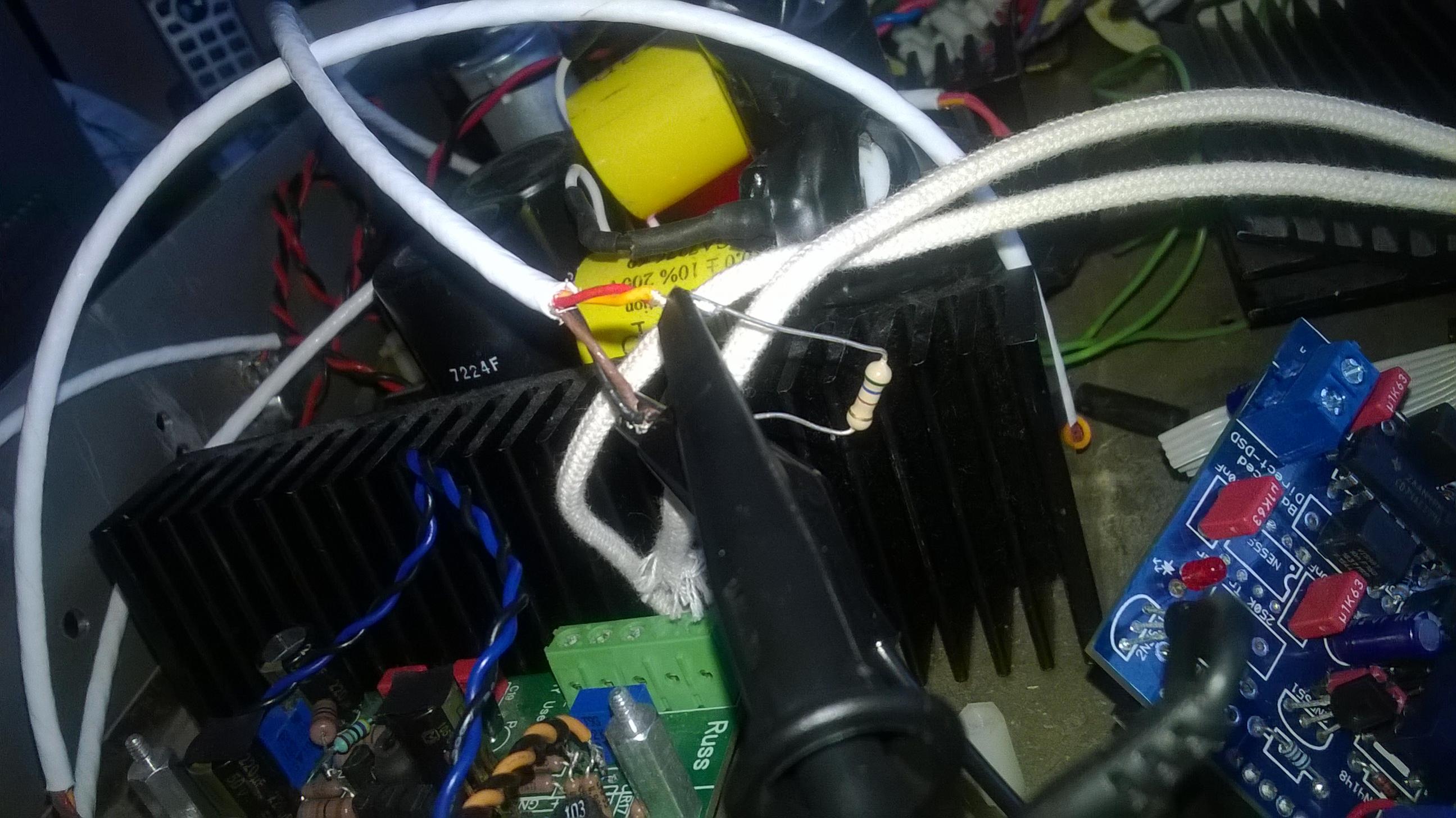

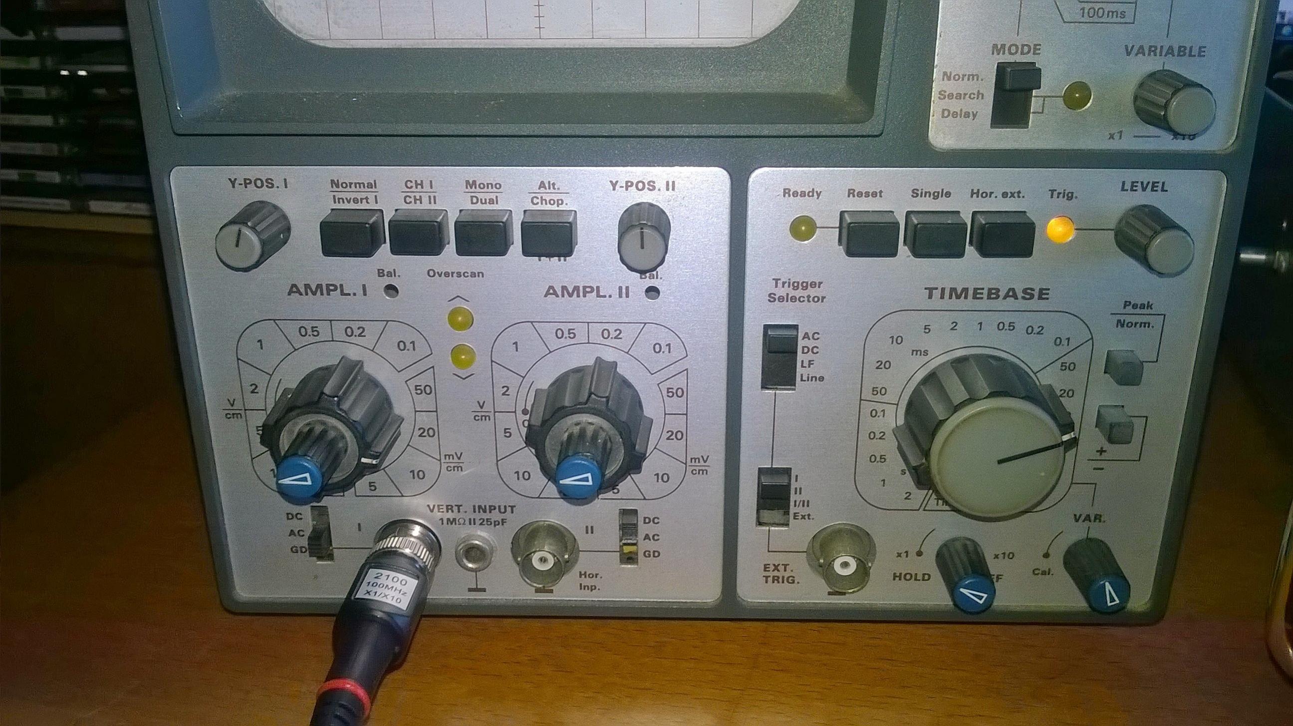

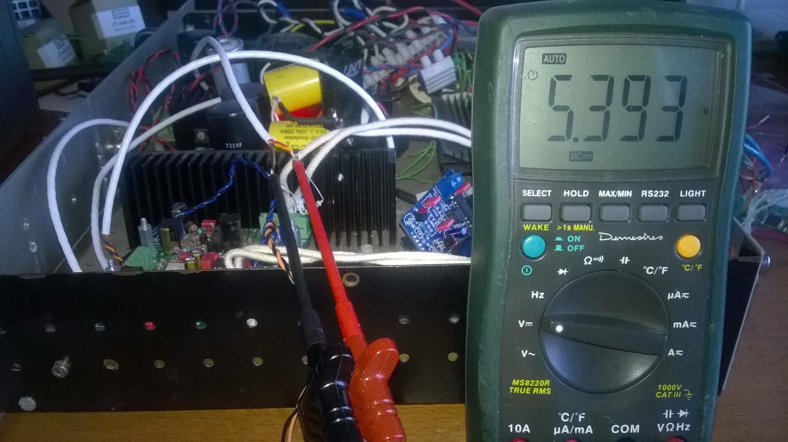

Well some data:
Reflektor-D supplies 5.4VDC to FF
FF draws 10mA
Attached scope pics with FF connected to Reflektor-D and 560R dummy load connected to to Reflektor-D, the scope straight line is the dummy load.

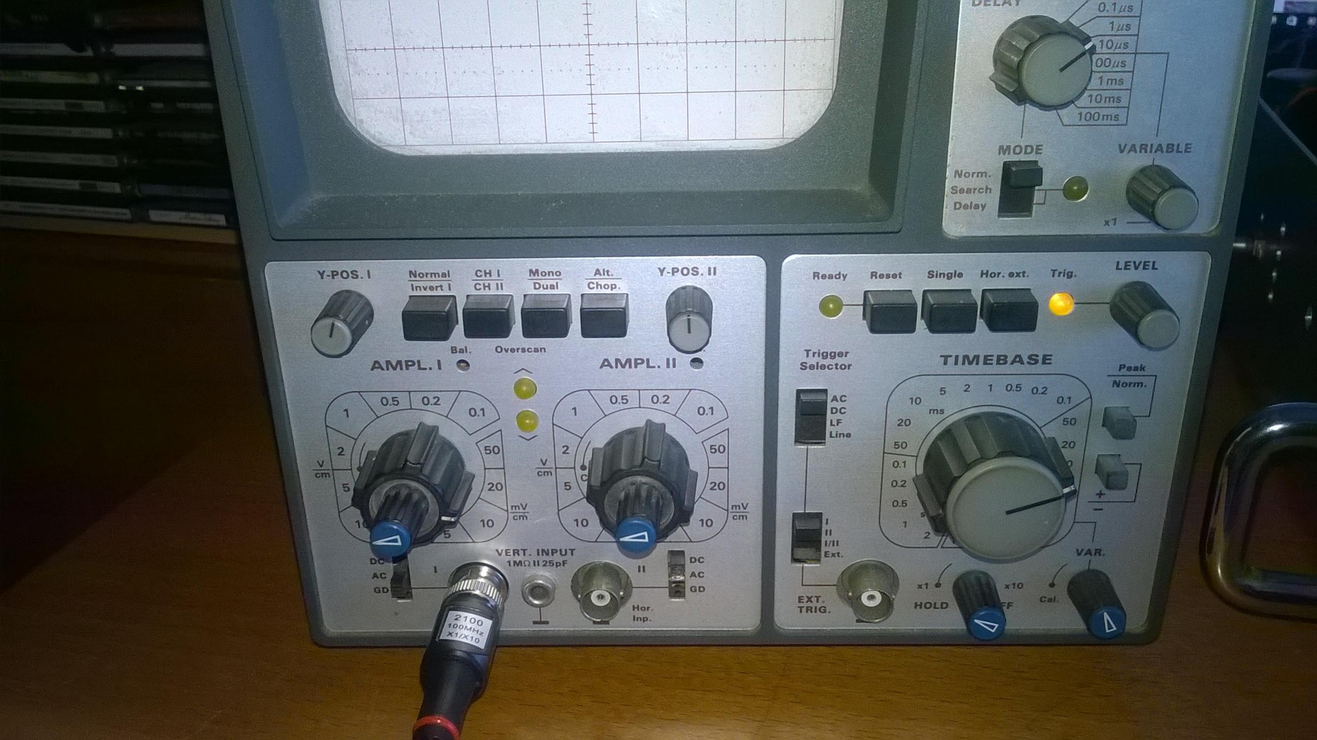

Ray as you can see FF produces some modulation on the first scope picture.
Felipe

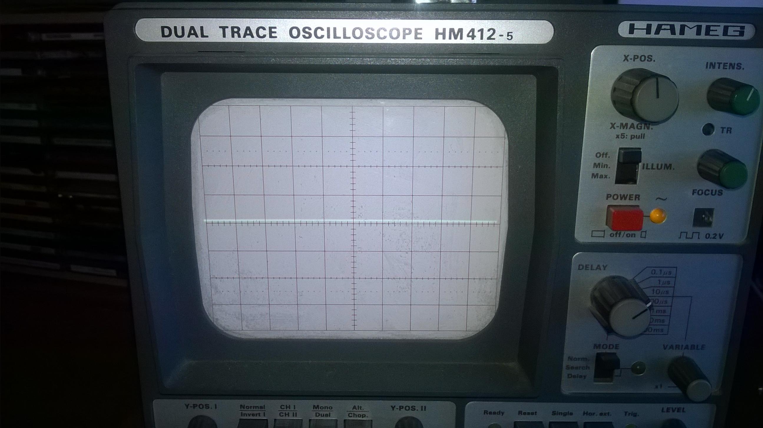

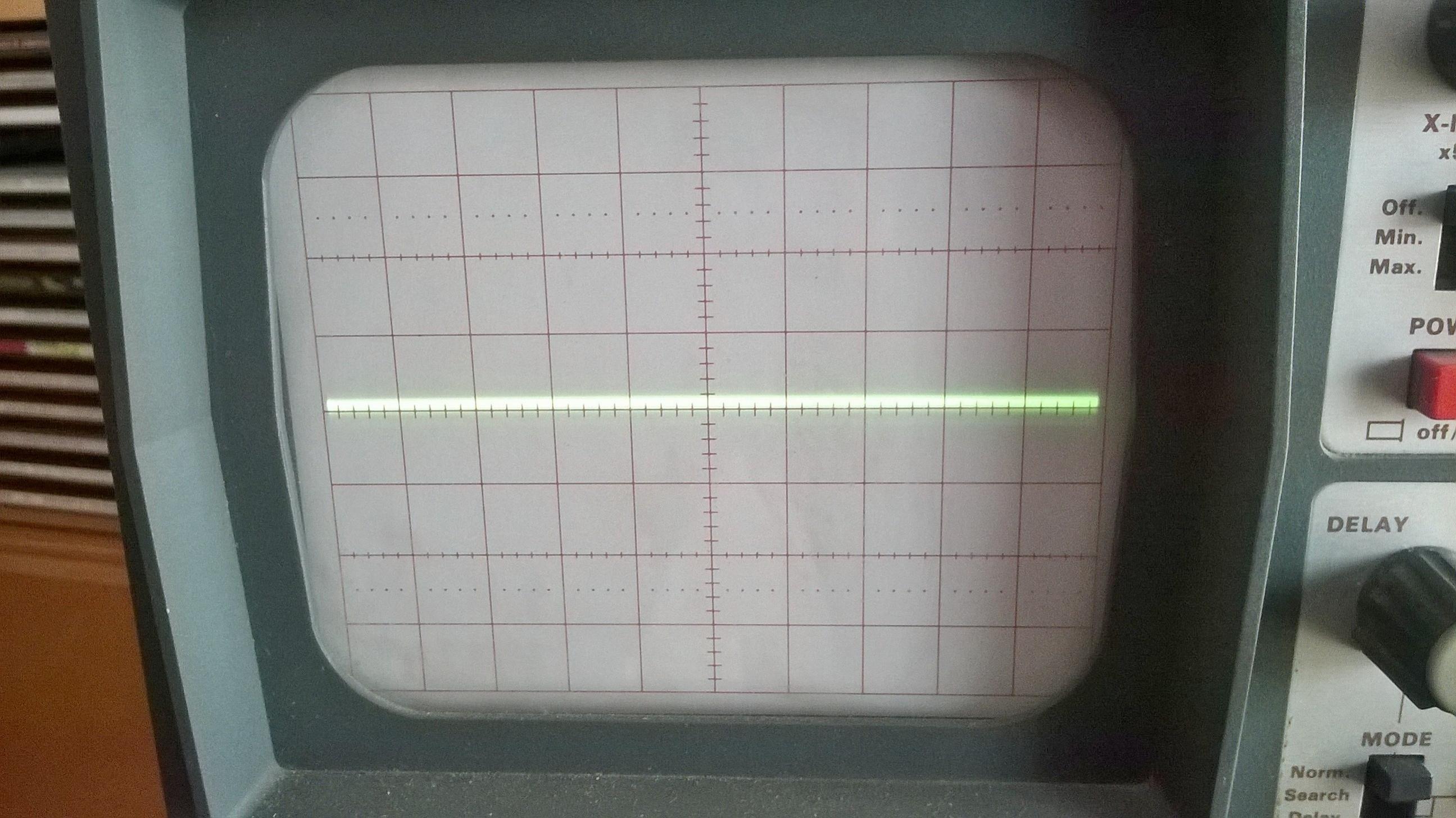

Ah, I see. I was looking at the 3rd and 6th pictures and couldn't see the FF connected in either?
The 1st picture is the scope connected to FF PSU, you can see the modulation.
The 2nd picture is the scope settings 20mV/cm 20uS when measured the FF PSU
The 3rd picture is connected the 560R dummy load to simulate the 10mA of consumption of FF, 5.4VDC / 560R = 0.01A = 10mA.
The 4th pciture is the scope connected across the dummy load, as you can see there is no modulation: straight line.
The 5th picture is the scope settings 20mV/cm 20uS when measured the dummy load.
The 6th picture is the scope probes connected to dummy load.

Well fixed the noise adding LC filtering at the PSU, now CLC 2.200uF 2mH 1.000uF. Salas information: FF rather easily picks EMI
