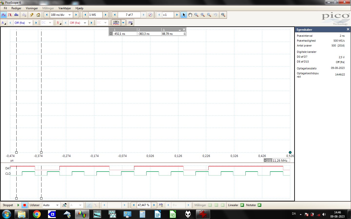

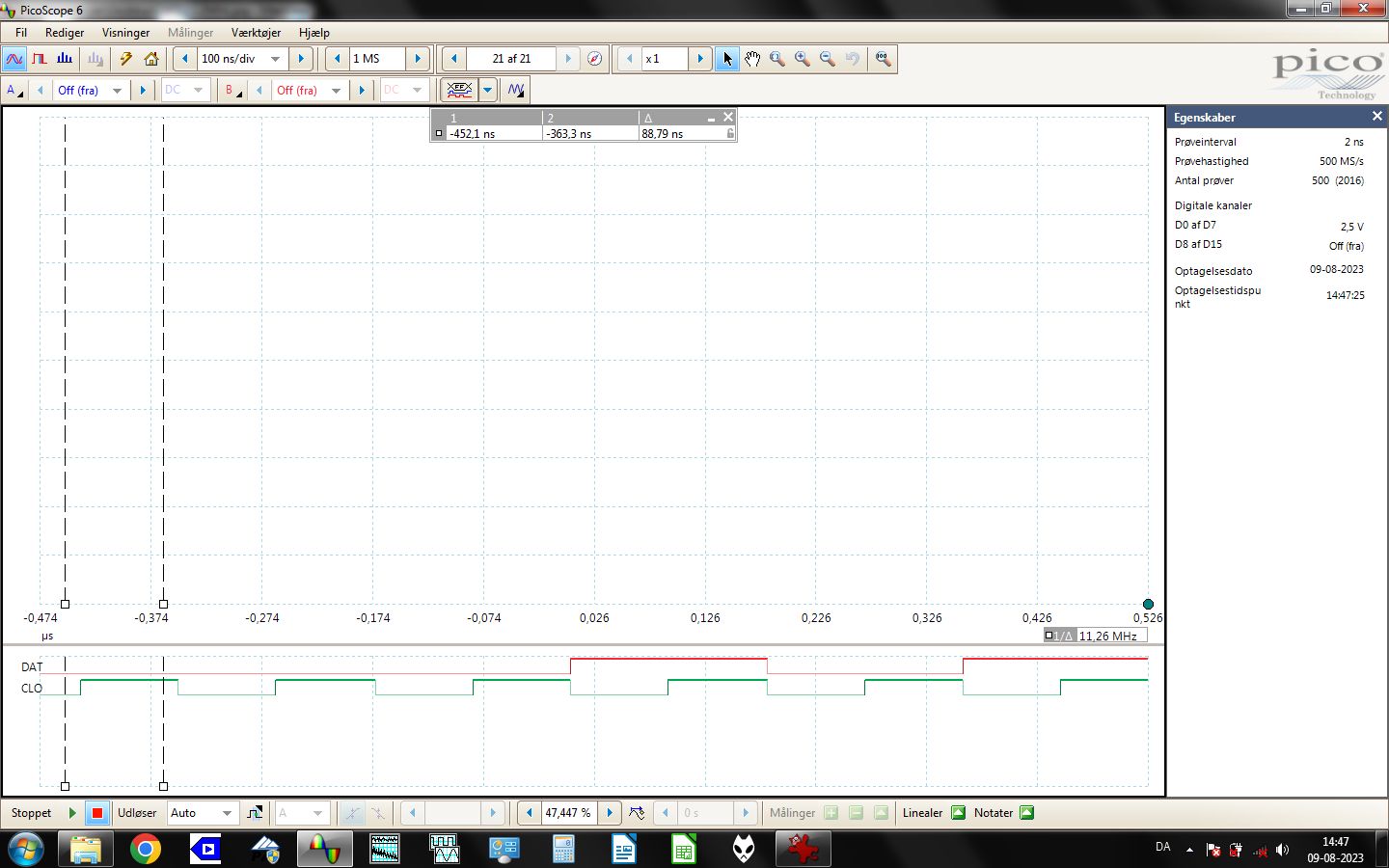

No, as far as I know all of these FFs change data at the rising BCLK edge. Regarding setup time I have made some timing measurements on the 74AUC1G74 that is currently soldered to the board. These measurements are attached (5.6 MHz & 11.2 MHz, JLSounds board, on-board oscillators).
As far as I can see the BCLK is always right in the middle of the DATA signal so I would guess there are not any issues with this ... ? I have also tried to increase the data line series resistor (up to 1k2) to change the timing of the DATA signal arrival at the FF but no change in distortion level.

@gentlevoice I meant to ask if the data going into the flip-flops change at the falling edge. Anyway, you confirmed it can't be a hold time issue.
