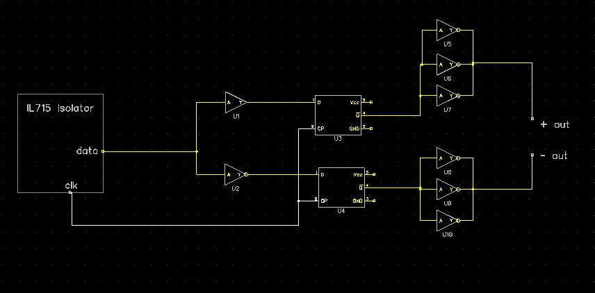

Attached are rough sketches of the 2 possible ways im going to try to build this power noDAC.
Chances are it will have unusable performance but it will be fun and costs so little.
In both examples the signals are "balanced" before the flip flops by an inverter and then inverting flip flops are used, first this keeps the signal path slightly simpler after the signals have been reclocked since non-inverting flip flops have a non-inverting buffer on the output (i.e 2 more inverters).
Additionally the single output flip flops dont have CLR and PRE functions, so their internal circuits are a lot simpler.
Finally, you have 2 seperate but identical flip flops working with inverse data inputs so it's more like a true balanced circuit than the dual output flip flop or a pair of non-inverting and inverting flip flops.
The initial idea, shown in the first example, was just to parallel the flip flops to increase output capability but there is also the possibility of using a single pair of the flip flops buffered by parallel inverters for the output stage, shown in second example.
The flip flops can achieve the same output capability but with a slightly simpler signal path.
Using inverters for the output will just move the heavy lifting from flip flop's output buffers outside instead with its own decoupling, depends how much the output load will effect the rest of the flip flop's operation.
but there is another pretty big difference to both examples...
With the flip flops you have many reclockers in parallel aswell, not just buffers, this has to have some adverse affect on the circuit. I dont have a hope of figuring out what that effect would be, or whether it is good or bad, without building both to see.
Im curious if the behaviours of this example can even be predicted with theory.

Theoretically, with tripled flip-flops, you reduce the jitter of the flip-flops by square root of three as it averages out to some extent. No idea how big or small that effect is.
I don't know which of the two circuits causes the smallest data-dependent disturbance on the supply and ground. Chances are that that one will work best. If I had to bet, I'd take the one with the tripled flip-flops, as it doesn't have to charge and discharge the wires to the buffers and the buffer input capacitances.
What are you going to connect to the outputs and how much capacitance does it have?
By the way, one of the outputs in the left picture is not connected.
I was hoping some sort of effect like that might exist with the parallel flip flops.
There will be a lot more in parallel per signal in practice to share the load, at least 8, especially for flip flops since they will presumably be more sensitive and now considering this averaging effect. They (LVC1G80) are a ~10c part so not much limiting the number.
It is intended to drive headphones, but with my 'solution' for volume control mention at end of post 2262 they would only see a resistor to ground close to their output.
Another potential for volume control is a combination of digital control and lowering the supply voltage, but the recommended output current for the LVC logic family drops dramatically below 3.3V so probably no good.
In fact, if the output capability follows this trend in the other direction it might be a better idea to run the logic at 5V for this application. The IL715 isolator would convienently be able to provide level translation for it.
I think JohnW mentioned another benefit to running at 5V somewhere in the thread.

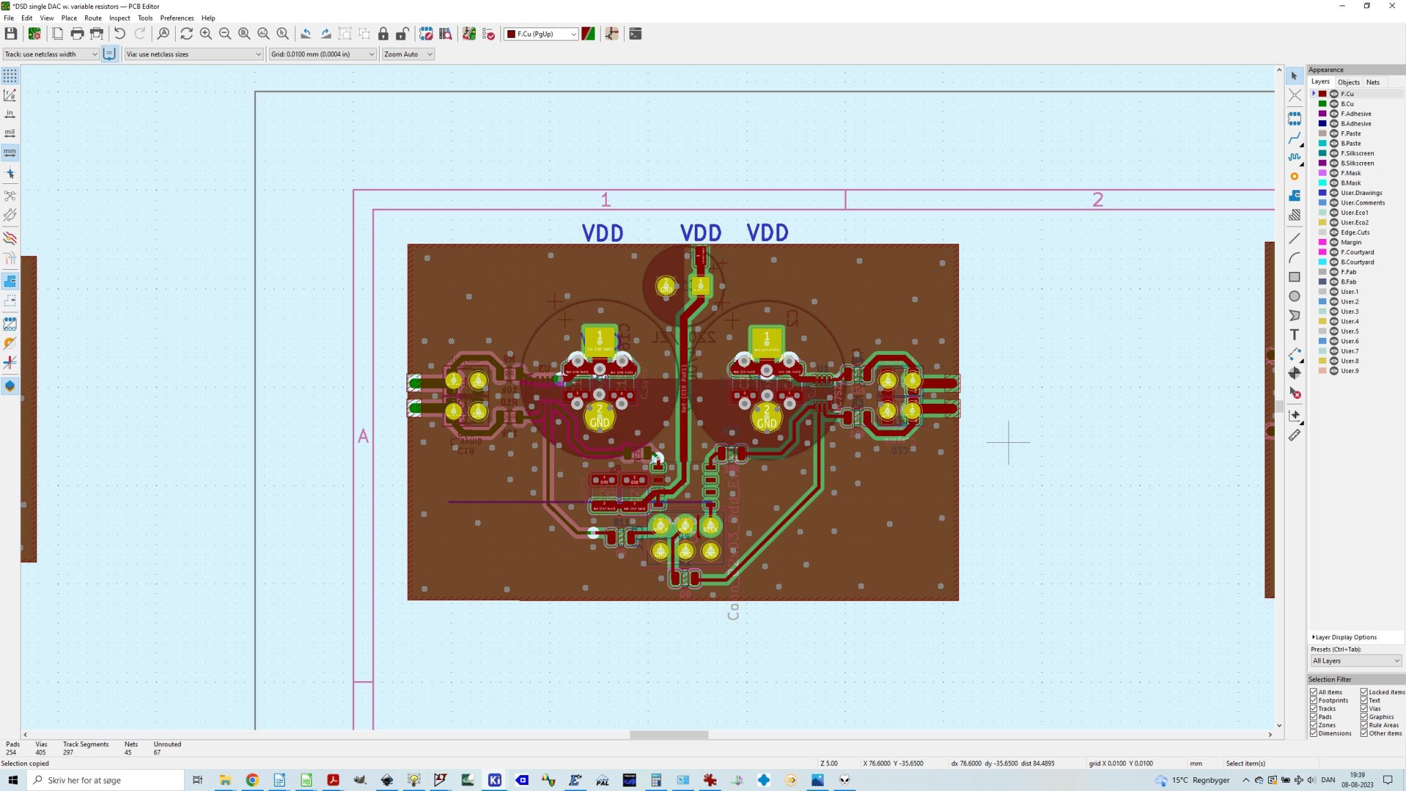

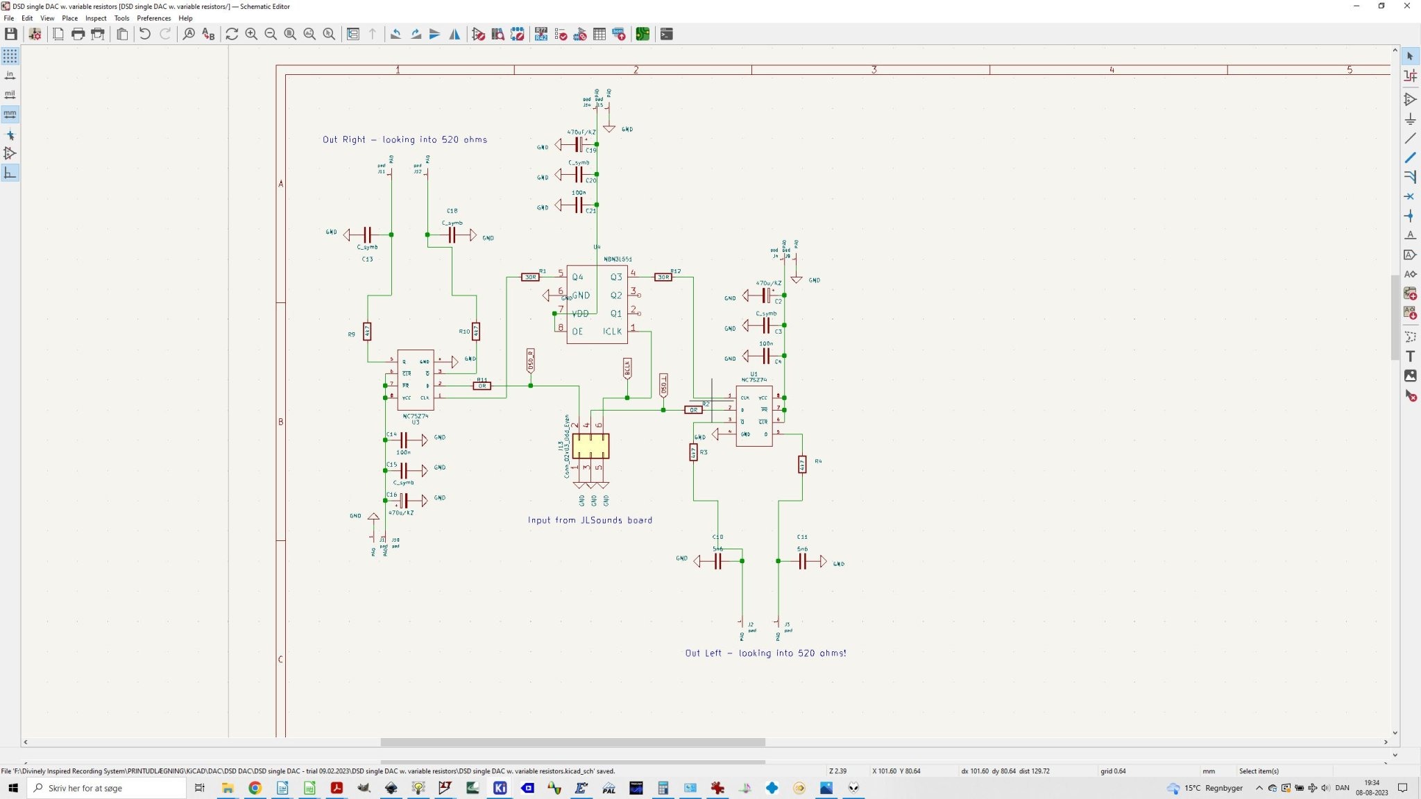

Hi all,
I have been experimenting quite some with various versions of a NoDAC - basically a balanced FF with an RC filter on the output - and while I can get very reasonable results at DSD64 & DSD128 (-104 dB to - 107 dB THD at DSD128), when I try exactly the same circuitry at DSD256 or DSD512 the distortion goes up substantially (-79 dB THD at DSD256, and -67 dB THD at DSD512) - essentially no matter which FF I use.
Since this rise in distortion level is almost equal for all the FFs (74AC74, NC7SZ74, 74AUP1G74, 74AUC1G74) I have a feel that it may be something "structural" - either related to some for me unknown DSD conversion theory - or in the way I have designed the circuitry.
BTW - a slight digression: These simple NoDACs sound absolutely wonderful - the best I have heard in terms of resolution, tonality, spaciousness, and "naturalness" - so both out of curiosity and slight "bewilderment" I would really like to find out what may be happening here ..??
FYI I have attached a copy of the very simple schematic as well as the PCB layout. I use JLSounds' USB-to-I2S card with NZ2520SDA oscillators so the phase noise performance should be reasonably fine. The AD converter I use for measurements is the AD7760 which is a 24 bit 2.5 MHz Fs balanced input ADC (evaluation board) with a 1 kohm input impedance. Besides the RC filter on the output of the FF (4.7kohm and 5.6 nF to GND - loaded by the 1 kohm) I use no other filtering before entering the signal into the ADC.
If one of you may know what causes this rise in distortion I would much appreciate your feedback.
