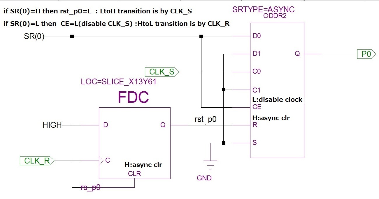

When using a low-speed flip-flop (FF) and configuring an analog FIR with multiple taps, a circuit like the one described below is effective for adjusting rise and fall time. This is a circuit I actually use within an FPGA for analog FIR purposes.
When the input SR(0) is high, the output P0 changes on CLK_S. Conversely, when SR(0) is low, CLK_S is ignored due to clock enable (CE) and P0 changes on CLK_R. Introducing a phase difference between CLK_S and CLK_R aligns the rising and falling edges. Simply replace SR(0) with xSR(0) for inversion. SR(1), xSR(1),SR(2),xSR(2), and so on are the same circuit. However, incorporating numerous logic ICs like 74HC74 might be disadvantageous due to noise and space, favoring the use of CPLD or FPGA.

I'm very interested to use your circuit for adjusting rise & fall time. Excuse my ignorance what ICs are involved?Exceeding 110dB THD in a single-tap DSD64 implementation can be considered nearly perfect. The gradual degradation seen in DSD128 and DSD256 is likely a result of following the laws of physics.🙂
In devices like FPGAs, most flip-flops typically have clock enables (CE), but this is not common in devices like the 74 series. In such cases, there's no choice but to drive the clock signal using AND gates as a substitute with 74hc74 or 74hc175. In my experience, driving the clock pins of several flip-flops with a small skew to avoid polluting the ground is quite challenging. This is especially true when dealing with analog circuits, like DACs, where there's a mix of analog and digital components. Therefore, if not using an FPGA, the tap count is likely limited to around four.

#2322 represents an internal circuit of an FPGA. Even when implementing it discretely, the architecture remains the same. Using synchronous clocks and asynchronous clears, you adjust the timing difference between the rising and falling edges. While it's preferable for both to be synchronous clocks, in the case of spartan6 with two clocks, this driving approach isn't feasible. So, a combination of synchronous and asynchronous is employed. This seems to be the only way, even with discrete components.I guess thie answer is for me. I don't want to use FPGA, your post https://www.diyaudio.com/community/threads/the-best-dac-is-no-dac.273474/post-7423752 have any FPGA involved?
Regarding flip-flops, using single ones like 7w74 might be advantageous compared to dual ones like 74hc74, as they allow for easier power supply bypassing. You can place GND and power supply on inner layers and individually insert 0402(0.1 or 0.01) components.

You didn’t say nothing about your hw and sw, maybe the bottleneck is one or both of them?
I mean, maybe your specs are enough to reach dsd128 but it is the natural limit.
Or, and this is a completely different beast, these are pcb design frequency limits.
My 2 cents.
Carmelo
EDIT:
Yeah, I skipped 3 pages of posts…
Could it be related to the characteristics of older FF?I have been experimenting quite some with various versions of a NoDAC - basically a balanced FF with an RC filter on the output - and while I can get very reasonable results at DSD64 & DSD128 (-104 dB to - 107 dB THD at DSD128), when I try exactly the same circuitry at DSD256 or DSD512 the distortion goes up substantially (-79 dB THD at DSD256, and -67 dB THD at DSD512) - essentially no matter which FF I use.
They have the fmax in the range of MHz, and it is needed to have them in the GHz range to avoid distortions at higher DSD rates.
Hi zintolo,
I think there were a couple of reasons why it didn't work too well at higher sample rates. One of them likely was the FFs I was using although my guess is that it is not necessarily the speed but more the similarity of rise/fall times that may be important in determining distortion levels (you may know more about this than I do ;-)). However, I did try a 2.5 GHz FF and it actually didn't perform any better than the ~250 MHz FF versions ...
An additional factor was that my measurement setup wasn't optimal. I was using the AD7760 eval board and for some yet unknown reason it (probably) was "disturbed" by the ultrasonic DSD noise and thus calculated varying distortion levels. Also the buffer I used between the DSD NoDAC and the AD7760 was not ideal. I currently use the Cosmos ADC and an OPA1612 buffer between the NoDAC and the Cosmos and get much more consistent and, I believe, reliable results.
Currently I haven't tried DSD256 or DSD512 though, because my clock setup is a bit unusual - I am feeding the NoDACs without reclocking and my maximum clock rate is 5.6 MHz, i.e. DSD128.
Another factor that in my experience makes a huge difference in the distortion level, is using an RTZ (return-to-zero) topology. And using a balanced configuration. I have not found single-ended outputs to perform very well distortion-wise.
Also, being careful in selecting the right decoupling capacitor values for the FFs. Since the NoDAC structure essentially is very basic it appears to be quite sensitive to the choice of decoupling capacitor value - this can change the distortion levels quite a bit.
Typically, the various FFs are also very sensitive to the loading on their outputs. Finding the right resistor value (as well as the accompanying capacitor value) can make a significant difference.
... my current two cents ...
Jesper
