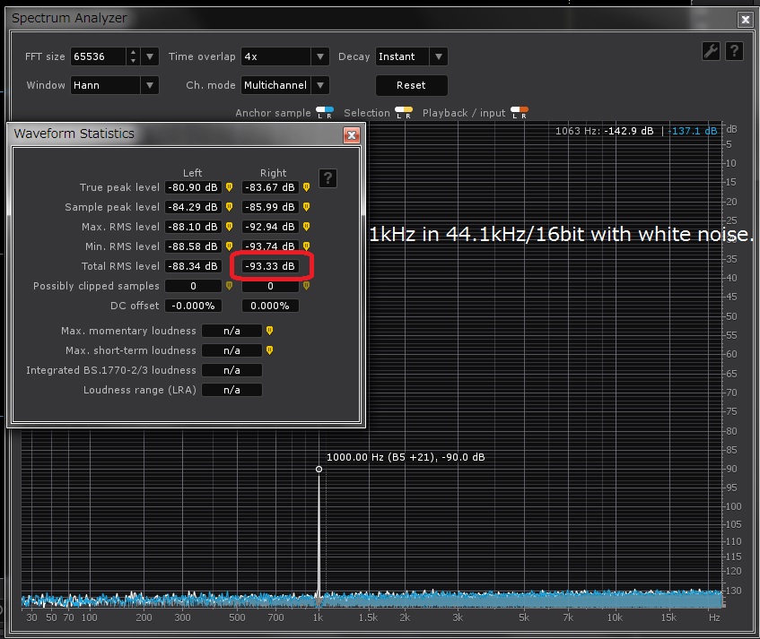

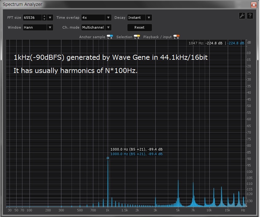

Hi, koldby.
Thank you for your measurement data. That is exactly what I want to know. 🙂I guess strange harmonics in 2(40Hz?) comes from the file itself as you mentioned. I usually use Wave Gene to generate a test signal. The 1st pic is the file done by WG, where harmonics of 100Hz exist. 1kHz in 44.1kHz sampling means no integer quotient(44100/1000=44.1). Instead, 100Hz is probably used for calculation(44100/100=441) to have integer quotient. The side effect of using 100Hz ends up strange 100Hz harmonics if you use WG. I can find some file-oriented strange harmonics in file 4. File 3 is clean.
One way to generate a clean 1kHz test signal in 44.1kHz/16bit sampling is a conversion from 44.1kHz/24bit to 44.1kHz/16bit with white noise option. This process converts residual harmonics into quantization noise(the 2nd pic). It's more convenient though quantization noise is higher than the theoretical value(-98dB).
I'm afraid you can hear residual noise when music is in silence because your file 3 has a larger noise floor than my 2nd pic by 20dB on condition that your FFT is 64k length. Quantization noise of CD(-98dB) isn't audible. Practically speaking, -85dB is the threshold if it's audible or not. Your setup is probably louder than the threshold. Can you hear residual noise? I guess you have roughly -80dB residual noise.

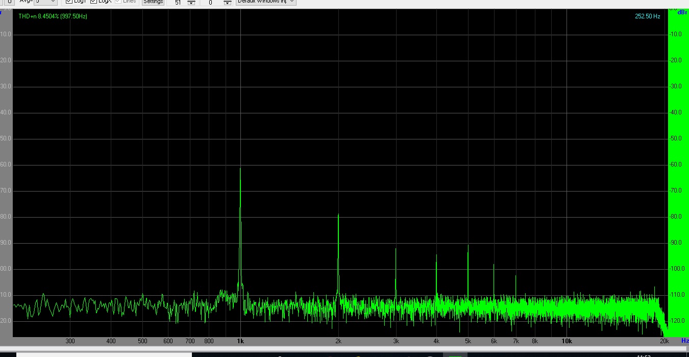

I cannot see that my residual noise should be only -80 dB. As I can see it the noise floor is more than 100 dB down .
Thanks for pointing me to the AP generator.Maybe better to provide yourself with a Login and download
APxWfmGenerator.exe from AP.com, it can generate all sorts of signals in various resolution so you can leave these problems behind.
If it`s still messed up something else is a miss...
It is very usefull to make -60 dB in different formats and clean. Unfortunately it cannot produce -30 -40 -50 -70 aso..
But some interesting results here , maybe...

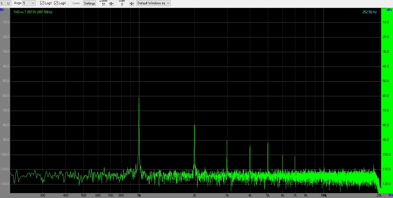

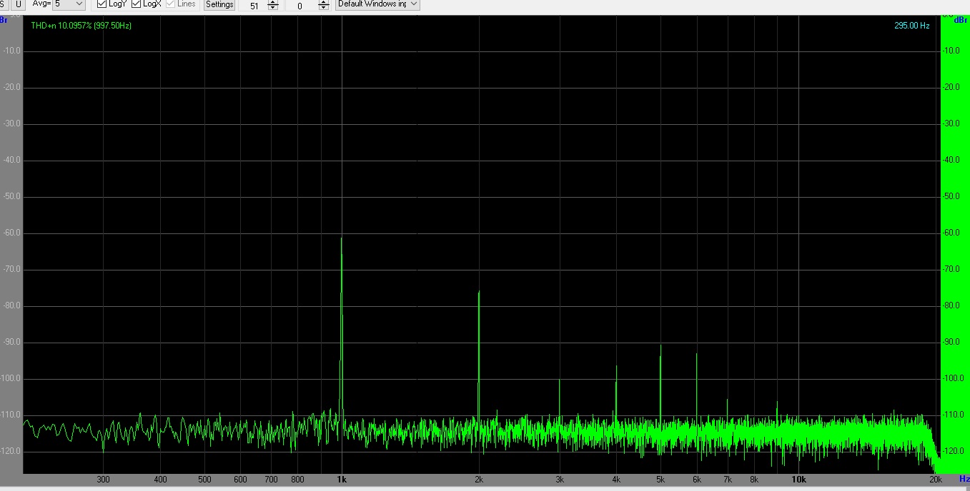

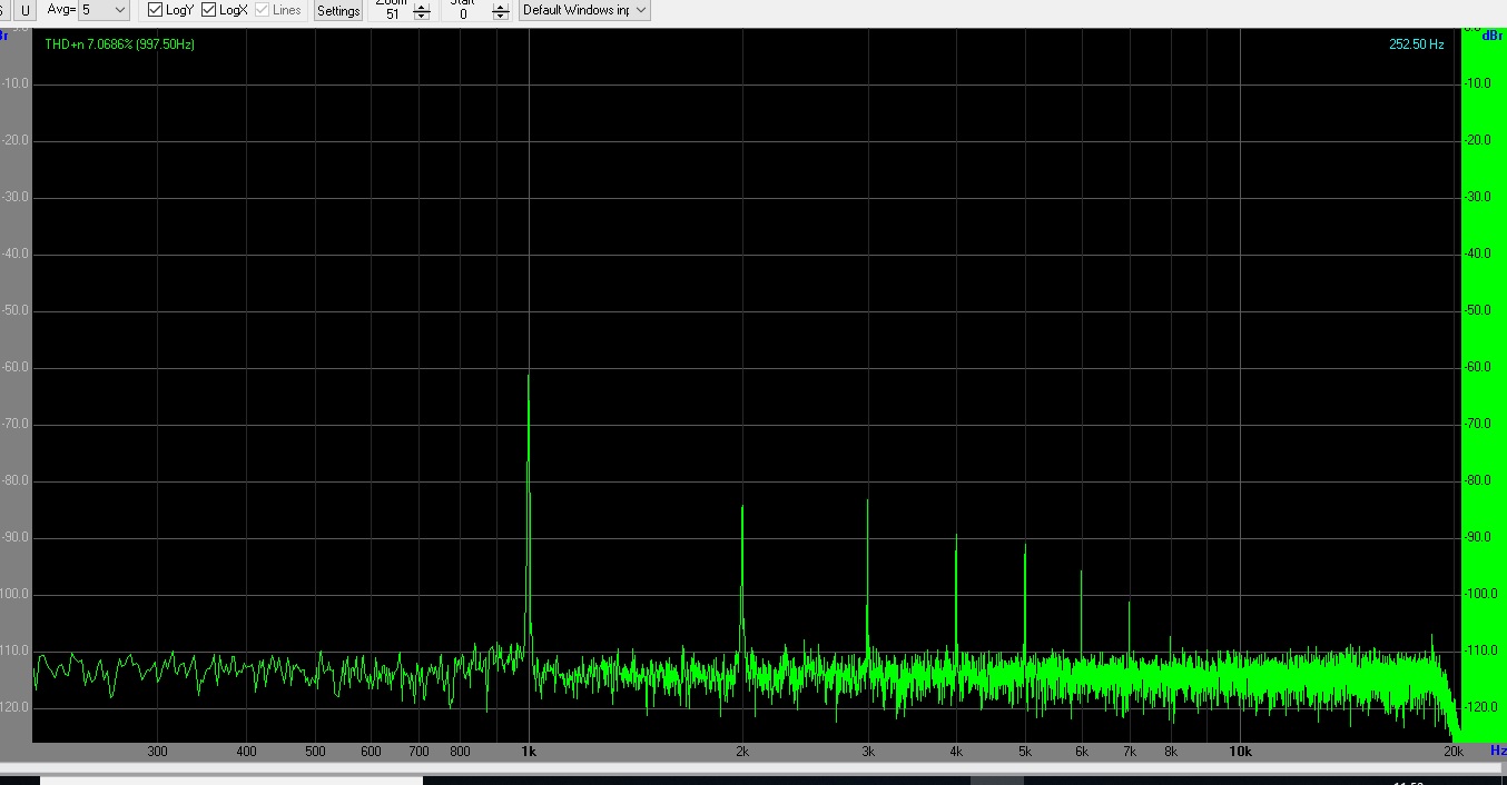

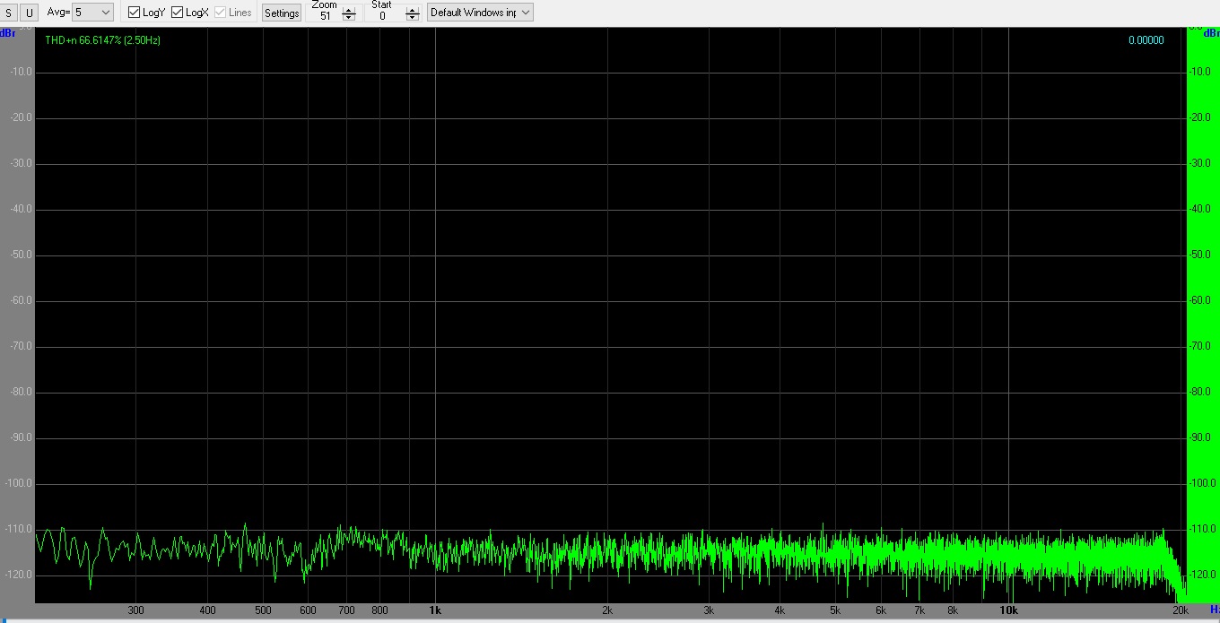

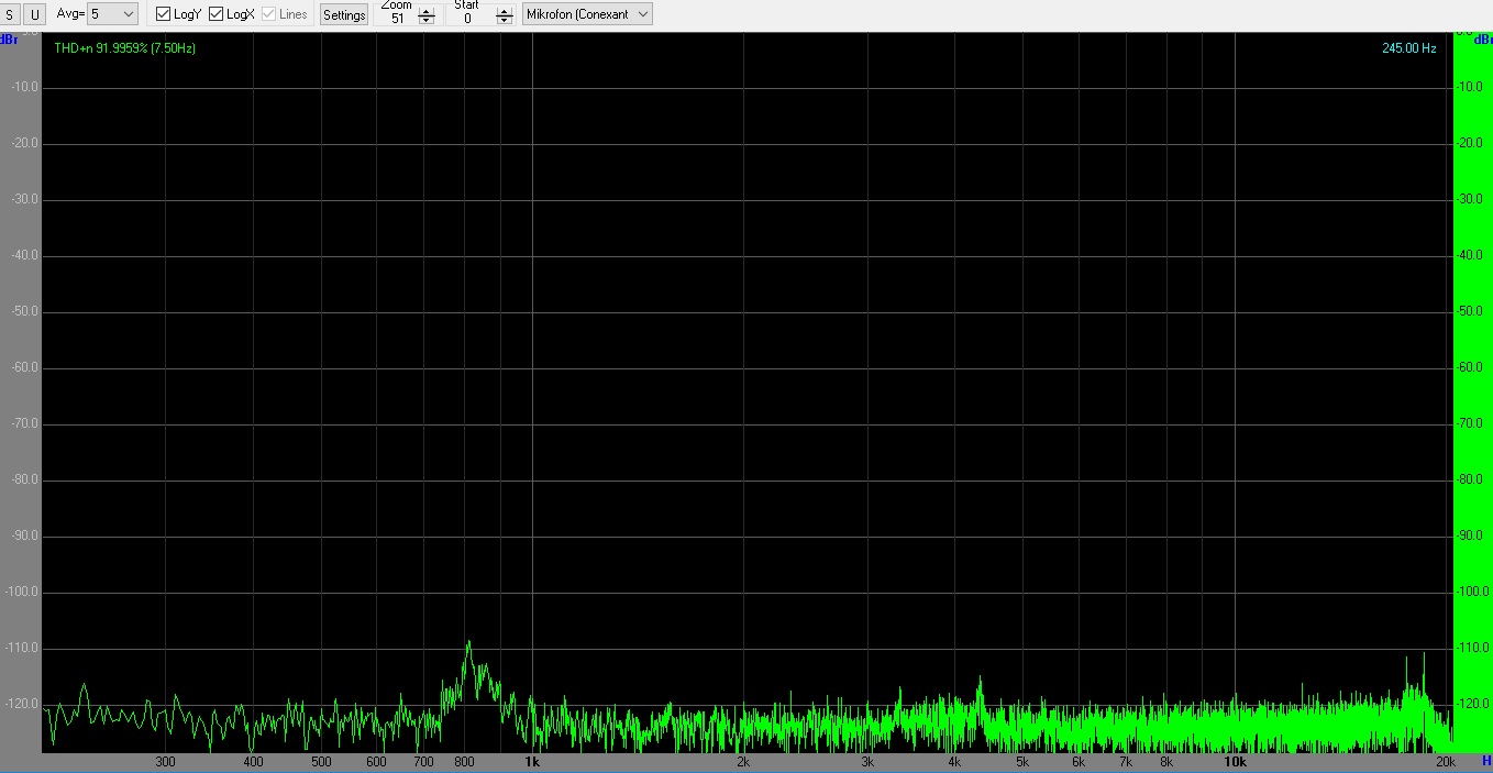

First some pics of residual noise
Pic 1 soundcard residual noise shorted input
Pic 2. NoDac on no input
The next 3 pics are AP generated -60 db 16 bit. The harmonics keeps changing in magnitude as seen in the three examples.
The last pic is AP generated -60 dB 24 bit and here the harmonics keeps their level steady.

I think you misunderstood me. I was observing this lowering of the 3. order harmonic when using only the Q out on the 74hct74.Anyway, you mentioned earlier having higher 3rd order distortion while not lowering the 2nd order by using the balanced flip flop, now you say that's not the case?
[/url]
So I decided to go with the SE version and then changed the 74HCT74 to an 74LV1GC79 instead to see if the higher speed of the LV1GC made a difference, but it did not.
So it was not the speed of the FF, but using it as balanced FF that changed the spectrum.
You need to calculate square-root of the sum of squares when you want residual noise from FFT plot. The noise floor of FFT doesn't mean RMS of residual noise. If your FFT is 64k length and bandwidth is 20kHz, 40dB is rough value to be added to the noise floor, i.e. -120(noise floor)+40=-80. This calculation is usually very complicated. Many software does calculation instead of you.
