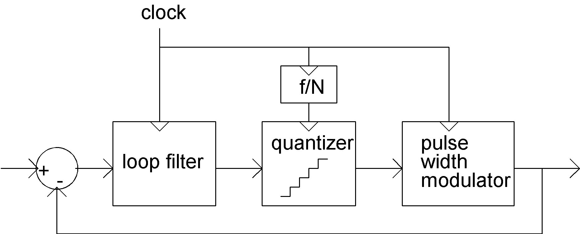

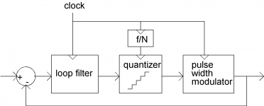

I'm not convinced (but it could be) that it's RTZ or a light variant. Months ago I expected, after measuring and comparing algorithms that the dac output signal would be less than normal, but it wasn't. Being a hardware guy it didn't catch me at the time that Jussi could've adjusted the level in software of course, to match RTZ to NRTZ. I haven't yet implemented RTZ in hardware to compare the software with. Will update here when that's the case.
Pseudo multi-bit could mean that he has embedded a pulse width modulator inside a sigma-delta loop, so he can use a quantizer with more levels that can be properly dithered. That works quite well against quantization artefacts, but it requires a high bitrate because the oversampling ratio is less than that of a single-bit sigma-delta with the same bitrate - which would explain why he only recommends it for DSD512.
Nice insight. That's what I would call a RTZ light version. 😀

It's a picture from an article about a hobby DAC I designed and made, see The valve DAC - Submicron silicon meets submillimetre vacuum. I implemented three different sigma-delta modulators on an FPGA board, two of them are according to the picture - although I don't use normal PWM but randomly rotated PWM. The third one is a chaotic single-bit sigma-delta.
The concept (but with normal PWM) comes straight from the description of prior art in an old patent by Peter Craven. The patent has passed its due by date and this was prior art, so embedding PWM in sigma-delta loops must have been done for decades.
That's the most wicked and bold design I've ever seen someone do: dac's made with tube oscillators and choice of algorithms etc etc! Must have taken some hours to get that beauty up and running well, do you still use it as a source today, what are its strong points, soundwise?

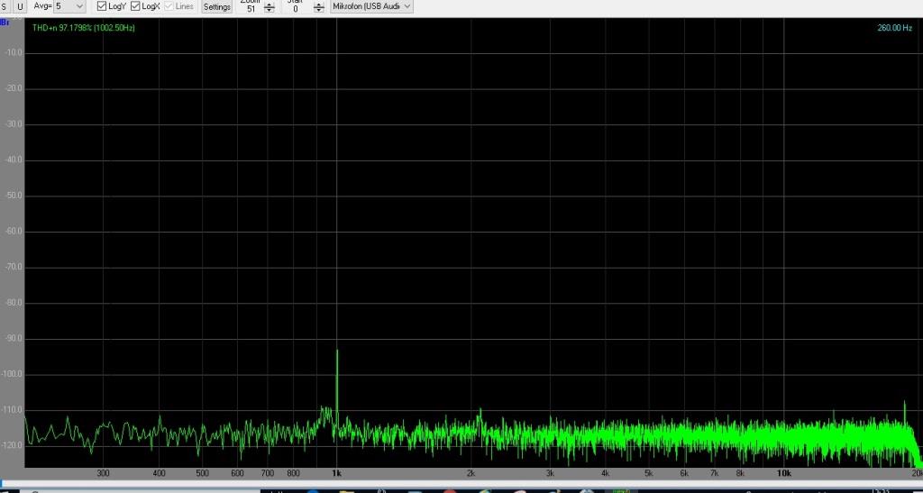

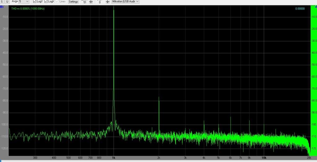

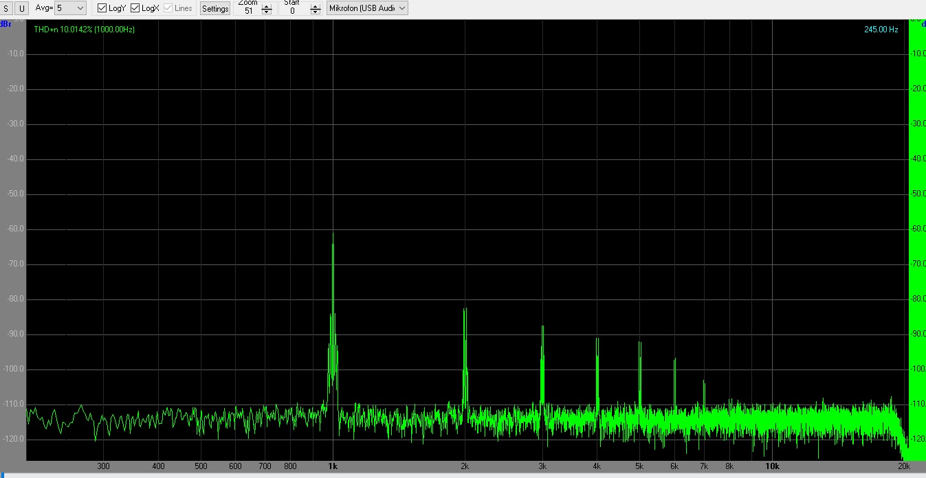

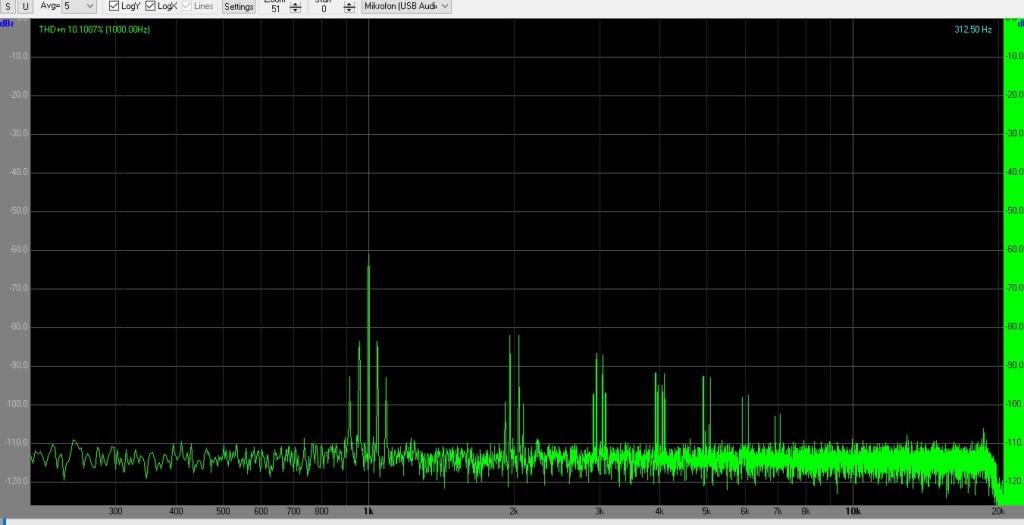

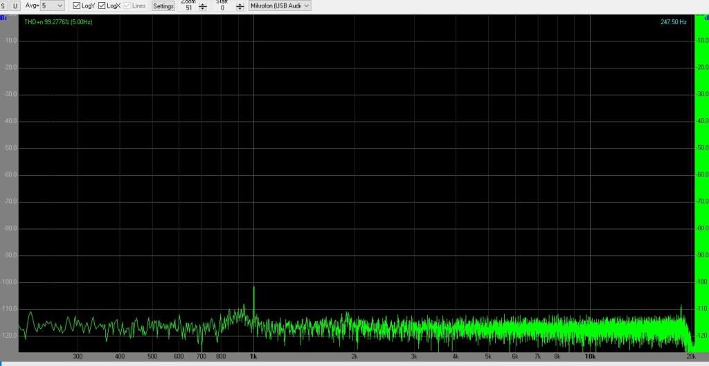

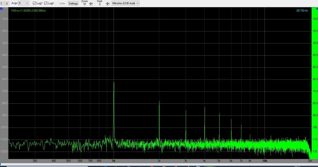

Hi
I have made some tests of a No Dac , consisting of an Amanero with direct DSD software, output to a 74lv1gc79 FlipFlop with only q out .
(If I use a F-F with Q and invQ it produces much higer third harmonic distortion.) This is connected to a RC filter (270 Ohm - 10 nF) and from the filter to a 10K:10K transformer.
The software is Jriver set to convert anything to 2x dsd in DoP format.
The results are shown in the pics.
1: 0dB
2: - 60 dB WAV from a testdisc downloaded from the web
3: - 60 dB WAV from RME
4: - 60 dB Wav from Wavetones.com
5: - 90 dB WAV fro testdisc
6: - 90,32 WAV fro Hans Polac
7: -100 dB WAV from RME
Surprisingly good result @ 0dB and this continues to about -30 dB.
Suprisingly big difference between the different - 60dB test .wav files.
I will try to get member Hans Polak to make some -50 -60 -70 dB files , as his -90 dB is much cleaner than the test disc.
The -100 dB just to show it can easily resolve that.

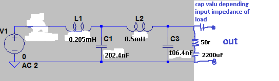

Bye the way, I have tried to place a LCLC filter in front of the Trafo ( like this: https://www.diyaudio.com/forums/att...racteristic-impedance-4th-low-pass-filter-png) and it makes no difference in the measured performance.
Yes I know that the ultrasonic noise would be lower, but it apparently has no influence in audio band. It could affect amplifying stages after, but even the the soundcards inputamplifier seems not to be affected.Did you also measure the ultrasonic noise? It should make a difference for that.

Great to also see some -60dB measurements, it's exactly where the problems are.
Strange to see what looks like intermodulation products on some, are you sure there wasn't some 40 Hz or other signal interfering with your measurements?
As an insurance against software upsample errors I always try a few test signals with different resolution and choose the best one, mainly looking at the noise floor. E.g. 1000Hz 16, 20, 24 and 32 bits. My default is 24 bits since most hardware supports it, but test cd's are 16 bits so better not use those. It might be interesting for comparison to e.g. a pcm dac, but when in prototyping that's not of interest yet.
Another important one is using a direct connection to the hardware by using ASIO drivers, but I assume that that's what you get automatically when dsd is the output signal.

I am quite sure it is the test files that are different, as I have measured that difference many times and it is the same each time.Great to also see some -60dB measurements, it's exactly where the problems are.

I think I have to use 16 bit files as well as the majority of music CD are in fact 16 bit.
I have measured the same files in a PCM dac. Here the strange intermodulation artifacts are not present in the -60 dB file, but still Hans Polaks files are better:

I think I tried with higher series resistance, and no changes in measurments, but I am not sure.
If I leave the FF out I get much higher 2. harmonic distortion (and also 3. ) ie. take the output directly from the Amanero. I guess the better result with the FF is because the data is clocked out with the bitstream clock.
but what I was referring to was if I use a FF (74hct74) with Q and invQ in balanced mode , the third harmonic becomes higher, without lowering the second.
Actually I find the result very promising, as the -60 db, witch is the worst, the highest harmonic (2.) is -80db down and in some of the files they are harmonic related to the fundamental. Wonder if is audible?
