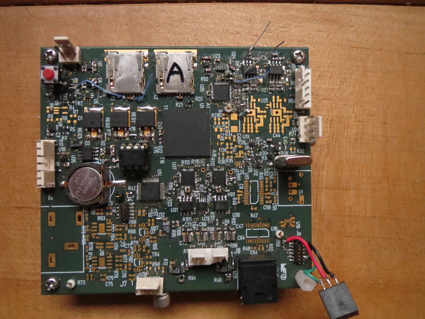

Thank you, what software/programm do you use to rip vinyl?
If you mean my hardware (ADC) to digitalize vinyl, It's DIYed ADC board which has SDcard(fat32) on the PCB to memorize wav file. The input of my ADC is external RIAA equalizer which has differential 5Vpp output. Digital data is stored in SDcard, where hardware control including rec and stop is done by a microcontroller(LTC1347) on the board. So, no software like Windows controlled USB devices exist. Just push rec button and stop, then you finish ripping.

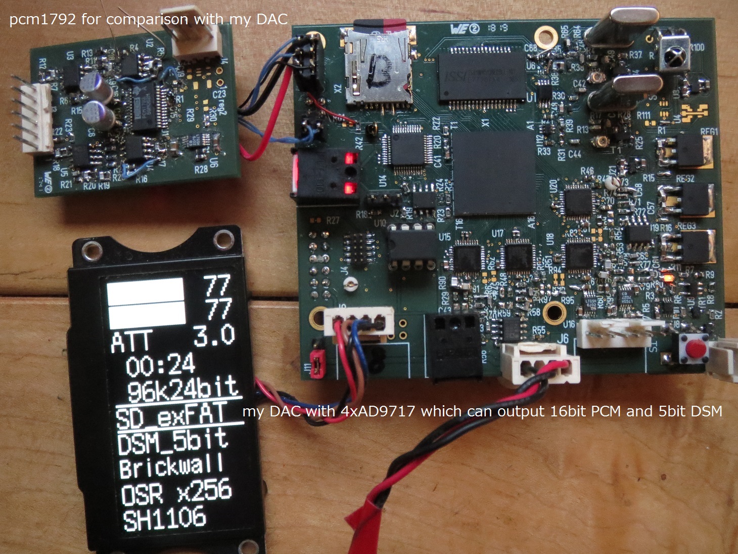

I measured pcm1792 in DSD mode, but haven't measured in PCM. It needs some modification on my DIY PCB. The only data I have is done with a CD player, which is far inferior to DSD mode of my DIY PCB.
... to my knowledge the PCM1792 doesn't play back DSD (?) ... Do you mean the DSD1792? And, if yes, can I ask you if you have compared it with an ES9038 based DAC (that is well-executed)?
Jesper
Pcm1792 can playback DSD if you have software converter(Rpi) or a hardware one from PCM to DSD. My solution is to use my DAC output because it has internal PCM to DSD converter(1bit DSM) in FPGA. A small PCB at the upper left(attached pic) is my DIYed pcm1792 board for comparison. I have now finished modification to my DIYed pcm1792 board to make it capable in PCM mode. The result was a little bit surprising. My DIYed pcm1792 in PCM mode has almost the same numbers as those in DSD mode(DSM conversion is done by my AD9717DAC as in pic).
CD-S2000(pioneer), which uses two pcm1794s(hardware configuration version of pcm1792) in PCM mode, is far inferior to my DIYed one if the input is bandlimited real music file at post #2004. Standard 1kHz sine can't uncover the difference. I'm not sure how much the difference in real music measurement affects SQ. But CD-S2000 has way worse THD+N in the real situation though both have the same DAC chip.
I guess this comes from poor physical implementation. CD-S2000 isn't multi-layer PCB while mine is 4-layer. My experience tells mixed signal circuit must have a solid ground plane. But I haven't found an objective result in the audio application why multi-layer is mandatory(nobody uses two-layer in video application). This can be one evidence. Another measurement data by real music has interesting results. I will open a new thread about this when I have finished a relative comparison.

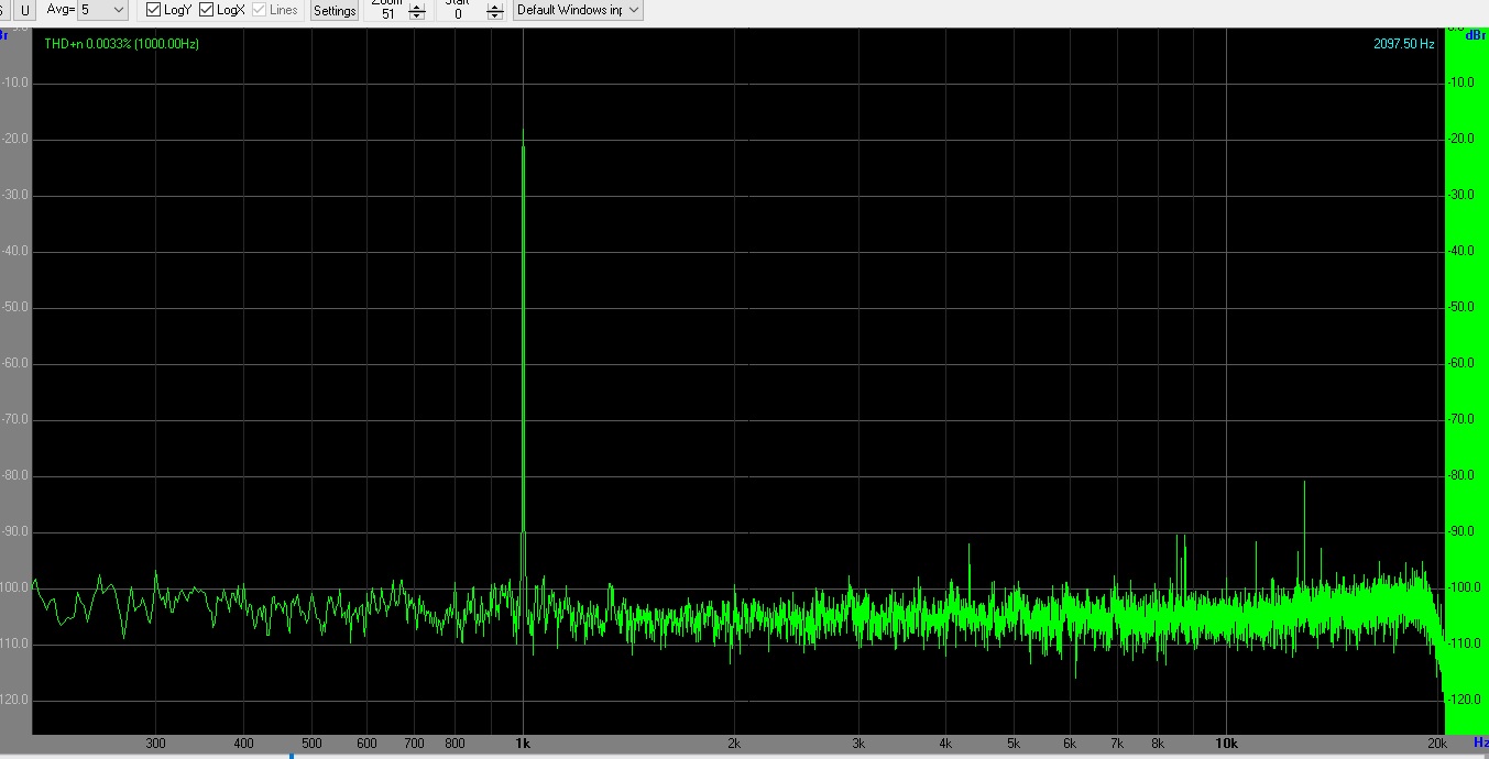

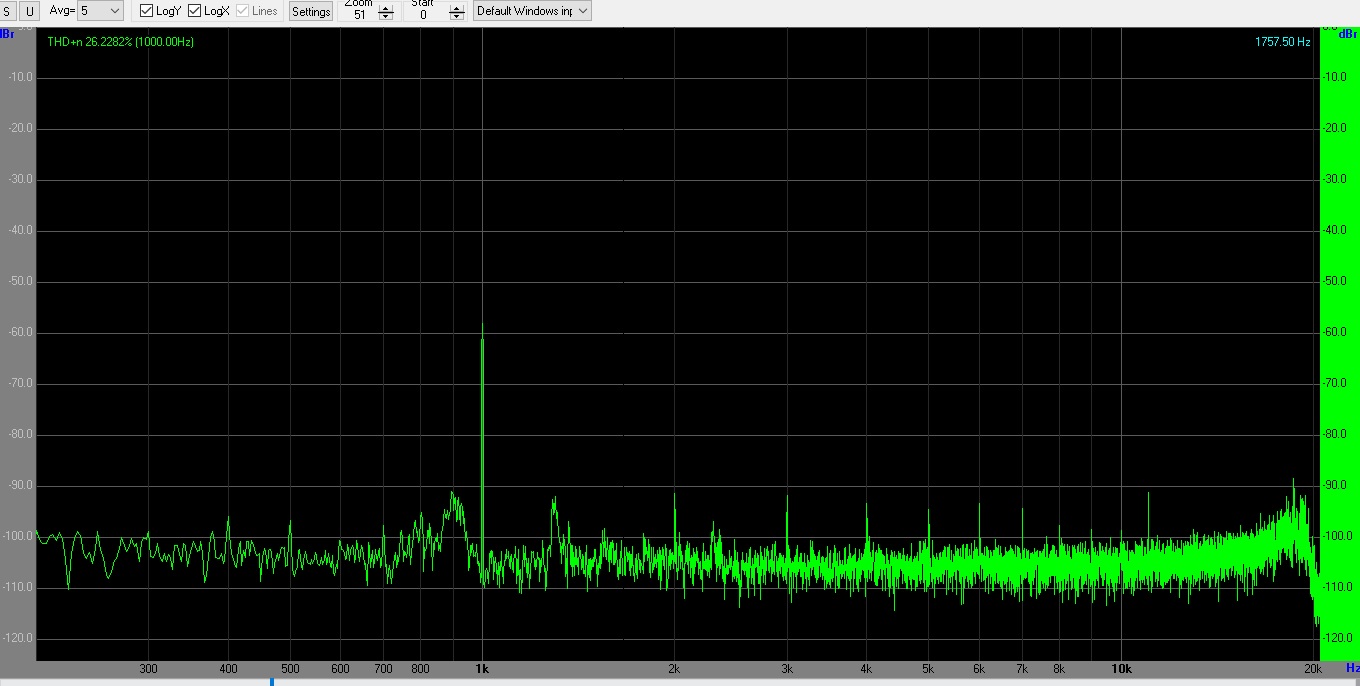

For all of you wondering where the audible distortions with many no-dacs, when playing at low volumes, extremely dynamic music, or when fade in or fade outs are at play (especially at high dsd rates):
Just a quick look at how a single ended Potato Semi flip flop behaves with different algorithms by HQPlayer, having a simple 2nd order analog output filter.
The test signal is 1KHz, -60dB @ DSD512.
The first image is taken with the DSD7 +256FS modulator,
the second with the AMSDM7 512+FS type, both Poly-sinc-2s.

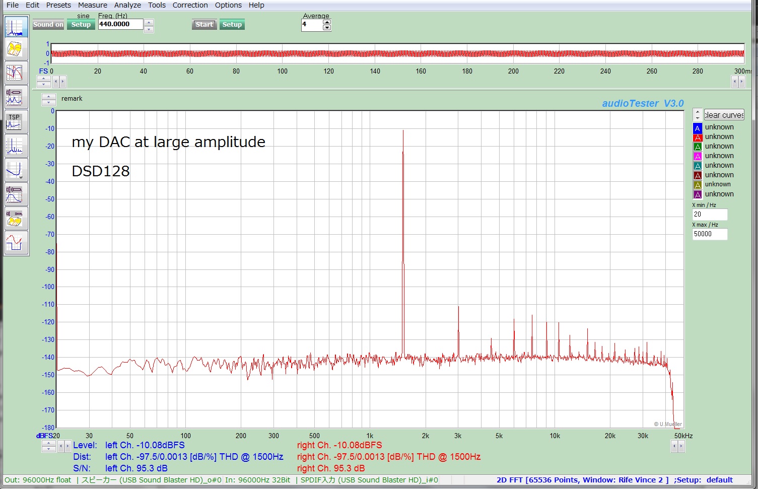

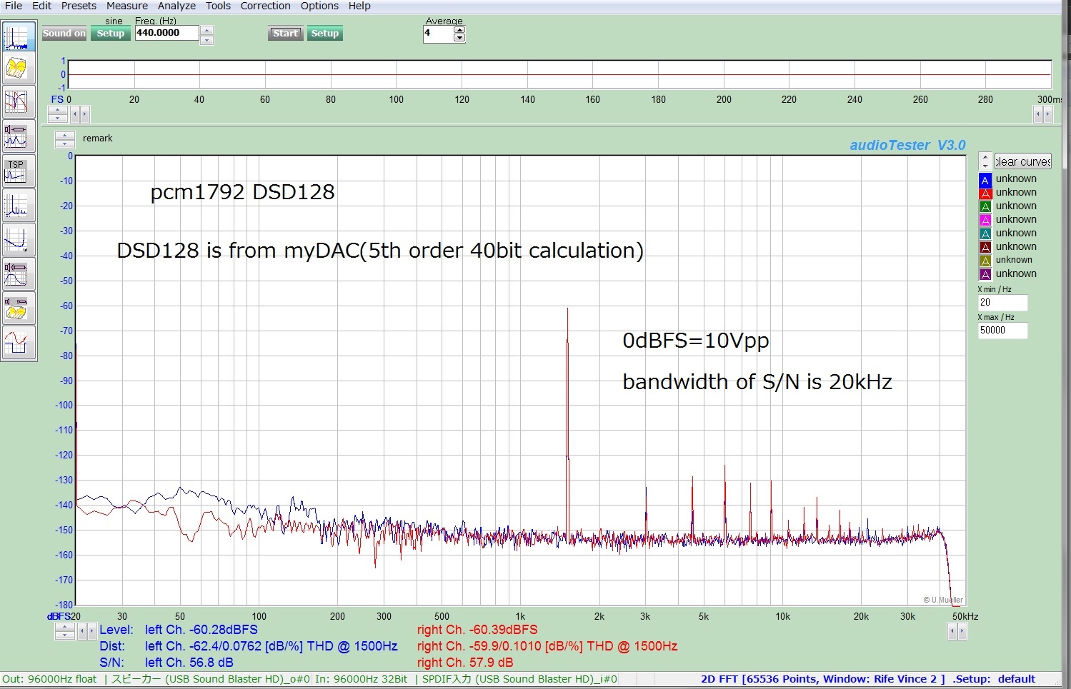

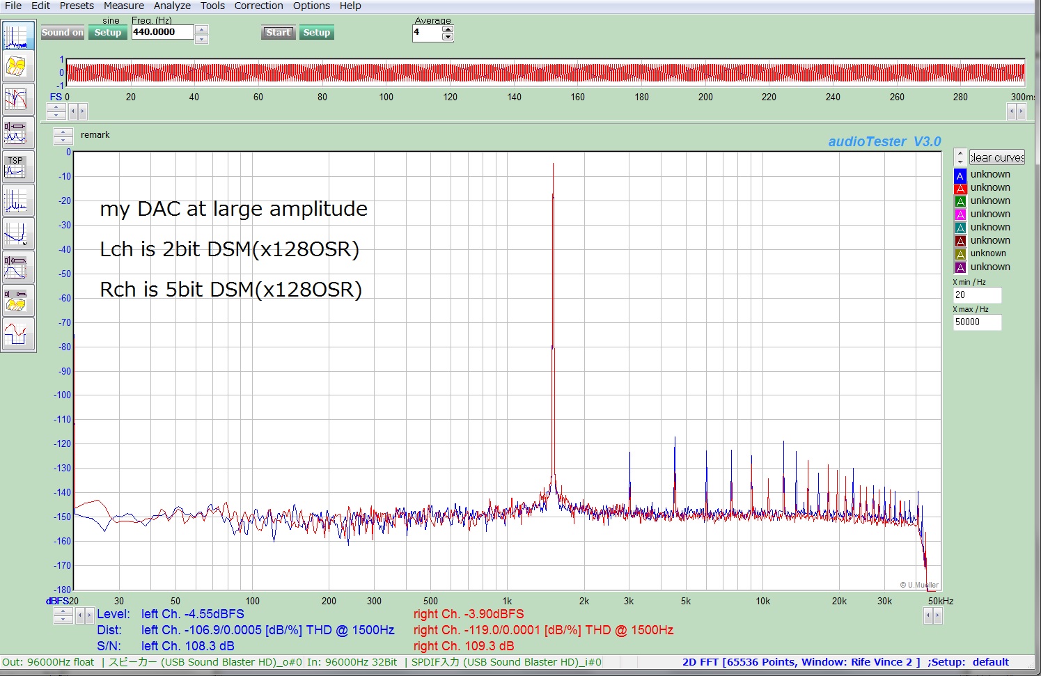

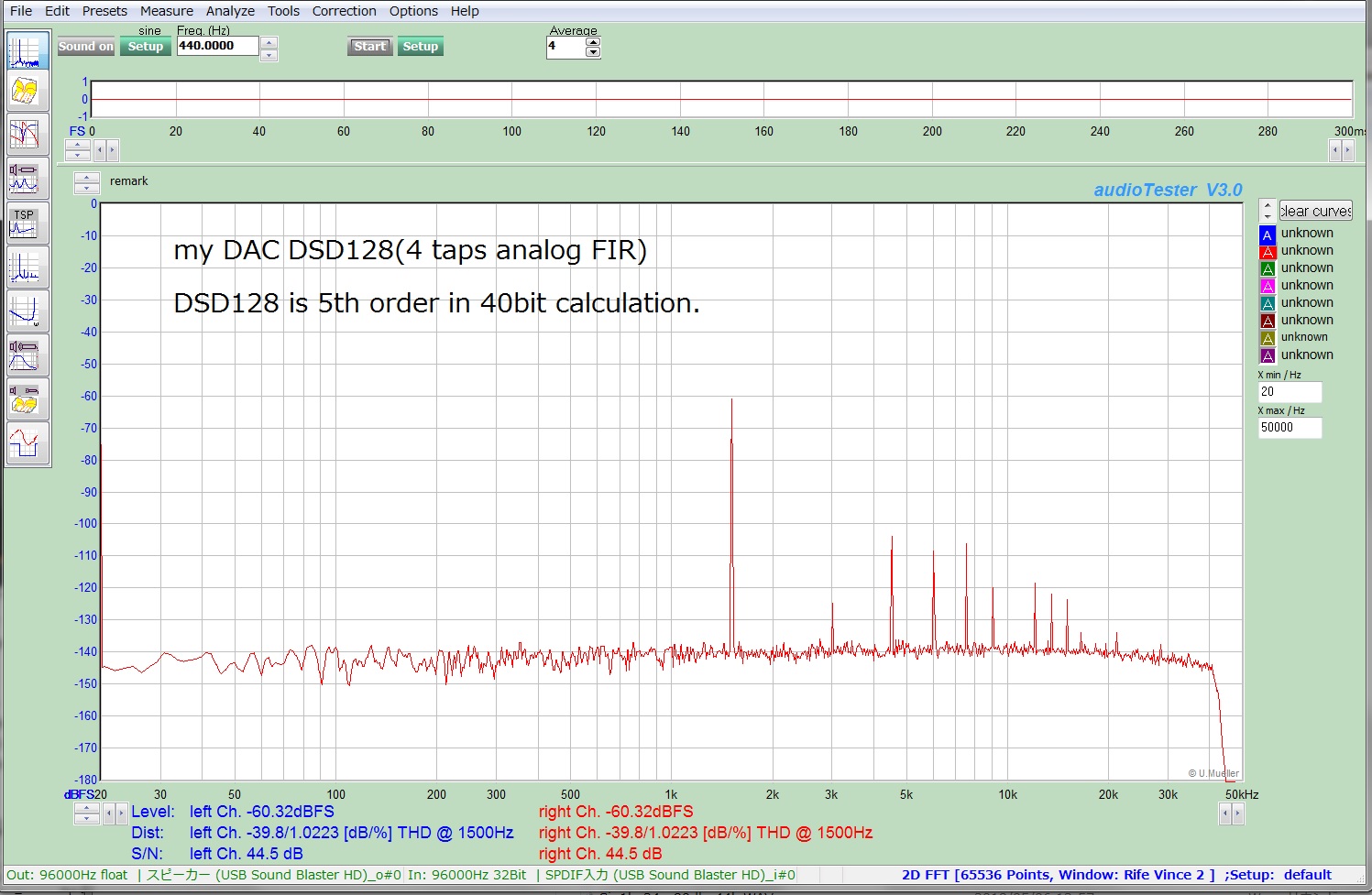

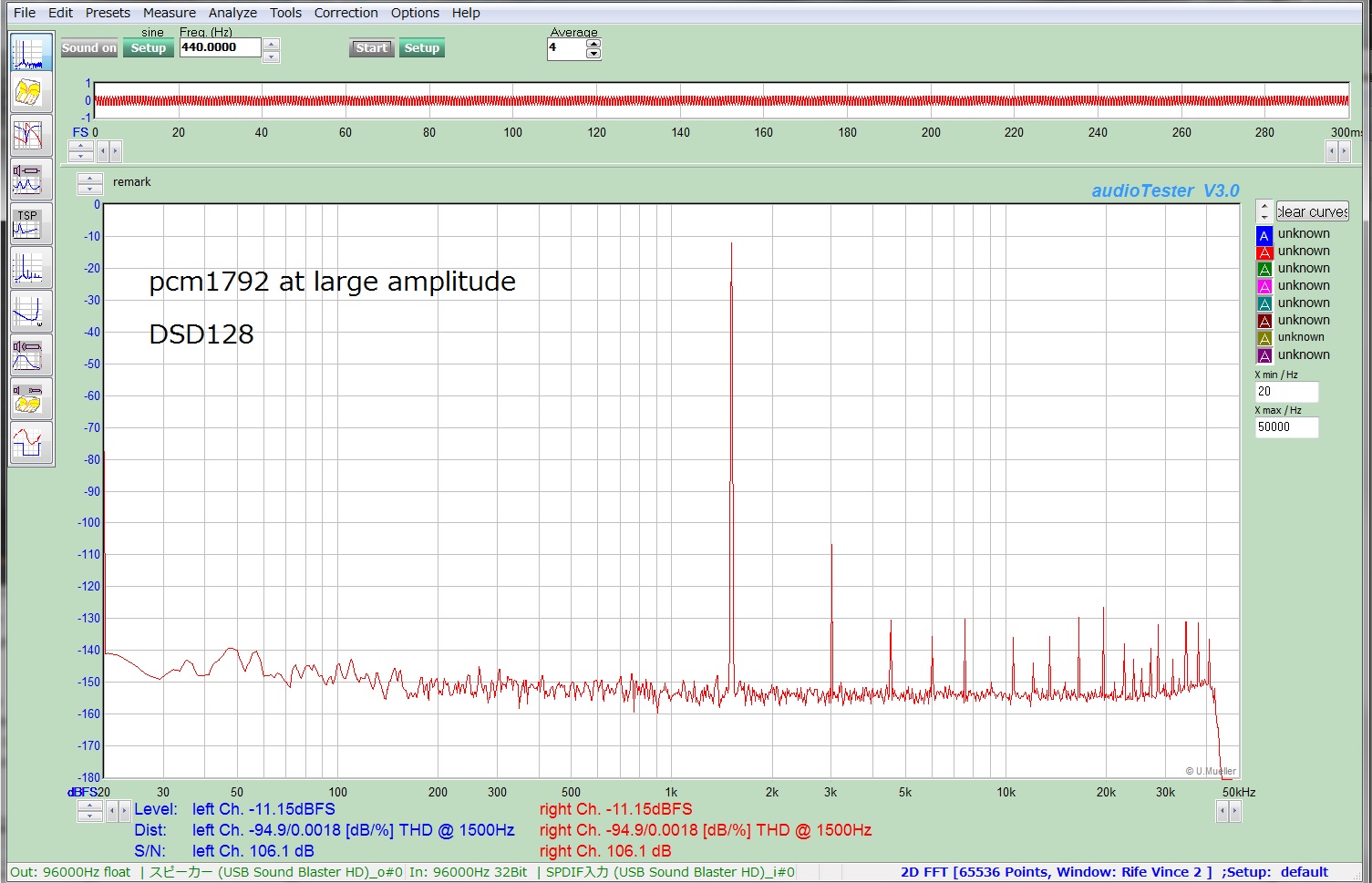

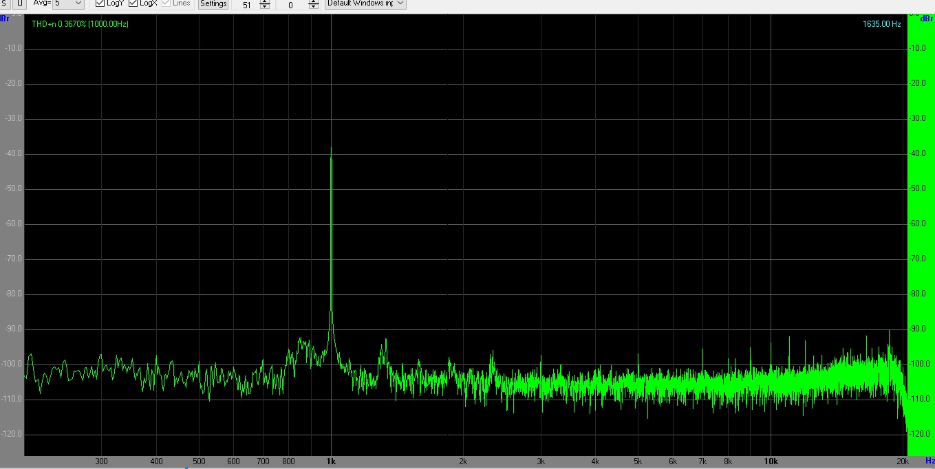

I have finally fixed the 1bit DSM(DSD) of my DAC. 1bit DSM is inherently less amplitude than multi-bit DSM by at least 6dB to ensure stable operation, which means 6dB degradation of S/N. Four-taps analog FIR of my DAC also can't have enough "multi-bit" to improve S/N. That's the reason my 1bitDSM is inferior to those of pcm1792. The 1st pic is my DAC, and the 2nd is pcm1792. Furthermore, low-level performance becomes worse as you posted while pcm1792 doesn't. Both have the same 1bit DSM signal from my FPGA(5th order in the 40bit calculation). I would say It's not the fault of my DSM calculation in the digital domain but conversion circuit in the analog domain.
In large amplitude, both have almost tha same performance(the 3rd pic and the 4th pic). I don't know why Chord or Psaudio can have excellent numbers in 1bit DSM, though the potential ability of DSM outperform PCM. It's easy for me to implement multi-bit DSM such as 2bit or 5bit(the 5th pic). For music playback, 2bit DSM, which can outperform pcm1792, is the best for me.

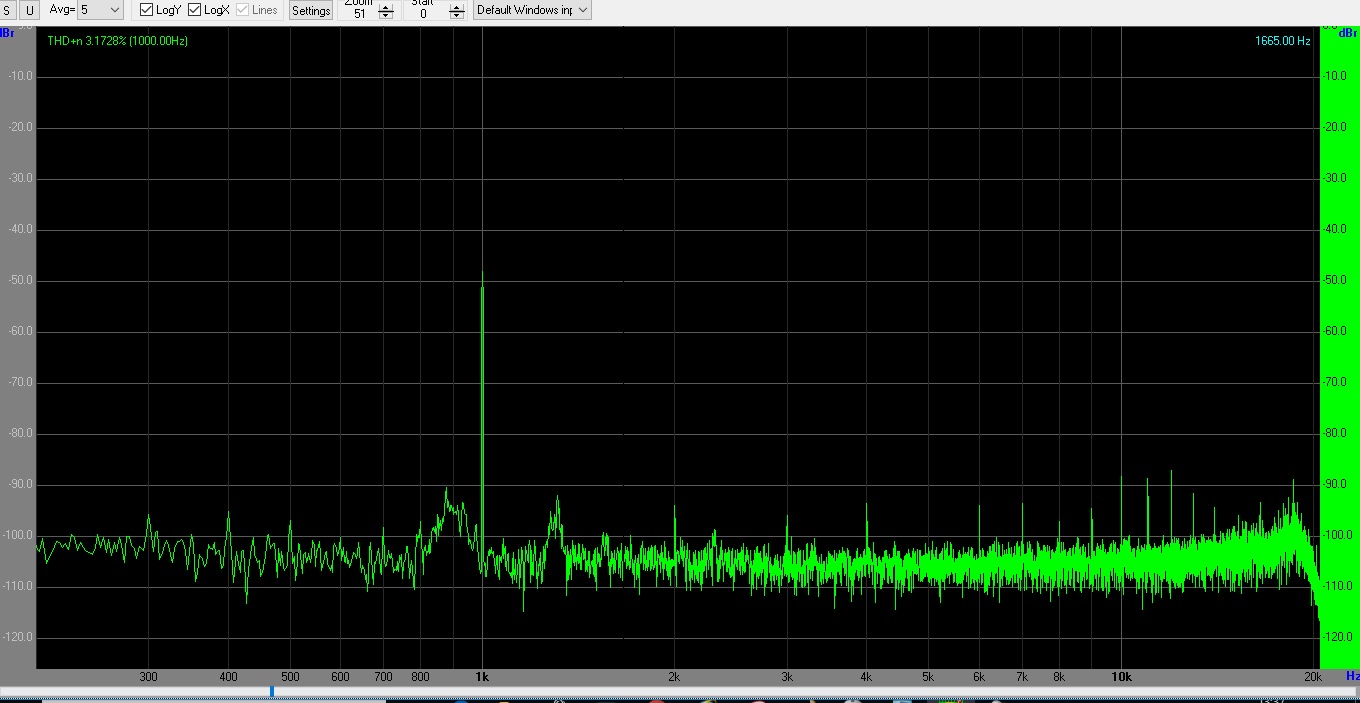

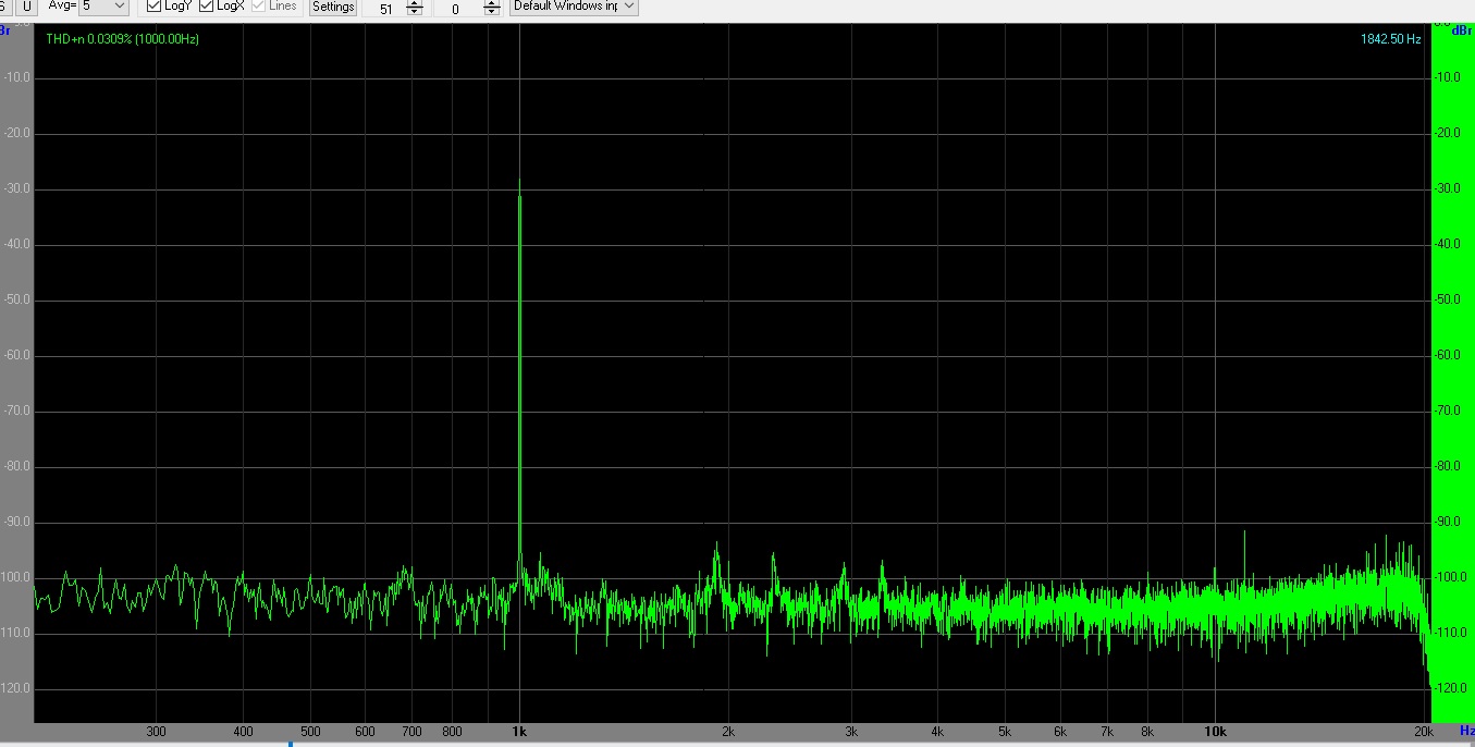

Member Hans Polak was kind enough to make some clean .wav files with 24 bits pcm encoded -20, -30, -40, -50 and -60 dB.
Here are the results form my NoDac.
It is an Amanero USB to a 74AUC1G74 only using Q out to 1 kOhm / 2N2 lowpass to 10 uf DC blocking capacitor and to 10K:10k transformer.
I have listened to it and it sounds very good indeed, although I have the infamous noise problem, probably because of too long unshielded wires to the 74AUC1G74 . Because of this noise, I cannot be completely sure, but my first impression is , that this is the best I have heard from a digital source. :yikes:

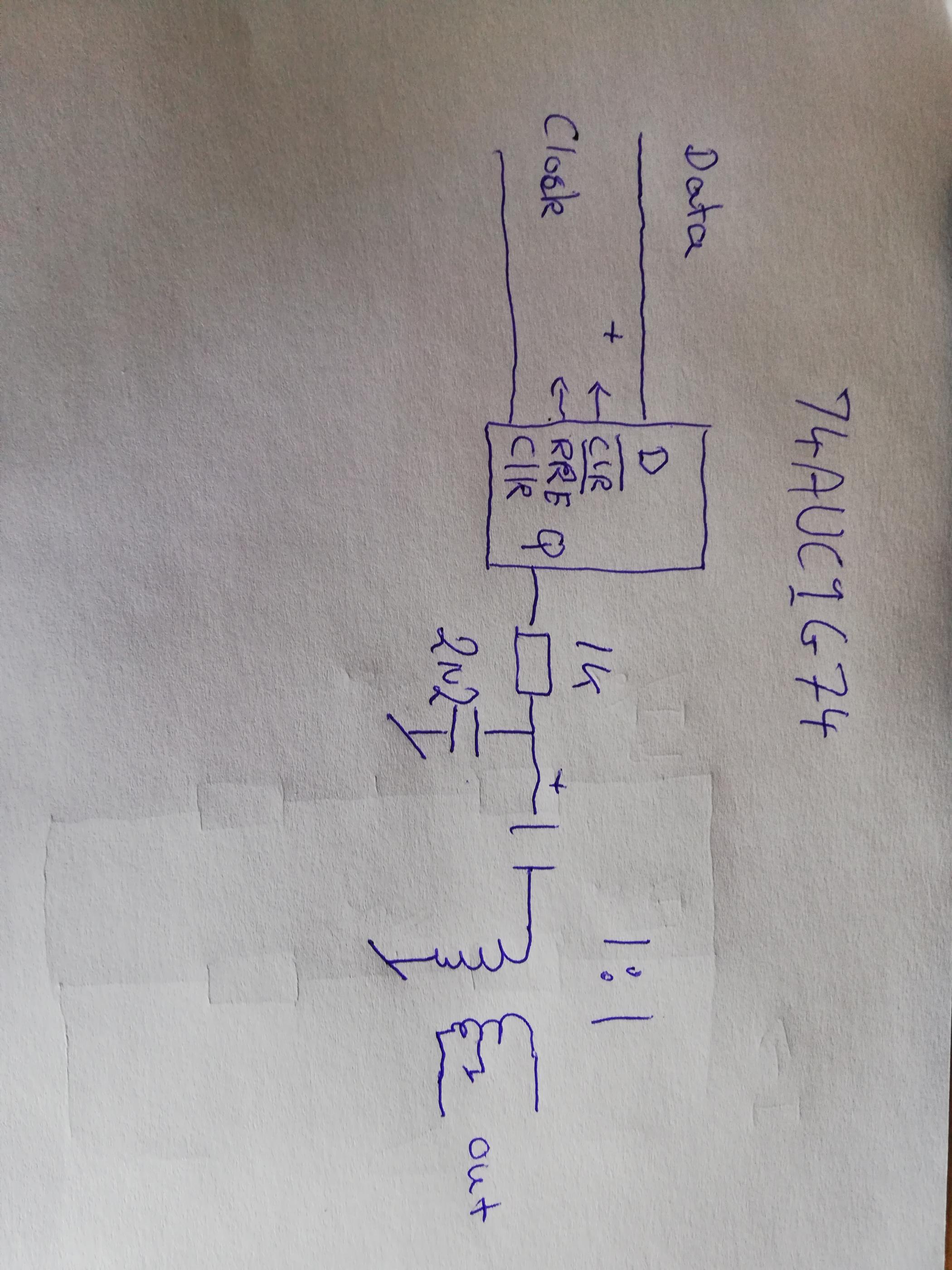

Why you need 74AUC1G74?
Could you post schematic?
About the noise listening music: Do you use separate HDD cpmeted to PC or laptop?

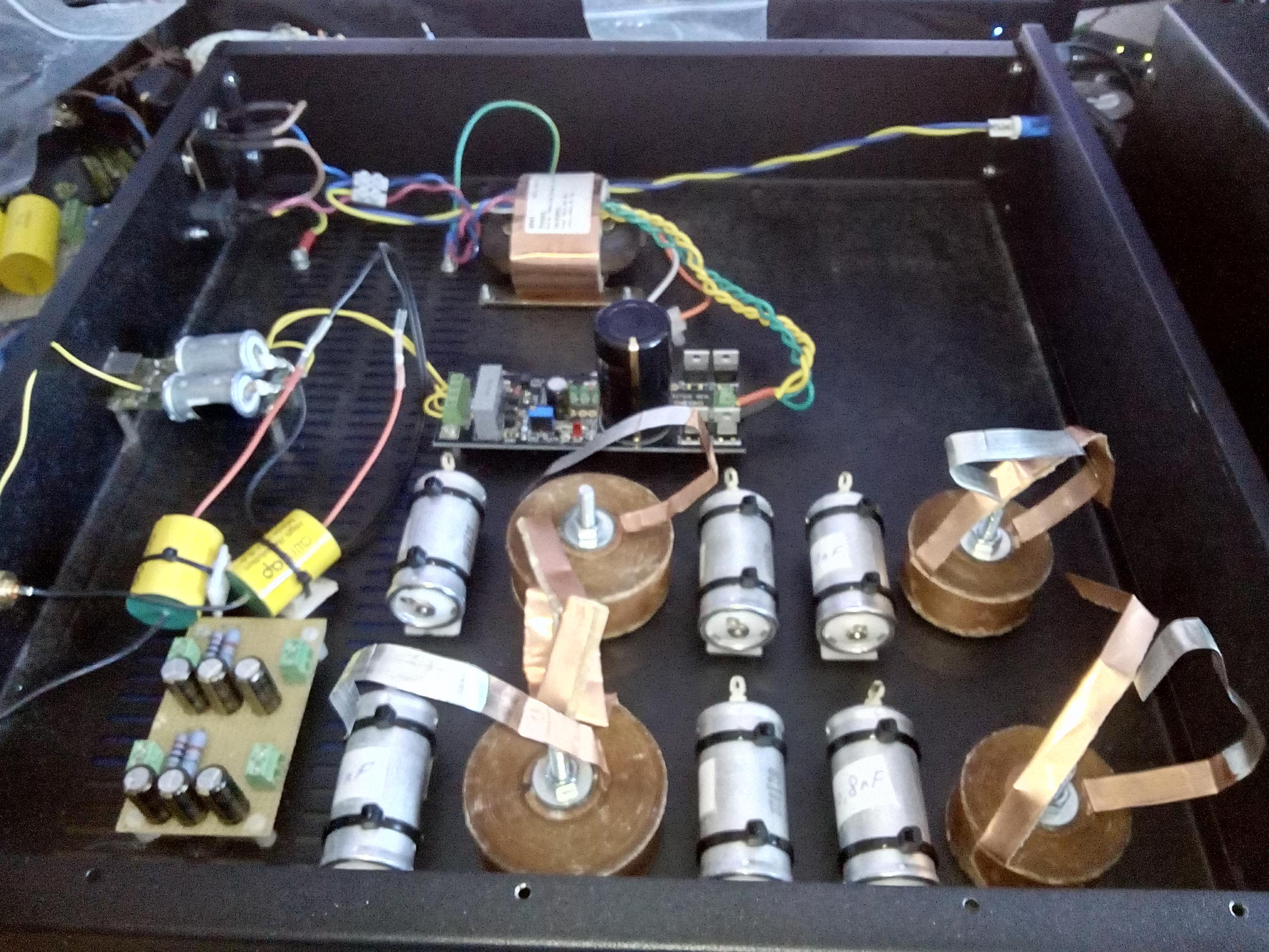

Attached pic with the upgrade for my friend Antonio to LCLC 4th order.
Why a FlipFlop? Because the distortion figures are lower this way. Why 74UAC1G74, ? Because it measures far better than 74HCT74.
And I just listened to a version with 74HCT74 and it is not as good as the AUC1G.
I made a R/C - L/C lowpass and used coax cables to connect the clk and data to the 74HCT74. Less noise but still far to much. Wonder why?
"Do you use separate HDD cpmeted to PC or laptop?"
I do not understand what you are asking. The noise is there wheter I use an isolator or not on USB and it dosent matter if the files I listen to are on a HDD or on my server (cable- not WiFi)
What kind of noise do you hear?
More of a constant hiss, a dark rumble, tones/noise/hiss that is dynamic e.g. depending on loudness of the music.
Do you have that flip flop nicely decoupled with 100 and/or 10nF and besides coax: short lengths are best.
Maybe invert the clock to the flip flop, or invert the clock to the interface?
Other thing comes to mind: if you're not at dsd512 the clock is too fast, you could reclock the bitclock from the interface, maybe you're experiencing stability issues because of jitter from the interface and not all bits clock stabile.
Just guessing here;-)

Hi Koldby. Please try to put MCK (master clock) @ flip-flop CLK input pin. OR recklock SCK with MCK and after that clock the data f-f chip.
And repeat clocking with 2 f-f, to avoid metastabile state... F-F chips are usually double inside, use booth of them in cascade.
I tried clocking with MCK and 2 f-f and it is better sounding.
cheers
Another thing, I think that this 1bit dsd dac need a sort of current conversion. So I suggest to put some say 4.7K serial R at -output of f-f, and to use some Riv 2.2K cca to ground. (or some values to acheive standard pull-down resistor 10K, depends on the driver of f-f output circuit...). After that use Cout and analog filter to interstage xfrm. Take a look at the signalyst dsd dac one bit output.
Also I would suggest analog RC terminating secondary of transformer with 15KHz analog signal to eliminate ringing. Take a look at the jensen papers, Find max R and min C without ringing. Then terminate with larger value of R. That is sounding better because of less"compression effect" then just terminate with smaller value of R at the secondary... f-f is not powerful driver...
I'm guessing they have a different hardware setup, so maybe they have had more time to optimize the software to it, anyway: looked at lots of online measurements of dacs and even some expensive stuff really isn't that extremely good. It might not even sound as expected from the measurements, but that's another issue.
Do you know the distortion your soundcard generates at those high amplitudes? It's a pain at those good figures, either way: those are nice specs! 🙂
