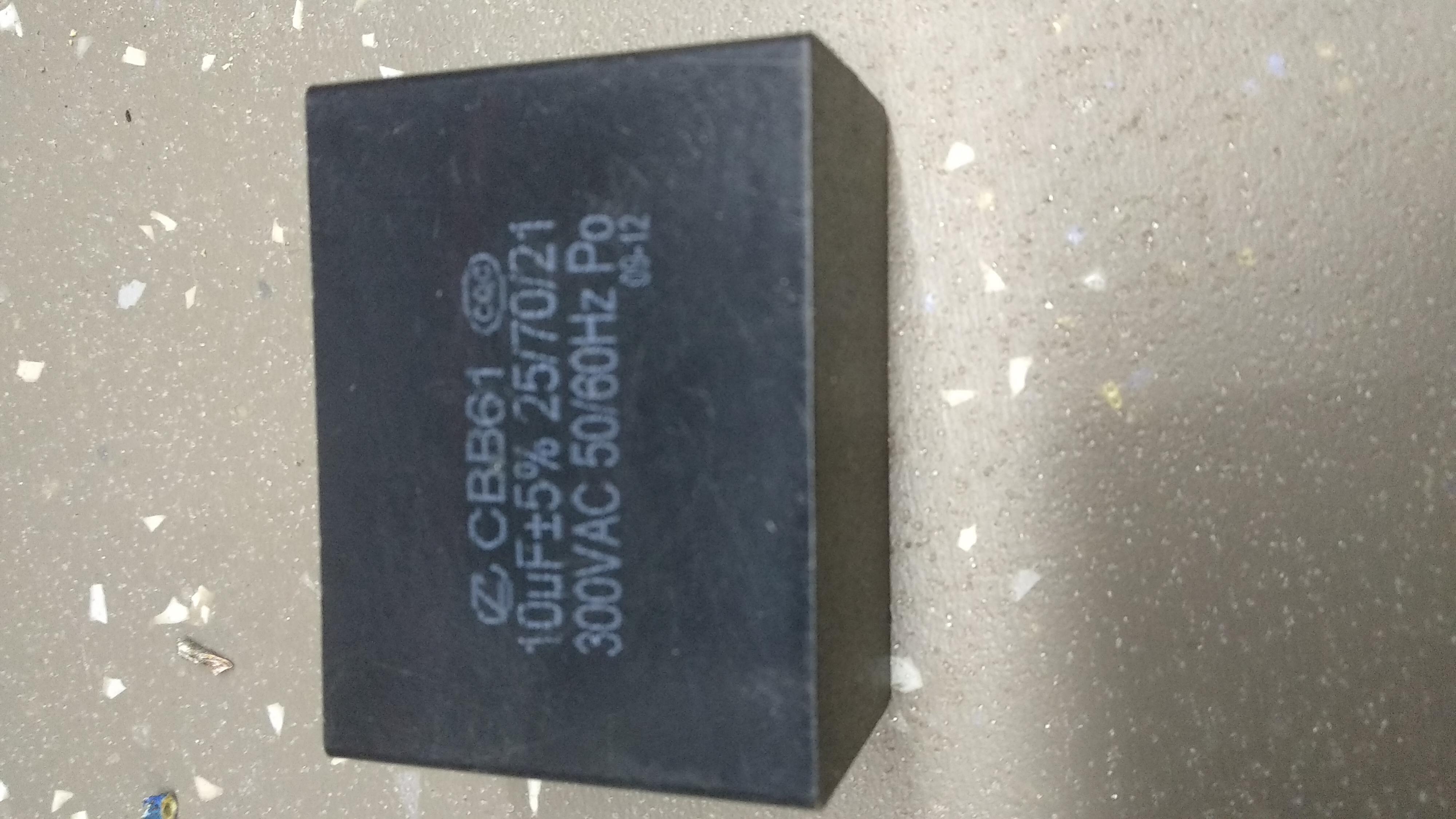

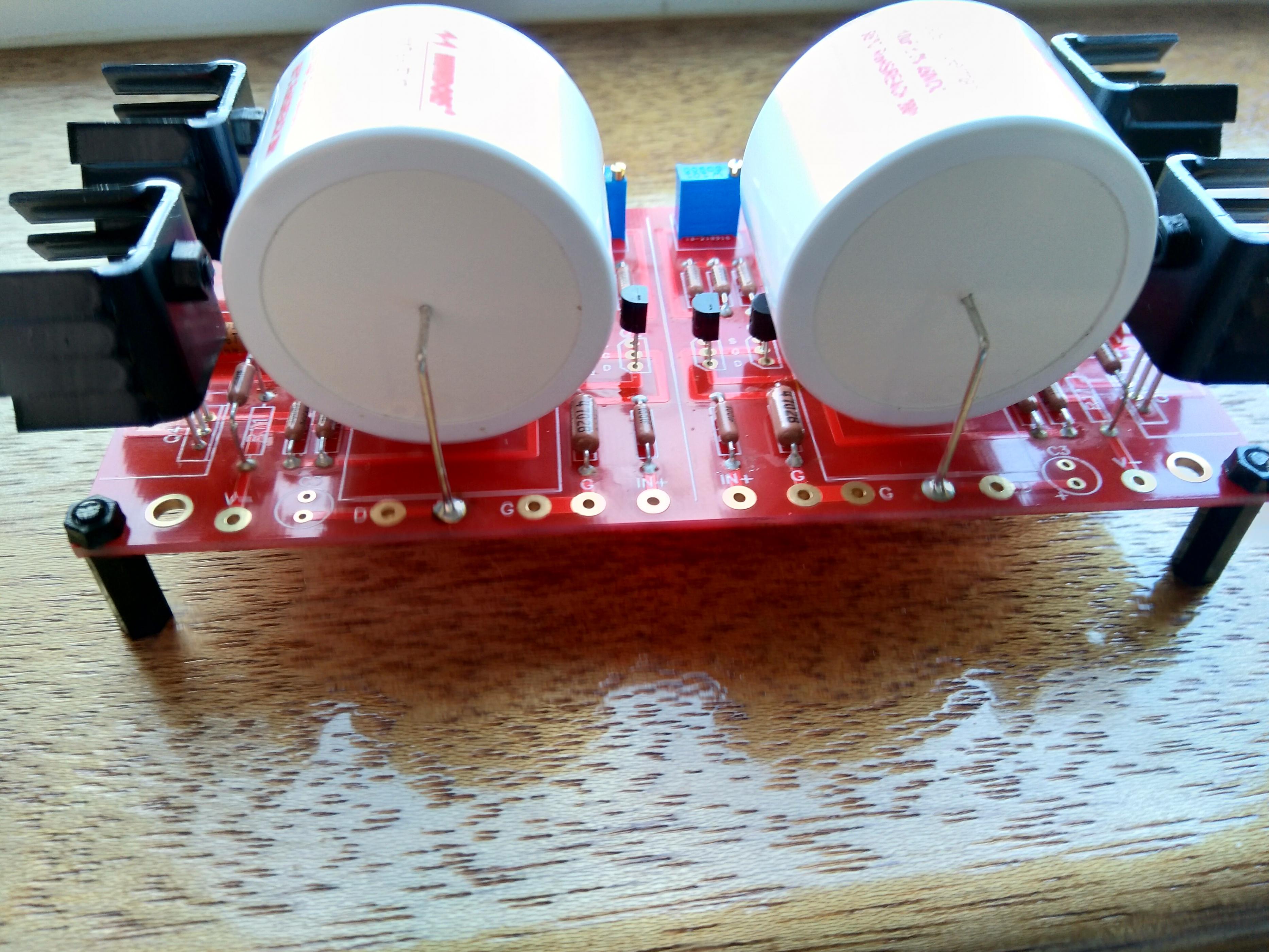

"Don't laugh at my BA-3, I mistakenly bought components that are oversize and crammed them in."
I did the same when I built my EAR 834 clone.
I stuffed it with 5w Kiwame resistors! BIG!
Those are some monster coupling caps. The board looks much better with the rest of the components the right size.

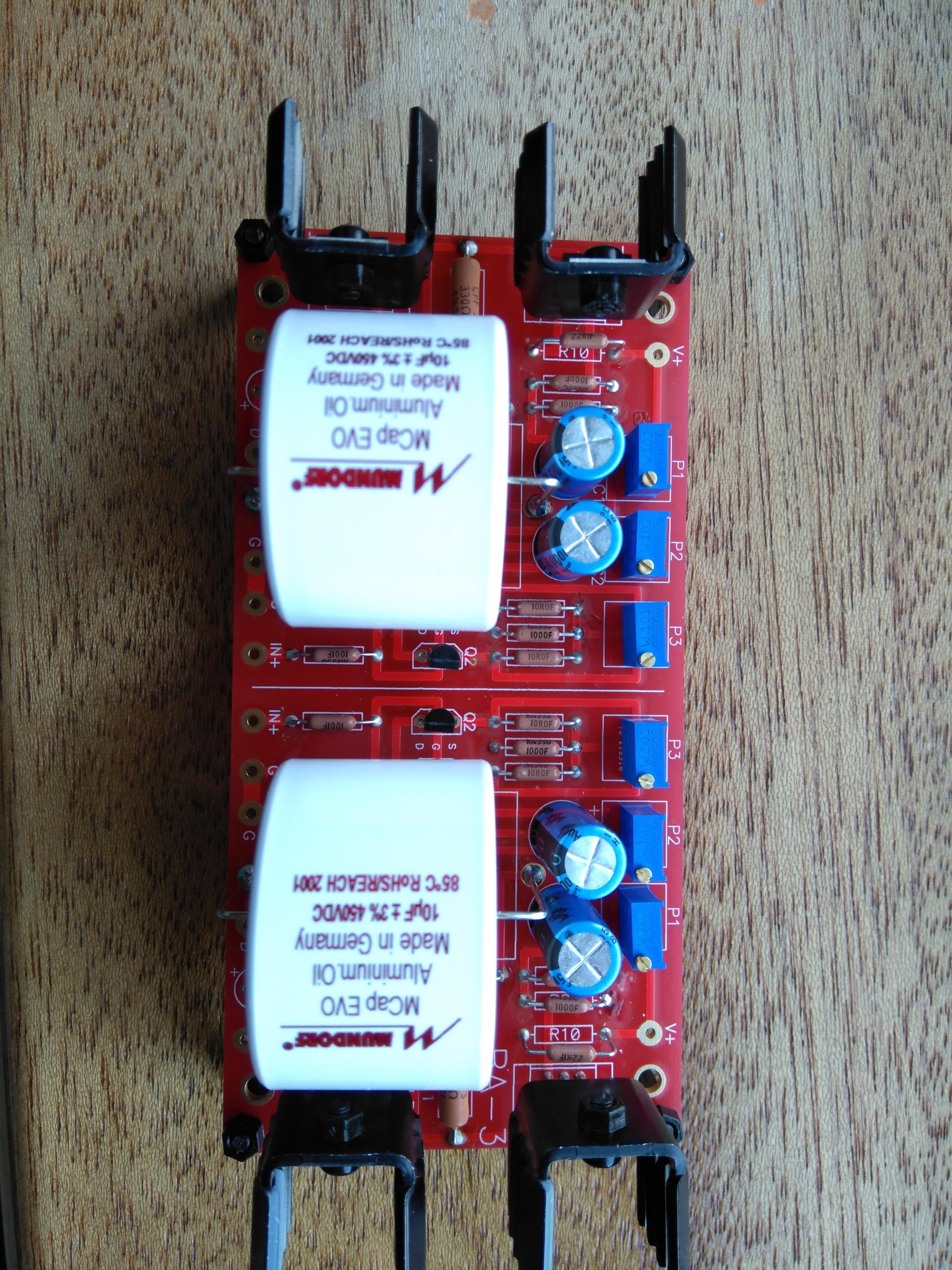

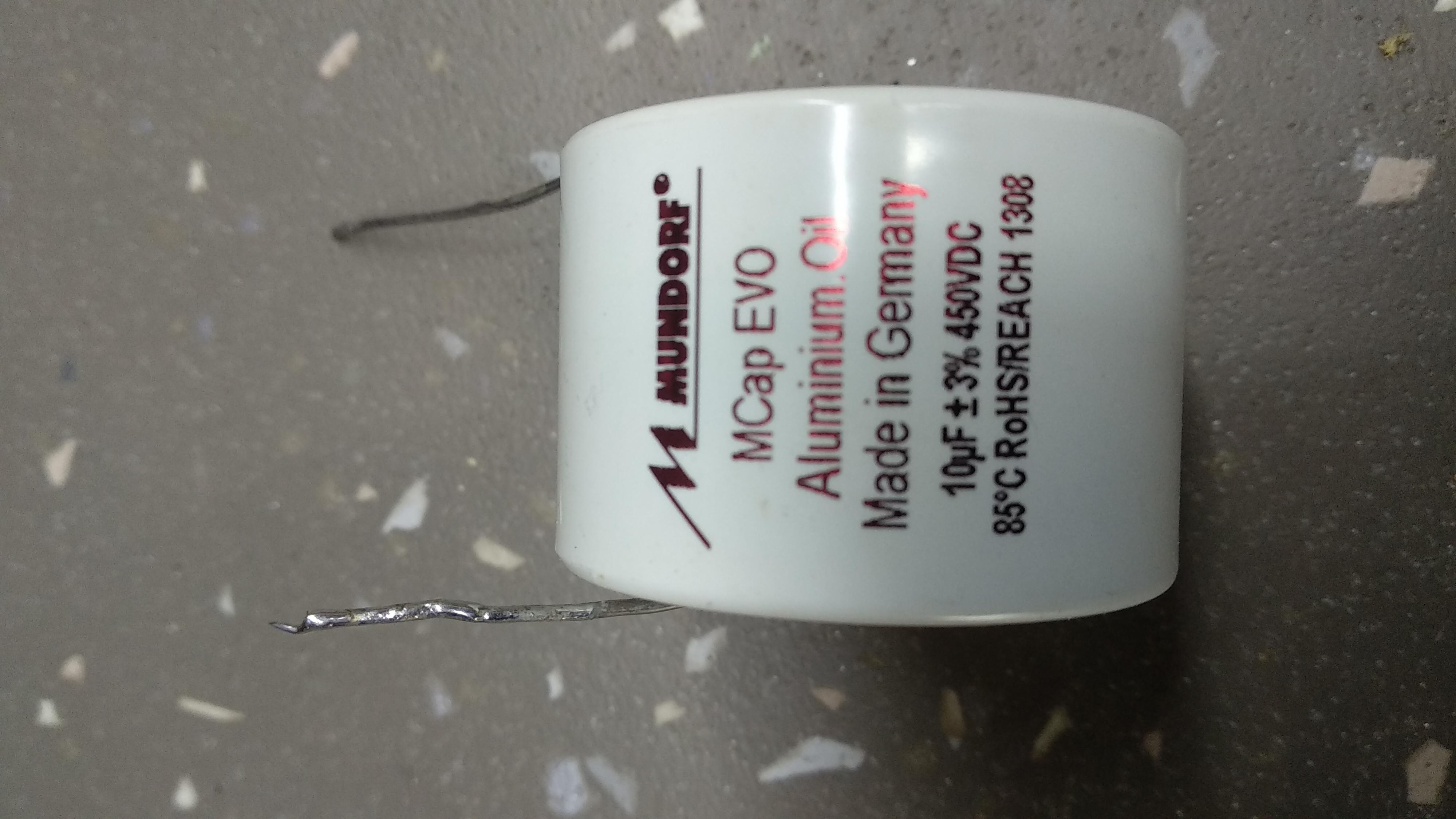

I went ahead and put these caps on the outputs of both my Pearl 2 and BA-3 FE, replacing the electrolytics and film bypass. 2.2 uF is all I need based on input impedances. I listened for a few minutes and my initial impression is positive, I'll try to do a longer session tonight.
Here's my BA-3 board.
What’s your opinion of the caps?
I listened for an hour or so and I'm happy with them. I think they are an upgrade over the electrolytics, a cleaner/brighter top end with no harshness. On the Pearl I went from 22uF to 2.2 uF, so there is less cap there.
First I was a bit skeptical of the sound at first and missed the warm 2H from B1K but the I left it on overnight by mistake and it sounded wonderful. I bet the Mundorfs sounds terrific.
I know the idea that caps have a "sound" is controversial, but there is a distinct difference in sound when the coupling caps are removed completely from my Pearl 2. Therefore, in my mind caps do have a sound.
I figure $32 or so for 4 audiophile caps isn't too crazy, considering one can spend several hundred on each at the high end. Also, I'm stuck at home and need stuff to do.
I think caps have an effect on sound and I feel a bit of extra spend is worth it, within reason.

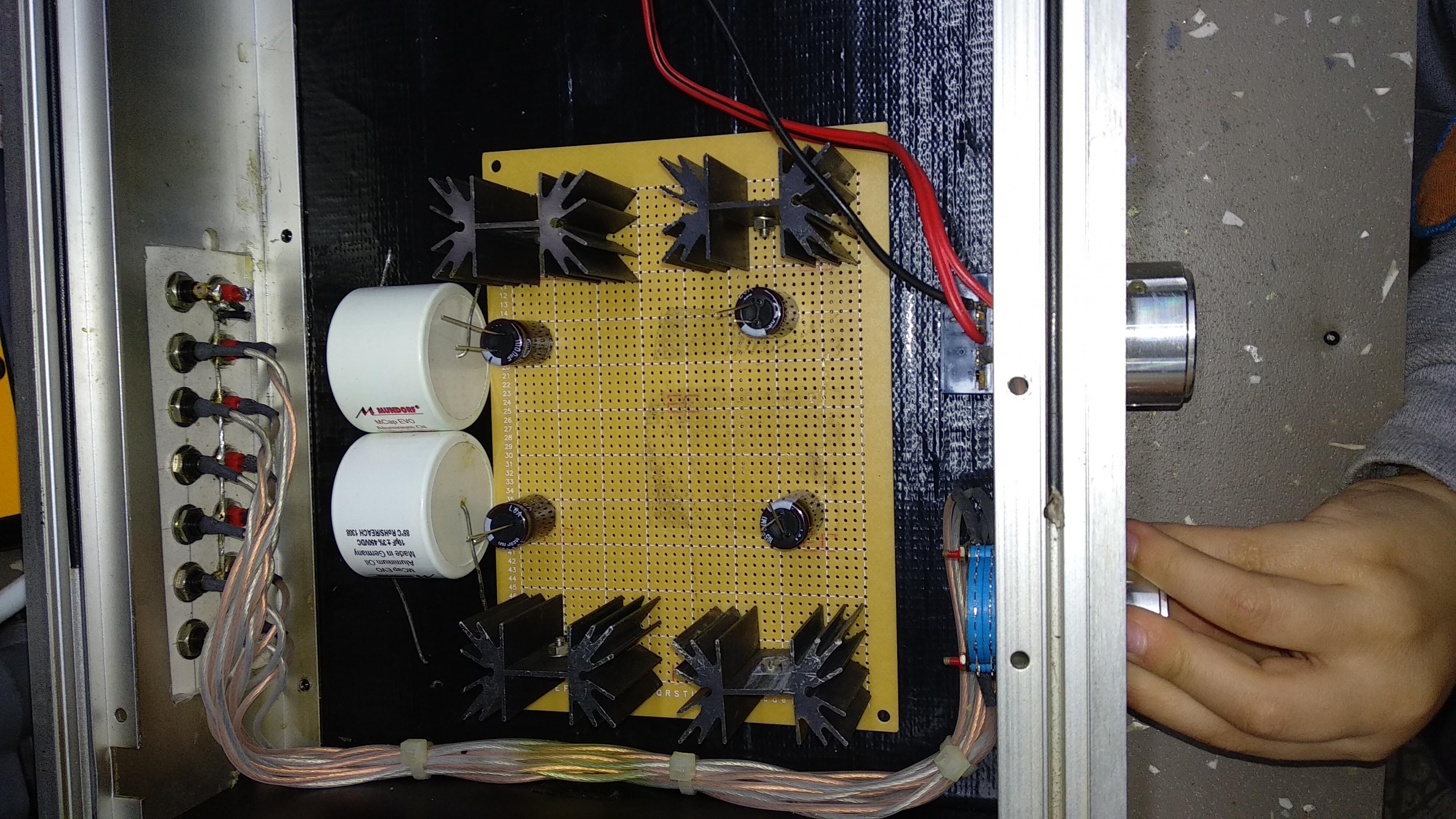

I would like to try to make the pcb here at home Is it possible here on the forum to publish the pcb traces? thanks

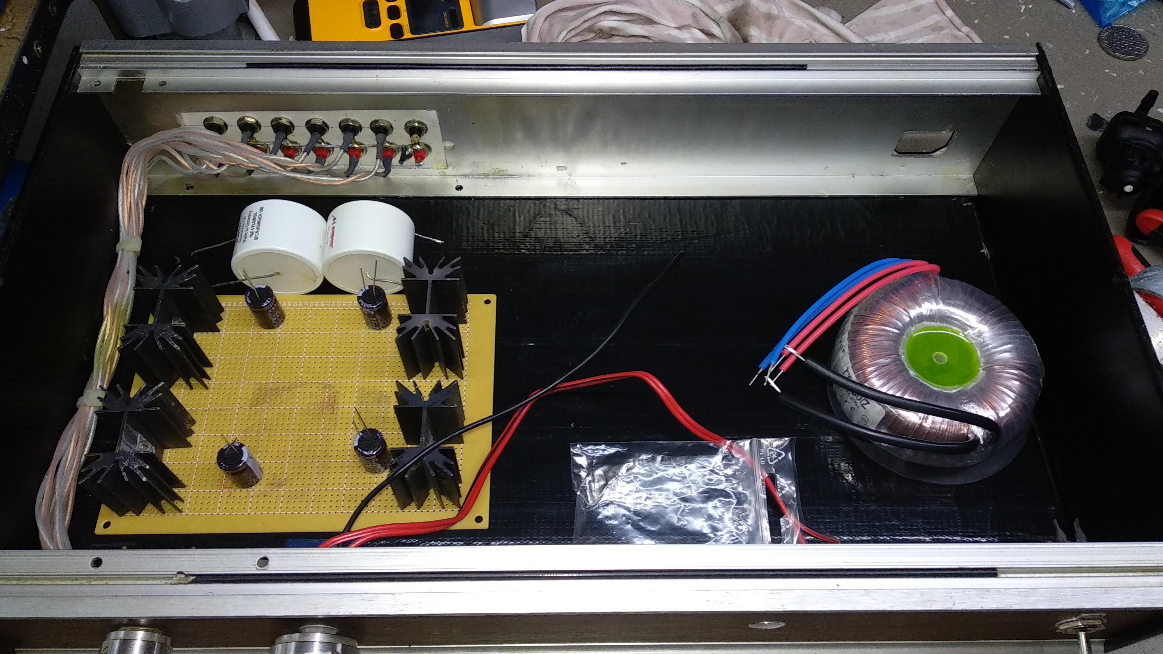

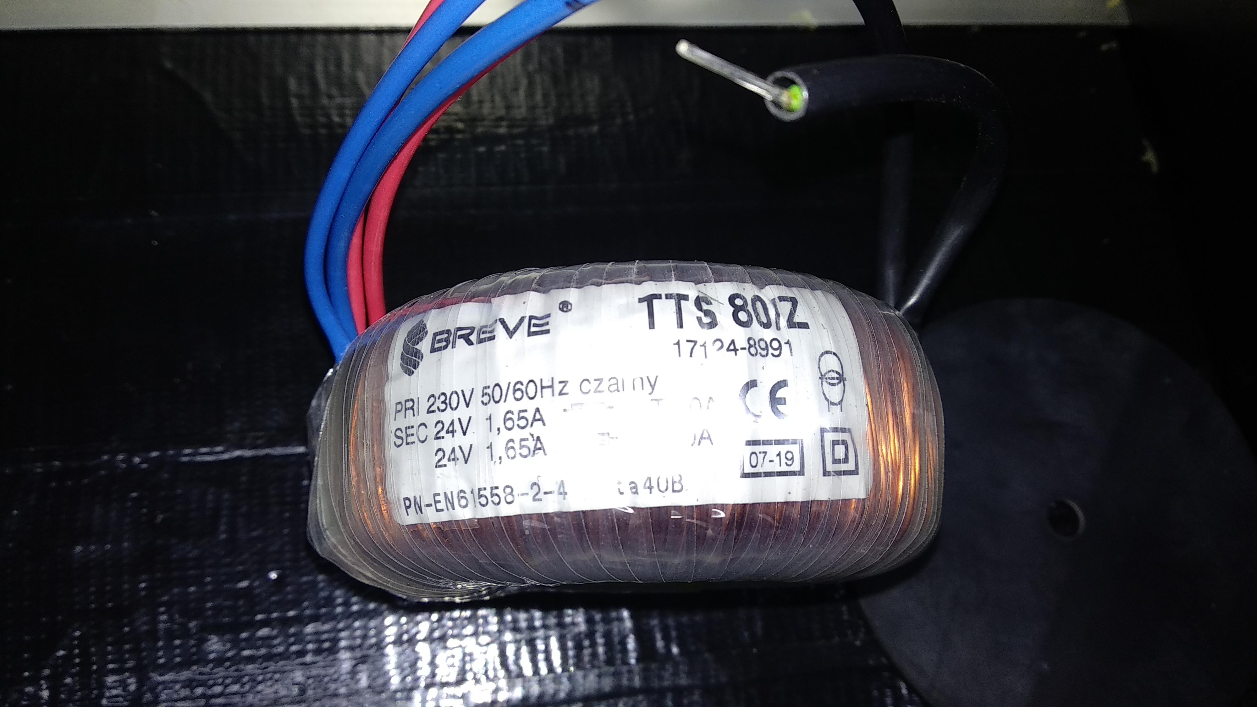

🚧under construction🚧

Looks good so far - you have a lot of sources!
