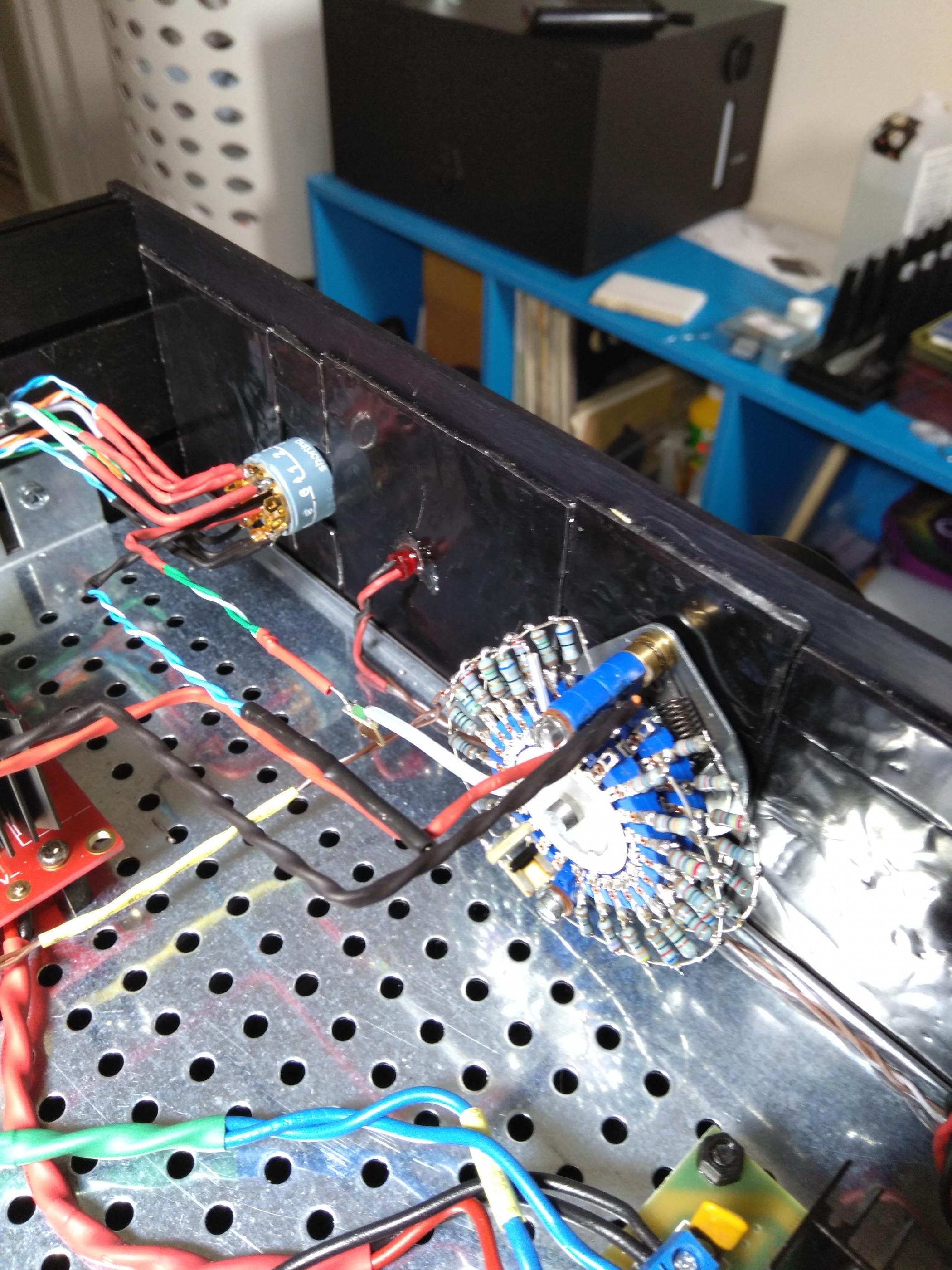

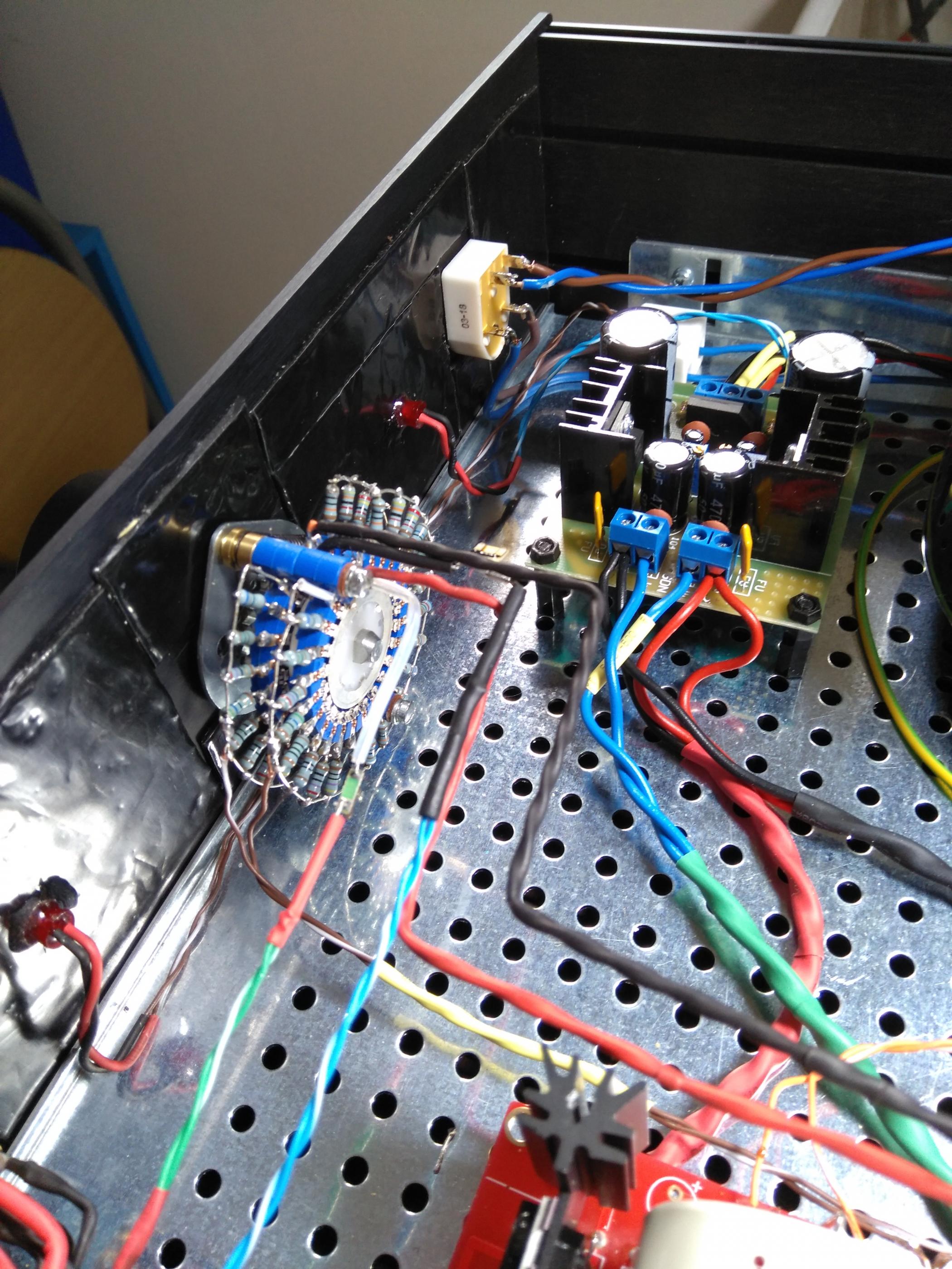

These last few posts have me thinking about upgrading the volume control on my BA3FE. I built mine with a 23 step attenuator off ebay for $25. It sounds great at is... but of course I'm wondering what else might be possible with an upgrade. Curious to know what others would recommend? I've looked at the Goldpoints, browsed through the impressive selection of stepped attenuators at hificollective. I don't know enough about how they work to evaluate the various options, so any suggestions welcome!

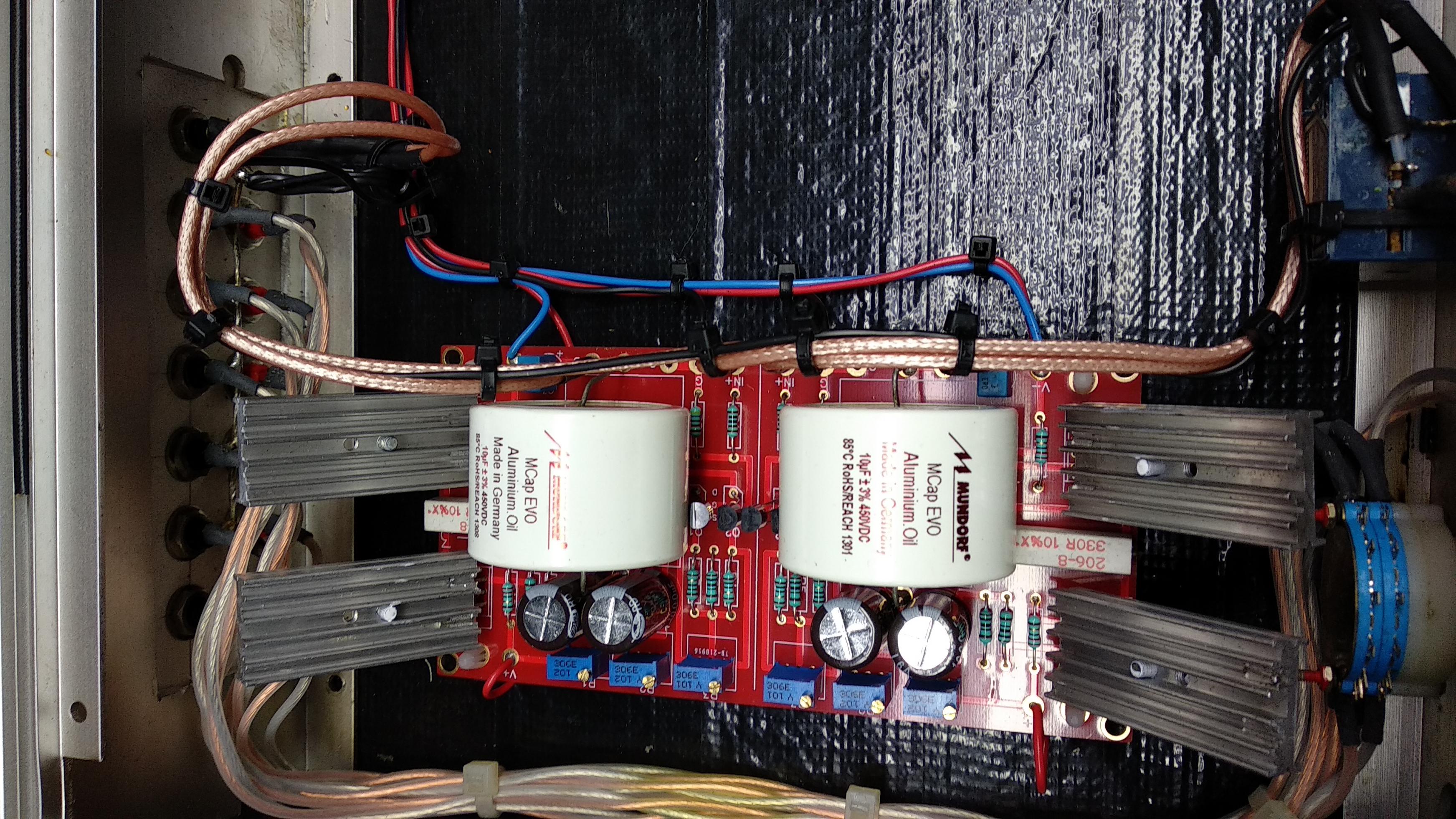

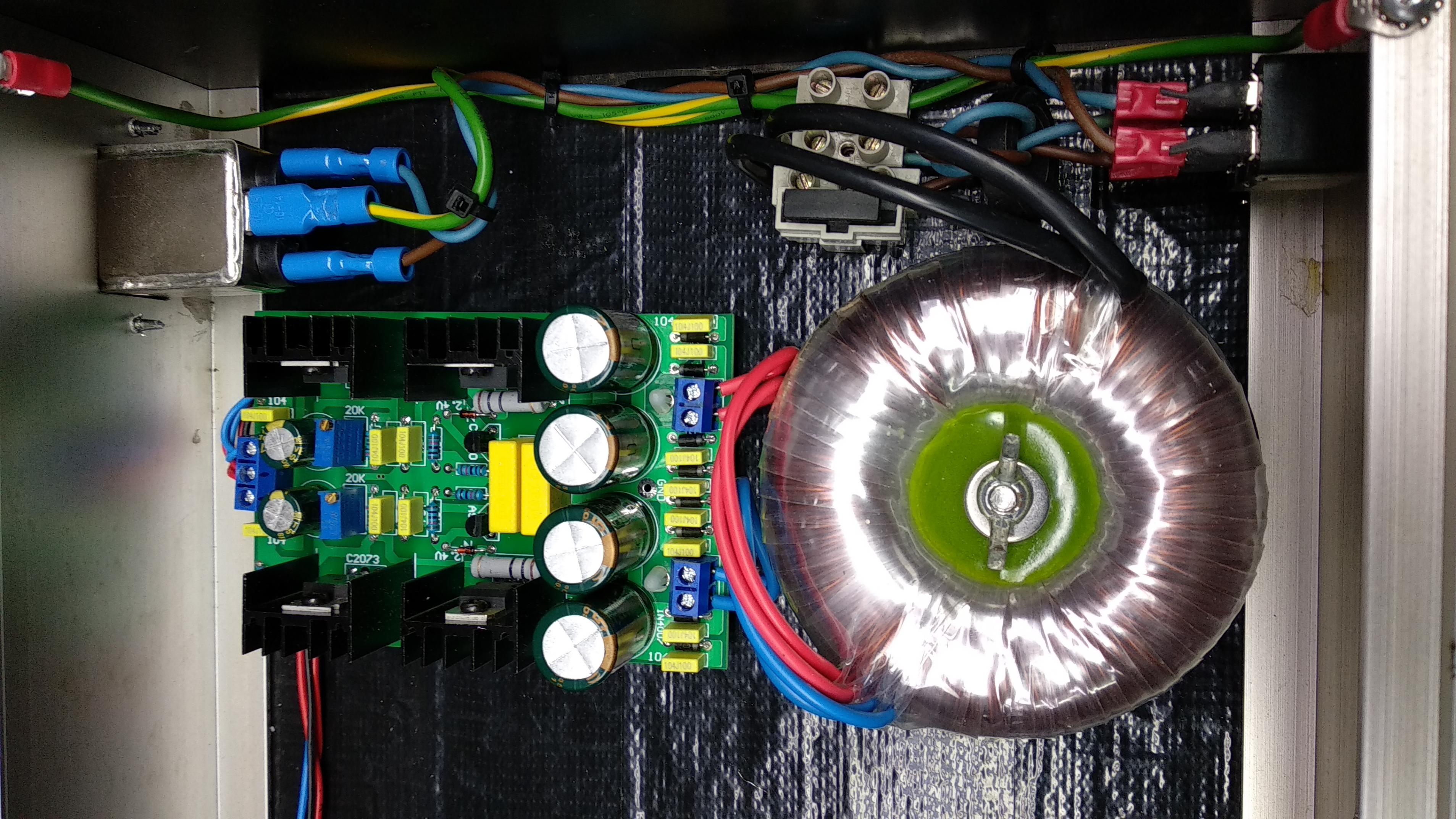

BA-3 preamp done. it's delicious

Awesome!

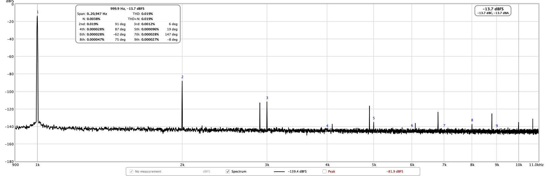

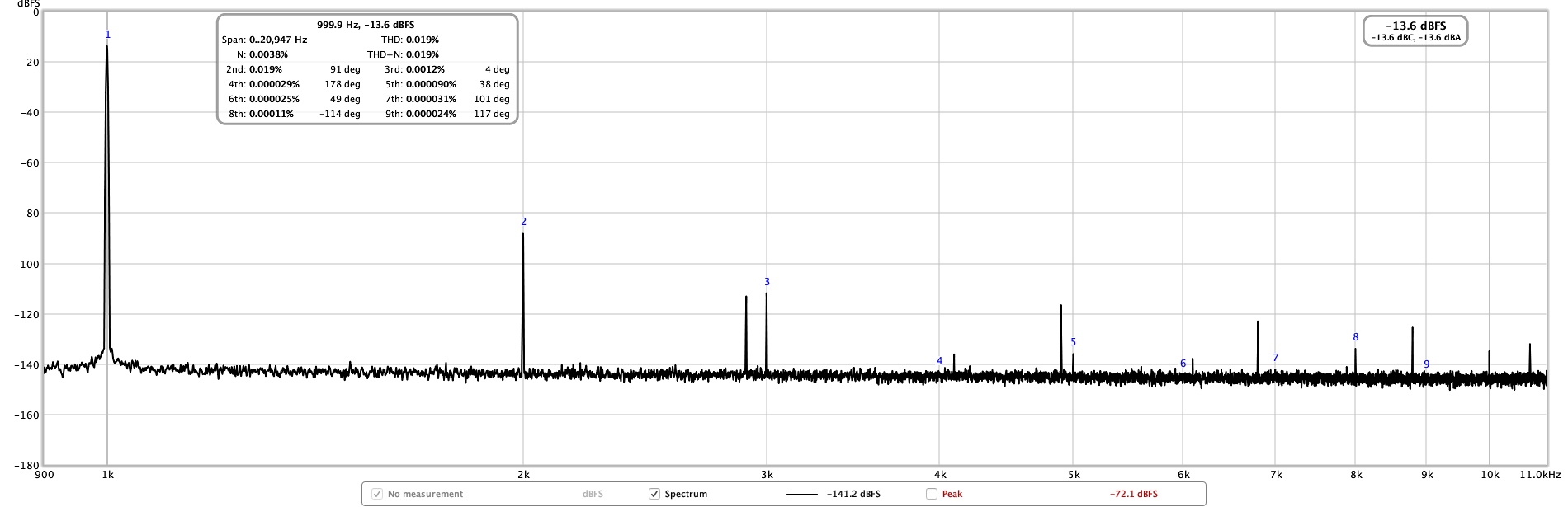

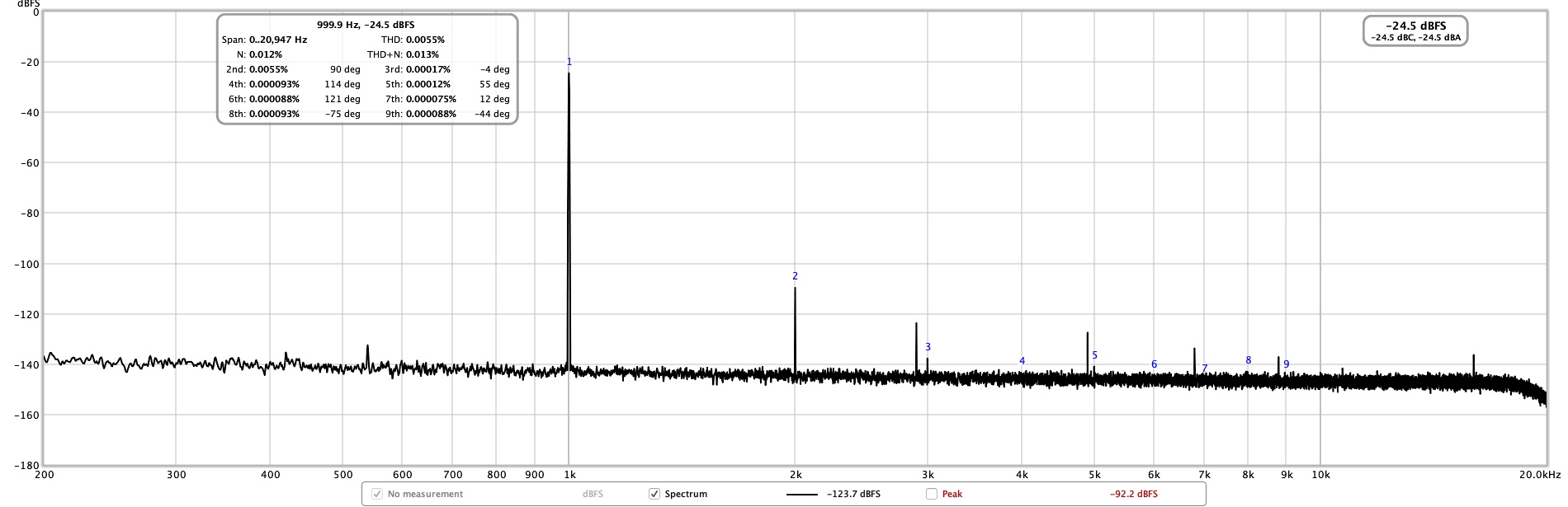

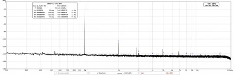

I recently picked up a Focusrite Scarlett Solo and have been having fun measuring distortion with REW. Specifically, it's really proved to be the missing link to truly understanding/optimizing the P3 pot in my BA3 pre. The one thing that I have a question about are a few consistent weeds I'm finding in my measurements. I'm seeing notable spikes at 2.9k, 4.9k, 6.8k and 8.8k. They present consistently on both channels and are not impacted when adjusting P3. Has anyone else seen this in their BA3? Or am I overlooking some obvious explanation for these spikes?
