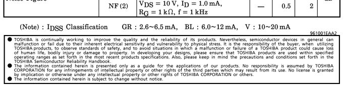

I thought the BL-grades top out around 12mA.
That's the case according to the datasheet. My experience is consistent
with this as well.
Dennis
anil , 17mA mean V grade ?
Not necessarily right. There are outliers in BL grade as well. Mine is BL grade and they are genuine as well.
with this as well.
Dennis
If we can test Idss to the manufacturer's spec, then we will find that no BL grade is above 12mA +-tolerance.
17mA is way outside any expected tolerance.
BUT !!!!
we don't test to manufacturer's spec.
We get an approximation using ~10Vds and 0Vgs to get an Id that is close to Idss which can ONLY be when we hold Tj=25°C
Yes, but I have measured hundreds of those small JFETs and have never seen a single JFET around 17mA. From a bag of 200, highest value is around 11.0 mA Idss.
So sorry Anilva there's something wrong with that pair of 17mA when it says BL on the printing.
Picture?
Picture?
Instead of focussing on whether it is BL or V series of JFets (or may be fake), I am keen to know if a 17mA jFET pair will do the frontend job in BA-3 or should I only use 10mA pairs. I have a stock of good pairs from Spencer to not let me get too worried on the fake parts.
What current will the 17mA devices pass when in the circuit?
From there you can select load resistors to give an appropriate drive to the next stage.
AND
you can determine the Pq of the jFETs to decide whether they will run cool enough or too hot.

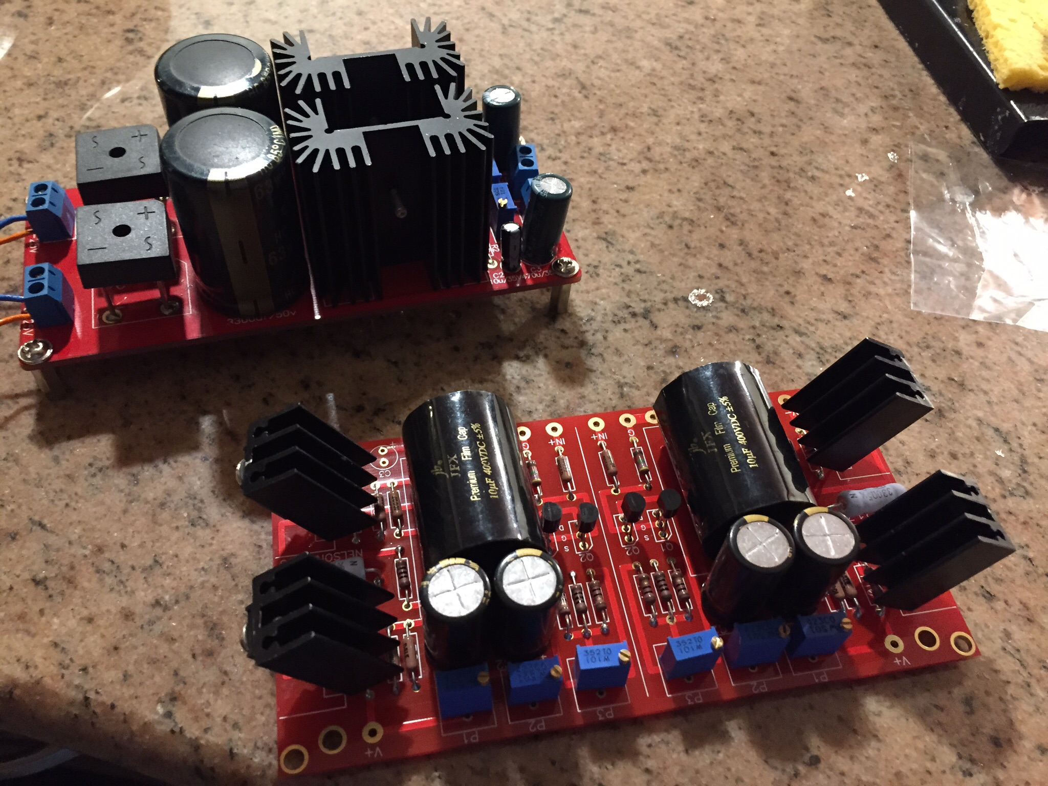

Completed BA3 board
BA3 board is assembled and ready for testing. Built a dual rail power supply using surplus Lm338 regulators and adjusted for each rail at 24 VDC. Got a variac for safe testing. Set the bias pots for zero value and P3 at midpoint.
Will fire up the board tomorrow and report. Thanks to this build guide thread and advice from the forum members and Papa for the design.
Cheers.
Cheers.
The board works flawlessly. Biases to 45mA. No problem. Did not hear yet. Will need to remove my B1 and mount this in the preamp cabinet.
