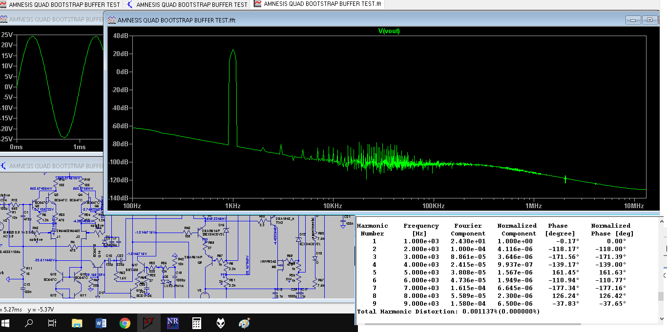

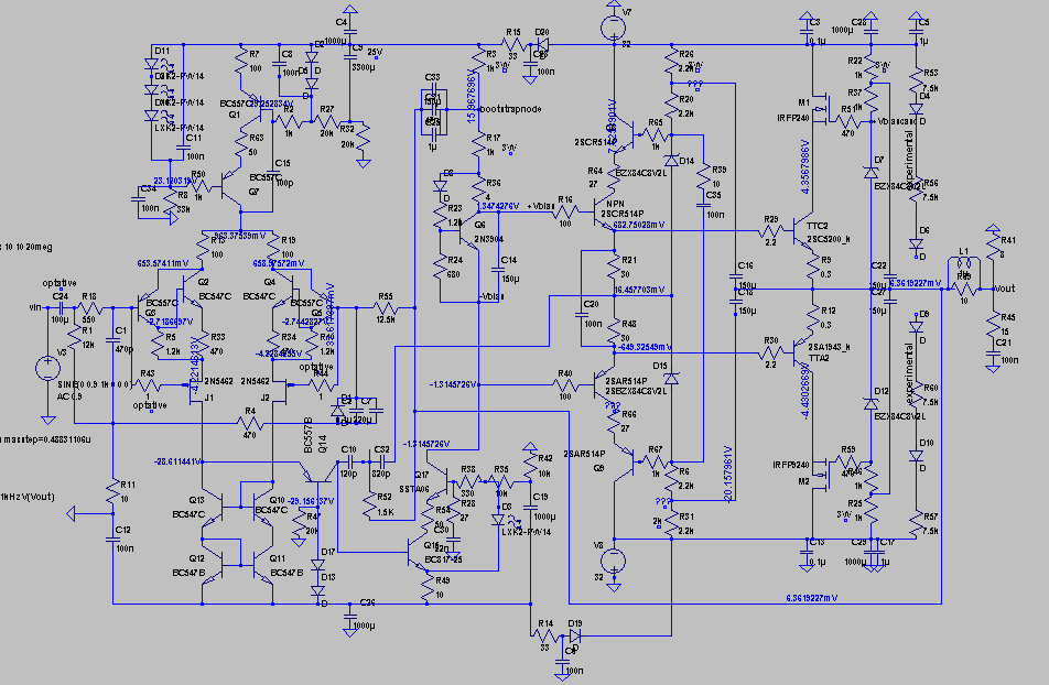

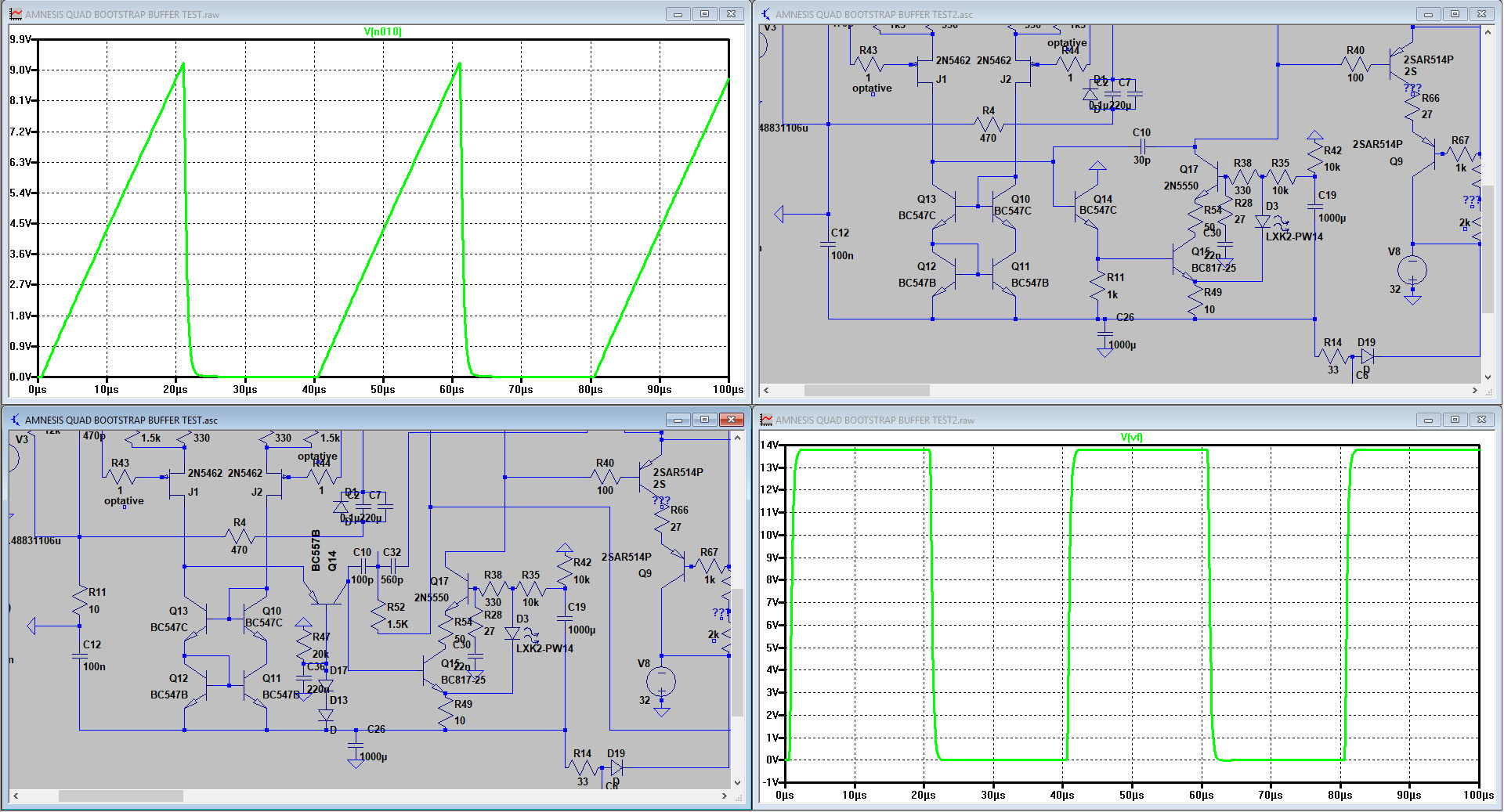

What about this one? 🙂
I took the bootstrap for the drivers from the drivers middle point separated from output node. I included the common-base buffer for the current signal to the VAS. Both classic Miller and Two Pole will be tested.
  • AMNESIS QUAD BOOTSTRAP BUFFER TEST.asc

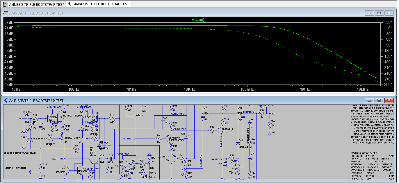

Hi dear JOSI1,
Today I had the time to experiment. You know I will try any trick that seems reasonable, to my highly trained intuition... 😀
First, neither mod made the bursts of oscillation to dissapear.
Second, the "driver central point" mod was not to my liking: it made the music sound too tight. I reversed to stock version.
Third, the common-base PNP buffer Q14 worked very well. I have to make extended listening tests but so far I am very pleased: music seems more focused and clean, with better color and textures to the instruments.
M.
PS: I had not the time to try the Dual Pole compensation yet with this trick.

After a view weeks of renovating my apartment I have more time now for updating schematics and layout. So we have to coordinate the next steps.
I already added the RC element (10R/100n) across the zener diodes of the driver and the common-base PNP buffer Q14.
I think the caps from the bases of the driver cascode transistors to GND are obsolete now.
What about the gate stoppers R43/R44 for J1/J2 and the suggested 0R resistors at the collectors of Q2/Q4 in the input stage??

OK. Update.
1) Zobel position, before of after de L//R output, does nothing to the oscillation. I was about to try 47n Zobel cap but, nah...
2) Two pole compensation does not abort oscillation bursts. I am using lowish caps, 100pF+560pF and the amp does not go into full oscillation. With higher caps margins are much better. Because 1) and 2) I still think the bursts are not global feedback related...
3) Adding 47nF caps in parallel to R26 and R31 (bootstrap for the Vref) reduced a little THD and gave good margins on simulation. At iddle, the max amplitude of the oscillation was reduced to 30mV, BUT, when testing even at low volume the thing went into full blown oscillation. So out with them.
4) I added 100nF film cap C37 (polystyrene they said) between bootstraps caps C16 and C18, which didn't seem like a good idea at first. The reduction in THD is marginal but the thing is actually stable (no influence on periodic bursts) and sounds good. More testing needed.
Which reminded me that I never tested Symon's idea to increase the Rs for the driver's cascode Vref...
There are still multitude of mods 🙁 to try...this is the fun of amp building 😀
BTW, R33-R34 for the NPN's emitter of the input CFP were changed from 330R to 0: there is a perceptible change soundwise. No R is clearer and more focused but IMHO looses some of the midrange magic. So I think this position is good for experimentation on flavors. The other positions of the input sub-circuit we discussed are not sine qua non and we can pass without them.
I had not the time to experiment further with the VAS. Maybe a Mosfet cascode/bootstrap for the VAS would be OK. I have to find a mid-power N-channel.
M.

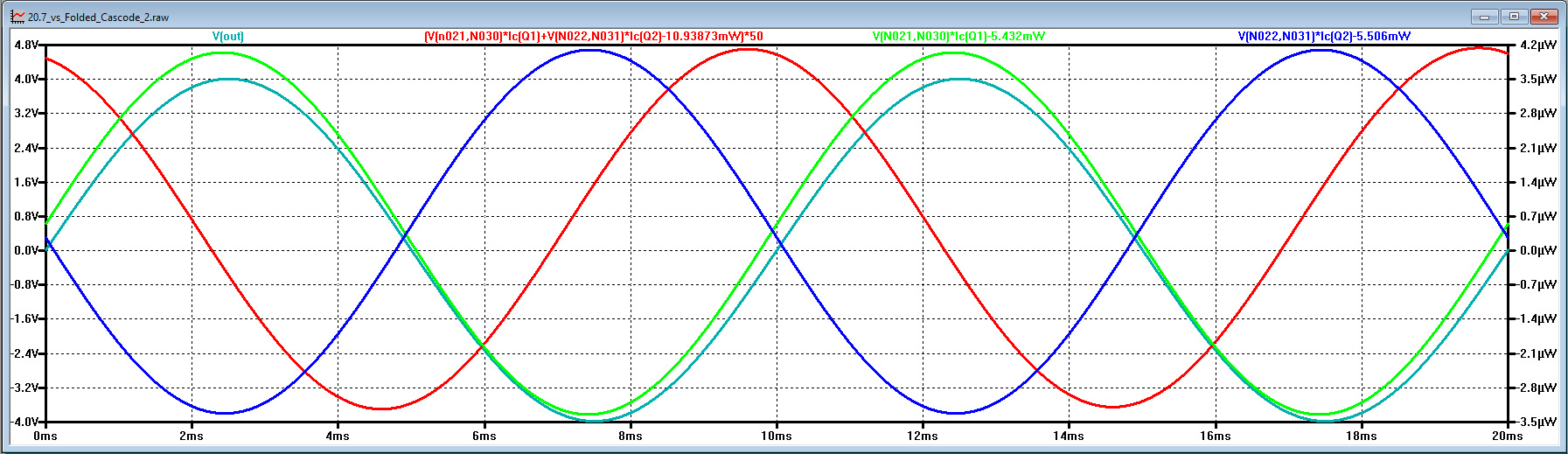

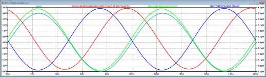

Dear Max,
I have read most of your efforts with great interest and I appreciate a lot the road you have followed.
However, after having given this subject some thoughts, I would like to express some doubts about distortion from memory effects.
At first a few initial info's:
- A transistor will need something like 1 calorie to increase its temp by 1 degree.
- 1Wh = 860cal
- Vbe has a tempco of ca 2mV/C with an IC of several mA.
- Music has an average value of 0 independent of volume.
- It takes some time to heat up or cool down, so very high frequencies will probably have no single effect on Vbe temp.
For this reason I have taken a 100Hz signal with an amplitude of 0.17V resulting in a 1Watt signal into a 8 Ohm Load for my main amp, having a gain of 23.3 or 27.3dB.
This main amp has a cascoded differential input pair, with a tail current of 3 mA.
The image below shows the output signal, 2.8V eff, but also the delta in power consumption in green and blue of the two transistors forming the input pair (Vce*Ic).
Red shows the sum of both power deltas, and as can be seen in the topline, the level in power change of the sum of both is even a factor 50 lower !
I have added both levels because my input pair is a monolithic dual transistor, most likely smoothing out individual temp changes.
But let's try to look at just an individual transistor.
Every 5msec, 3.1 uWatt will be added or subtracted, the integral of the Sinewave.
This is an amount of energy of 15.5e-9Wattsec.
With 1Wh=860cal, this figure translates into 3.7e-9 cal or the same amount in degree temp change (see initial info's).
With 2mV/degrees for Vbe, this results in a Vbe change of 7.4 pVolt.
This amount of Vbe change lies some factor 1000 below the main amp's input noise of a least several uV/Hz.
So my feeling is, could such a small memory effect do any harm at all ?
Making things even less likely is the fact that with a monolithic input pair the 7.4 pV becomes even a factor 50 smaller, well into the femto Volt region !
This of course is all using the example of my main amp, but other amps will probably not be that far off.
When you can hear differences with the Skilay layout, I think that has probably to do with other effects than memory effects.
Hans

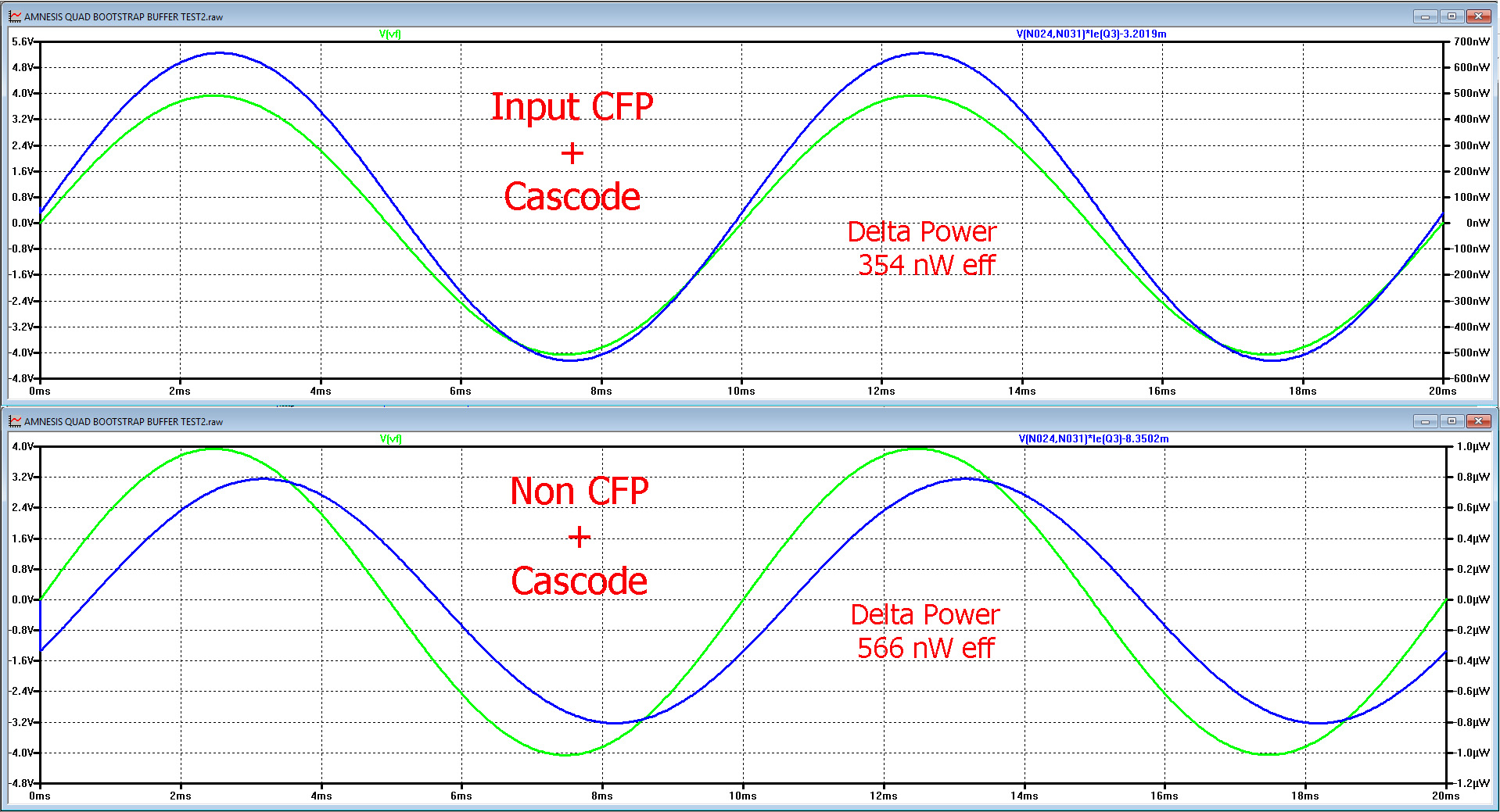

With the (modified) LTSpice Amnesis model, I was able to investigate what difference it makes with the Szkilai Complementary Feedback Pair against a non CFP treated input.
Like before I used a 100Hz input signal giving 1 Watt output @ 8 Ohm.
In the image below, the upper part with CFP, shows the output voltage in green and the delta in power consumption for one input transistor in blue.
The lower part is without CFP, where the tail current is reduced from 6 mA to 3 mA, to have the same amount of current flowing through the input pair.
To my surprise it hardly makes a difference whether CFP is used or not.
With CFP the effective power delta is 354 nWatt and without CFP 566 nWatt.
As a matter of fact, this is even a factor 10 lower as in the simulation with my main amp, probably because this amp has a much higher loop gain at 100 Hz.
This means that power induced Vbe change with and without CFP is in this case even below 1pV.
Simulated input noise measured 7.7nV/rtHz, or some huge 80 dB above the Vbe change caused by power fluctuations.
Hans
