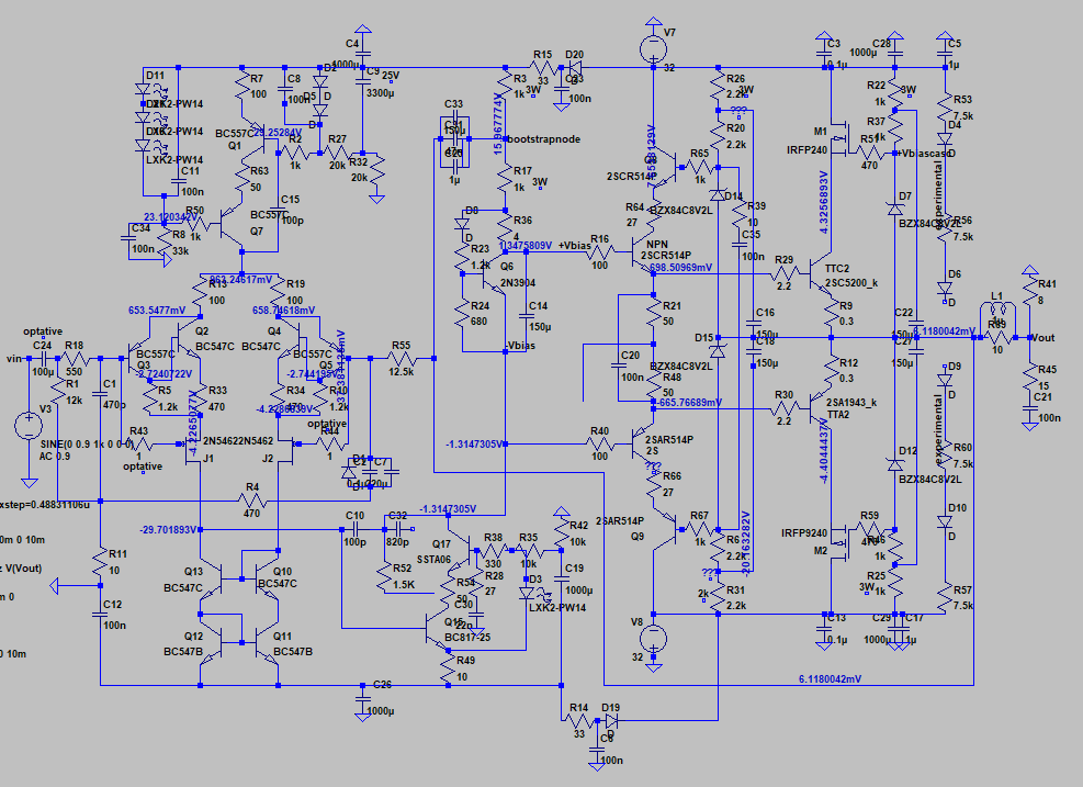

Update schematics and layout
Although there are several items to be checked I want to post
an update of schematics and layout.
The update contains:
- 2 layer layout for shorter traces and increased width
- Combi layout CCS-VAS / Bootstrapped VAS
- Separate bootstrap for driver stage and output stage
(base/gate stoppers, 8 resistors 2W, caps to GND)
- Cascoded current mirror incl. degeneration resistors/ trim pot
for offset control
- feedback with 4 parallel resistors + cap
- split emitter resistors for driver stage with feedback cap
- driver stage / cascode on common heat sink (T-/U-profile)
transistors orientation base/gate -> collector/drain -> emitter/source
- RRDD string not included (yet)
Open issues
- stability problem
- decoupling caps
- transistors for VAS and CCS-VAS
Comments are welcome!

Comments on first look at schematics:
D27: only recommended for CCS-VAS version.
R27: value depends on the BJT chosen for Vbe multiplier. Check Hagermann's paper.
I recommend putting pin sockets to support the majority R, for example E-C resistors for the cascodes; resistors for the CFP...etc.
RDRD can be "aerial", anyway. 😉
About VAS BJT: keeping in mind that this is an experimental amplifier with a tendency for oscillation, I will commit heresy by recommending using at first a low beta T, like BD139.

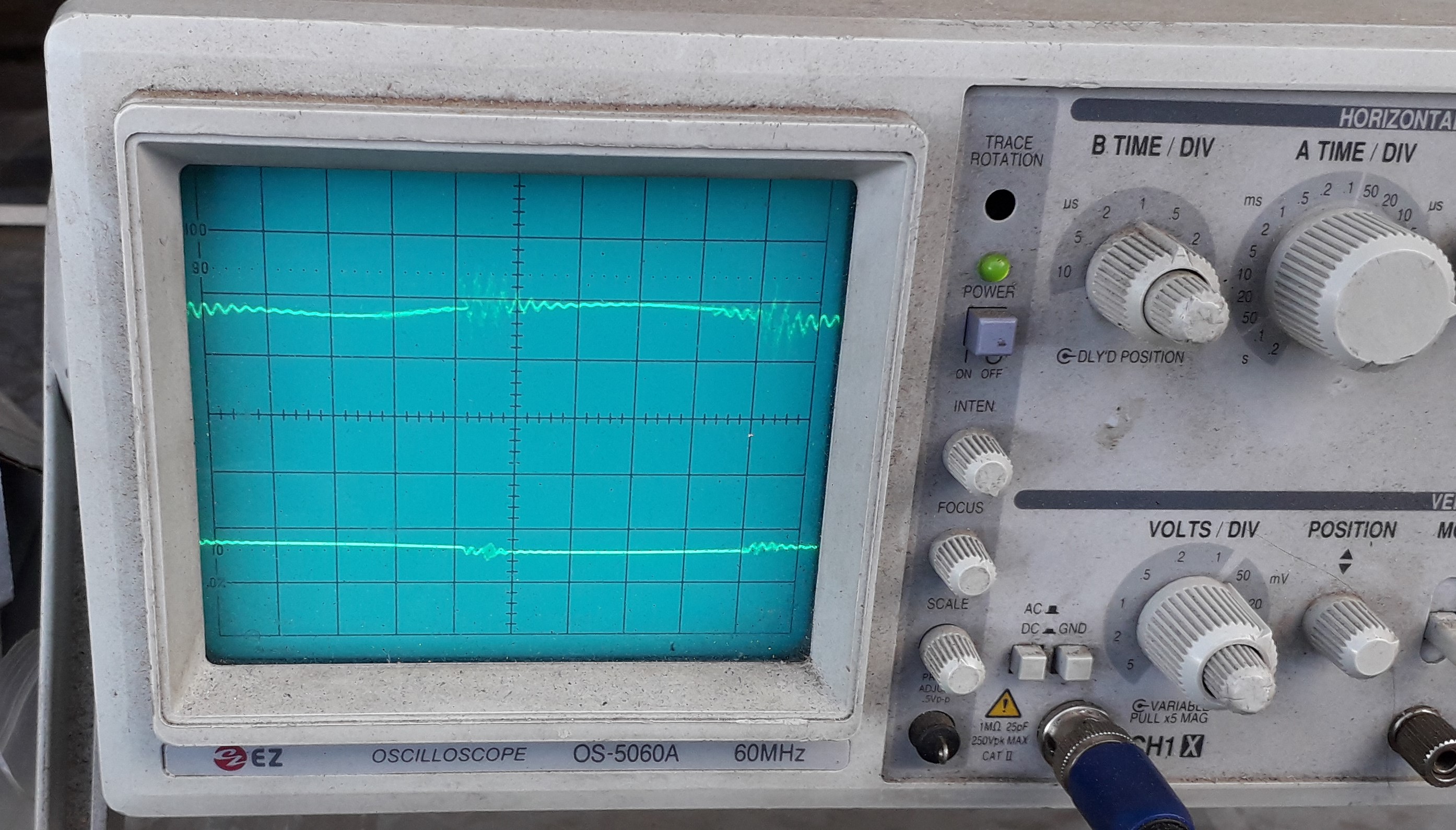

Report:
Original TRIPLE (QUAD) bootstrap amp is stable and sounding good to me.
DIY CCS-VAS double bootstrap amp is still presenting +/-80mv double freq. base oscillation.
I think the problem lies on the VAS-drivers area...
Removing C16 increased heavily the amplitude of the same oscillation. Increasing the value of C16 from 220n to 1u made no change.
Swapping 150uF electrolytics bootstrap capacitors for 15u film caps made no improvement.
Connecting C26 (100n from base of positive driver's cascode to ground) makes no change, but C27 (the negative one) is essential to avoid complete full power VHF oscillation and harm.
I have yet to try increasing base resistors for the drivers or adding BC capacitance for the same, with the original Miller compensation. Also, make both BJT of similar type.
Also, adding small capacitance between cascodes' bases...
Other ideas are welcome.
As you can see, experimental amps can be very frustrating sometimes. 🙁
This is not a good project for eternal beginners, like yours truly.
It is advised to have good experience, at least an oscilloscope and lots of resilience and "sang froid". 😀
M.

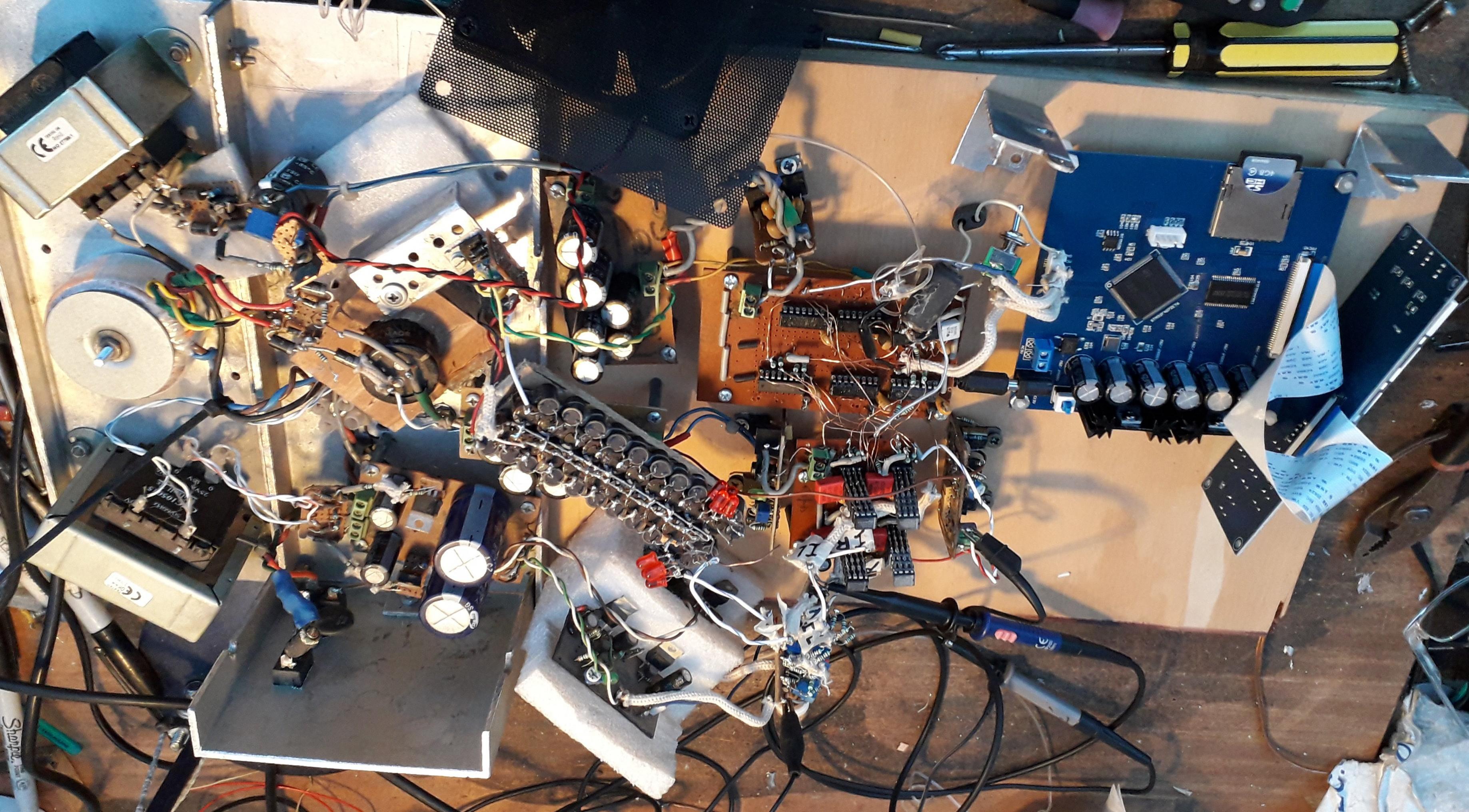

A big mess...
So, two SD card player+DACs upgraded and one new USB DAC built after 😀 I am stricking the project again.

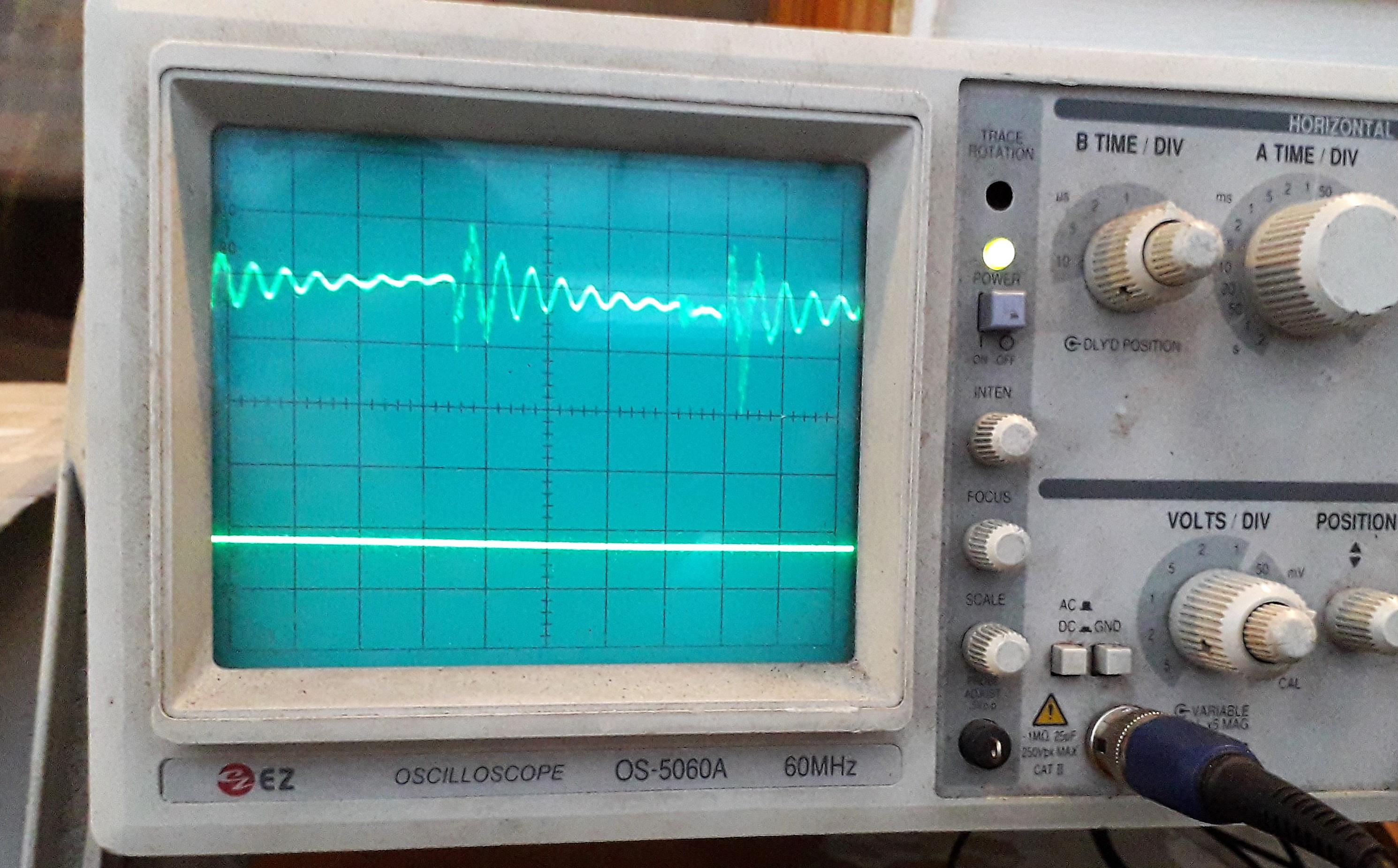

I attach a pic of the kind of oscillation I am having. Scale is 20mV and 1us. So now I have about 2MHz (the 80MHz is not there any more) and with elastic behavior of the resonant tank. Apparenty, there are many subcircuits that can resonate given the proper conditions. Now I have the output disconnected, to be safe, and the driver's cascodes without decoupling caps. I have the VAS cascode decoupled to ground instead of supply rail. Common Miller with 220pF.

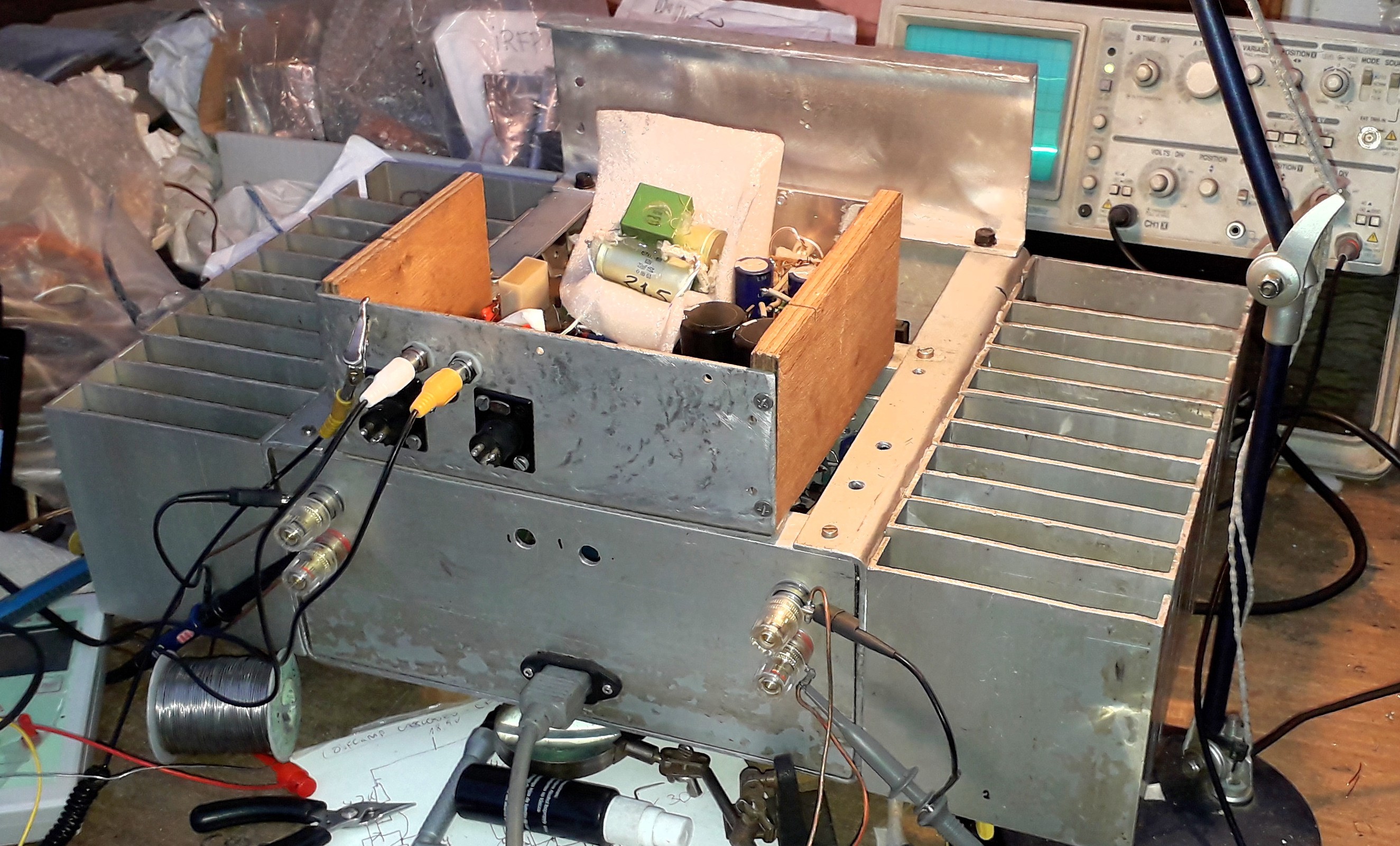

I plan to alter the value of some resistances (and caps) here and there and reduce the path lengths as much as possible.
Anyway...today I plan to meet my mechanical man to build the monster heatsinks for the future two stage VFET amplifier with LTMD input section...that one won't oscillate. 🙂
M.

Hi Symon,
Basically, I am trying every single spot I think can have influence on the resonant circuit and change values and positions of Rs and Cs, and evaluate the behaviors...all I got is either that kind of curve (with the initial impulse bigger or gentler; with or without auto-controlled bursts of VHF oscillation, like in the present pic) or full blown VHF oscillation, for which reason I disconnected the output from power. The permutations and combination I tried are too many to describe...
Yesterday I tried, against my will, the simple, non-cascoded VAS and it did not make any difference whatsoever...nor did inverting the sequence of BJTs for the cascoded VAS. Increasing base R for the cascodes to 1K neither made any difference...
I also reduced Miller cap to 100p (standard for this type of amps) with no ill effect, which demonstrates, IMHO, that the problem is not global FB related but related to some local form of FB node(s)...

Regarding the schematic in post-159:
I believe it would be beneficial to add some electrolytics across each of D7,12 and then a 100n from end-to-end of this bipolar floating supply. In other projects using this type of the circuit, the electros filter the zener noise and the 100n eliminates noise at low signal levels.
Where the Cob of the output devices might be kept constant in this cascode, I feel like Symon that having it be high all the time would be problematic for the drive stage.
Like you, I have efficient speakers and my power needs are low. I dare say that if yours are 90dB-1W-1m then the signal you actually listen to is in the 10s or 100s of milliwatt level. This would mean that in real use the output is "hardly moving" (4Vpp, maybe - pretty darn loud at 87dB) and the Cob issue would not make itself known audibly.

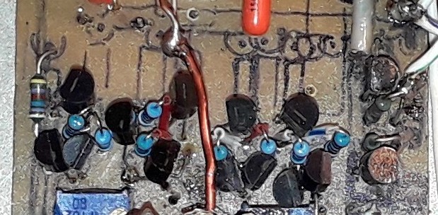

I modified the input compound cascoded CFP to 2SK30 cascoded/bootstrapped with 2SK170, with BC560 as the counterpart. I am keeping resistors low: 1K and 330R.
Now the listening tests...

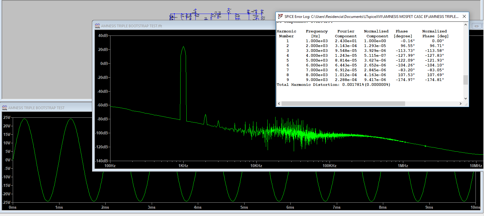

OK. Some news.
I tried the recommended tricks.
A 100nF from ground to heatsink worked better.
A 10R+100nF (even 10nF) from driver's cascode zener circuit (from +8.2V to -8.2V nodes) worked better.
Better no mess with Mosfet (output) cascode circuit as the same added subcircuit caused full oscillation.
Electrolytics parallel zeners did not improve things. Remember I am concerned about oscillation, and not about THD.
I attach some pics from the (reduced) oscillation I am having and the test circuit, and FFT, with 0.9V signal for 32V supply. The scope shows sort of a "pre-ringing", unlike the previous ones.
I suspect all this problem is related to my filthy test instalment...
Nevertheless, the amp did not go into full oscillation and I could listen some sweet music and even torture it. I connected two 16 Ohm speakers to the single channel I tested. Man, this is a superior sounding amp. 😎
