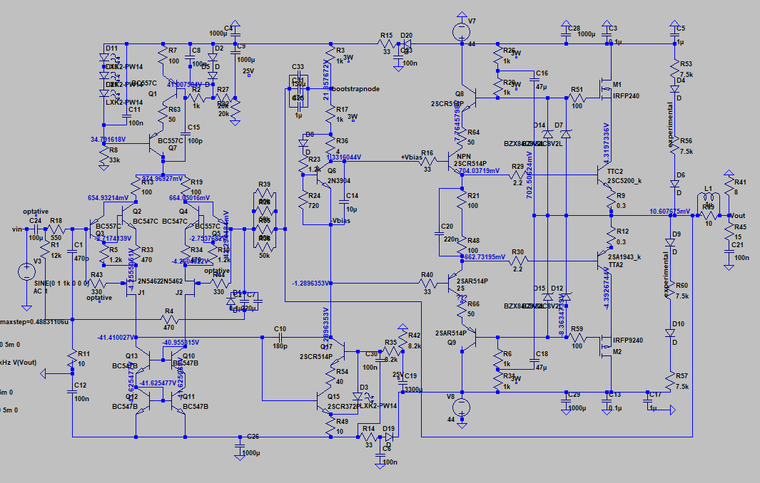

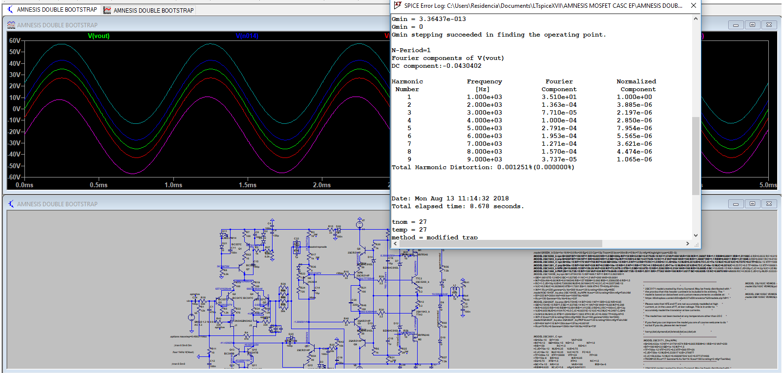

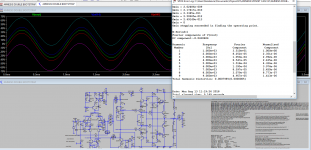

The magic of bootstrapping...apart giving more headroom, less current is needed at the CCSs to achieve the same swing, but THD can be lower at some point and we can play with values to achieve both.
See how the DC voltage at the bootstrap node goes up and so does AC swing (+/-60 or more) depending on value of resistors. This curves are with 1.3VAC input signal. near clipping. We are learning...we are learning... 🙂
I have to simulate if one bootstrapped-CCS can feed both voltage sources...

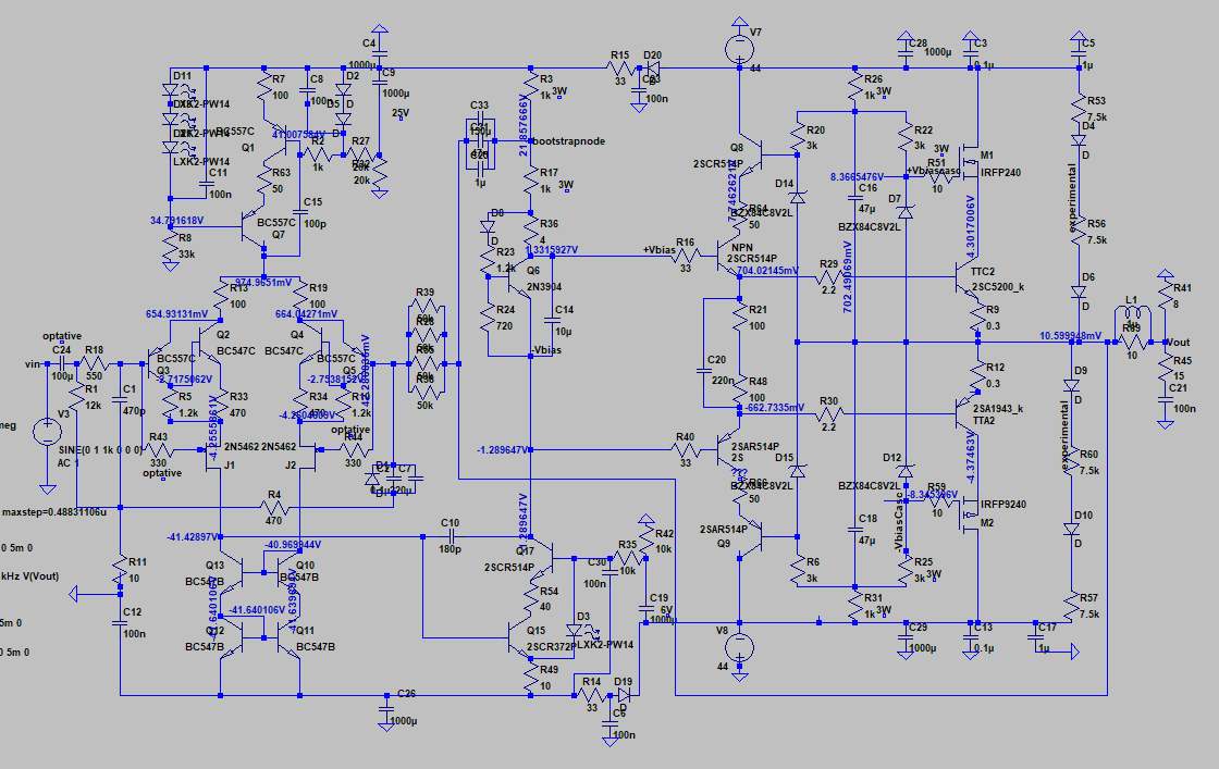

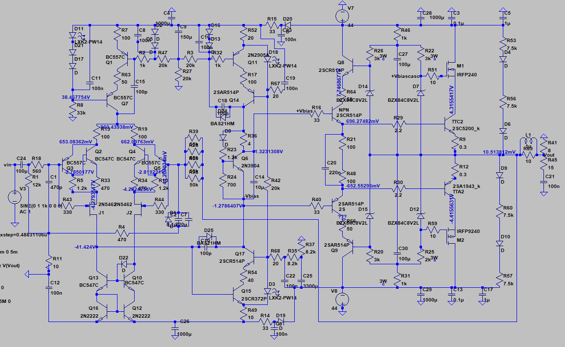

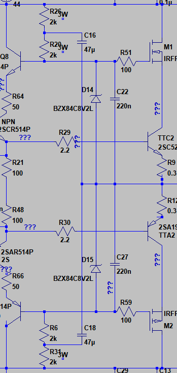

Two more variants:
1) CCS-VAS with double bootstrap and with "improved" bypassing.
2) Double-shared bootstrap. Apparently the output cascodes doesn't care where the current comes from...less parts.
The CCS-VAS amps always show more THD (5k to 20k) than the bootstraped VAS amps. 😱
Hi Max,
I had been looking at similar output stage simplifications. For your second circuit, you don't need to parallel the zeners, so D14 and D15 can be removed.
Also something that logically makes sense is to place a small capacitor across the zerers say about 220n this provides stabilisation and a resurve of currnet should the cascodes need it.
I think you observed yesterday that output stage cascode resistor values are rather low, I think they are supplying around 24mA, perhaps we could reduce this to around 12mA a reduce loading of the amplifier.

Hi Max,
Yes, I know. I only wished to add more current handling capability in case of something weird happening. In my repair of the bootstrapped amp I noticed that the zeners for the driver's cascodes (1A) were either lower voltage or behaving like a capacitor: damaged.
See attached.
Symon
OK. Like a bootstrap for the gates/bases... 🙂
Easy to try.
I tried the same but connected to rails. Not good.
With some arrangements there was a small peaking at around 7MHz.
I believe I tested even 7mA. I can test lower current for the cascodes CCS' but THD starts to climb.

Hi Max,
I've been looking at the VAS stage and I think the grounding could be improved, see below.
Also after playing with the simulation, I think two pole compensation looks promising way to improve phase margin and reduce distortion.
Symon

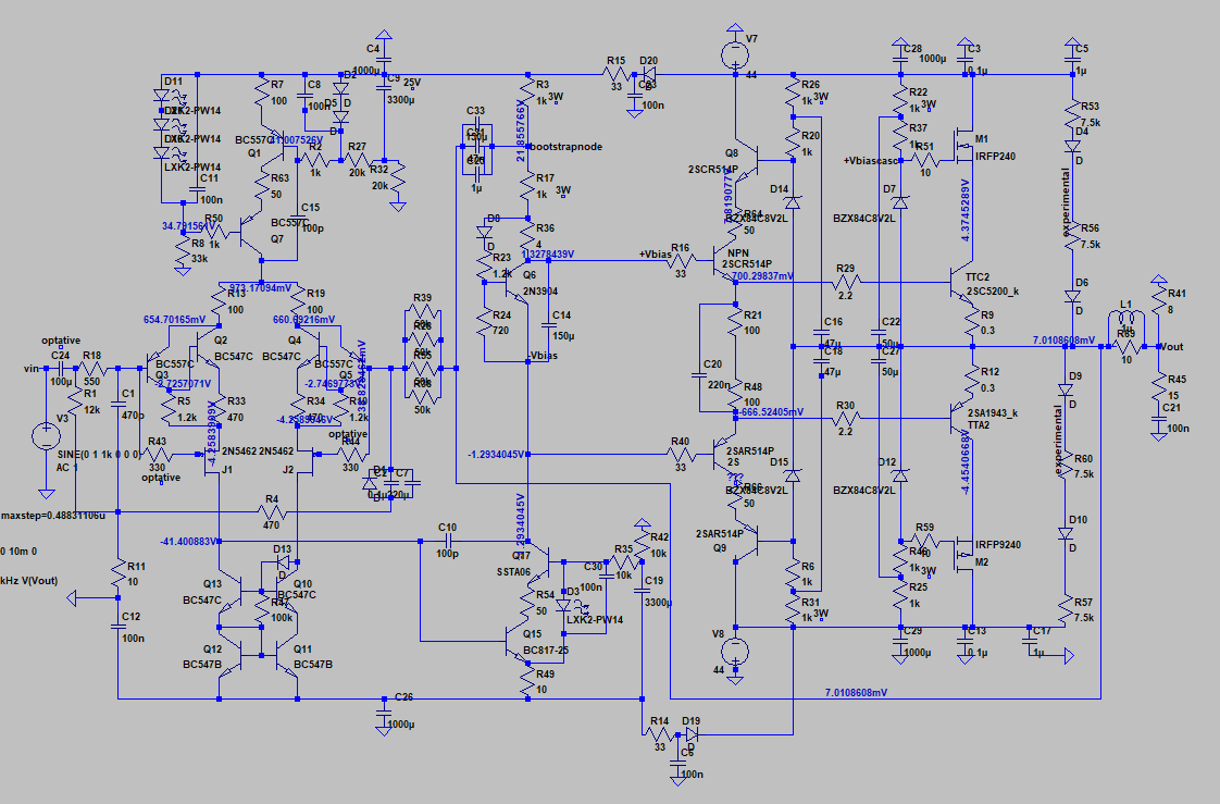

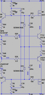

Hi dear JOSI1,
Yesterday I worked a little on the output. First one side "shared bootstrap", that is only one bootstrap (2 resistors per polarity) and the other side "triple bootstrap" (four resistors per polarity) and some listening tests were performed. I had to bypass again the bases of the drivers' cascode. See below. I had the feeling that the "shared" was a bit loose on the bass and less focused as I went to upgrade it for the "triple", which was easier to stabilize, meaning getting rid of the oscillation on peaks. This was done with 27R in series with 100-150nF at the bases of the cascode T. But now I found the article by the creator of the Ovation amp (I believe he is Bonsai; sorry if I'm wrong) where he deals with the same problem but at input. See attached. I will upgrade as he advices for there is still a low grade VHF oscillation/noise that stops when I pause the source.
The problem I did not preview is that, the zener's leads being very long, I solder them in different lengths to the bases, meaning different parasitic inductances.
With 32V PS, I use 3X 0.6W resistors for bootstrap without problems, Though higher wattage can lead to less noise. I think 2W will be more than enough. As for brands, I don't have an opinion yet. I suppose any good quality metal film would be OK...
Resistors can be located underside. No problem. Due to different (unpredictable) inductances, it is better to plan for the "triple" and then taste what configuration gives better results.
They can be piggy-backed but horizontally to avoid they acting as antennas.
The trick is to place the zener (or damper R-bypass capacitor; see attachment) as near as possible from cascode's base.

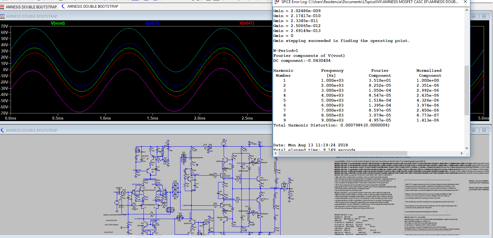

Attached, two simulations with the modified (as recommended by the above site) bypassing for the cascodes, with maximum values they seem to tolerate. In case of oscillation (highly probable) lowest values that cancel all oscillation must be used.
This could be modeled and simulated beforehand but I wouldn't know hot to do it exactly.

OK. Quick update.
Just adding 330R gate stopper resistors from Voltage reference node to MOSFET's gate (without upgrading driver's cascode bypassing) reduced the hash of the base line to 5mV.
This supports the idea that parasitic inductance from the long leads of the zeners and etc form a Collpits...
I hope upgrading to the recommended bypass on the driver's stage cascode will kill all the gremlins. 😱
Unfortunately, not much time for playing around.
Best wishes,
M.
Best wishes,
M.
More on the improved bypass.
I wired the TRIPLE Bootstrap amp much like my last .asc file shows. I can tell that the MOSFET cascode's gate doesn't like a cap attached to it! It starts oscillating at peaks even at low power. We have to keep these, probably, local feedback loops as short as possible.
With the present organization (the VAS is not optimized yet 😱) I managed to reduce but not to eliminate the base oscillation: there are two frequencies riding together, the first at 10MHz and the second at 80MHz. Note that Ft for the 4793/1837 drivers is 70MHz...
I forgot to mention that I check with speakers connected, to save time, so there is added capacitance of speakers and probes.
When sweet music stops or pauses there is a 20mV harsh (oscillation) that lasts 2-3 seconds and then it reduces to 2,5mV on one channel and to 5mV on the other channel. This is the best I could do so far. I gave up, temporarily, and now I am making listening tests. No matter that little problem, he he, the amp sounds the best so far. It has the traits of all the previous versions: dynamics and a softness of the emission, but has better resolution and delicacy. I hope I can make that harshness disappear to listen to the full potential of the Amnesis. I plan to add or increase base stoppers everywhere...every advice is welcome.
Now I have to upgrade the CCS loaded-VAS amp (a DOUBLE bootstrap) and try to make it better than the present one. 😎 I will try to make changes to reduce path lengths and try to avoid the risk of oscillation, probably due to parasitics...
M.
PS: some of my power resistors and the missing IRFP arrived 😎 Maybe that will help.
M.

Thank you JOSI1 for your invaluable work.
I am not an expert but I this can be viewed from two extremes, considering this is still an experimental amplifier:
a) go for the cheapest complete option possible, considering that many changes to the wiring are still probable.
b) go for the best solution, meaning heavy copper, double sided, to allow for shorter paths, higher current, resistance to de-soldering...etc.
I am inclined to the latest one but that is because I am the the daddy 😀 of this monster baby...lets see what others think.
Let me know what is the number that makes the project PCB get a reduction in price: I might buy a big lot to make it more attractive to the public 😀
Speaking about the TRIPLE bootstrap, I am philosophizing about how the amp can sound so good even with that multi-megaHerz harsh riding the signal?...or is it how can it sound so good thanks to the same oscillation??? Can it be a similar process to what the recording AC bias of tape does to that medium???
Allegedly, high frequency bias for tape overcomes hysteresis of the magnetic tape but tape isn't the only magnetic material on the signal path! The speaker magnet is also there at the end of it. Can HF signal bias also help with speaker magnet hysteresis???
Biasing in Magnetic Tape Recording
Since the amp is "stable", meaning that it won't go into auto-kaput mode, I will still be listening for a while this "clairvoyant" version... 😎
PS: this is with the RDRD strings not soldered...
M.
