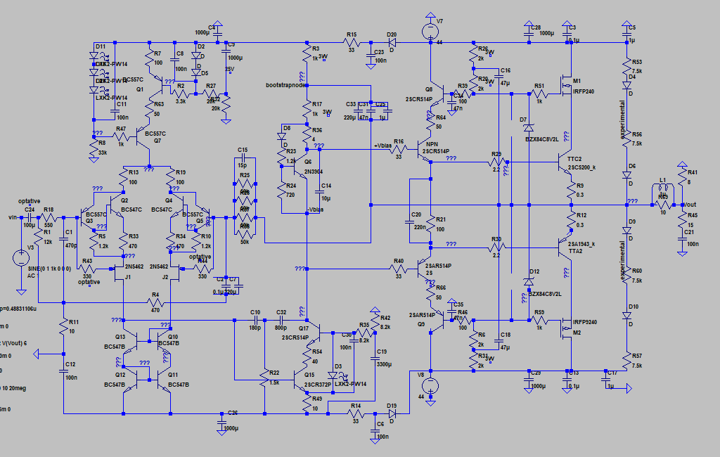

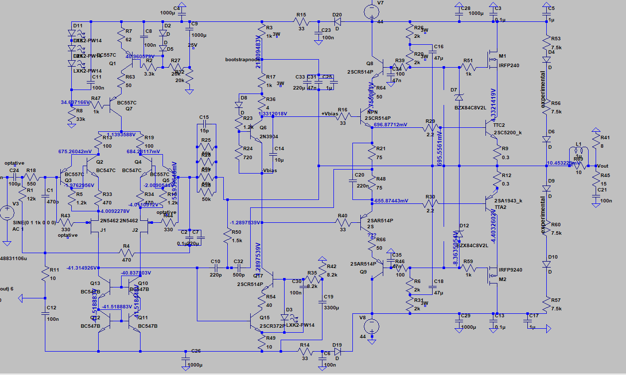

Did some revisiting of the "shared double bootstrap", which is convenient from a parts count and simplicity POV.
We can increase base/gate stoppers resistors. For example, in the following experiment I increased gate stopper R for the MOSFETs to 1K with no apparent harm. That will probably make the amp more stable...we can try different values there.
Other way to increase stability is by lowering gain, by increasing R4. In that experiment with R4=820r, gain is reduced to 16X but stability margins are better, before Zobel. For those who do not need a lot of gain or power. The same by reducing R feedback to 7K or so...10K is also nice.
I don't know if that will be detrimental for dynamics, though.

Dear JOSI1,
I think 20 pieces at EU7 is cheap as can be. Lets go for it: I'll buy what it takes to go to that mark. 😀
Two extra points:
Note that I no longer consider two separate emitter resistors (R21=200 Ohm) for the drivers, as my last schematics show. I will update the "TRIPLE".
I have to study the more complex compensation strategies as Symon recommended... 🙁
We need a bit more stability margins if others want to enter the project. There is a lot of responsibility there...
Though I am comfortable as it is for my own use. 🙂
Thanks again,
M.

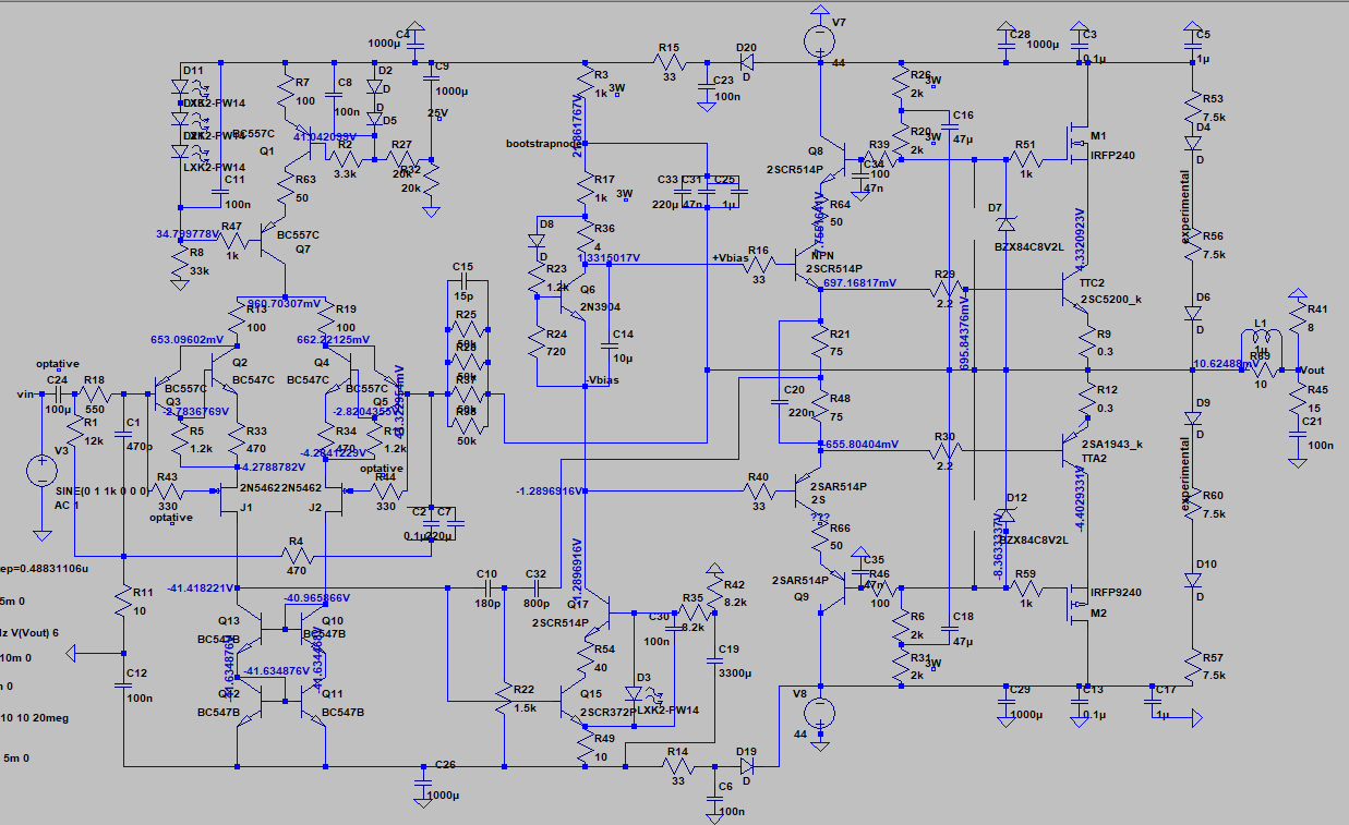

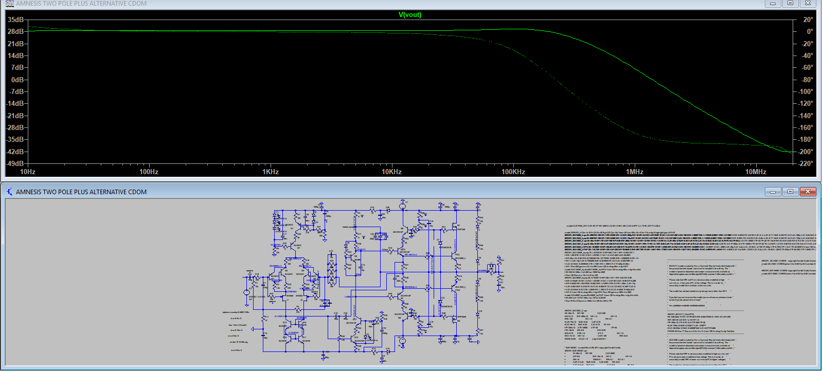

I already started the study of this very complex subject of compensation.
Please attached some of the trillions of variations possible.
I updated Symon's two-pole. Reduced C//R feedback to 15p. Note that I am using 4 resistors in // in my second amp, so that by itself adds some capacitance...
I added a simulation of a compensation with driver's stage included (I hope I remember well what the little bird told me...) which gives on paper good margins.
Also note that increasing current on the Drivers seems a good thing 🙂
The caps //zeners are not included because I did not like it in real world...
Opinions please.

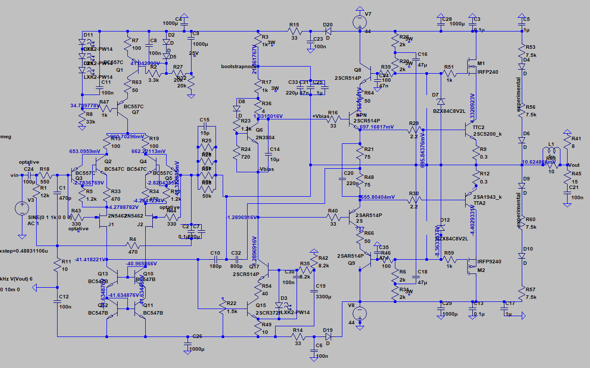

And the combination of the two techniques seems even more attractive. 😎
Strangely enough, HF distortion does not appear...
Anyway, an easy mod to try...proabably will be a good radio emitter 😀
Next I will include the whole output section...

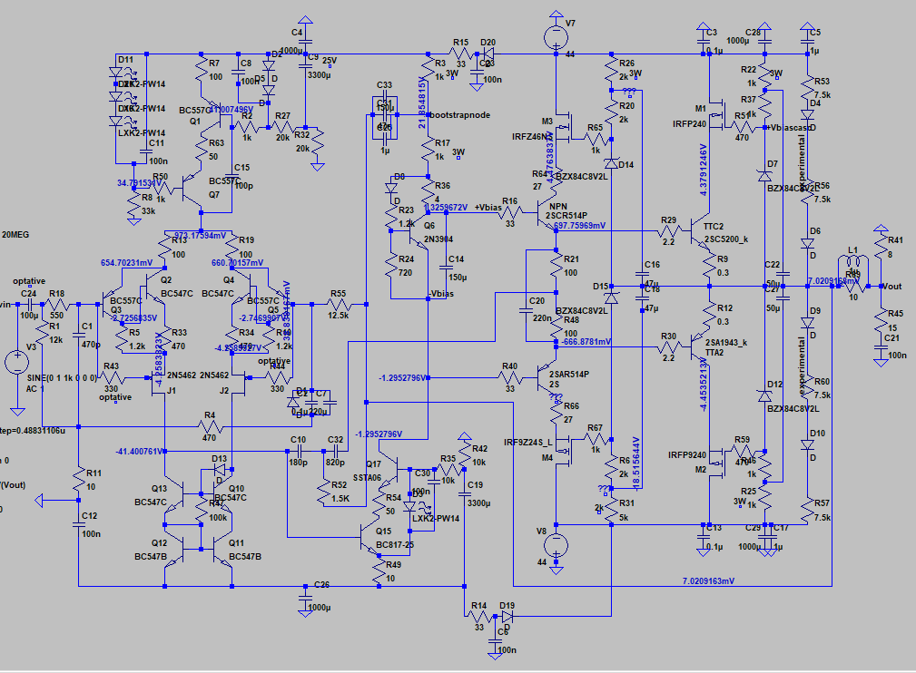

Hi Max,
I think the circuit in Post 226 defeats two pole compensation as the effect of C32 is shorted out by the output of the amplifier which is very low impedance. So C32 is mainly ensuring the junction of R21 and R48 is linked to the output.
I've not simulated this but I think it will show its working by single pole compensation. based on value of C10.
I'll post more when i get time

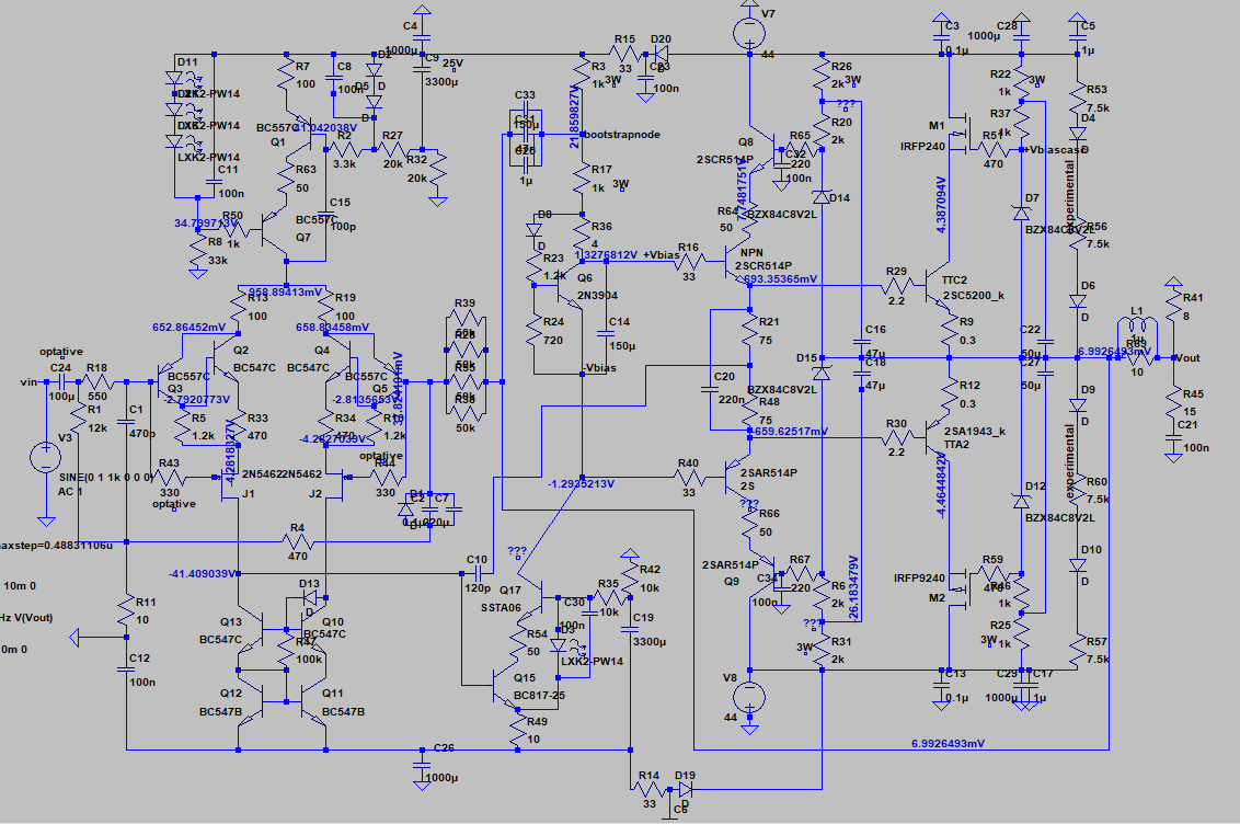

That two-pole comp is very entertaining. A low cost, easy to test trick.
Of course, I will try every possible combination that seems stable on simulation.
If it appears stable, who am I to disagree?
The thing is that I want to include drivers stage and/or output and see if that makes the CCS-loaded VAS amp stable. So far, it has been difficult to do so... 🙁 after upgrading to boostrapped cascoded drivers.
For example the following gives best margins so far, as far (near) as I understand.
Oh! and I can also test what happens when current increases to 4.5mA on each tail of the input "pair".

Hi Max,
i mentioned before that I'm concerned about connecting capacitors from Driver cascode Base to Ground, I know you found this kills oscillation in output. And at 1KHz it looks fine, but run the Dynamic simulation at 10KHz, and see what it does.
I'm playing with an alternative simplified cascode arrangement which I'll post later.
Also to evaluate stability it's useful need to simulate square wave behavior, as this shows up resonance problems.
Symon

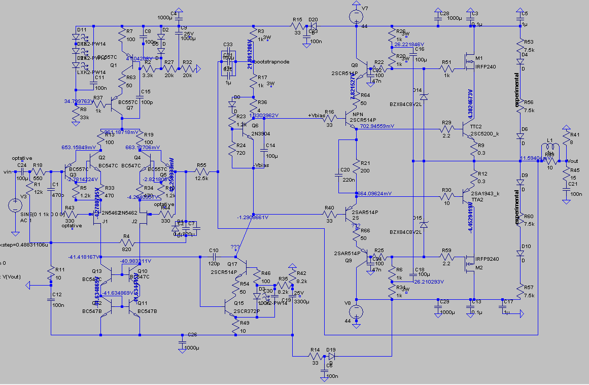

Hi Max,
I considered that the Driver stage cascode is basically doing the same as the OP device cascoe. so why duplicate?
Also since the OP cascode is a MOSFET it takes very little current, so we can reduce the boot strap current. Only problem is that the MOSFET cascode drop it too high for the driver so I had to increase the zener voltage.
I altered the feed back in the input stage so the input devices Q3 and Q5 now carry much less current than the complementary devices Q2 and Q4. I checked and in Peufeu's circuit he doesn't use emitter degeneration on the complemenrary devices so this shouldn't affect memory effect.
I test ran this at 1KHz, 10KHz, and 100Khz, and all seems stable in simulation.
What happens in real world?
Regards
Symon

Feedback from output signal
should one use separate traces from the output
to the feedback resistors (4x 50k) and
from output to C33 (bootstrap note)
The same trace works OK.
One good quality (low tempco) R would also be fine. From 10K (probably more stable) to 12.5K should work.
Offset correction
Before introducing a double current mirror an offset correction
was possible by adding a trim pot to the 68R resistors.
How can an offset correction look like now.
Keep some small resistors (10R) in the emitter lines.
Using a resistor parallel to R13/R19=100
I haven't implemented this mod yet. In fact I had to take a rest from the CCS-loaded VAS amp (made some upgrades to my digital projects instead) so no experiment this weekend. At the present time I cannot recommend that version because it seems more difficult to stabilize than the TRIPLE BOOTSTRAP amp.
I hope the cascoded curremt mirror will have perfect offfset...if not, we can try to degenerate a little, as you propose, one of the branches, depending of the signal value of the offset... 😱
C19
C19=3300u/25V cap requires more board space for layout.
Can the capacity be reduced to 1000u or at least 2200u.
Again, I have not implemented this mod yet. Only the 100nF cap is there. The value does not seem that critical. Even a 47uF will do, so a 1000uF can be tried. I have here many Rubycon ZL 1800/35V caps with, I believe 12mm width.
Double current mirror
should D13 and R47=100K be planned for layout
They can be omitted..
Thanks for you patience.
Dear Symon,
I was thinking about your last proposal (not yet tried) but I am worried about Early voltage for the output BJT since now its VCE is much higher... in that case may be it would be better to let the drivers simple, meaning not cascoded.
I have tried both versions of the two pole compensation, with no effect on control of the oscillatory tendency of the CCS-loaded VAS amp, despite the wider margins they convey, so probably it is a local feedback problem...I have yet to try increased base resistors for the common-collectors and some BC caps...
M.
Hi Max,
you are correct, using the same MOSFet to cascode the output and driver does require a higher zerner voltage, but at least in simulation this doesn't seem to be a problem. The simulation file shows this, and a few other small changes to make it work.
i think for tis project the main advantage of cascode here is reduced power disipation in output and driver. So you get better bias stability, and less thermal memory effect.
But, the thing is try it and see how significant effect is of the output / driver cascode.
Symon
Compensation is something that needs some further investigation, I'm playing with a 2 stage design currently, and while it appears stable I'm still looking for a better compensation solution before I start construction.
From previous practical experience you have to be careful adding capacitors to the circuit, sometimes they introduce new problems ... or just degrade performance to an un acceptable degree.
Symon

About your thought:
C20
as far as I know this cap was recommended by D. Self to
improve the switching time of the output stage.
Did you detect any advantages (THD, stability) if this
cap is added.
I think I will give this topic a try: with smaller and bigger values and without. Thank you very much for the idea.
I was lazy because I put it underside the PCB... 😱
M.
Hi Max, JOSI1
As Max says the role of C20 is to speed up switch off of the "Slow" output devices, by giving the internal capacitor in the device a path to discharge. It works by allowing the driver for the device that is turning on to "Pull" the base of the output device that is turnng off and pulling out stored charge in the base capacitance. To do this C20 should be many times larger than the expected Cbe / Cob of the output devices. As with all things there is probably an optimal value.
So in general C20 makes the voltage drop between the base of output devices TTC2 and TTA2 more constant than just the resistor R21 + R48 would achieve. Incidently I think these resistor values are rather high, typically the value of the resistor in this position is lower. But perhaps C20 makes up for this?
Symon
Symon
Yes, I simulated before lower values (50%) of these R21 R48 and it even helped THD a bit.
I don't no when I will have time to experiment though...
I think that could be one source of troubles.
When I increased the resistor from cascode's E to driver's C from 27 to 54 Ohm, the base oscillation dropped a bit on the mV range. 😕
About that, I ordered a new scope probe since one of mine was old and suspect...
Thank you for your ideas. 🙂
M.
